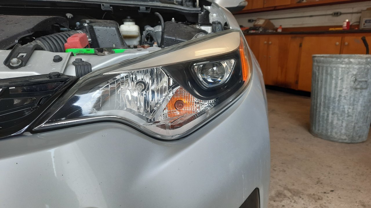

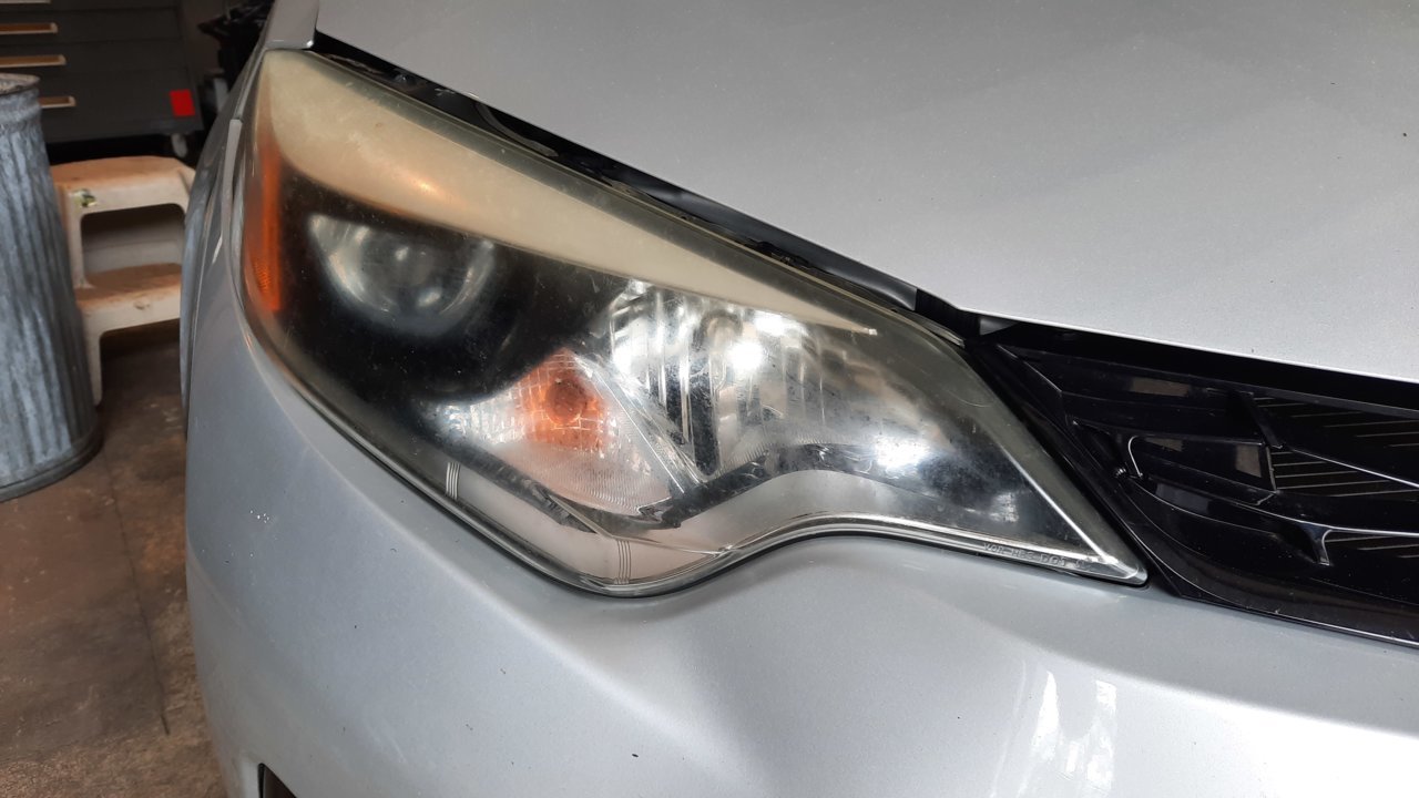

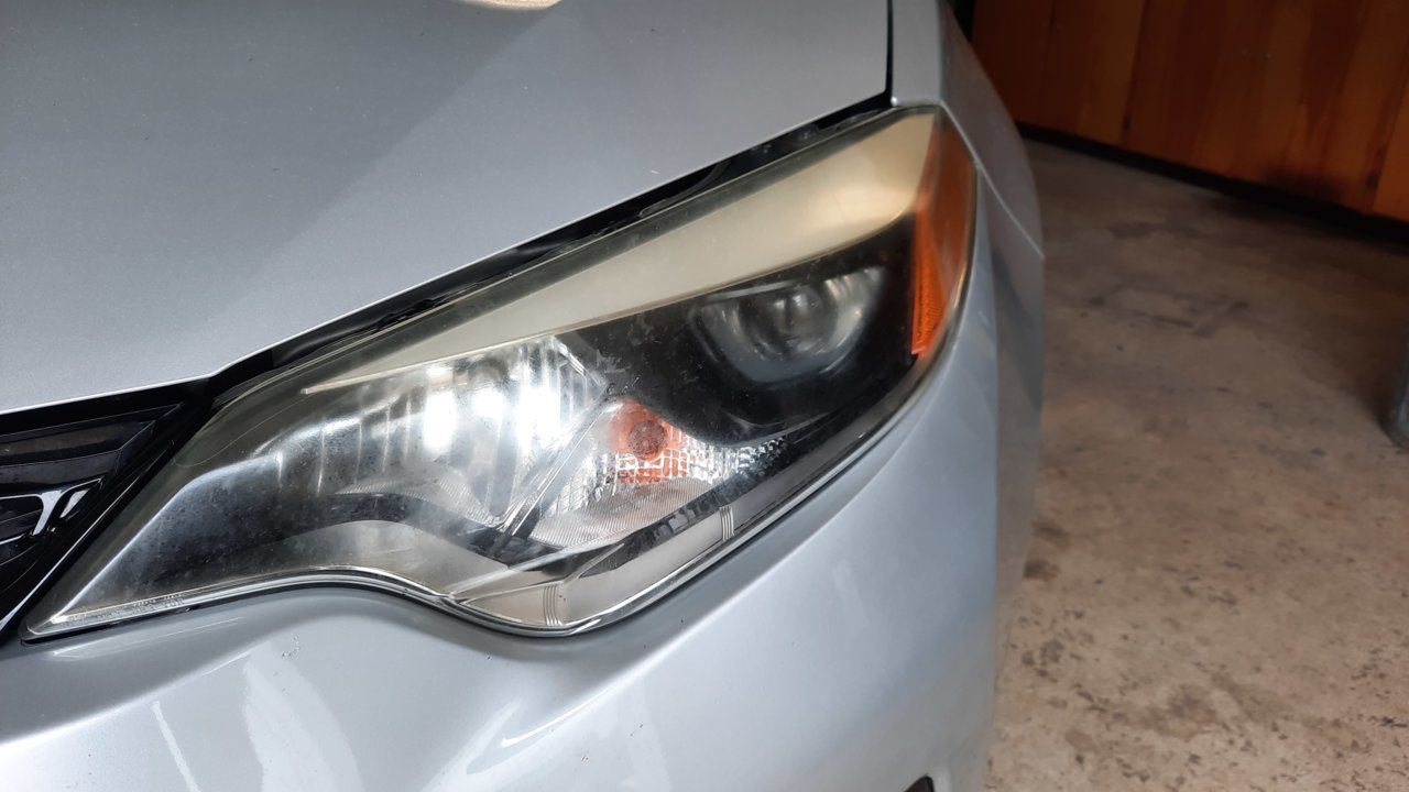

    Ended the day by restoring the headlights in my wife's Carolla.

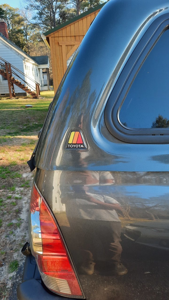

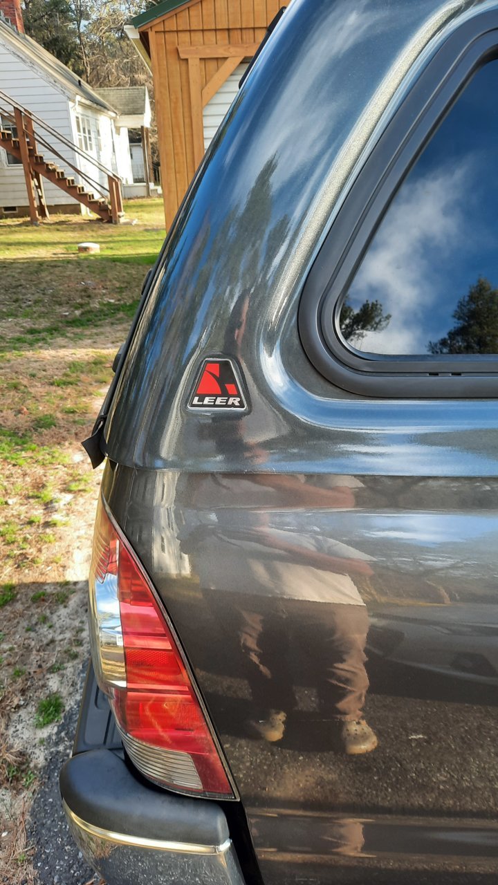

    Where did you get it?

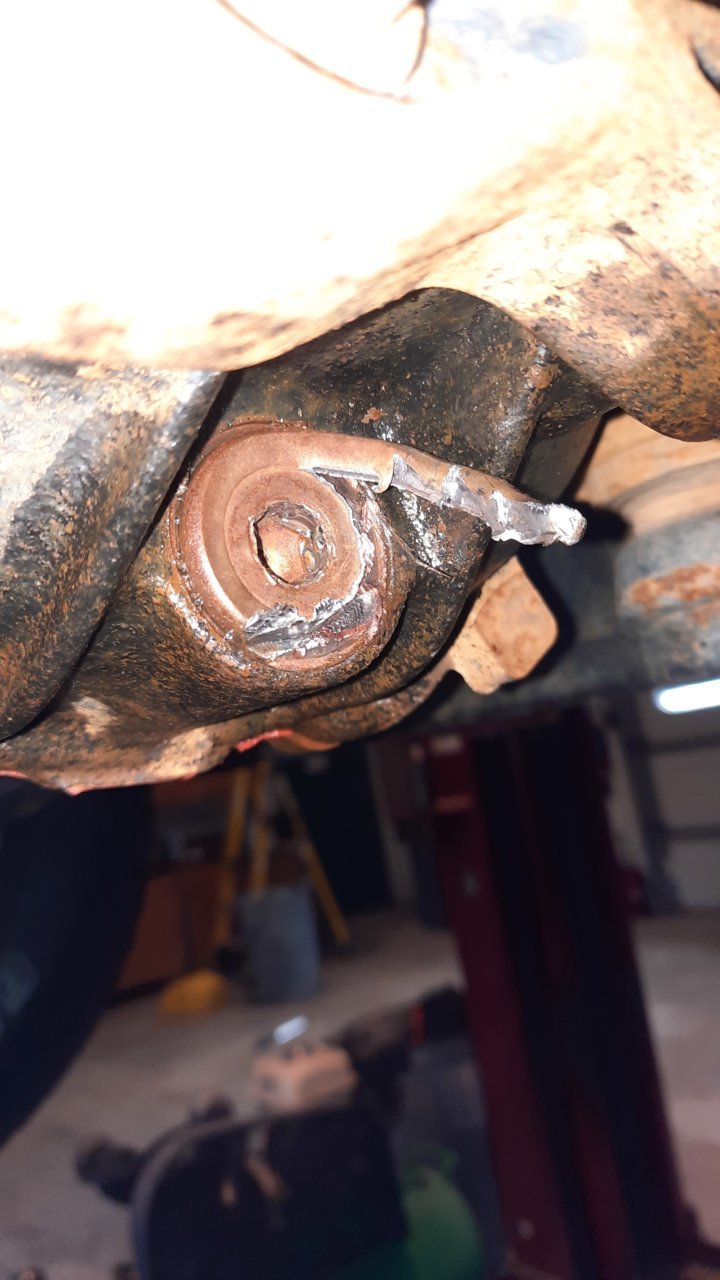

    Installed the ECGS bushing, New front diff seal, drained and filled the front and rear diff and the transfer case.

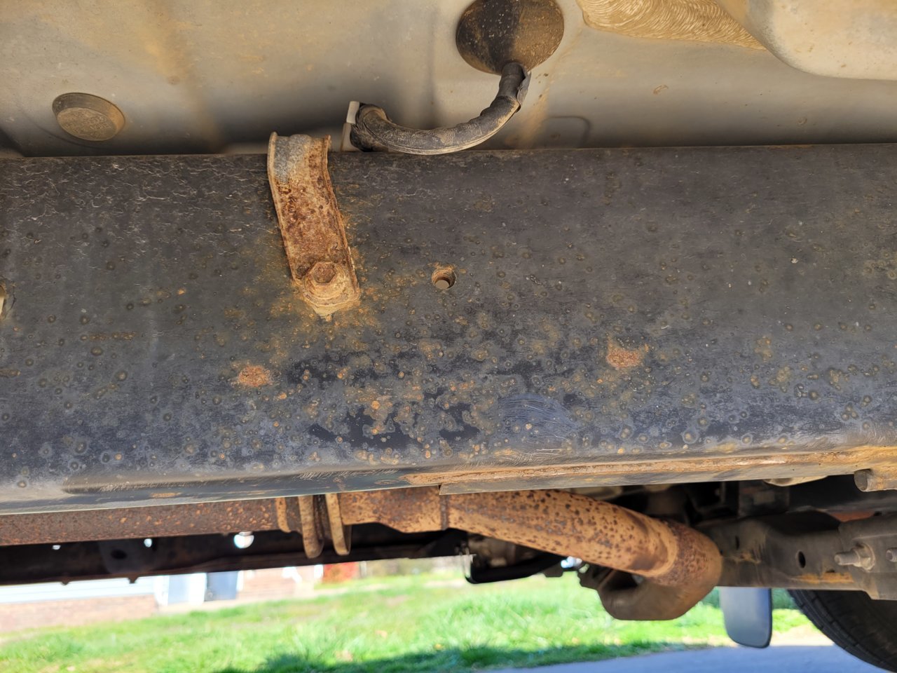

    Started working on frame resto. It's not bad I think it's been replaced but I want to stop the rust in its tracks. The whole thing is getting the wire wheel, then 2 coats rust reformer and a coat of rustoleum pro enamel. This is what it will look like I did a test spot with that setup. Gonna take the bed off and everything. Of course it's getting fluid filmed when complete. Not bad for an '06.

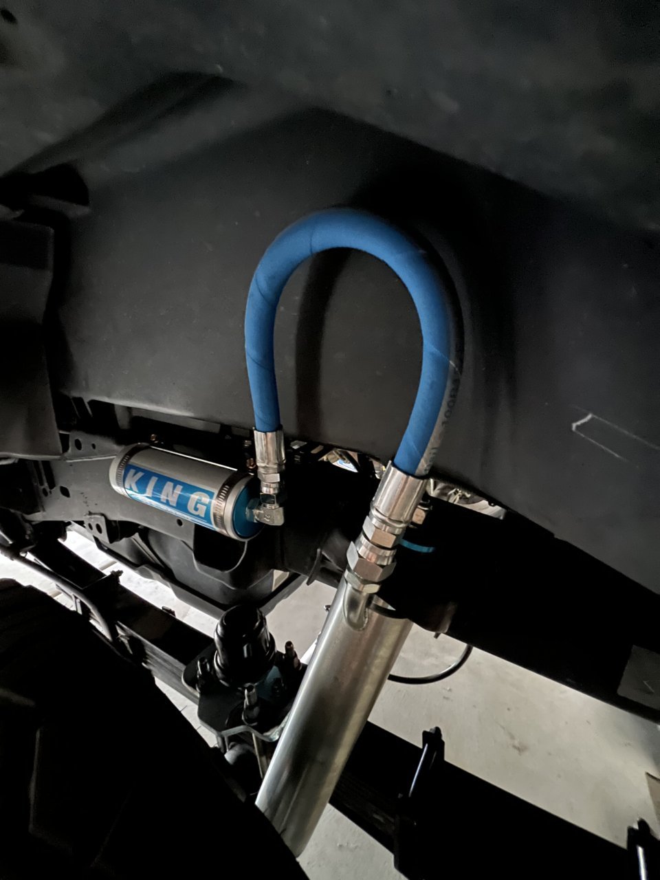

    New shock relocation kit

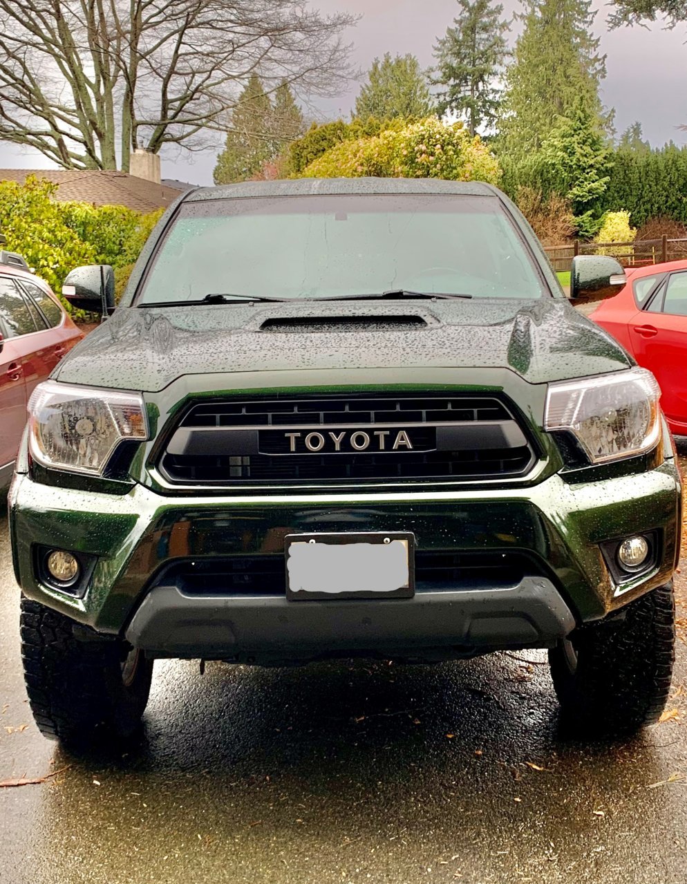

    I gave in and swapped to a pro grille. Been enjoying the new look
