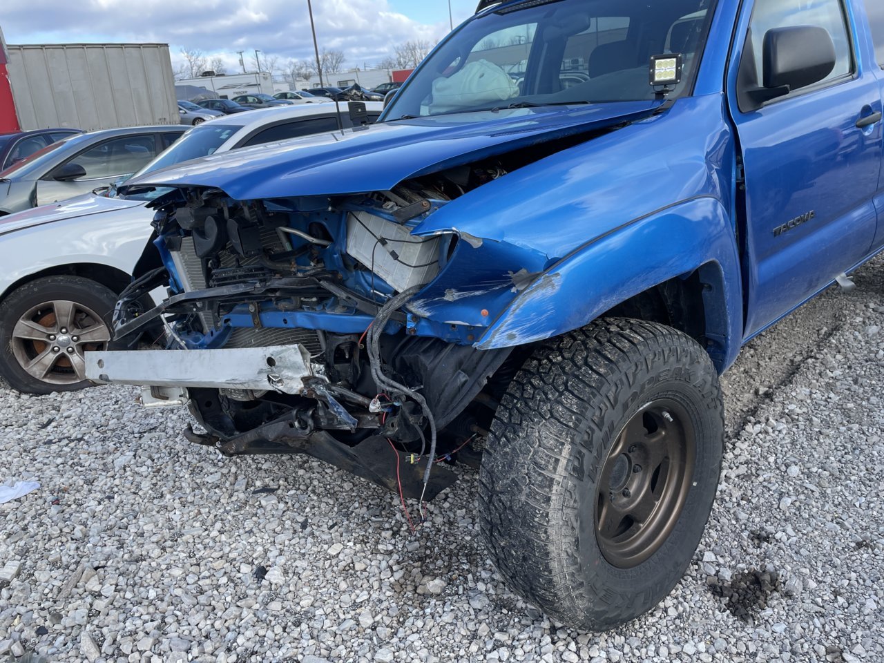

    Too bad, it looks like you had a pretty nice truck. You can maybe salvage the wheels and tires for your next one?

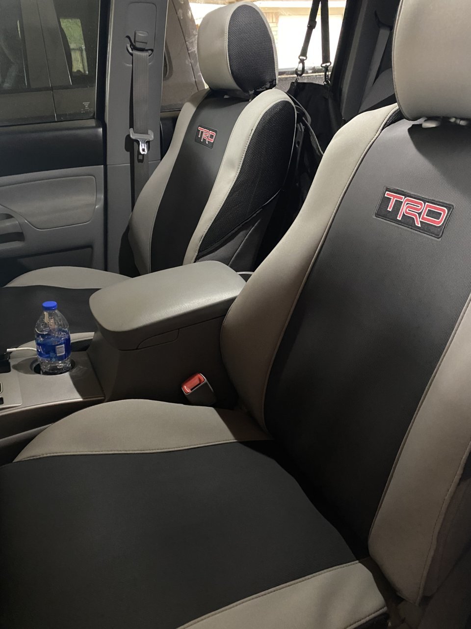

    811431B4-1233-4B1F-9481-502837D7F06C.jpg 035F5824-0F10-4841-9E87-4DEA02075EE5.jpg Installed seat covers and Victory 4x4 panels. I didn’t have a lot of confidence in the supplied mounting hardware so I popped the console out and fastened them from behind with new hardware.

    I dig those seat covers! Looks like they won’t fit on a 2015 :(

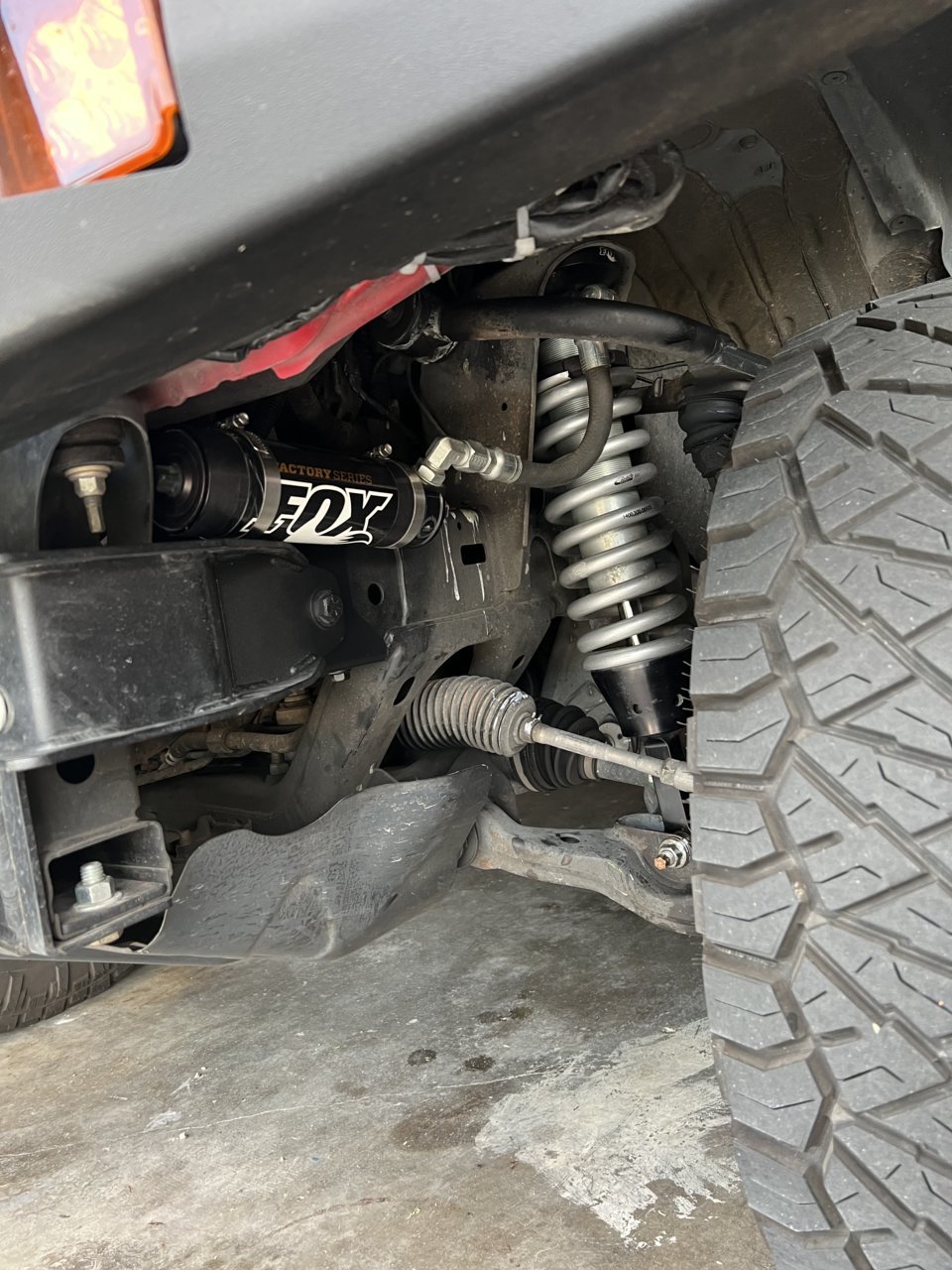

    Finally mounted up the fox 2.5s I got from @welderf15, thanks again man! Ride is much improved over the OMEs and the taco lean is finally leveled out. :taco:

    looks great man.

    Thanks, I wont be happy until i make a skid for it.

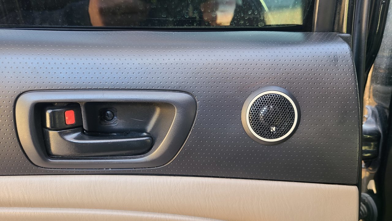

    Added some tweeters to the rear doors. Definitely fills the gap I felt was missing in sound all around the cab.

    Details?!?

    Just kicker cs 3/4" tweeters. I cut the hole to the mounting size which is 1-9/16" and from then I just ran them in line from the speaker I had down there. Which is an image dynamics 6.5 coaxial speaker. They come with in line crossovers so it makes the install pretty easy.

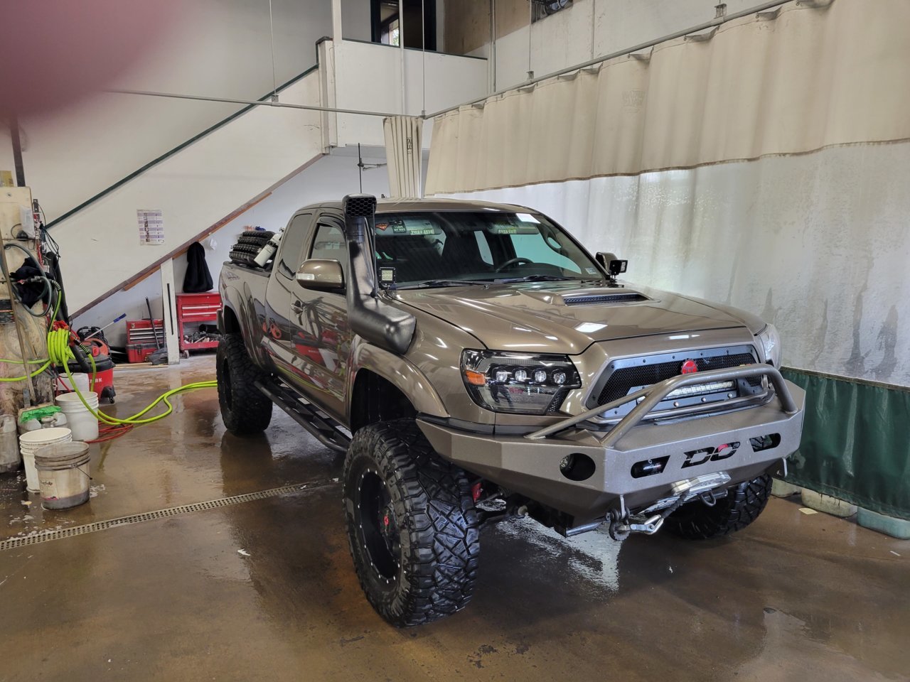

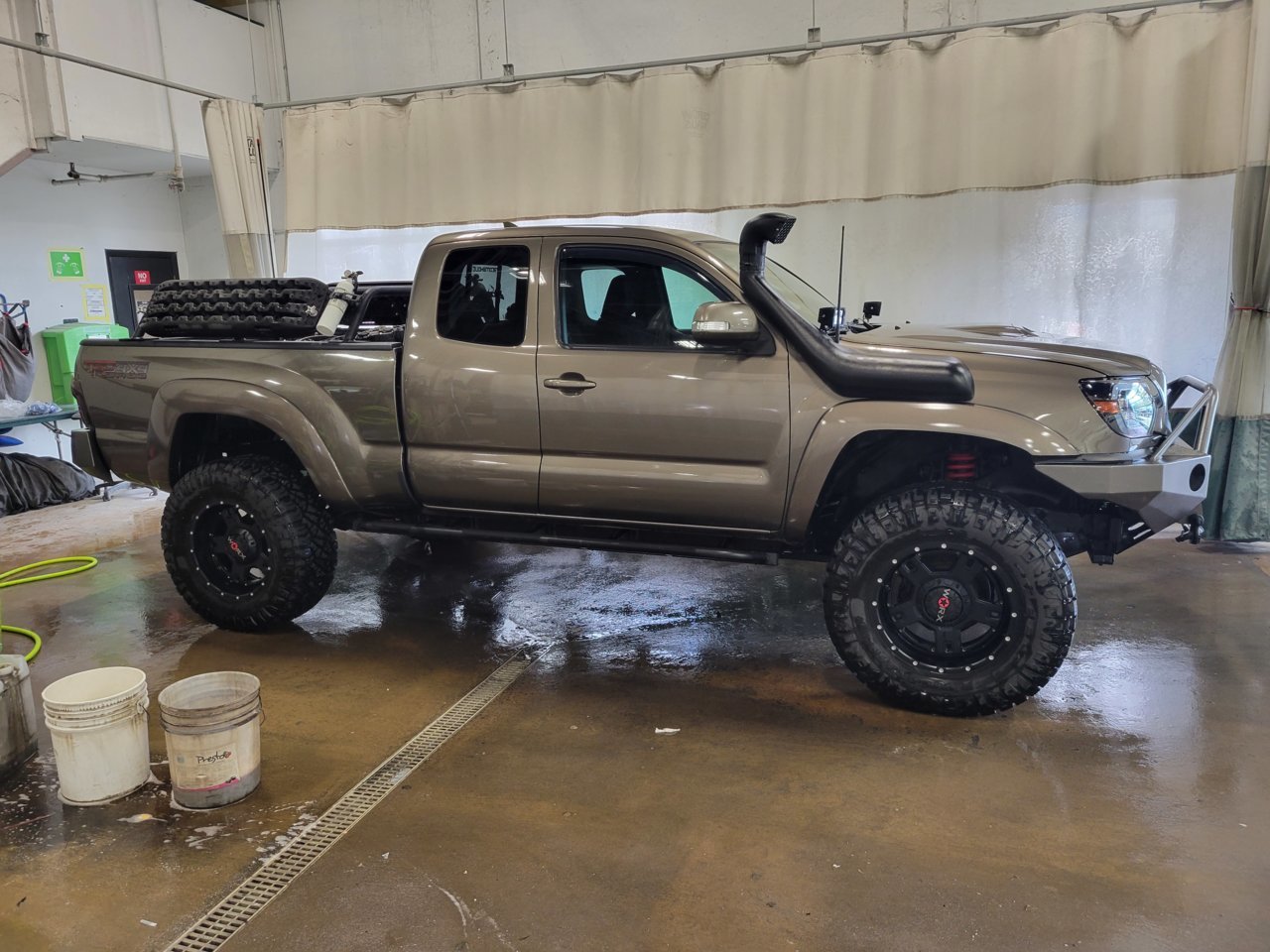

    I'm pretty good at the $5 wash.
