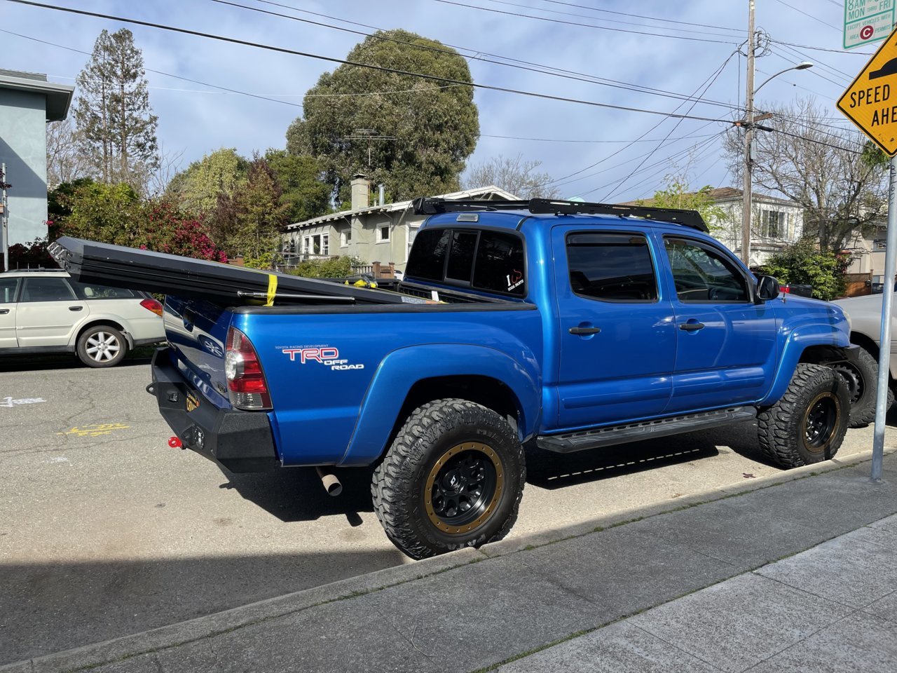

    Ready to be homeless. Roofnest Falcon 1.

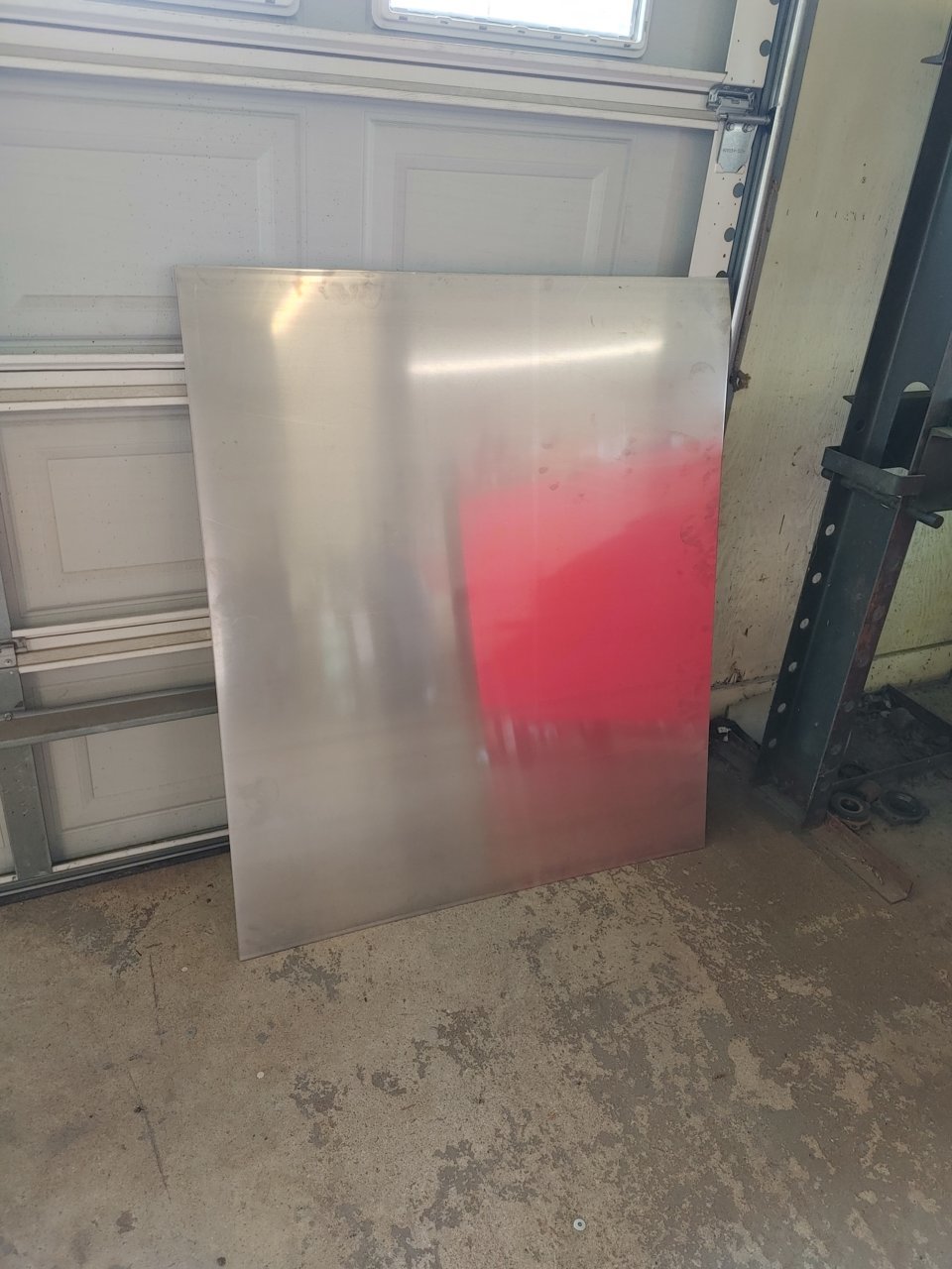

    0331221317_HDR.jpgwent and got 180$ sheet of 1/8th aluminum. Going to make a template from cardboard and have it cut. Will have to weld some tabs on bumper to attach.

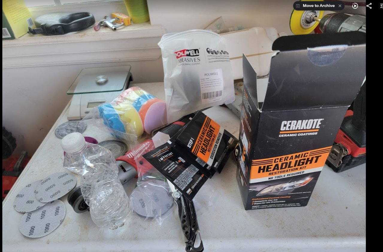

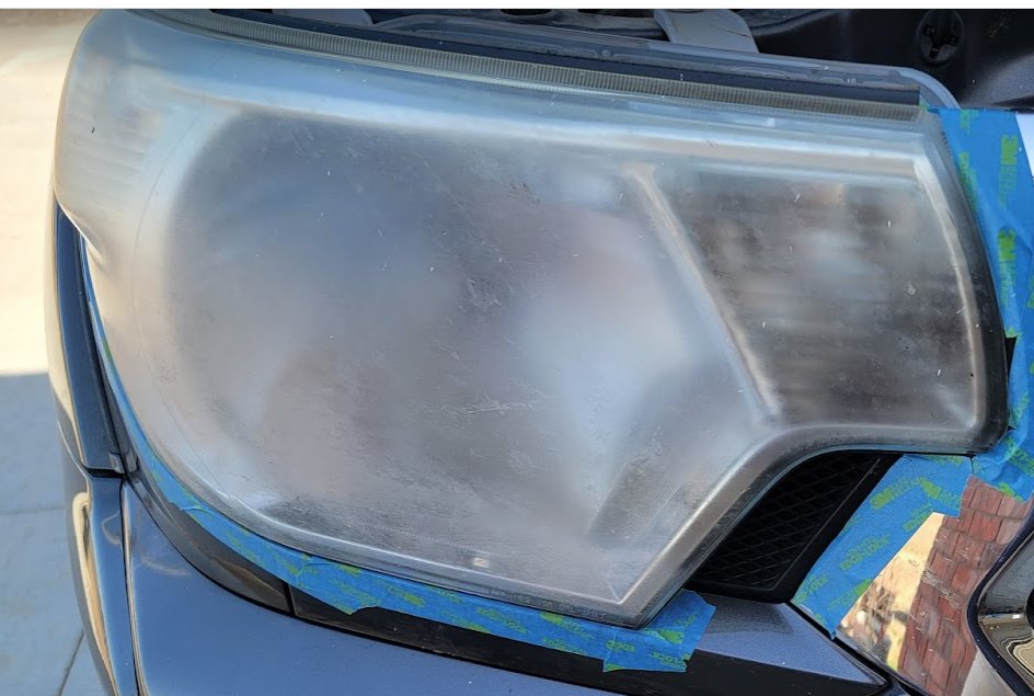

    I bought a drill sander kit off Amazon. I wish i would have went all the way to the 5000 grit though. Then just used the Cerakote ceramic coating wipes out of their headlight kit. Didnt even bother with their oxidation wipes, but hindsight, probably would have made the sanding go quicker. Think they have a little hand sander in the kit, but drill kit was much faster and i didnt want to be hand sanding all day. This maybe took 30-60 mins, longer cause beer, lol.
    Start with the aggressive grit and just move up, wet sanding. Pretty easy. I've heard from others that the Cerakote lasts years supposedly, unlike other stuff. Being that its a ceramic coating. Auto 2 part clears would be an even longer result. But again, windy as sh** here and i would just end up with sand in that. My garage is full of a tore up 4 wheeler i am rebuilding for the kiddos, so couldnt close it up in there and spray clear. Plus didnt want to have to tape off whole front end or remove the lights. Kids, animals, and wifes endless projects keeps my time ate up. :rofl: This was quick.

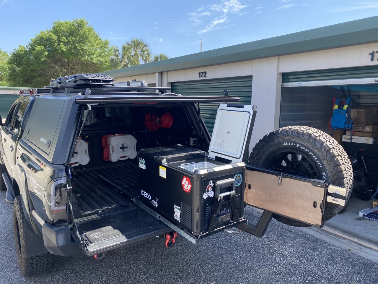

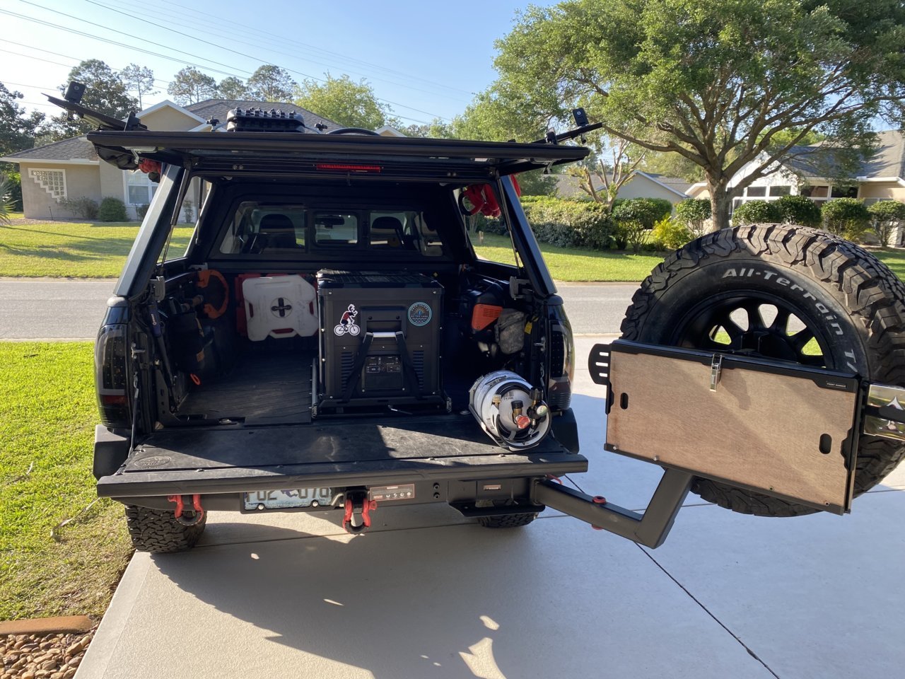

    Installed my ICECO slider for my 75L dual freezer/fridge and FINALLY got the balls to cut 4.5" holes in my quarter panel for the snorkel! Whew! That's done!
    IMG_2963.jpg IMG_2969.jpg IMG_2971.jpgIMG_2962.jpg 67042899915__84C4CFD2-1C07-47C0-A5B8-3B71A5C4B692.jpg 67044018586__D1B49FC6-C23F-4E96-A6BF-4F478F353431.jpg
