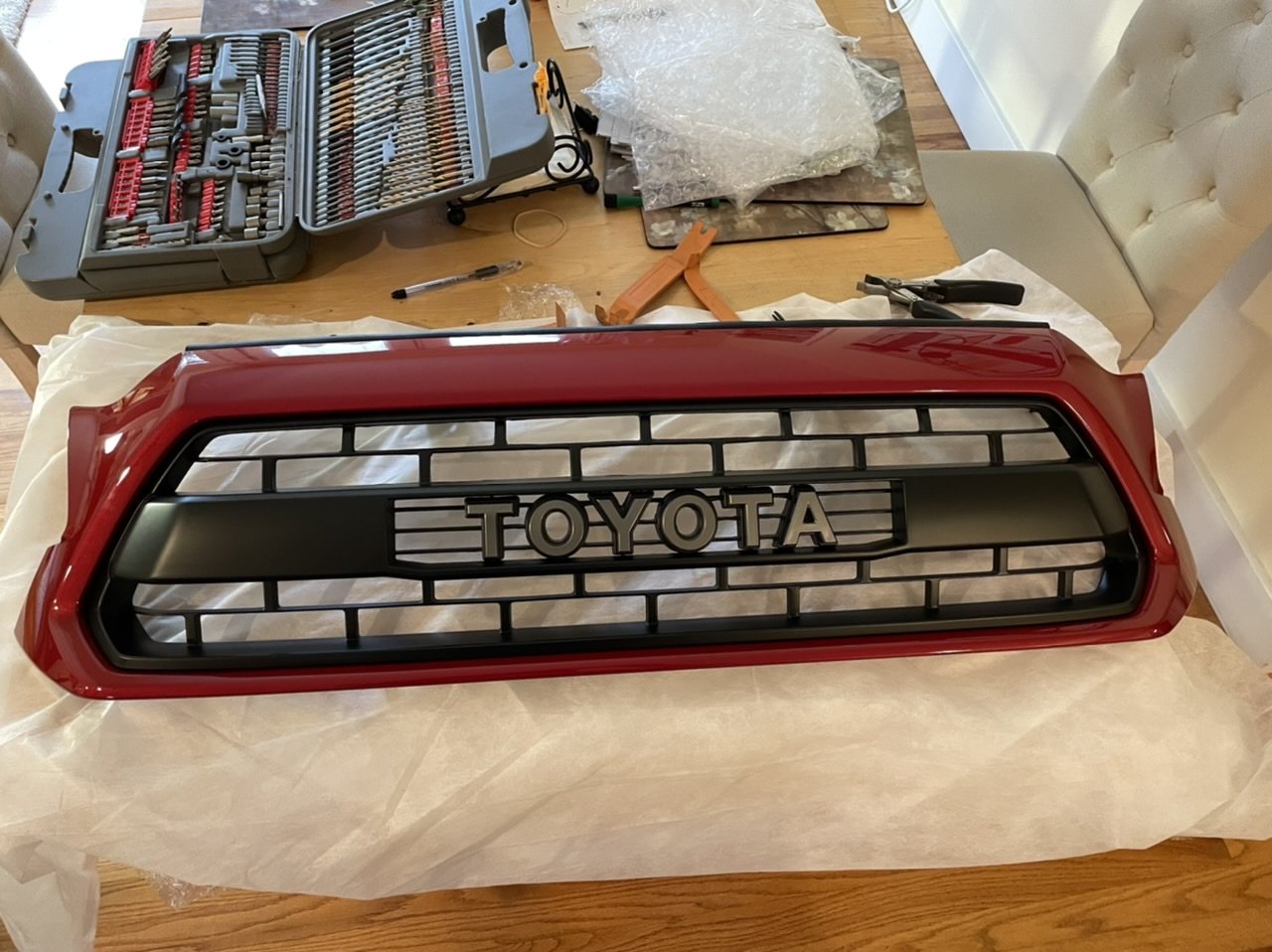

    Assembled the pro grille with a new painted surround. Going to wait until I have both pro headlights to install but very eager to de-chrome and de-sombrero the front.

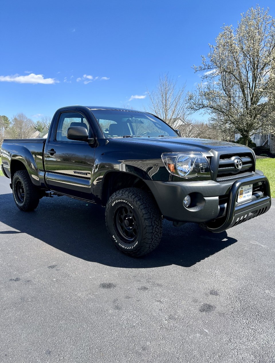

    Ready lift leveling kit, 235 75 15 BFG KO2 tires, KMC black alloys, black headlights, black fog lights, black grill, tonneau, new OEM recalled frame and suspension, emergency LED lighting package
    Update- I’ve had the 235 75 R15s BFG K02s and alum wheels on the truck for about 2 months now. It drives and handles so much better than it did with the stock 215s with steel wheels. I also installed a Pro Comp 2 3/4 leveling kit with the AAL option and replaced the shocks and struts with gas KYBs. The Ready Lift was on back order and I got tired of waiting. Very happy with the quality, fit, and finish of the Pro Comp lift. After some research, I utilized Pre Runner spec shocks for the rear to compensate for the lift and they worked out great. I think the speedo was a little fast to begin because GPS confirm it’s spot on. I am pretty sure the weight of this setup is about the same as the stock tires and steel wheels because the lighter aluminum wheels compensated for the heavier BFG K02s. I have an automatic which are geared lower then standard shift axels. It pulls and accelerates just fine with these mods. So, the key take away here for me is that it’s weight more than anything that zaps the power from base model 5 luggers IMO. upload_2022-4-3_19-26-0.jpg

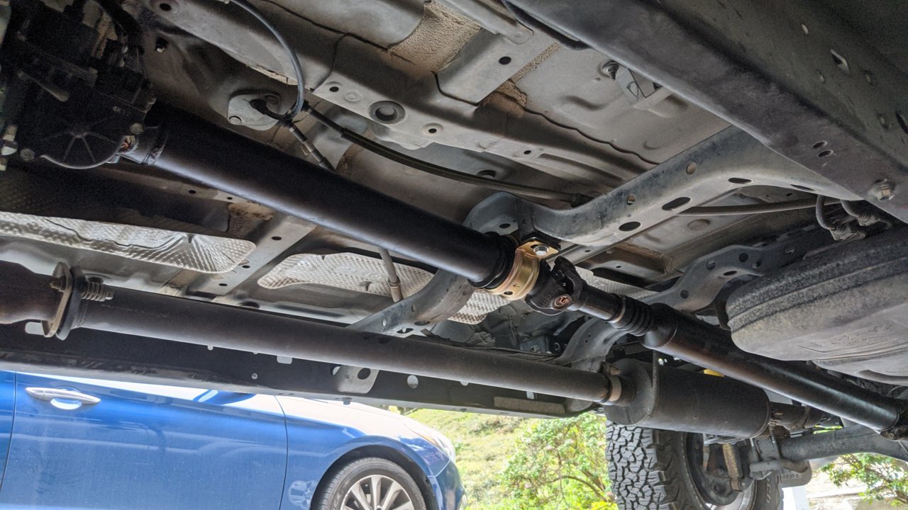

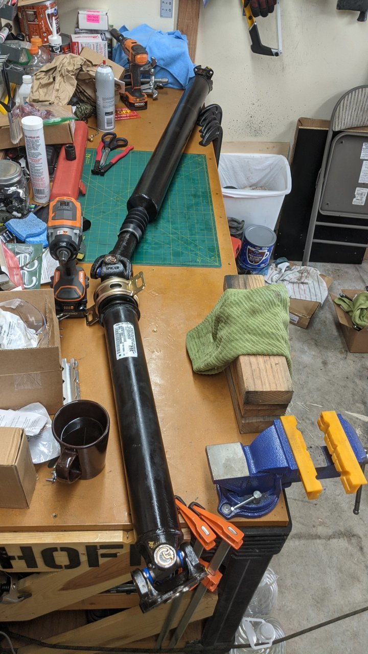

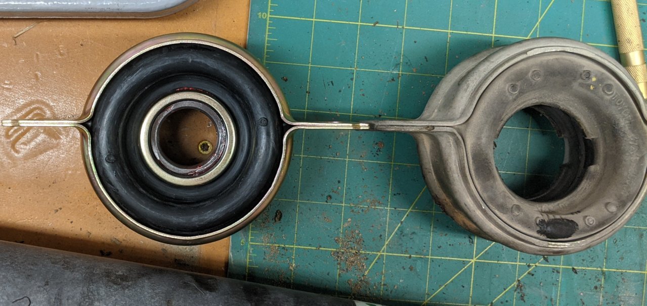

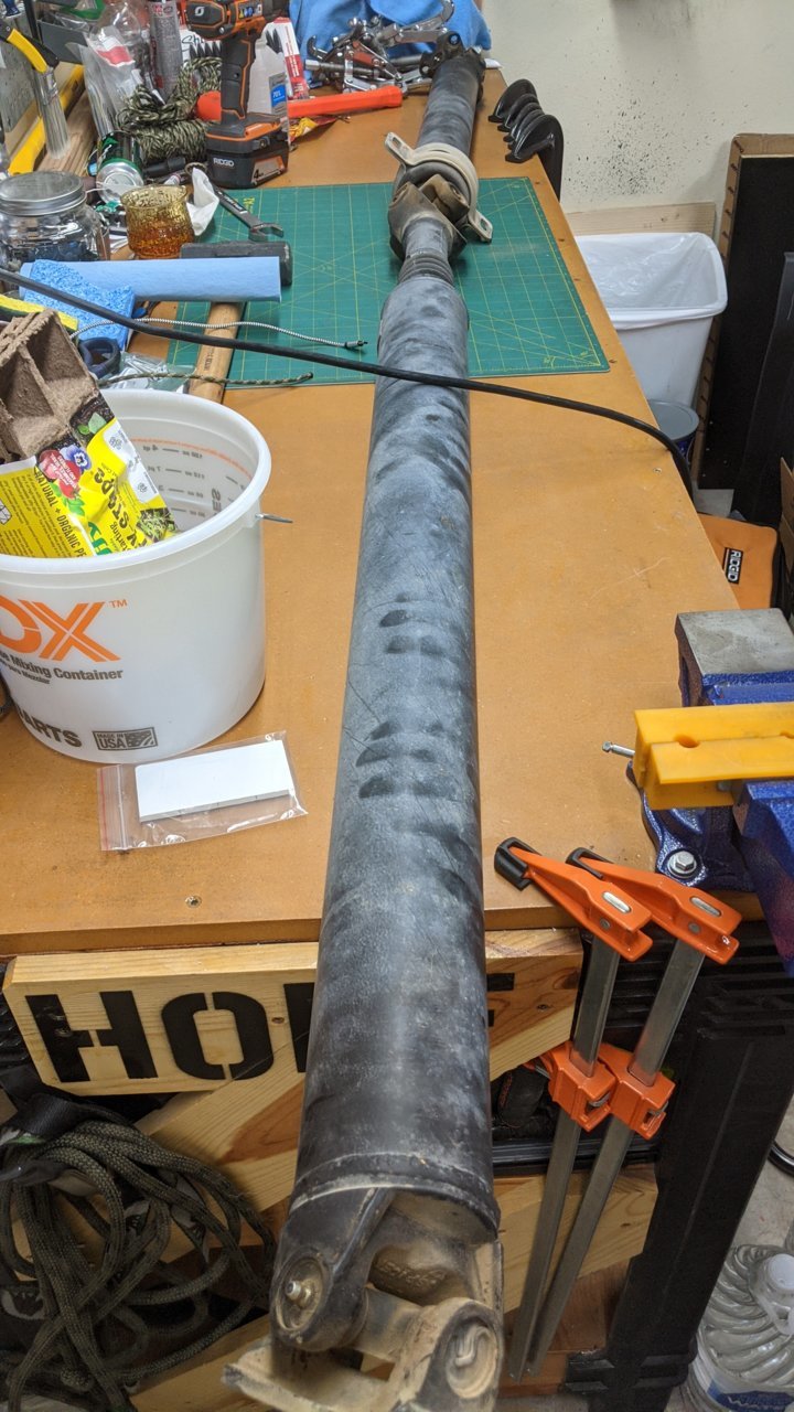

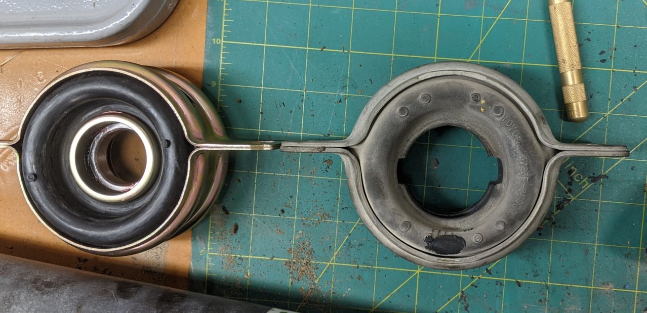

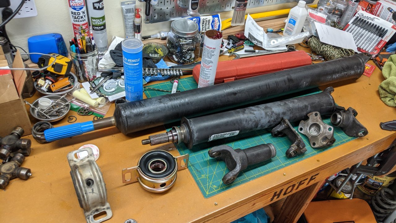

    I had a significant amount of play (maybe 1/2") in the carrier bearing (really the bushing) on my driveshaft, so I decided to replace it. And because I was going to be taking the driveshaft off to do it, I figured I would replace the u-joints at the same time. Once I got it off, I didn't like the way the slip yoke boot looked, so I ended up replacing that too and ended up refreshing the entire driveshaft. For reference, the truck is at 84k and is wheeled (moderate) fairly regularly.
    U-joints and boot are Spicer, while the bearing is SKF (hopefully it holes up as well as stock, we'll see).
    Before:
    Old and New bearing (can definitely see how much the old bushing was sagging here by how off-center it is):
    Disassembled:
    Reassembled and installed:

    Surprised you didn't go the Ford poly IEDLS carrier route
    I wonder how hard this is to DIY
    So far I've got:
    -press with limited dowels/sleeves
    -U-joint clip pliers, not sure if the u-joints can be re-used at 160k, though I grease them periodically
    -hammer
    -can borrow a puller, maybe should buy 1 or two of my own
    -whiteout to mark locations of everything to re-assemble aligned how it came apart
    IIRC supposedly there's not much more to it than that according to the how-to write up
    watched someone put U-joints on a 3g 4runner a while ago and it didn't seem as impossible "you must take it to a driveline shop for $200-300" as some people make it out to be

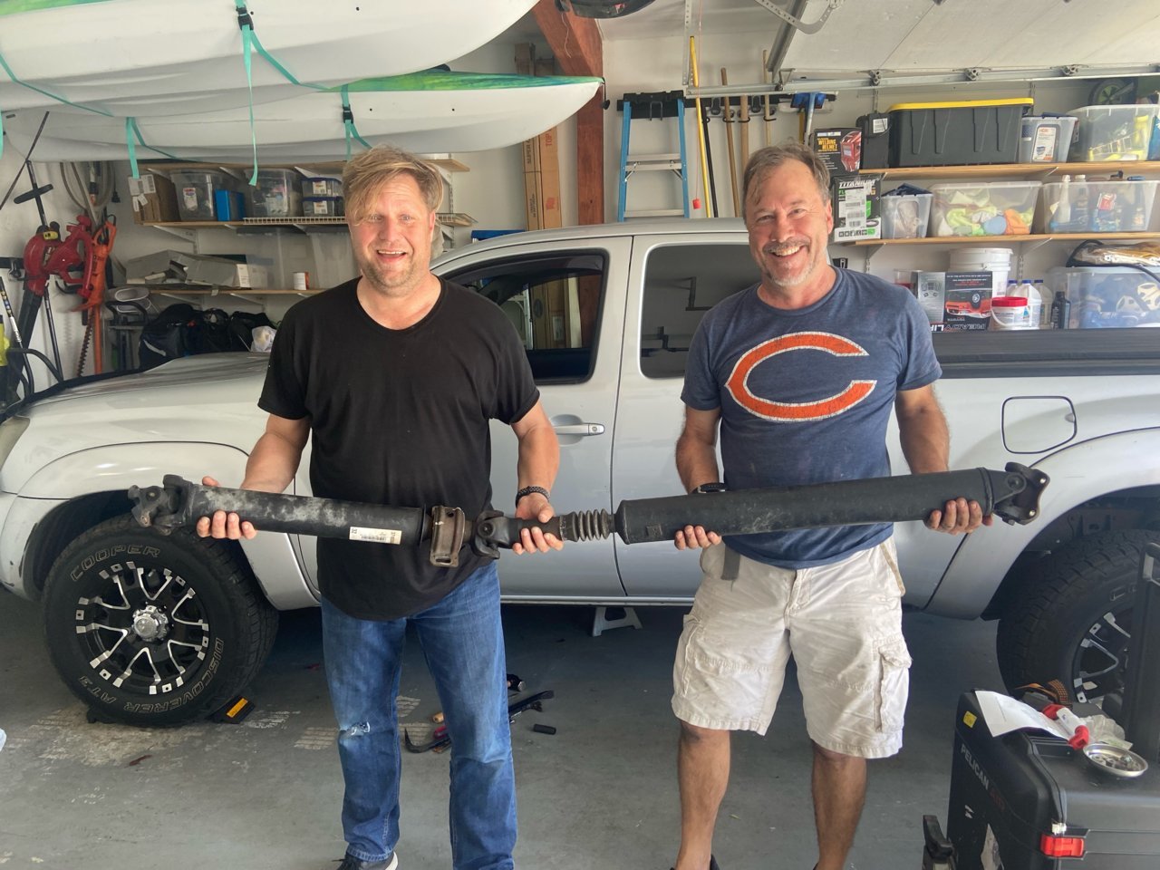

    My buddy and I just did this on my 2006 TRD Sport 4 WD. Its totally doable, and having done it I can give a short cheat sheet.
    1. Use paint to mark the flanges. Penetrating lubricant will dissolve magic markers. Take a picture of the whole drive shaft in advance to reference in case you have any doubts about the alignment when reassembling with the new U-joints. This photo below was very helpful when we had doubts after some of my marks dissolved
    2. A butane torch is key for heating up the bolts to crack them
    3. You absolutely will need some wobble extensions (Harbor Freight) and short sockets (14mm) because of the tight fit. (U-joint socket extenders are too long. Trust me, wobble extensions are essential). We found 3/8 inch drives worked best for the most part, except the initial breaker bar to crack the bolts, and the torque wrench tightening at the end, when we used 1/2 inch drives.
    4. A ball joint press with a standard variable speed impact wrench is way faster than hammering. They are a free rental at the auto parts store). We used a borrowed heavy duty, corded impact wrench and it was too powerful, we busted one of the new U-joints. A standard variable speed one is all you need and gives you the subtlety to line up the caps underneath the channels for the clips.
    Here are some excellent videos to brief yourself before you start:
    https://www.youtube.com/watch?v=5gOeBE-ylQw&t=1182s
    https://www.youtube.com/watch?v=6WvlVa7OzS8&t=642s
    https://www.youtube.com/watch?v=IF9--WmZOYo

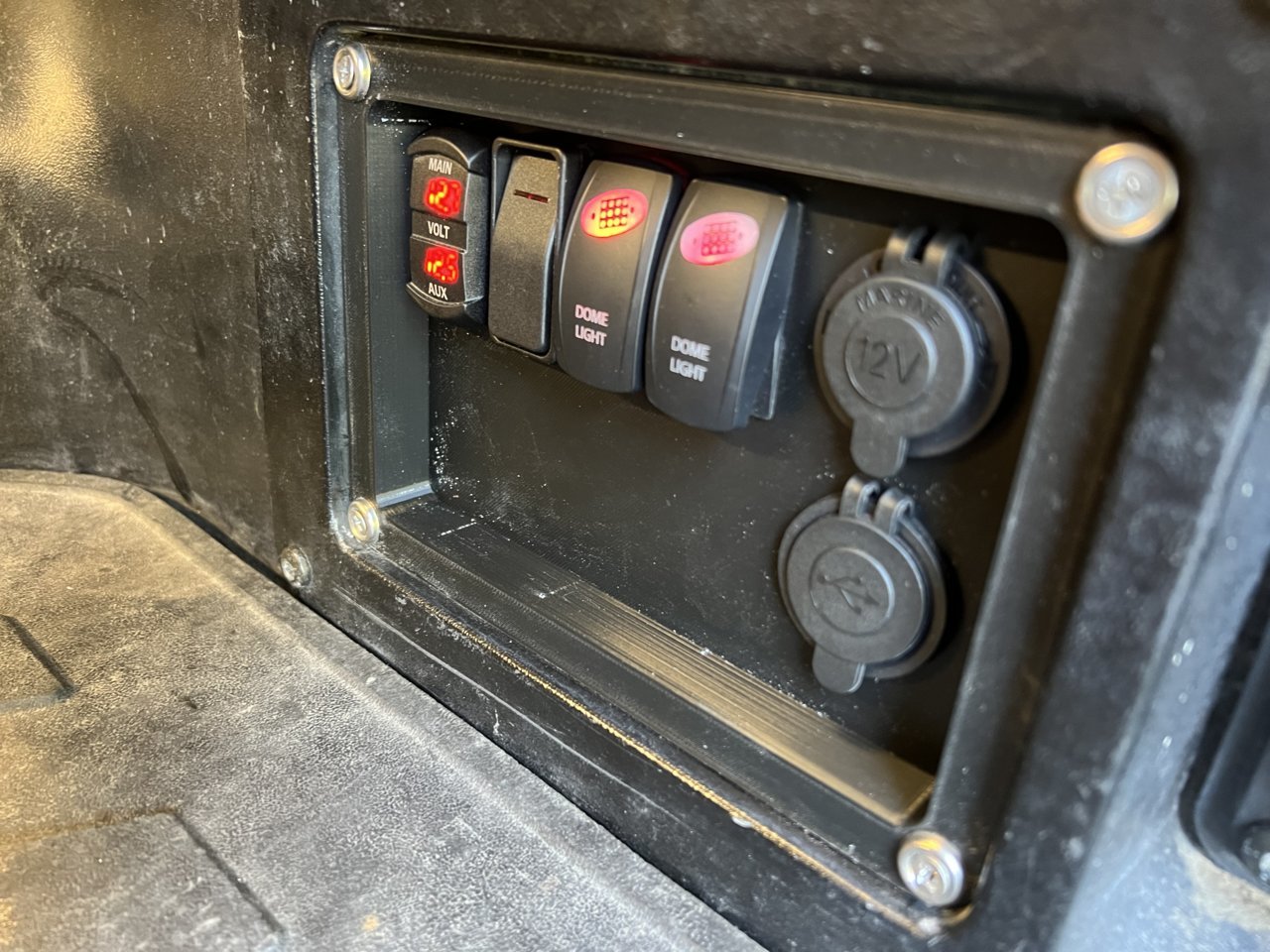

    Added a 12v set up in the bed so I can plug in some lights for the rooftop tent. The 12v outlet, USB, and voltmeter setup was only around $15 on Amazon and ended up fitting the bed storage door pretty well. Ran a wire from the battery and used a T tap to ground to the tail light ground.

    I just did this same thing. I was worried about the button getting mashed by stuff in the bed so I 3d printed a recessed cover...
