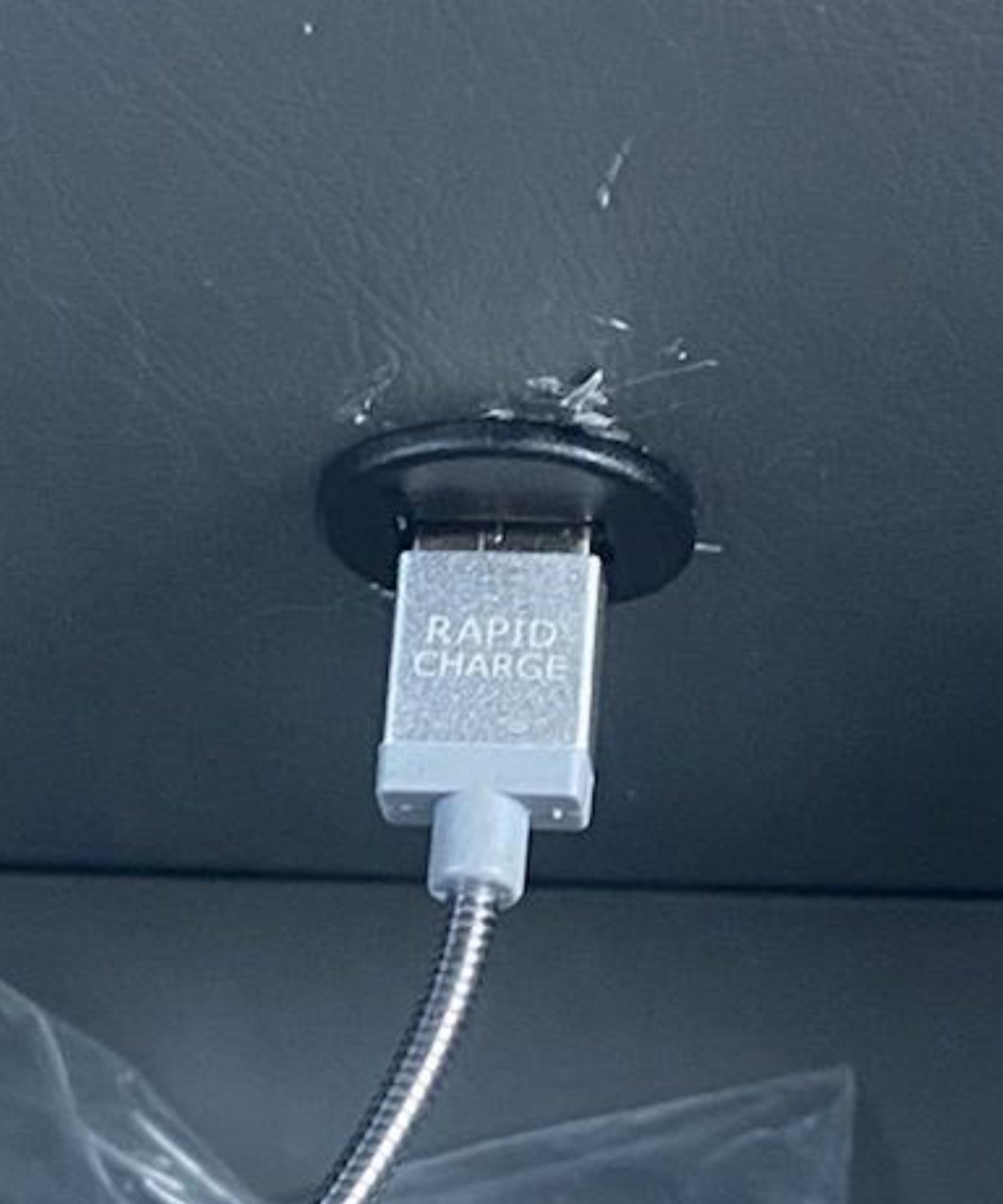

    the only bit I had that for the plug would not fit with the drill and bit had to go on a weird angle, so it came out rough. I can’t see it sitting down so it didn’t bother me. I had to take the picture on a weird angle to even get the Jack in the picture. The stereo comes with hanging USB’s I added the flush kit.
    I’ll be honest I never really looked that close……looks like a pice of plastic slag I could just trim off if I care to……..

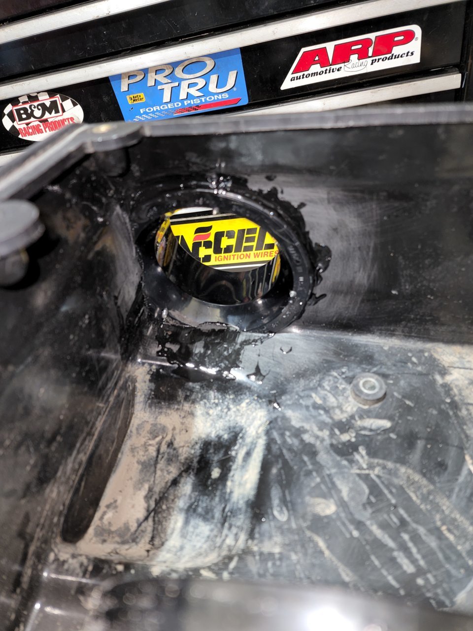

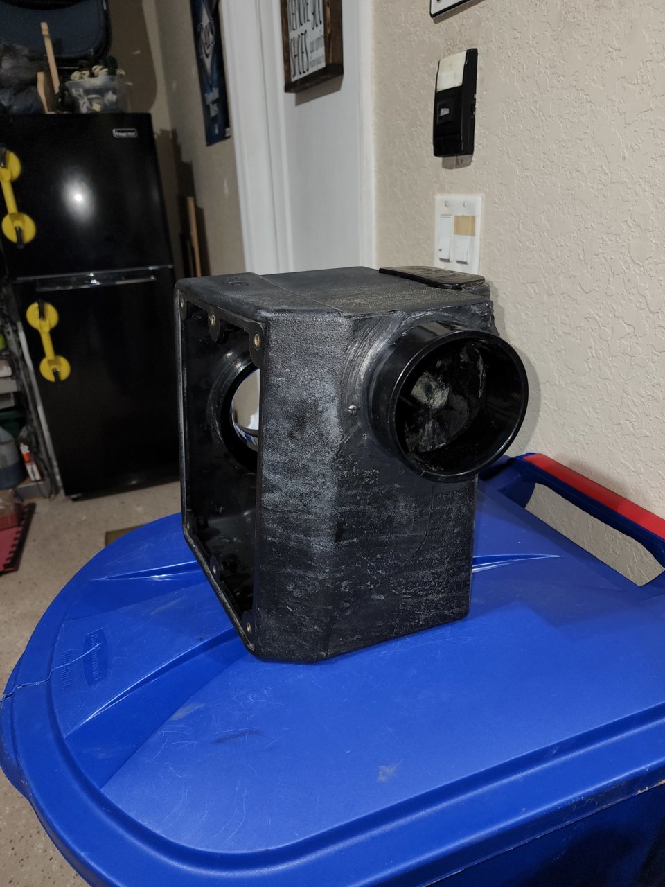

    Hit some trails last weekend and some water got into the Afe air box. Didn't like the idea of a snorkel but had to get one. Problem was how do I adapt the snorkel to the Afe box with the intake being oval. Someone on here cut the oval down and used a 4" to 3" hose adapter but had sealing issues. I opted to use a 3" toilet flange. Cut out the oval entirely and adapted the flange to the air box with plastic adhesive and silicone sealant. Used screws to hold it in place while the adhesive dries.
