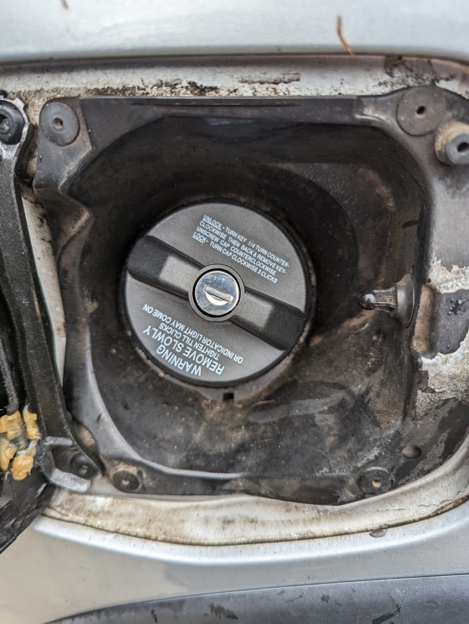

    I tried one of those, caused a warning light on the dash, ("trac off" of something like that). Put the OEM cap back on and after a week or so the warning light went off. Have you had this issue? If not where did you get your locking cap?

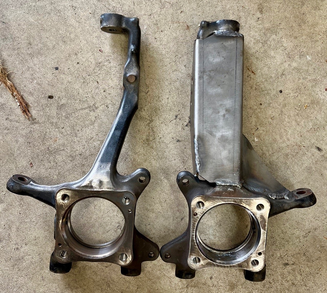

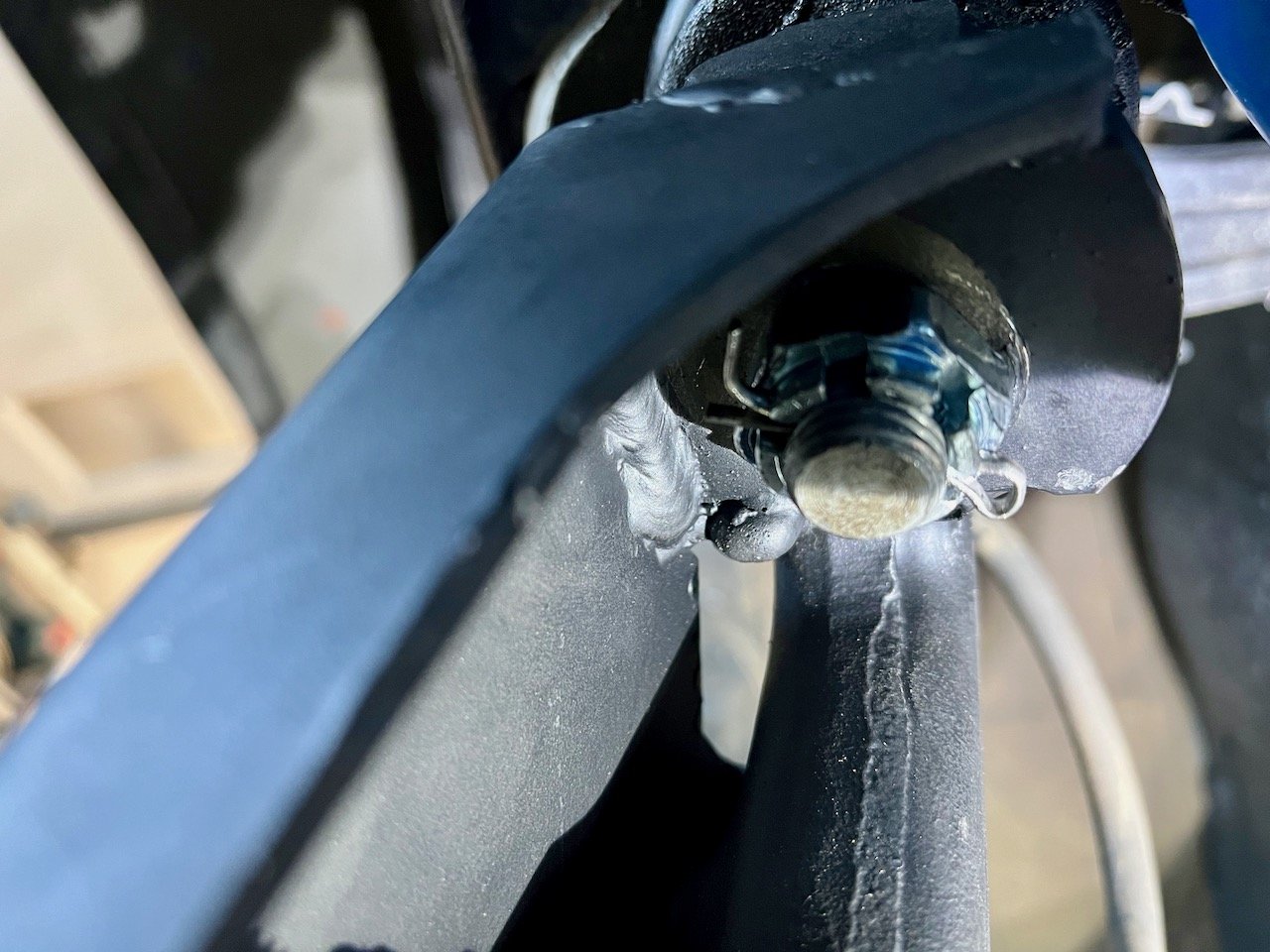

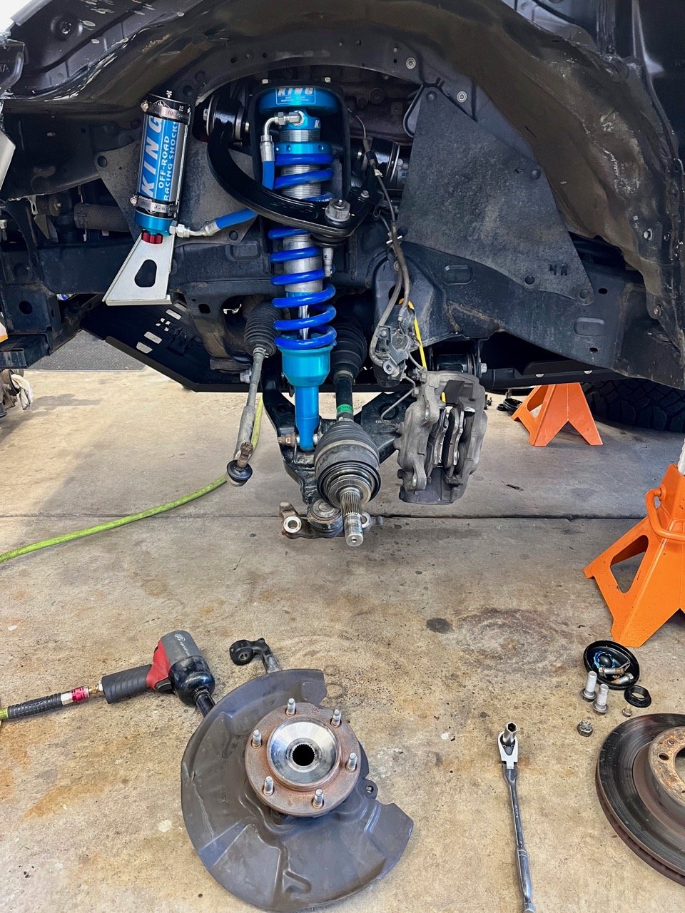

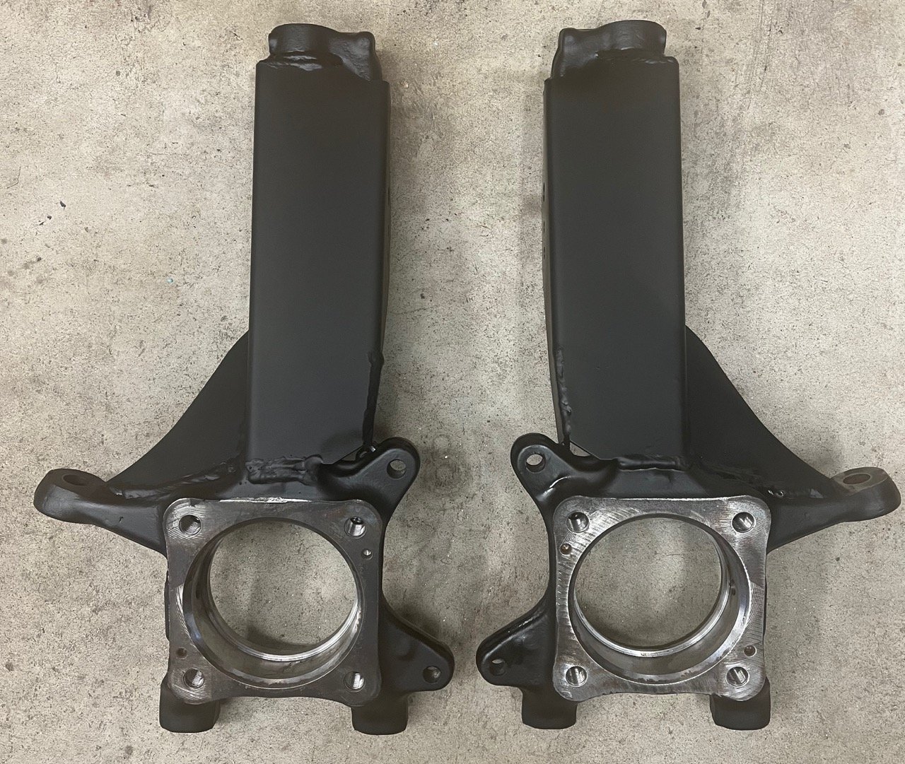

    Decided to finally install my Total Chaos spindle gussets. Started mid morning, will reinstall tomorrow. I have a spare set of spindles, but I was not completely sure they were un-bent, After completely removing my set I was able to compare and they seem perfect. The angle of the upper ball joint side is the same as the ones I removed. Those will stay as spares, hopefully I never need them.
    My welds are not the greatest, but should be strong enough for me.

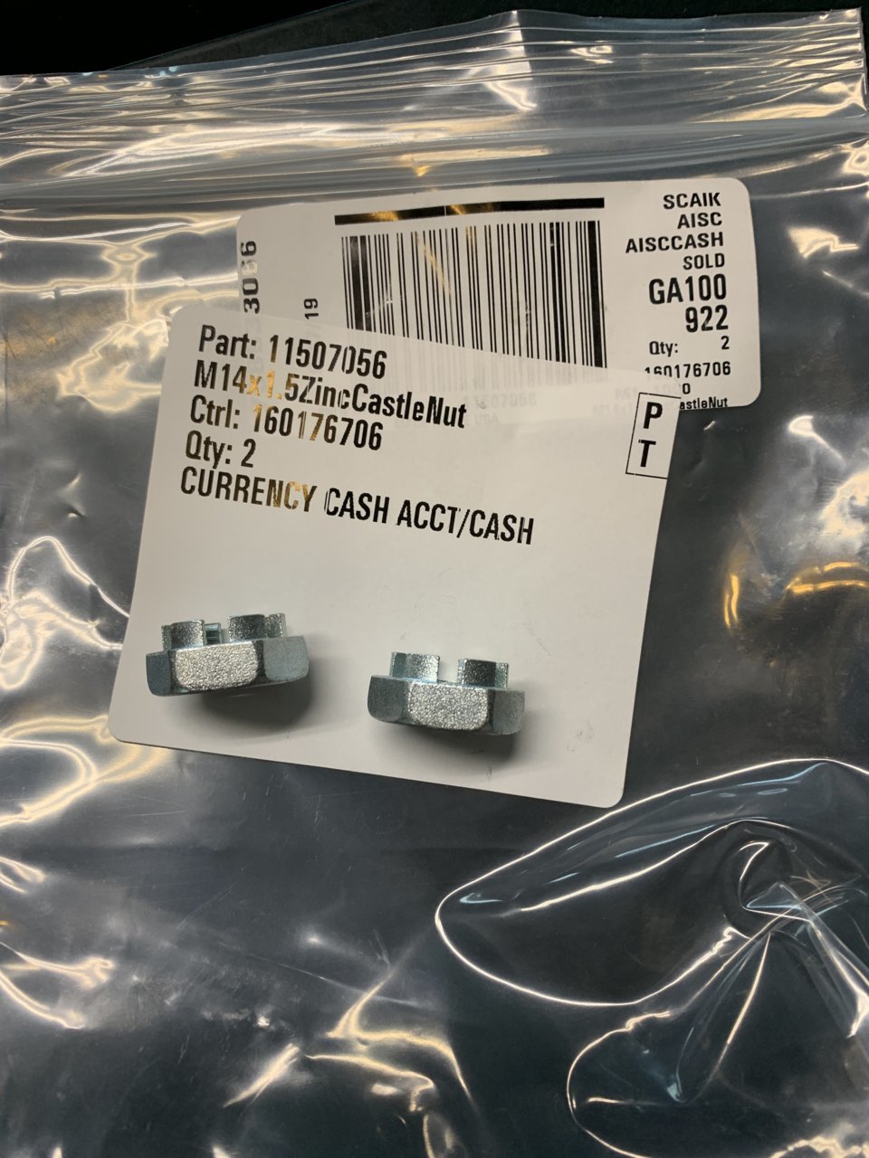

    FUN FACT: the spacers at the top of the ball joint make it so the castle nuts no longer line up at all. Turns out you can get low profile nuts from fastenal.
    https://www.tacomaworld.com/threads/total-chaos-gusseted-spindles.379567/page-28#post-21585691
    Fastenal part number 11507056
    Edit#2 - Short nuts FTW! - not super thrilled it's just zinc plated and not Geomet or some other superior anti-corrosion technique.

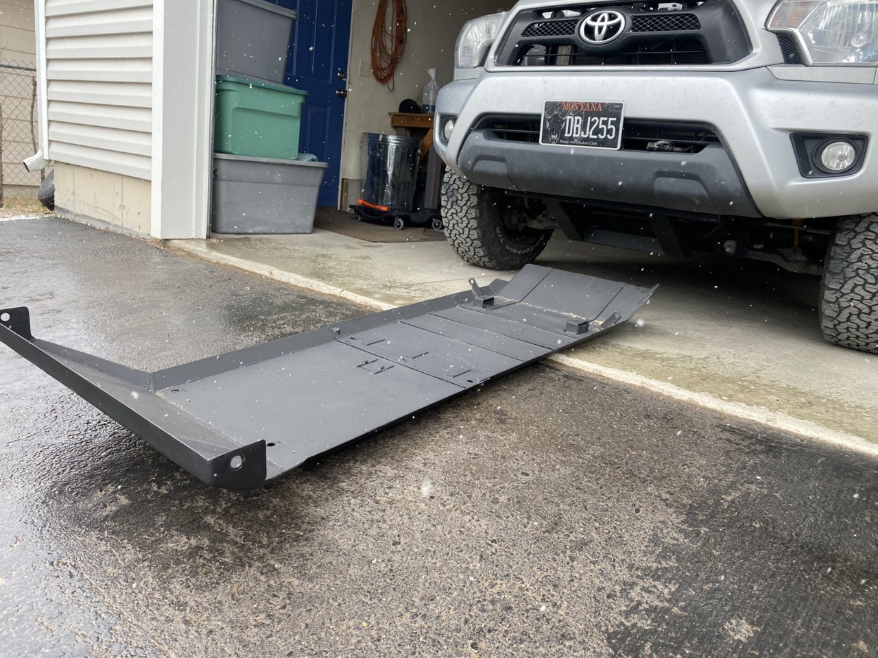

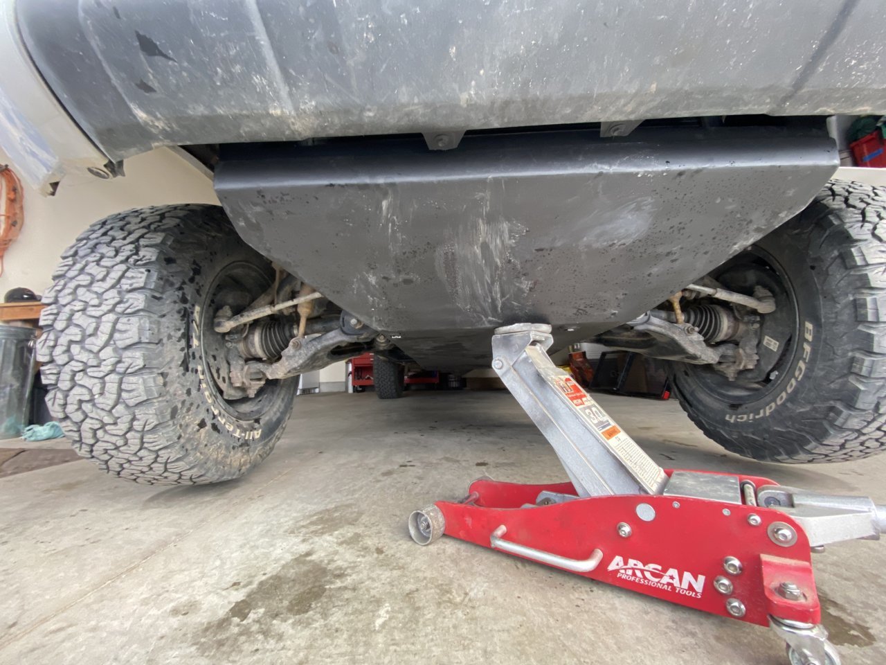

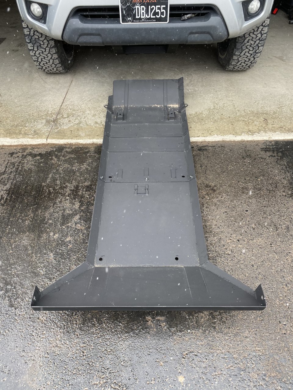

    7089FD20-6FD9-4C04-A20A-CA55F806DB57.jpg 1A432474-1AD0-4FB8-9D52-1733B8CA9565.jpg BBEB09CE-2A18-459D-9A10-32E07AE3484B.jpg Finished the skid plate last week but had to pull it off today so I figured I’d take some pictures to share with y’all.
    I had a little maintenance day for my 110k anniversary. I greased my driveline, replaced the brake/ clutch fluid and engine coolant.
    A few week’s ago I did both the diffs, TC, and manual transmission. So I shouldn’t have to touch the skid for another 100k except for the oil drain access door.
    The ribbed 10ga is pretty strong. As you can see here, I lifted the whole front end underneath the frame that I welded.
    I noticed a gash on my fuel tank so you can guess what’s coming next… :thumbsup:

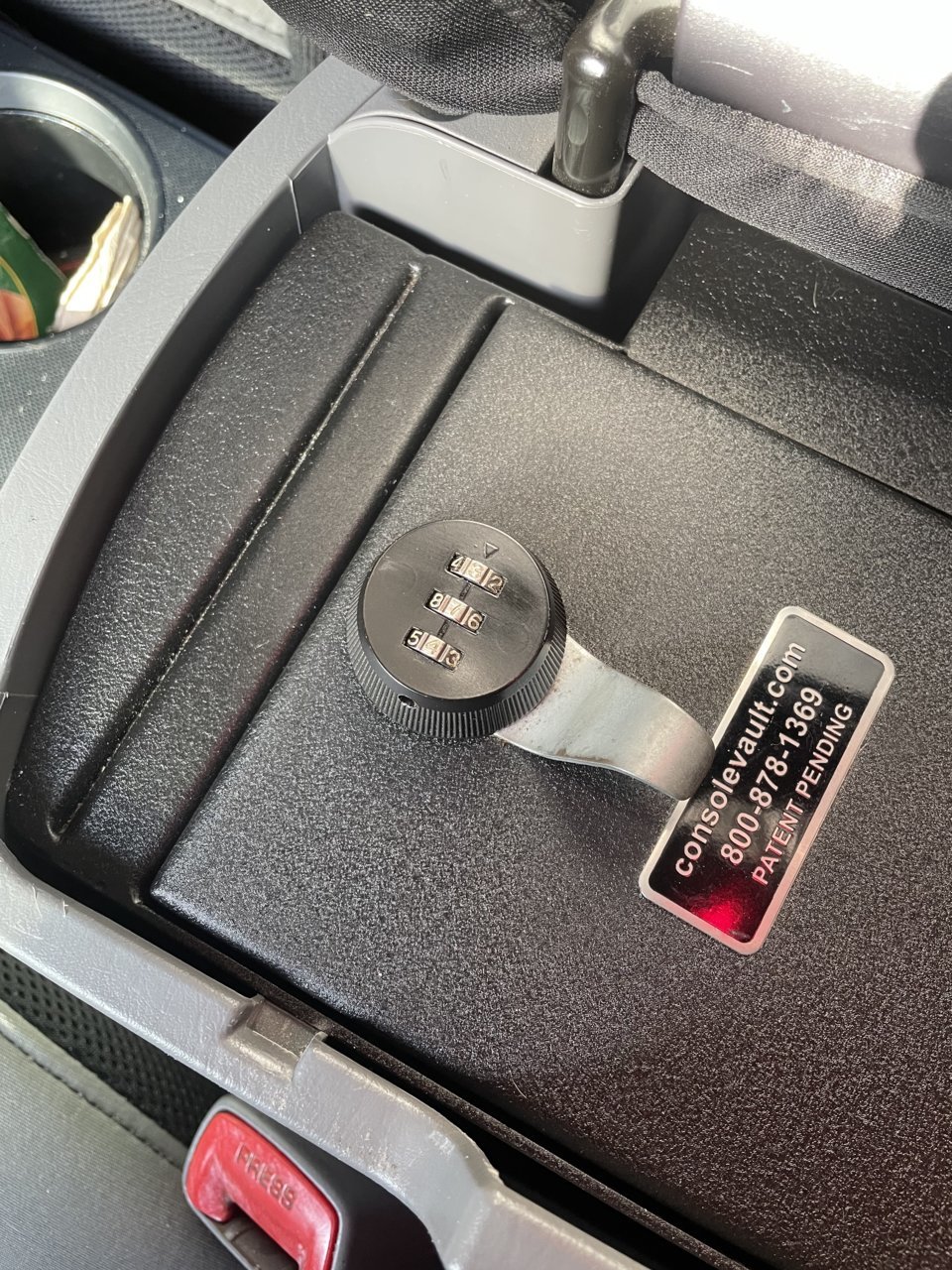

    Where'd you pick that up? I've been looking for a good 4 digit lock.

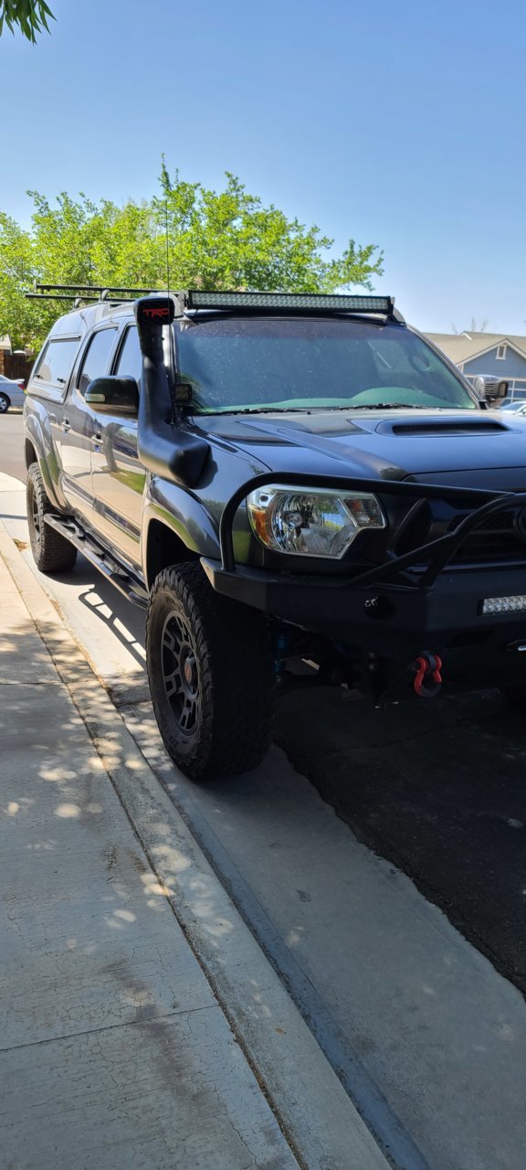

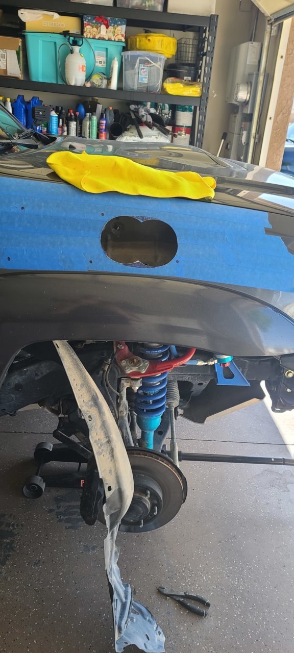

    Woke up this morning and the Easter Bunny surprised me with a snorkel! He does pretty clean work, would recommend.

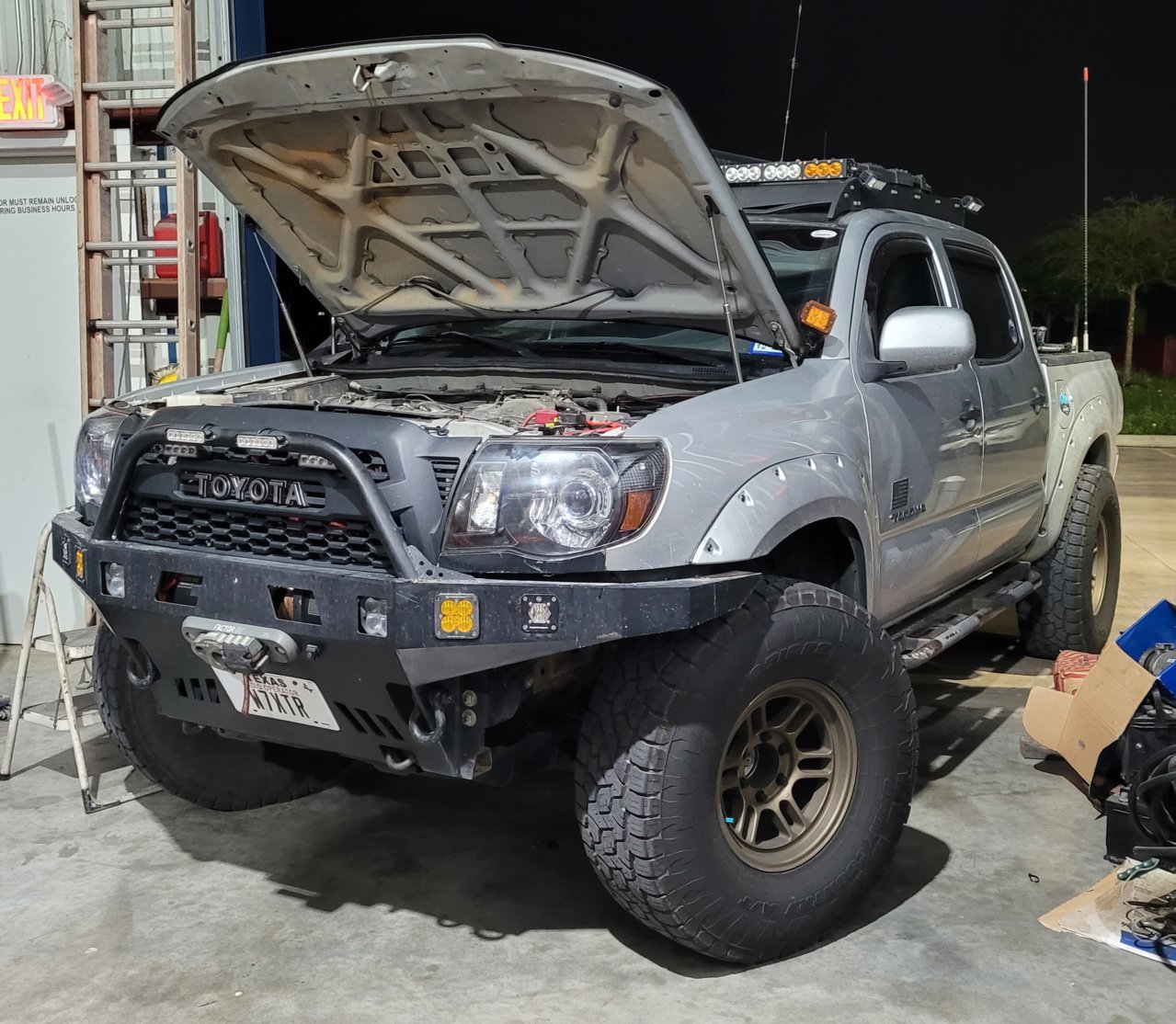

    Finally installed some redline hood struts, I open my hood almost daily to tinker so it's a worthwhile investment. Also replaced the upper ball joints due to alot of play, handling immensely improved.

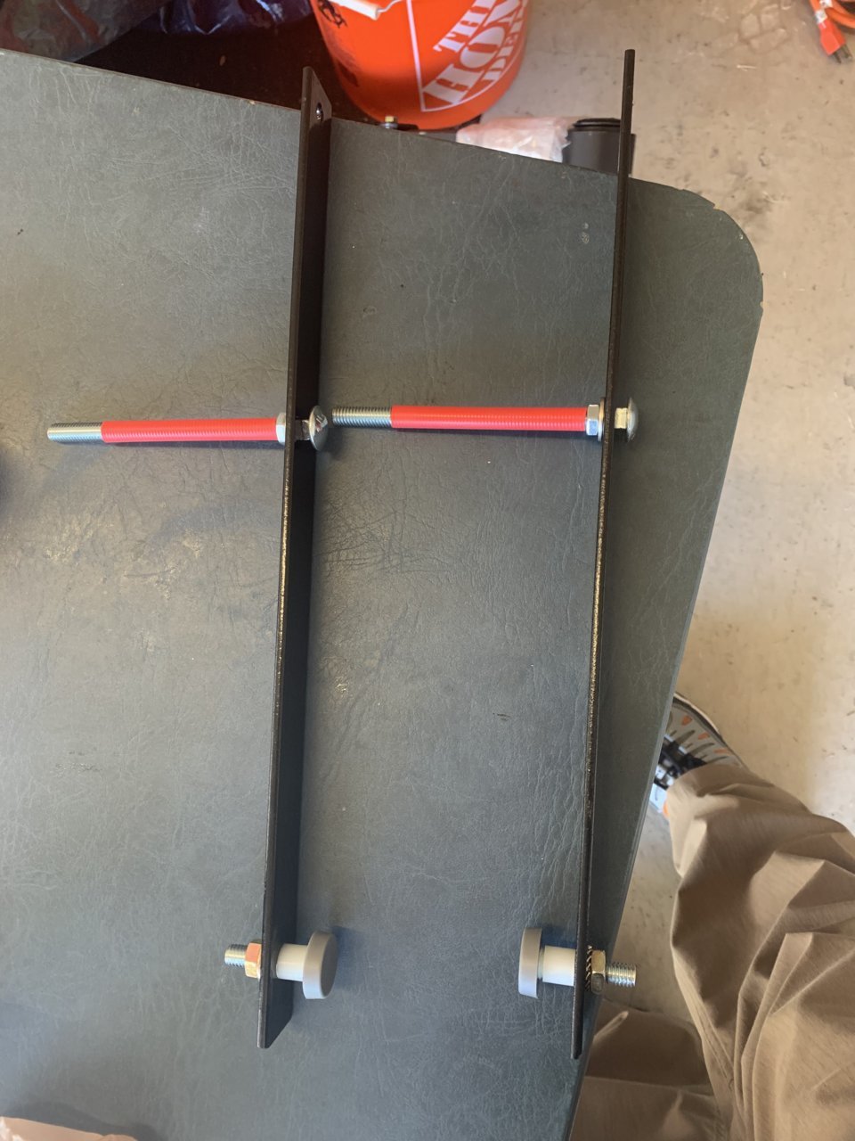

    Been working on a homemade setup for my traction boards to fit in the bed and under the bed cover. For less than $20 I think it turned out good.
    I used some T-bolts, to run threw the bed rails, a 1/4” thick piece of steel, some spacers, and carriage bolts etc etc.
