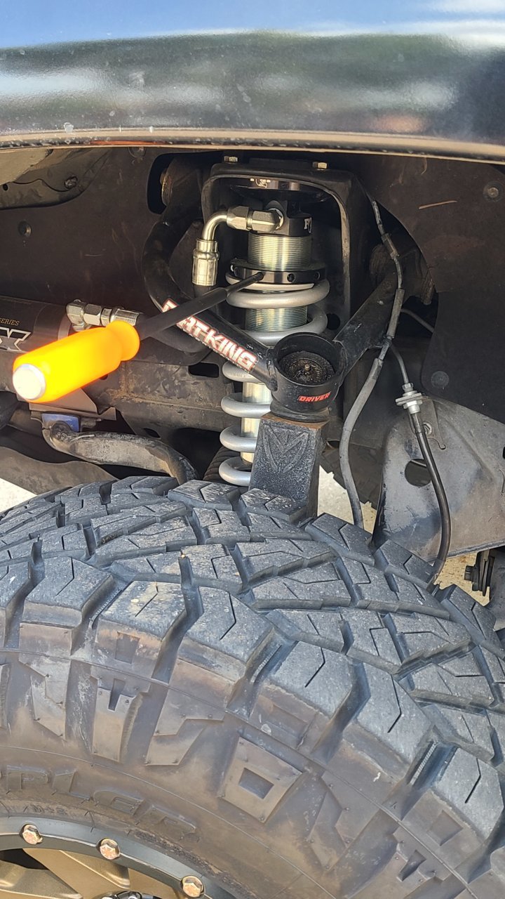

    Adjusted my coilovers for less preload and a somewhat factory style rake.
    Also crossed a milestone right after.

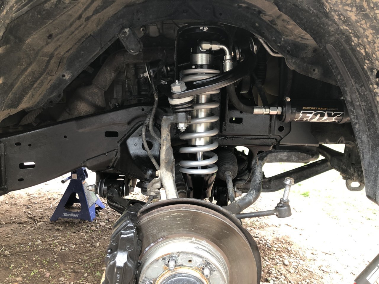

    POR-15 the frame
    New SPC Uppers
    New Fox Shocks
    New OEM LCA
    Long day... finished in the pouring rain.
    On to the rears, tomorrow.. weather permitting

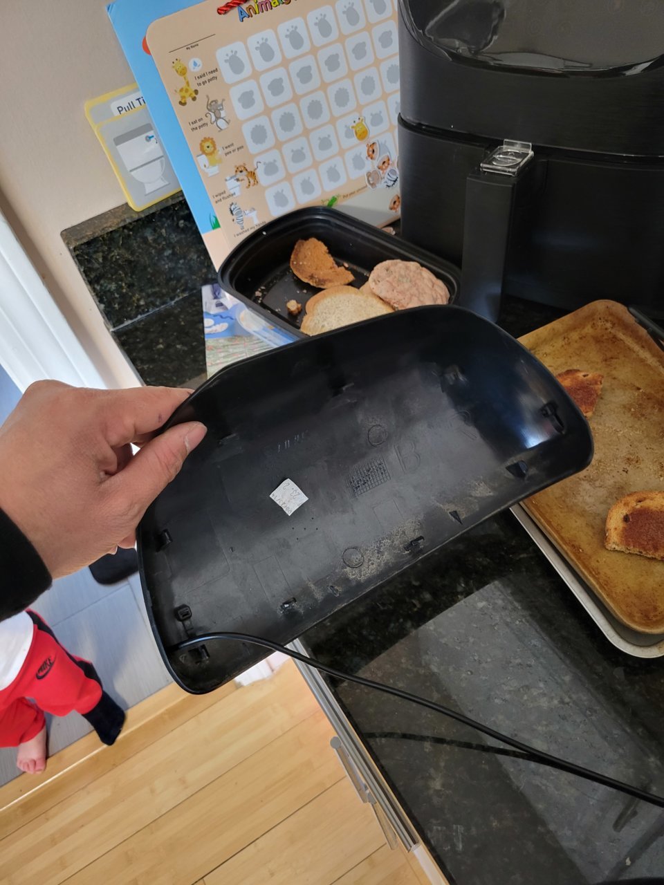

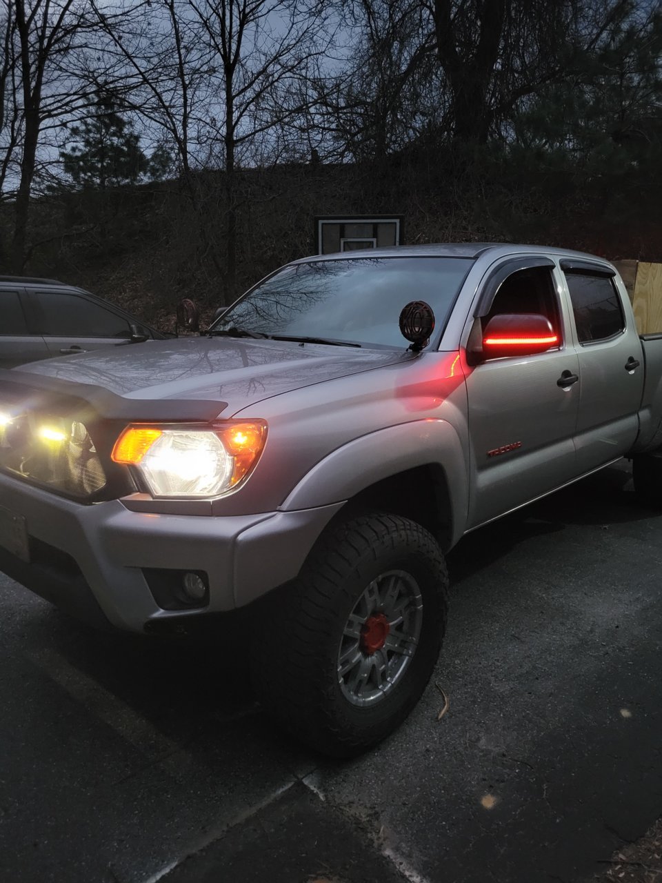

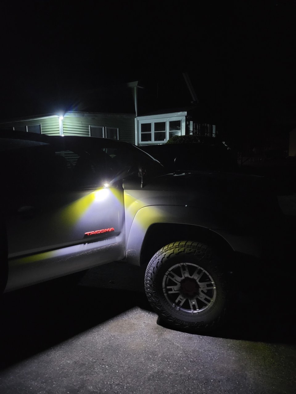

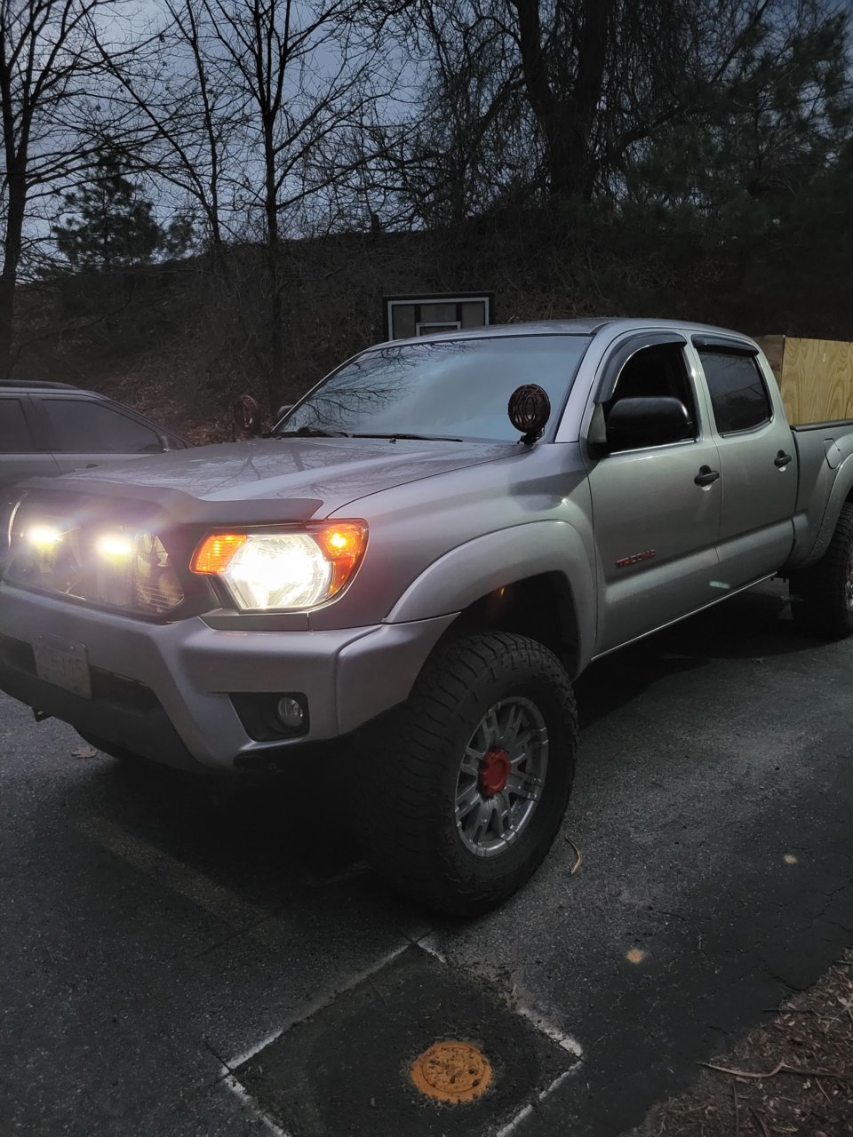

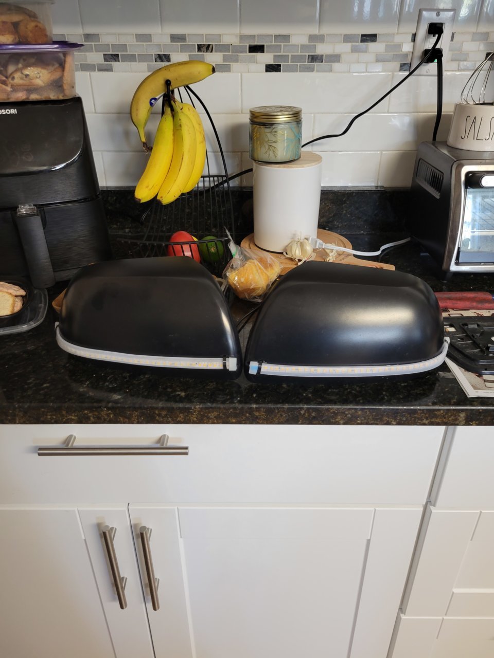

    Really wanted to do the puddle lights and mirror turn signals mod. The complete mirror assemblies for plug and play install were out of my price range. So I had to get a little crafty. Bought some led strips(they were supposed to be sequential but Amazonian screwed me and i didn't feel like returning). Grabbed some smaller led lights from wally world to use as puddle lights. Notched some holes in the bottoms of my factory mirrors to flush mount the puddle lights. Attached the strips to the front mirror caps and covered them in black vinyl wrap so they'd blend in a little better. Ran everything through the mirrors. Wired the strips to the pre wired power mirror harness in the door. Ran a constant power with in line fuse from the Battery to the puddle lights. Grabbed my ground for the puddle lights from the door switch so the lights come on when the doors open and shut off without a delay when they're closed. Also installed the Hikari h4s that were suggested to me. They're doing pretty good and I haven't been flashed yet.
    Side note. The turn signal strips have yellow and red diodes. I chose to wire up the red cause it shown through the black vinyl Better during the day. Just found out that in MA you can't have red front facing turn signals. IDK...hopefully I don't find that out the hard way...
