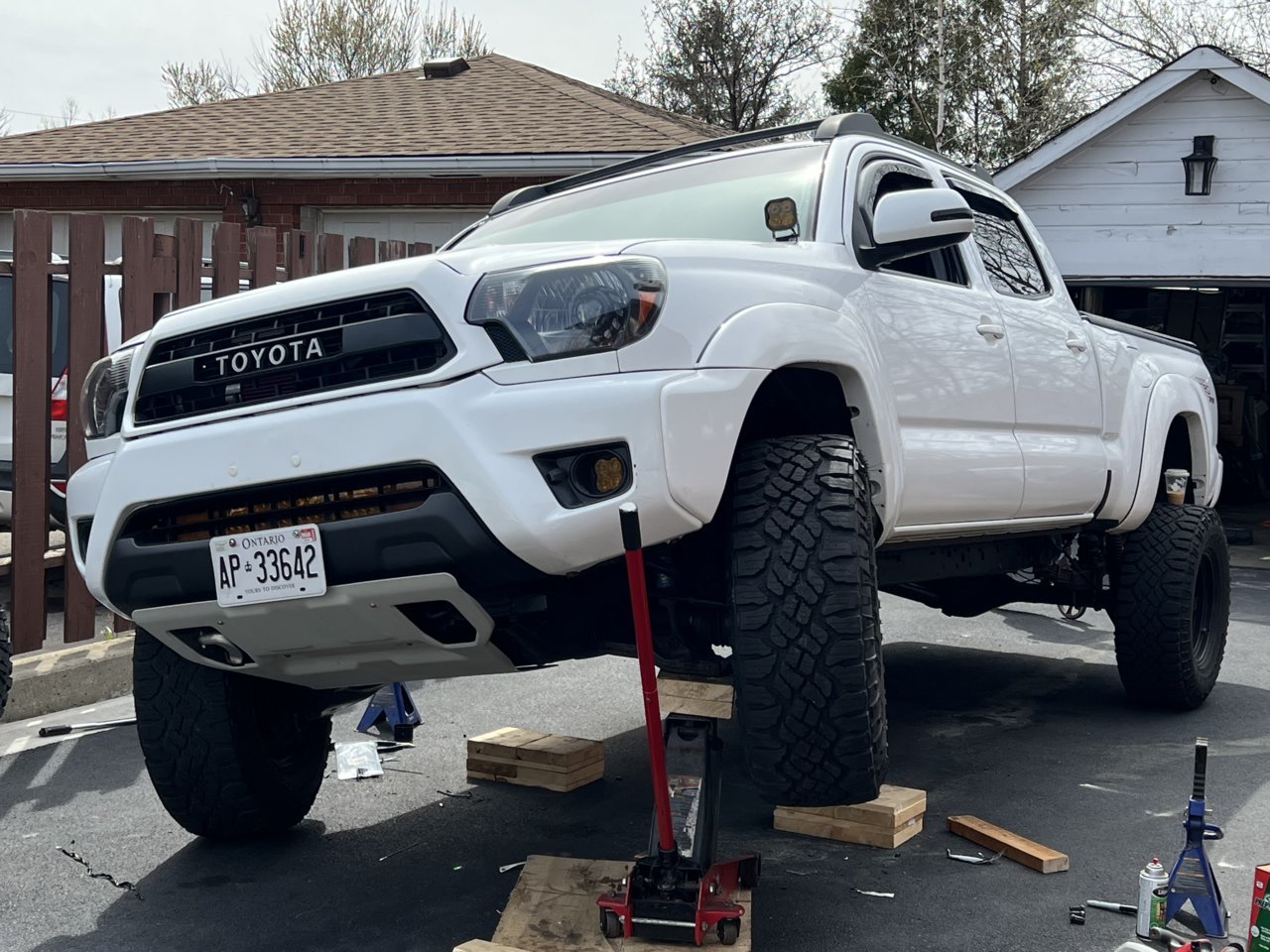

    It’s been confirmed.

    What about chafing? :eek:

    Is this picture, with the tire lifted?

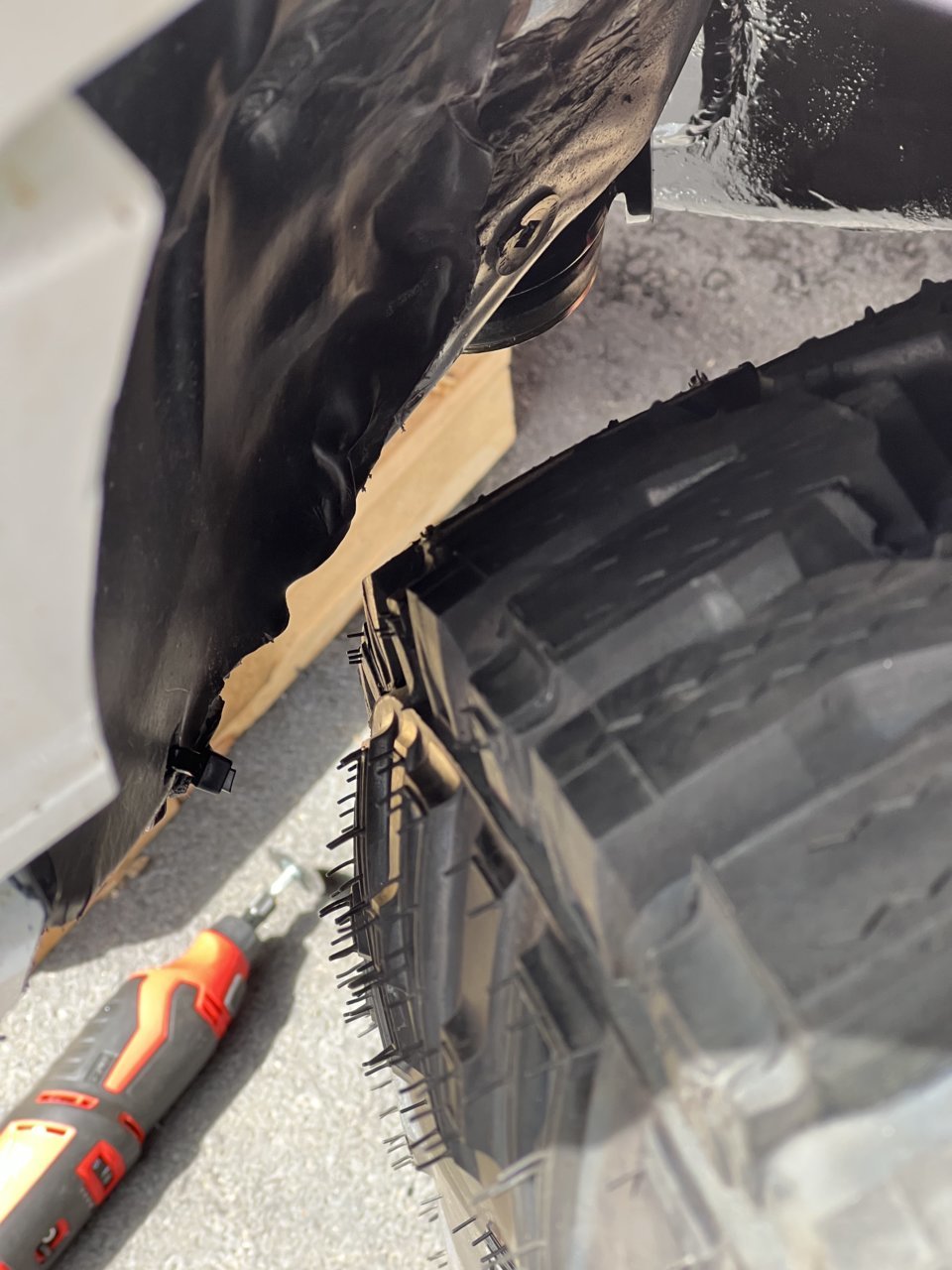

    2.5” lift (5100 on stock 9 year old coils) in the front, some cutting of the lower plastic/metal flare, pinch weld beat to the outside, cab relocated and 1” body lift helped big time. :) Hoping in a couple of weeks I’ll have my coilovers installed, should be sitting a bit higher in the front.

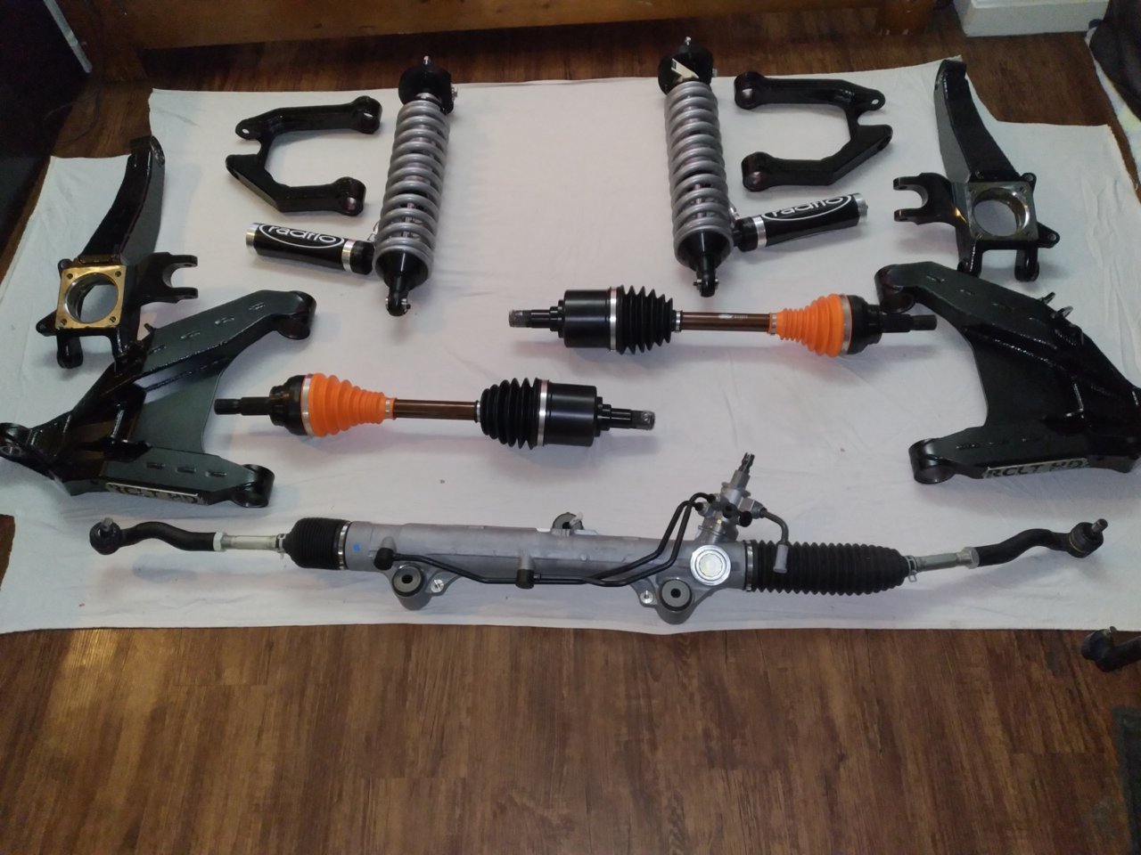

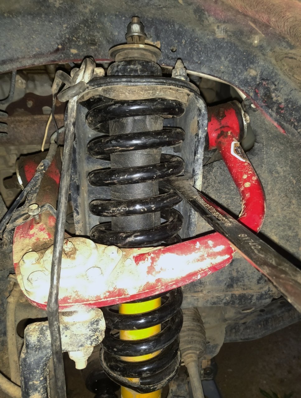

    Freaking dust boot popped off while installing lighter coils onto my old ome 9000s :confused:
    Had to pry it away from the upper mounting flange this time

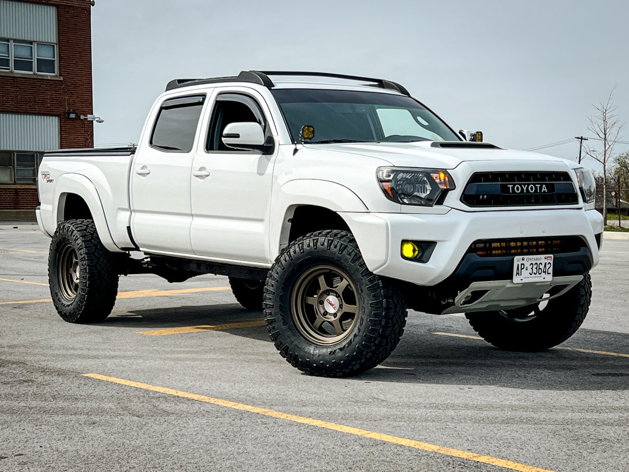

    Hah I read that in that dudes voice :rofl:
    Love the color combo, wheels and paint match up nicely :thumbsup:
