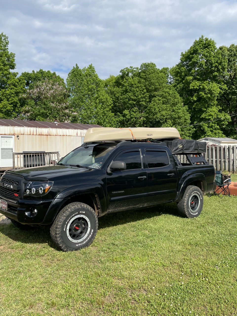

    Picked up a Lifetime Tamarack in great condition for $200! Anyone have experience loading two yaks onto the oem rack? If so, which kayak racks are you using and would you recommend them? Only thing I know to try is a set of the J style racks on each side of the oem rack. Just curious if there are any better ways. Thanks!

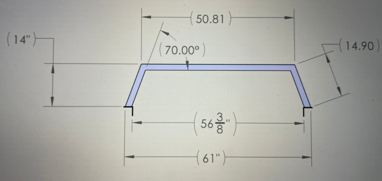

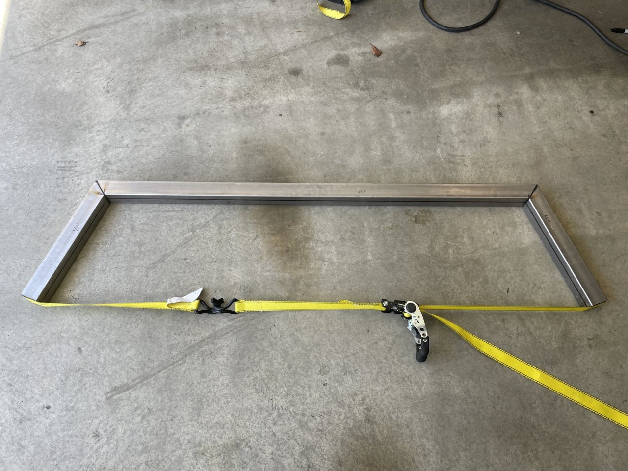

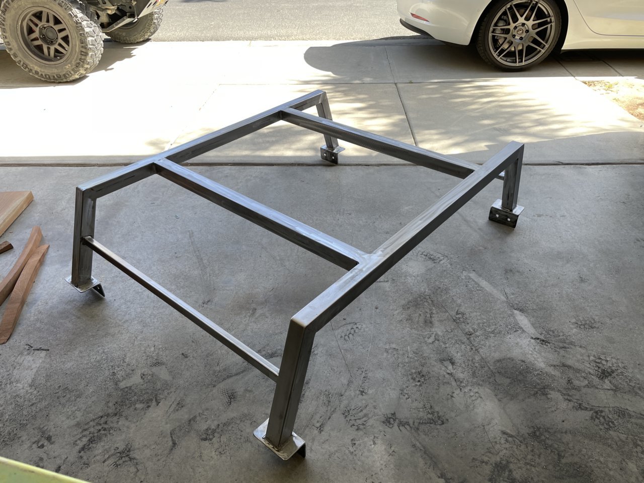

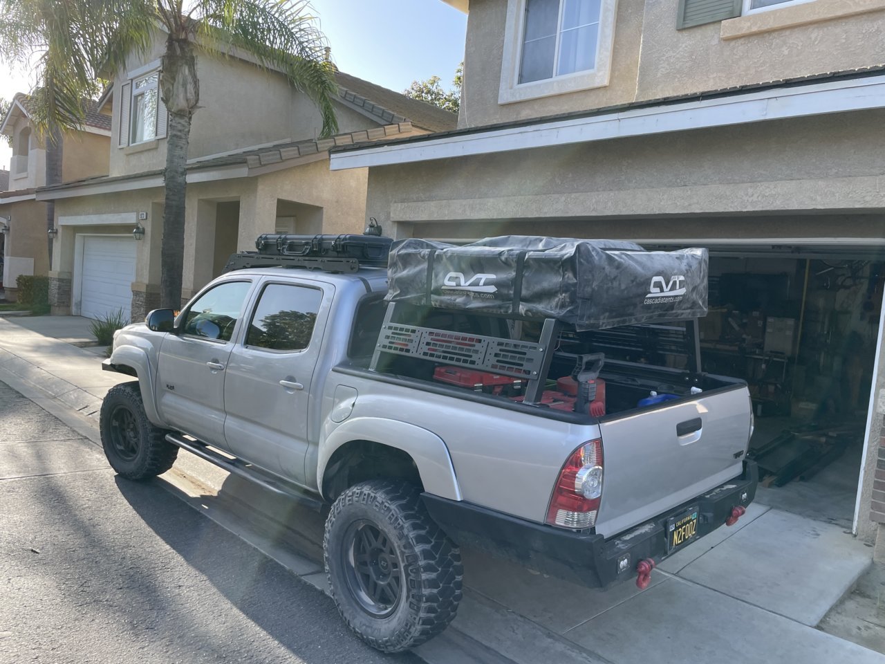

    I decided to make a new bed rack. I made my original rack 7" above the bed sides, it's been great for 3 years, but now I decided to double the height to approx 14".
    2" x 2" 14awg steel simply painted with Rustoleum Matte Black Hammered finish paint. The side panels are from Caliraised.
