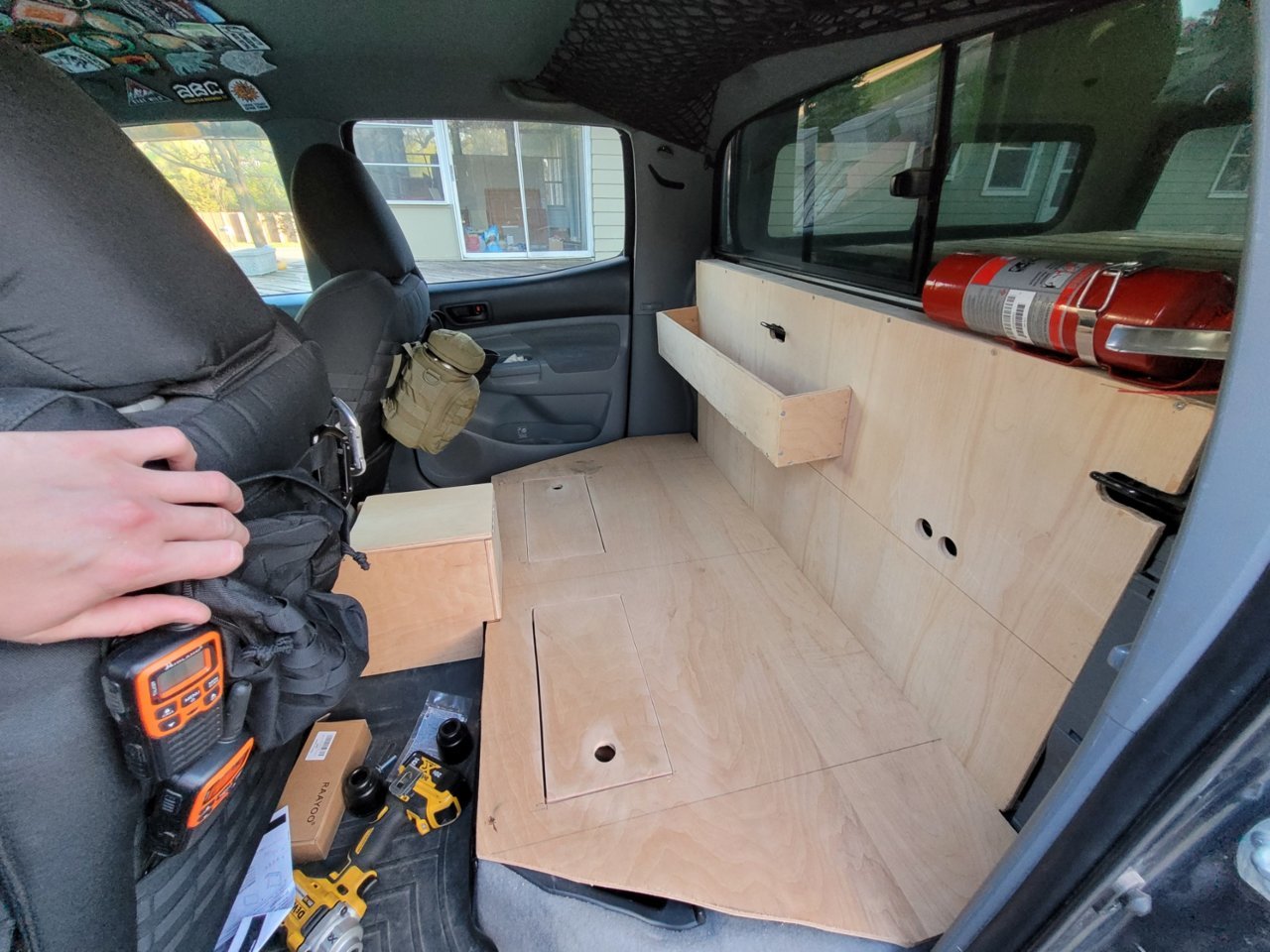

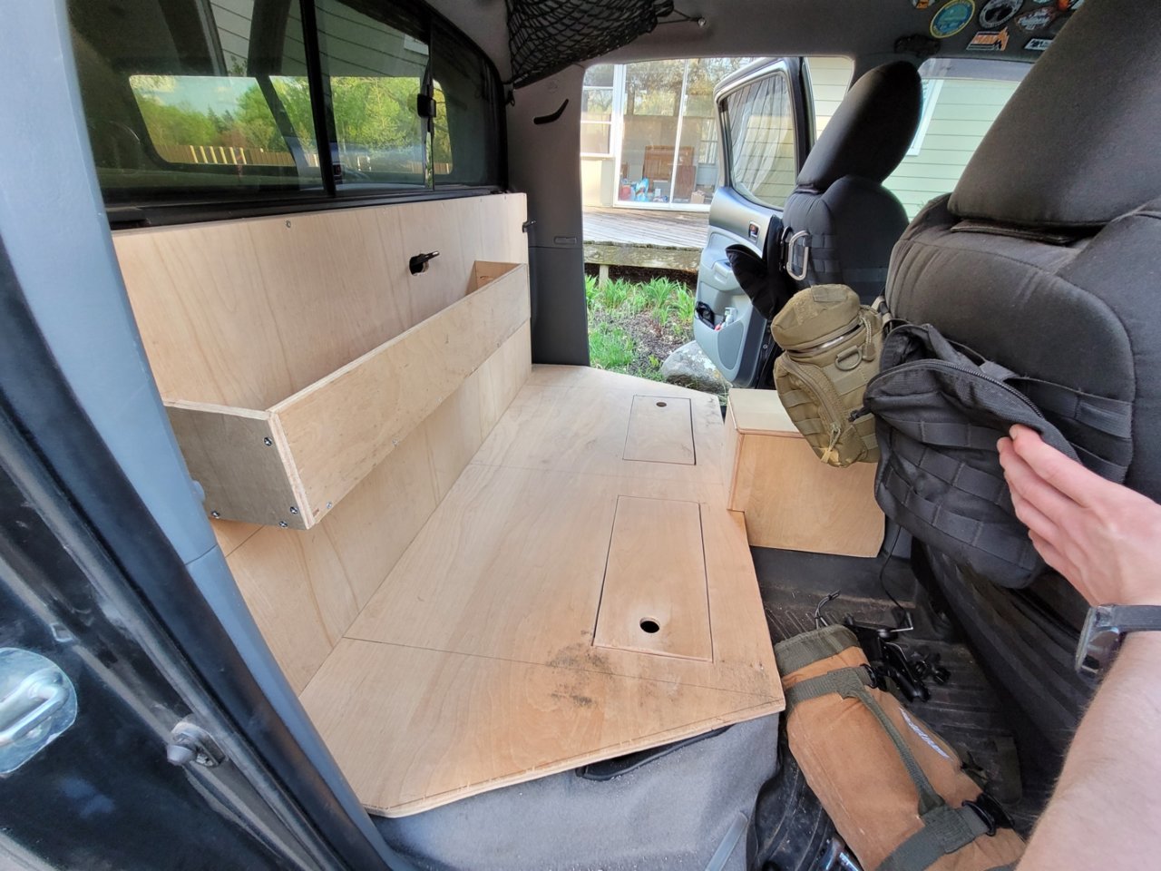

    And made good progress on my rear seat delete. Just need to add carpet this week and bolt it all down.
    Small box is a charging station for cameras, gopros, drone batteries and what ever else we want to put in there out of the way. Also will make it easier for our small doggo to make it from the back to the front.

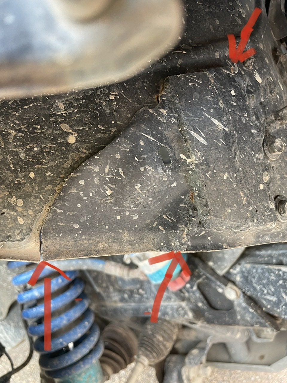

    Keep your eyes peeled for the core support cracking after this upgrade. There seems to be a correlation between this mod and core support issues.
    for example see the pic below on my truck, where a 6 crack already formed. A plate was welded over it and another 6 cracked formed and went around the plate. I have about 6 cracks in the core support these days. Chalk it up to those stiff bushings, a heavier battery, larger tires that had hit the inner fender some before I trimmed and hammered more, and thousands of miles of dirt.
    Just keep your eyes peeled.

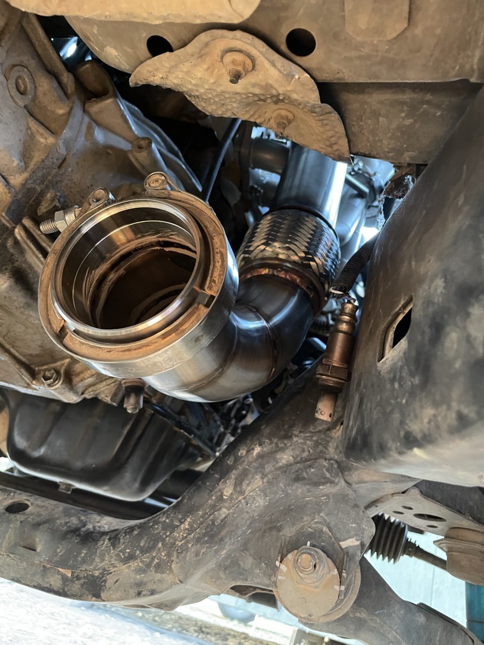

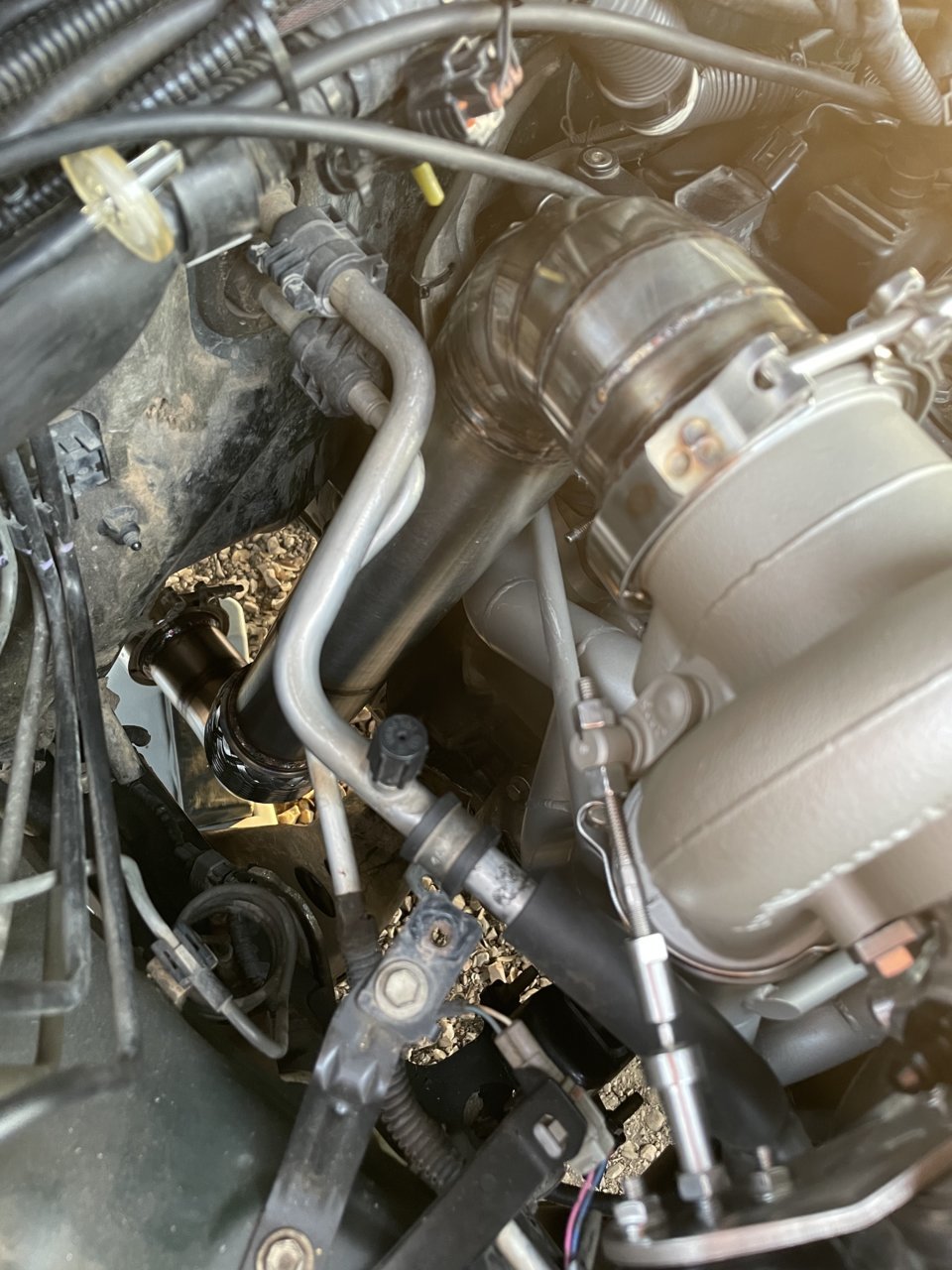

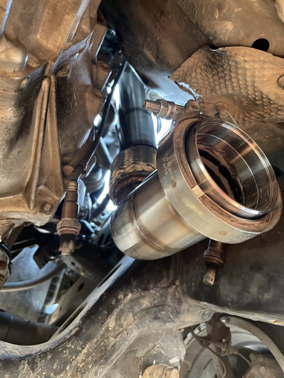

    Another fab heavy weekend for me, worked about 8 more hours on this project and nearly wrapped up the down-pipe. Still need to add O2 bungs, but other than that it’s about finished. Pretty stoked with how it’s turning out though!
