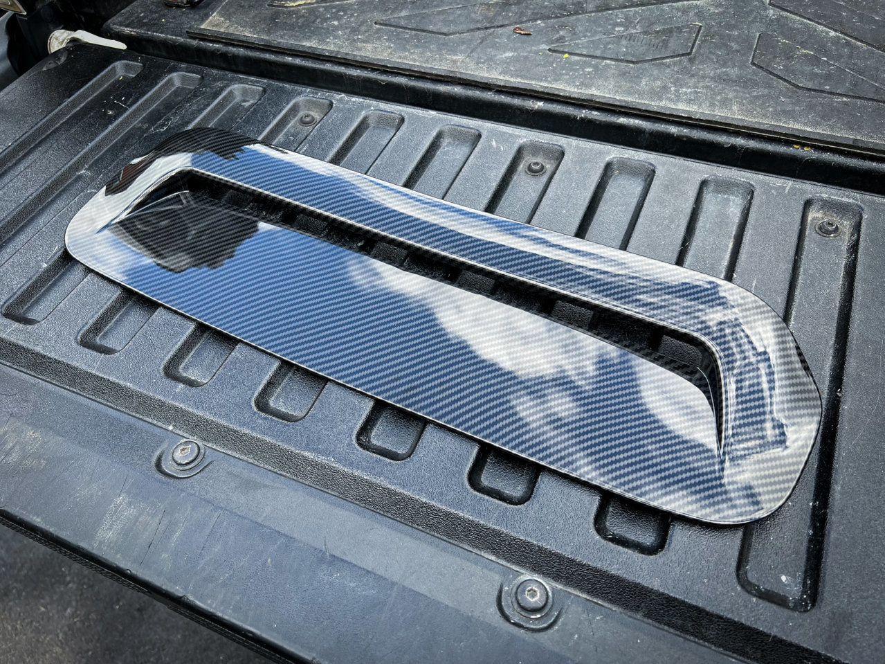

    Where did you get this??

    :spending:Me too!

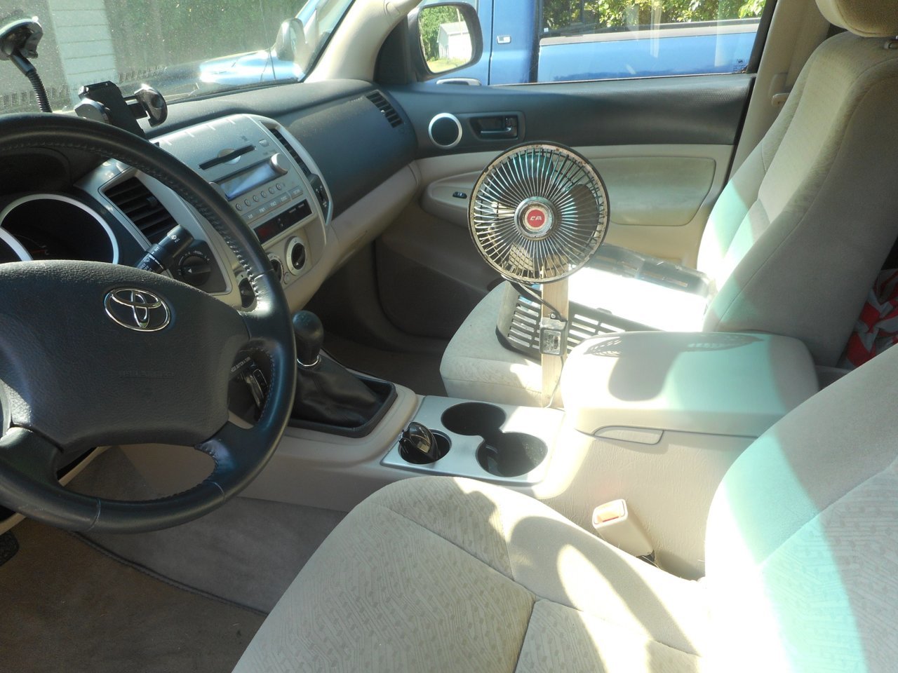

    I have the blinking light and likely seized compressor. Thank God it'll be in the 70s tomorrow when going back to work, unlike the 90s today. I haven't used this fan probably in about 20 years. Just rigged it up today for the Tacoma. I'm glad I hang onto things. It's just to keep the air moving if I have to go slow due to traffic. Fortunately, that's usually not the case. Of course I will get the AC fixed when I can.

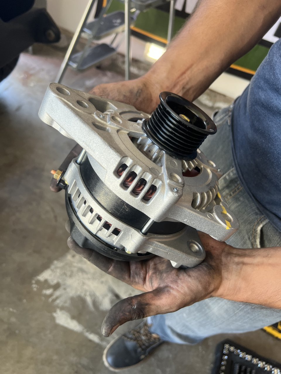

    Alternator took a dump on me, battery light came on while driving so I went and got it tested, idled at 9V and died as soon as I pulled in the driveway. Luckily bought a new one after the test and just swapped it out. Have the battery on a trickle charger now. Took an hour and a half because the damn thing doesn’t shimmy out (or back in) too easily.
    Here’s the new hardware

    It should come out very easily, if it's not then the lower bolt was overtightened (spec is only 32ftlbs) And the alternator ears have been bent in compressing on the lower block horn.

    Good job! I assume you bought it locally.

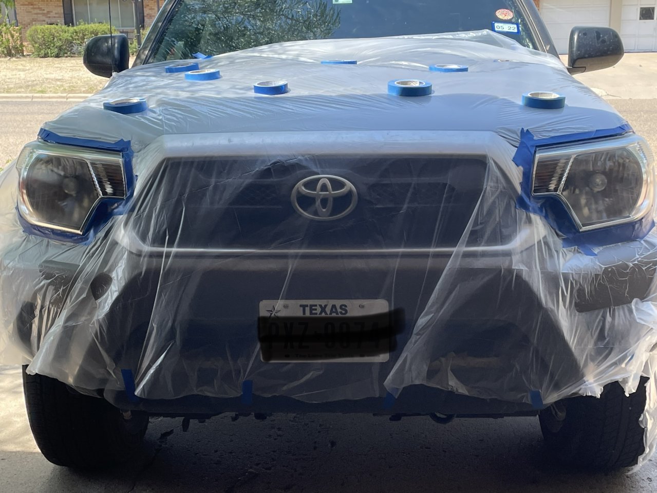

    Restored the headlights today. Wet sanded using a scouring pad, then 400, 600, 1000 and 2500 grit sandpaper. Then several coats of clear coat. I’ll use canuba wax to buff out the “orange peel” texture tomorrow after the clear coat has fully set. 10 years of yellow haze finally removed!

    Did one on the '12 a few weeks ago. Only issue was not removing the sheet metal shroud before removing mounting bolts. Removed a 10 mm bolt or nut and didn't see the one facing the driver fender. Other than that it was a cake job. Removing battery simplified it.

    One of my favorite Milwaukee purchases. Works off a battery or corded power. I've definitely used it in my vehicles before.

    Them things actually move some air! I was impressed by them.

    Yeah they do! I was too! I used to bring it from job to job in the shop I worked in. We didn't have an ac'd building and it was a life saver in the summer.

    One of my sons swears by Milwaukee. I've heard great things about them. He just bought battery powered circular saw, doing a project on his deck. Several of my corded tools have electrical tape over wirenuts on the cords, several on the long outdoor extension cord. That fan looks great - when charged would probably be fine for my 23 or so minute commute.
    What's cool is, as far as I know - the batteries are interchangeable on many of their tools/devices?

    I swear by there products too! A full charge would defintely last your commute. You can't beat some of those old corded workhorse tools though (wire nuts and all)! LOL! But these new cordless tools, Milwaukee and others are the future and they work great! Feels great not to be tethered to a power cord or air hose!

    No the mounting bolts backed out easily but I meant getting the alternator out of the engine bay itself was a pain in the ass.
    Thanks! And yes right down the street at OReillys, luckily they had one left in their inventory. Saved a lot of time.
    Yeah taking out the battery was key, but that shroud had me confused for a second as well. Didn’t realize there were 2 bolts so a few curse words may have been uttered as I tried to figure out wtf was going on, lol
