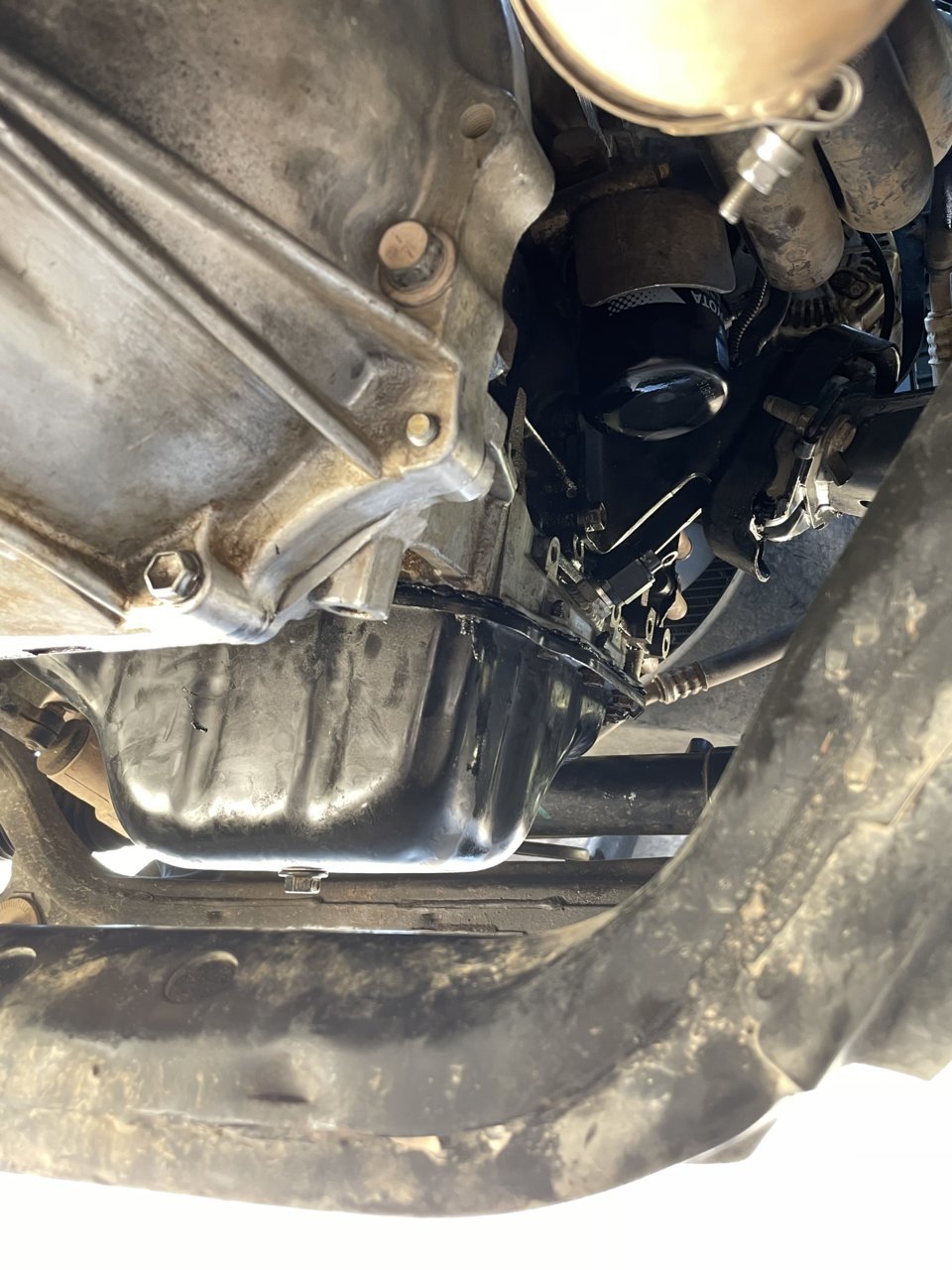

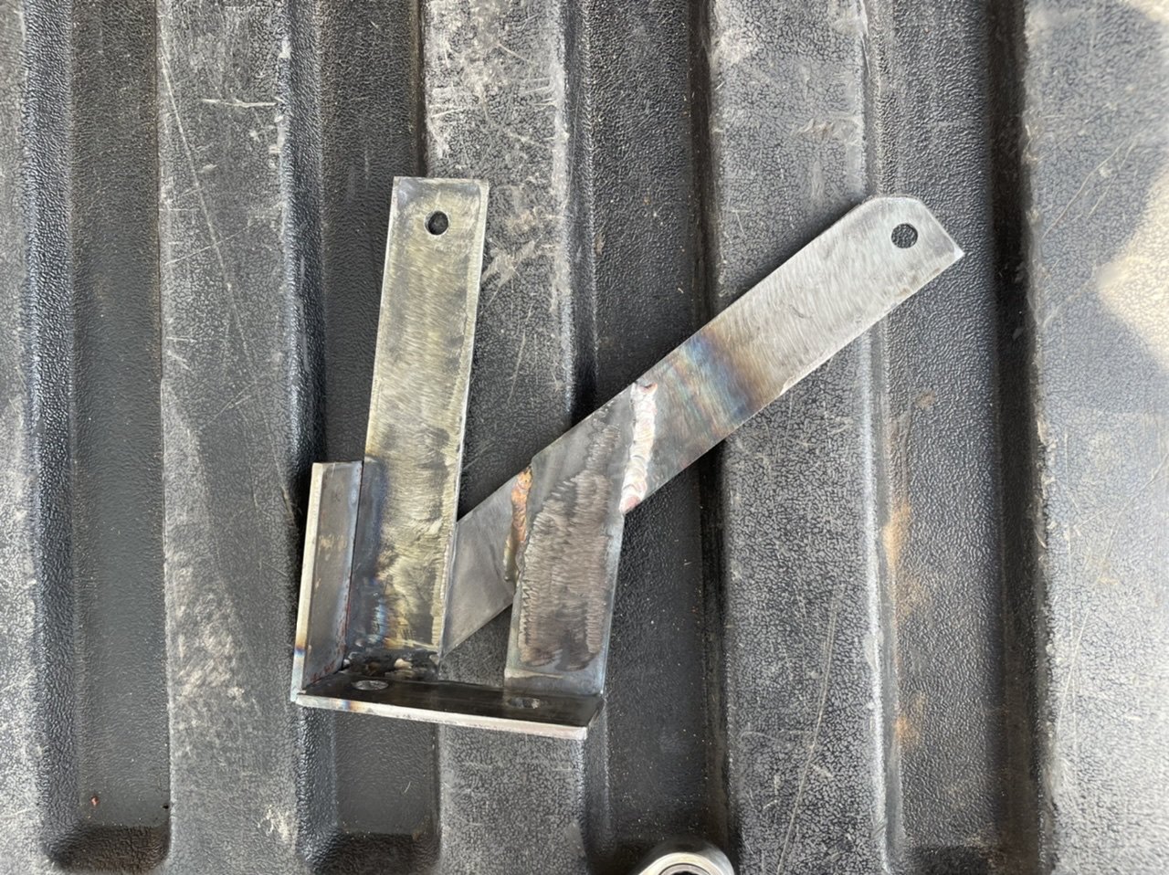

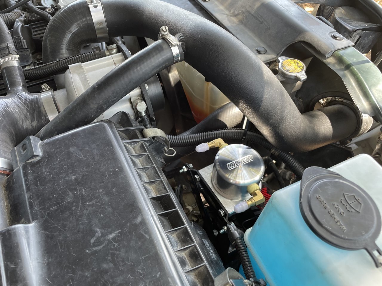

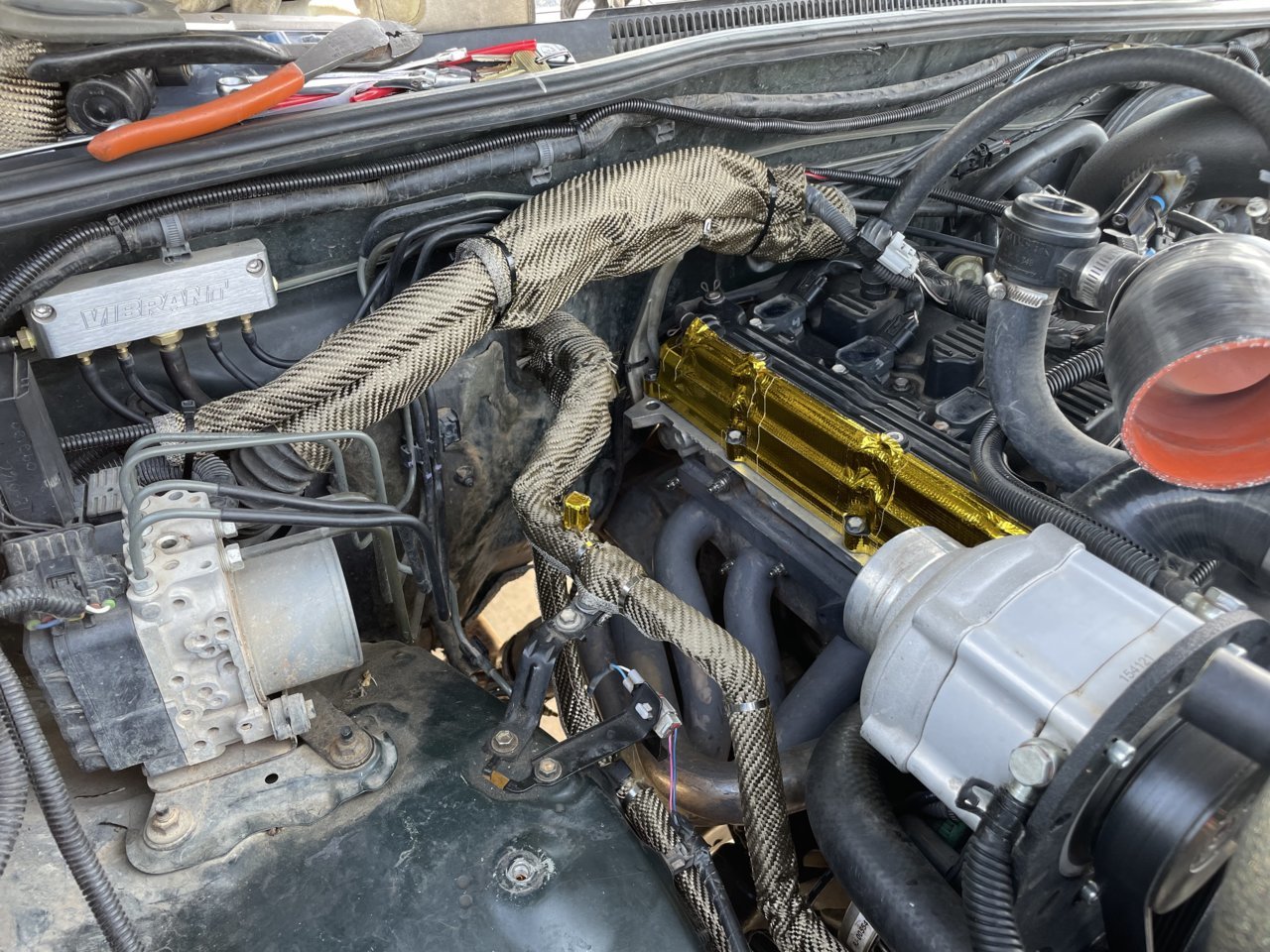

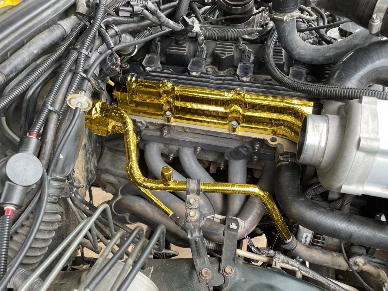

    Lots of turbo prep for me this weekend. Started out swapping in my upper oil pan that has the turbo drain port welded in. Then moved onto building a bracket & mounting my Moroso catch can. Waiting on parts for that to plumb it up but it’s ready. It has a valve on it so I ran a hose to the passenger fender well so it’s easy to drain. After that I moved onto heat shielding prep for the ac lines, valve cover, and wire loom. Also cleaned up some of the vacuum lines and shielded those too. Used some reflective tape on the valve cover and ac lines. Then went back and covered the ac lines and wire loom in PTP lava heat sleeve as well. Next weekend will be back to finishing the down-pipe and mid-pipe and then I’ll try to rework the intake piping and plumb everything up.

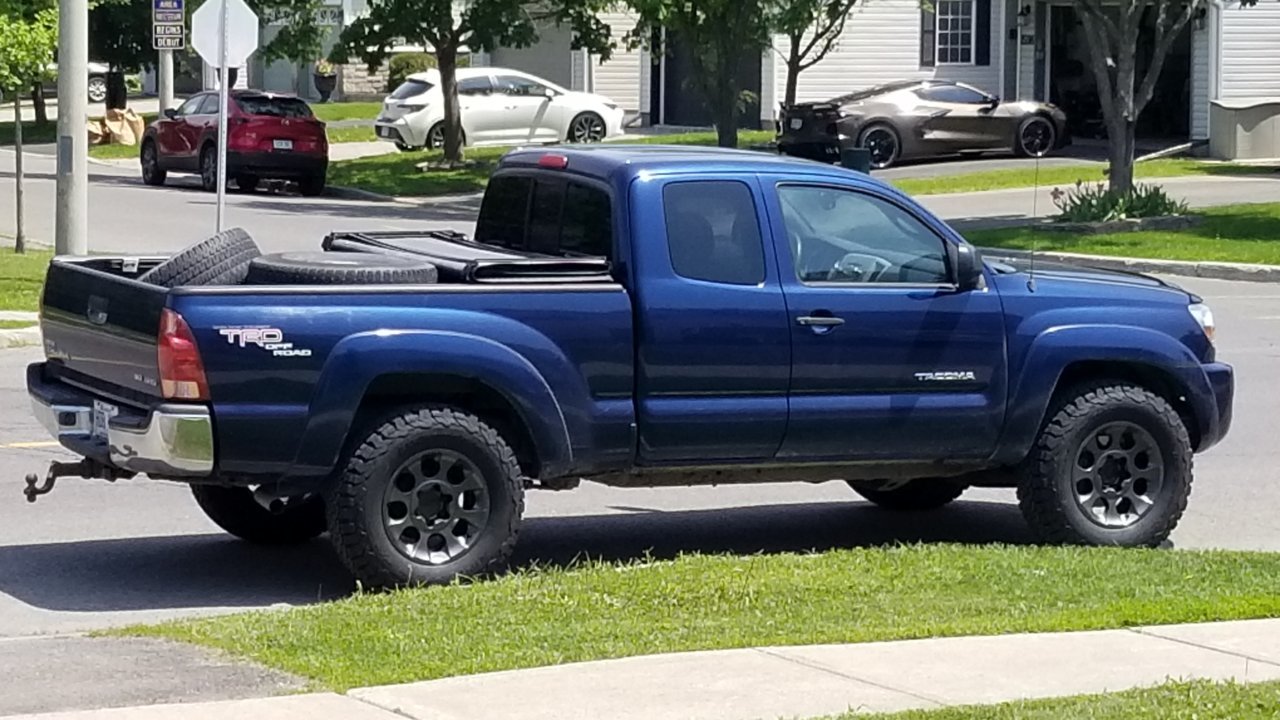

    Truck is back from the garage after the straightforward wheel job turned into an emergency front suspension one. <a href="https://www.tacomaworld.com/threads...en-tacoma-today.6499/page-11610#post-27382212">What Have You Done To Your 2nd Gen Tacoma Today?</a>
    They installed some Monroe 171371 strut and coil spring assemblies, and now I feel like it sits lower in the front, even though the bigger tires are now on. Maybe it's just my eyes, or maybe the suspension they installed is for the base Tacoma model, and not the higher OR version? I asked the mechanic and he said they seemed to be the same when he compared them... whatever, I didn't have much of a choice if I wanted my truck back asap, so it'll do for now, until I put in some Bilstein 5100's in the Fall.

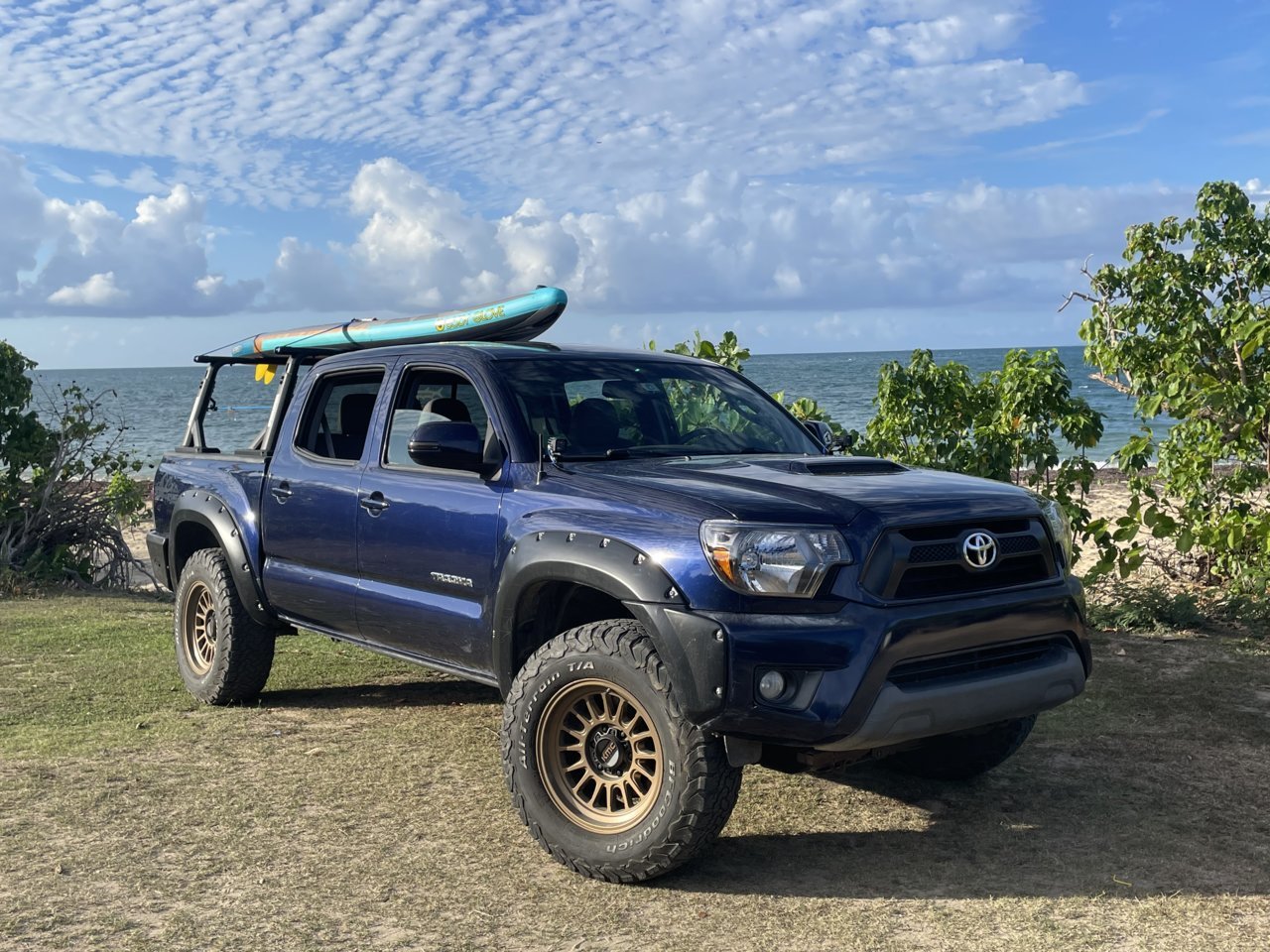

    Quarantined for a week with COVID so I installed my headlights and ditch lights. Those little Diode Dynamics SSC1’s are great. Perfect supplement to the stock headlights. The OEM TRD Pro headlights also look miles better than my old faded stockers.

    @SSX999 nope, mechanic lied. Those monroes are not the same compressed length struts. but, you got your truck back, and instead of 5100's I would look for a set of take offs from a 3rd gen. just 5100s and no new springs will make your turck ride like a chuck wagon...

    Love those headlights. I have what looks to be the same ones.
