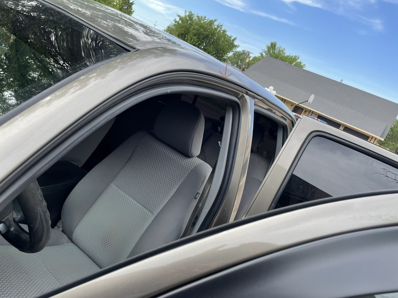

    I'll update on the outcome. If it works, it was a 3 minute mod that can work into anyone's schedule. I read a thread that this was the technique used by a toyota master mechanic to eliminate the noise over replacing the gasket.

    I did this a while back and it completely eliminated it, until recently. Now it has become my morning companion every day during my commute. This attempt sandwiches flexible tubing in the crease between the 2 flaps :)spy::devil:) on the existing door seal.

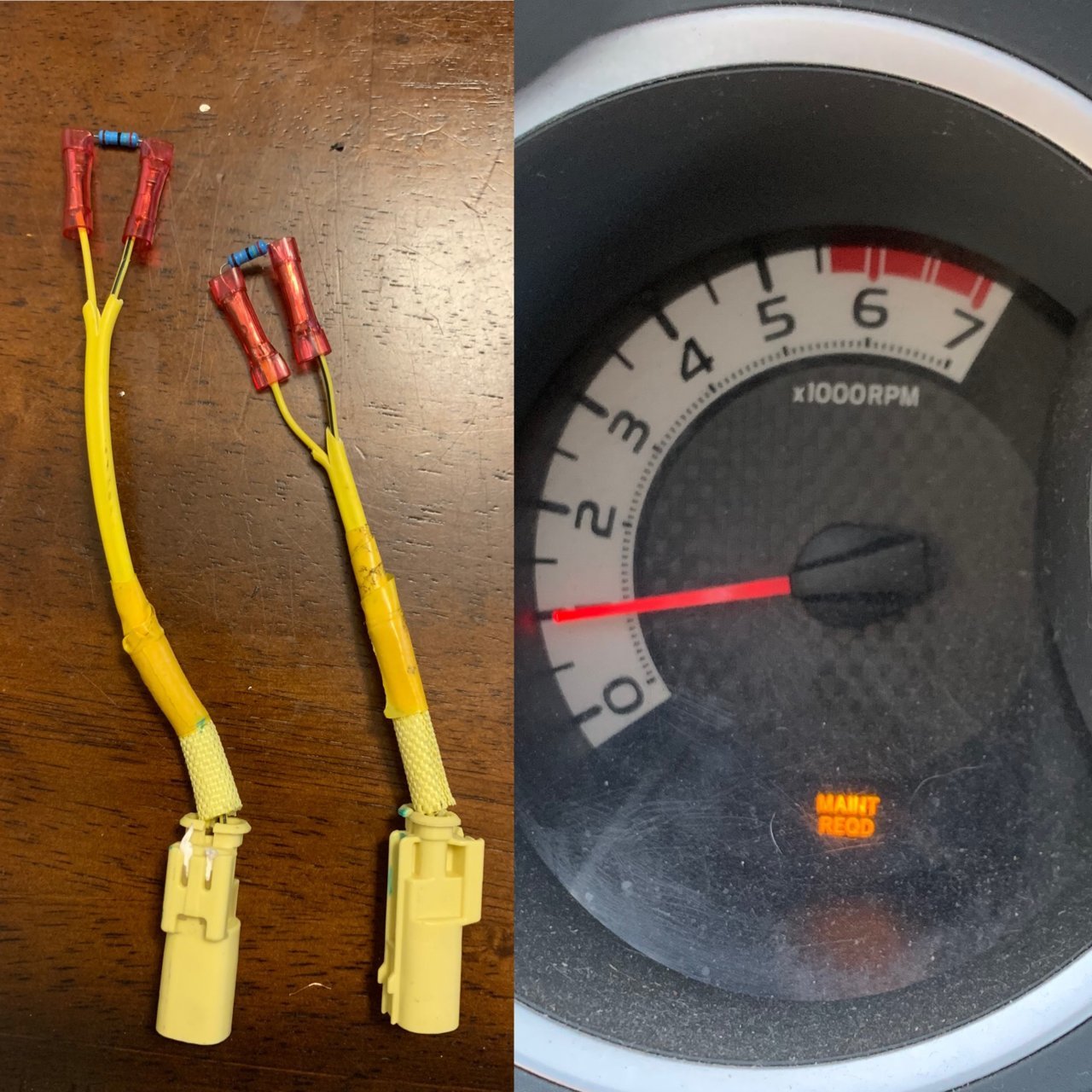

    Fixed my airbag light with this harness setup rigged to a resistor.
    so stoked it cleared the light, with no SRS reader required.

    You added weather stripping to the inside of the existing? What material?

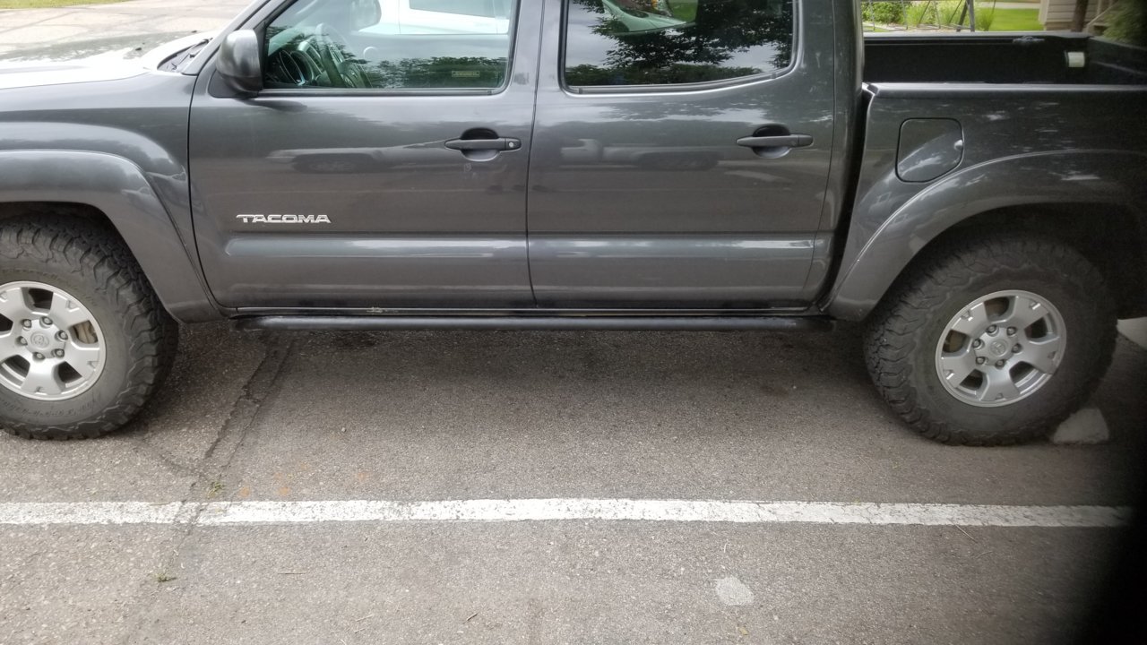

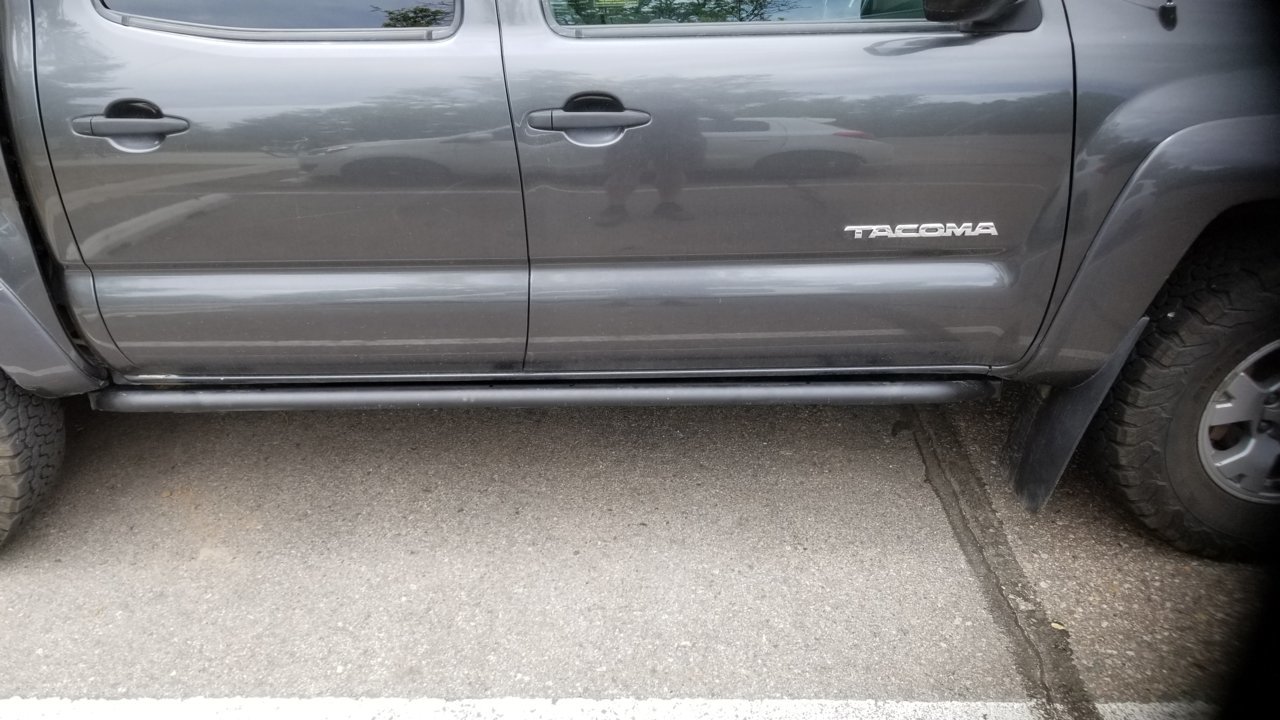

    If
    Not sure if you know this or not but those are not sliders, they are decorations. You’ll be sad if you try to use them as sliders.

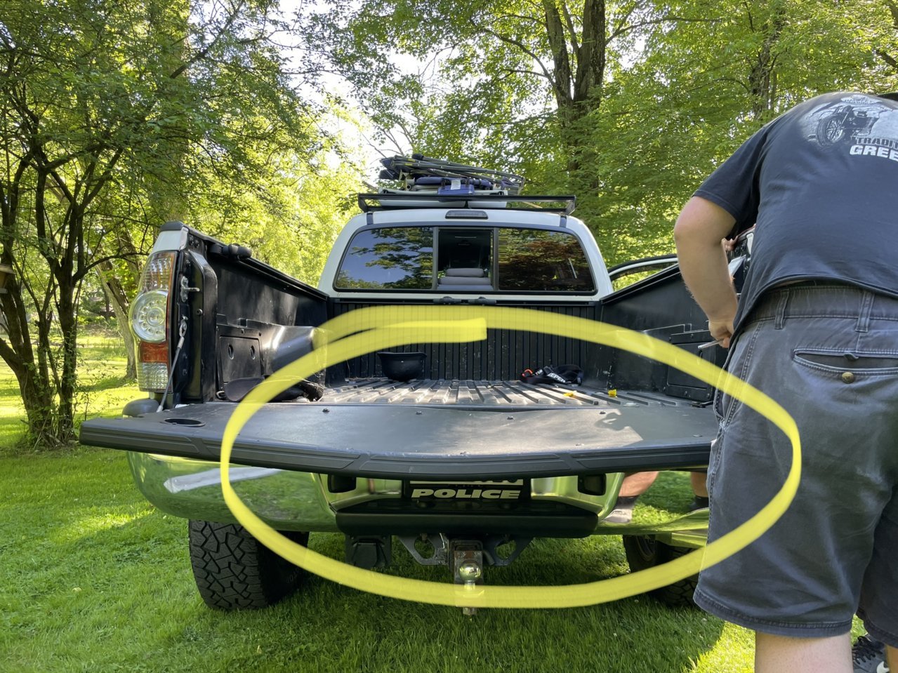

    Oof - yep. This is why I run both a steel tailgate skin and a steel tailgate cap.

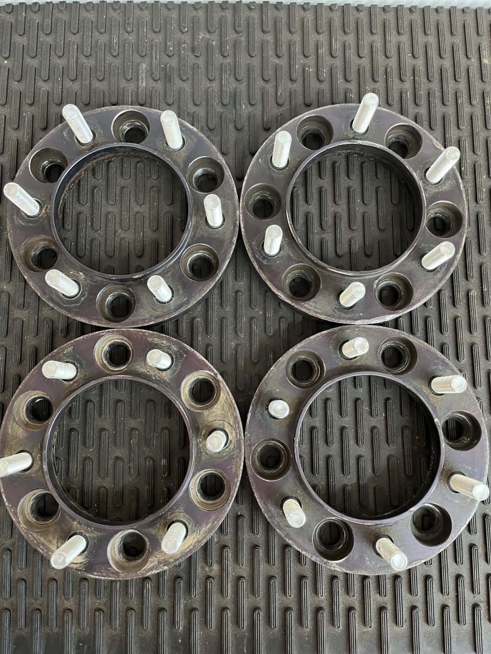

    Got my Bora spacers installed with brand new studs today. When I had my new wheels installed a few weeks back, we learned that 3 of the 4 wheel spacers had at least one bent stud on each spacer.
    Ordered 24 replacement studs from Bora and got them installed.

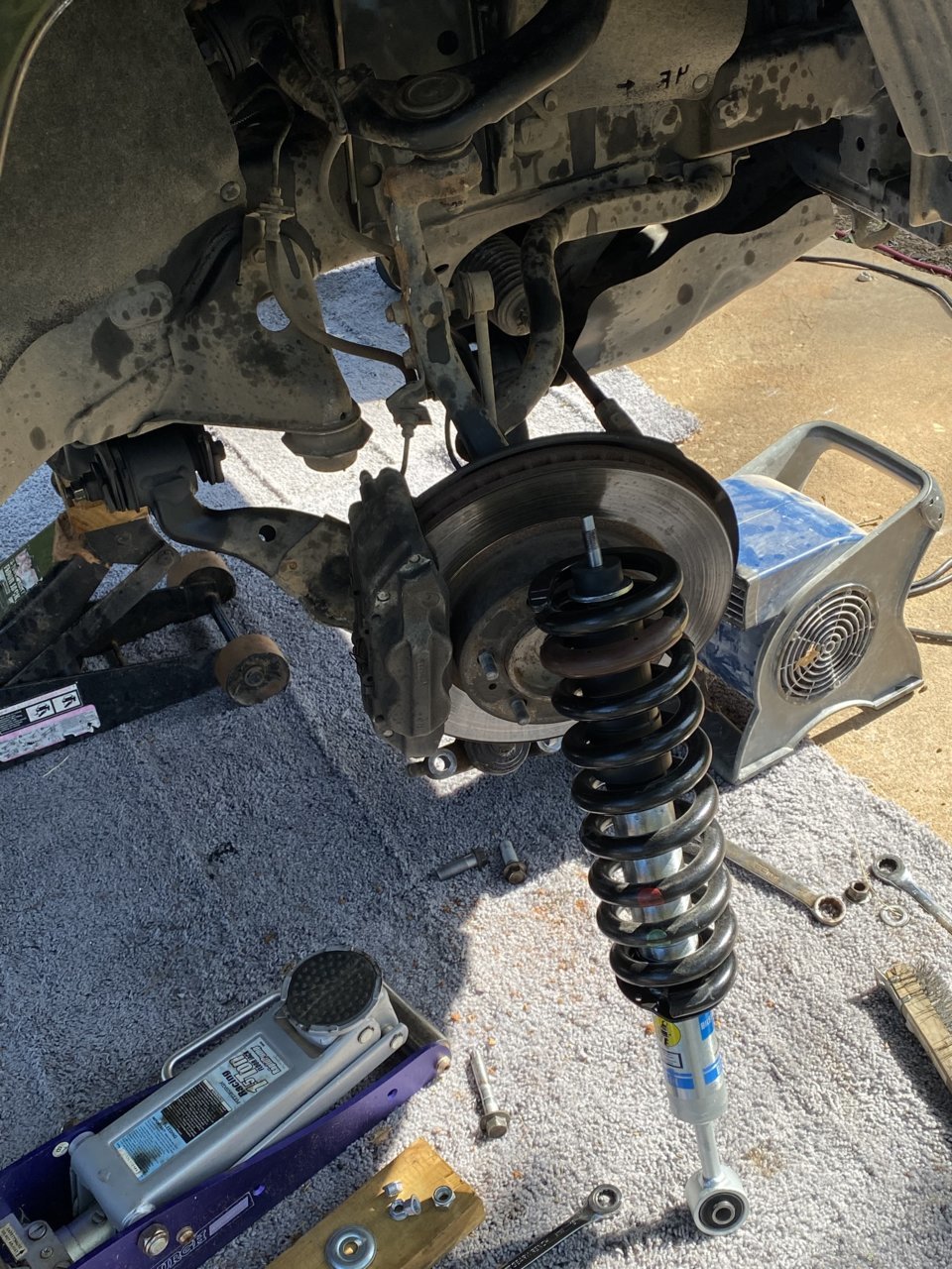

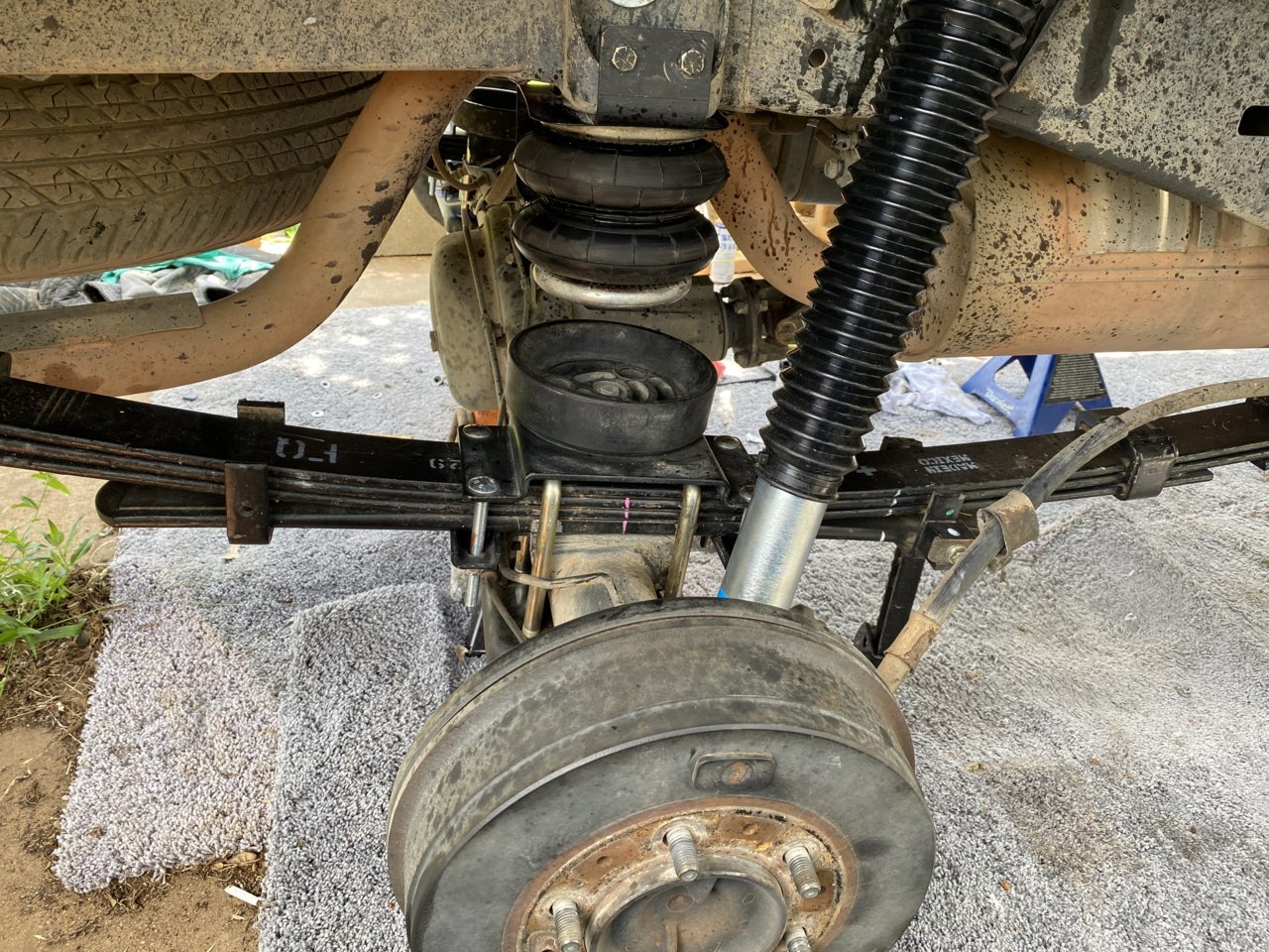

    Added New TRD Coils with Adjustable Bilstein 5100's to the front & New Take off's TRD Rear Leaf Springs with 5100's and Firestone Air Bags to the rear of my daily driver Road Warrior Prerunner.
