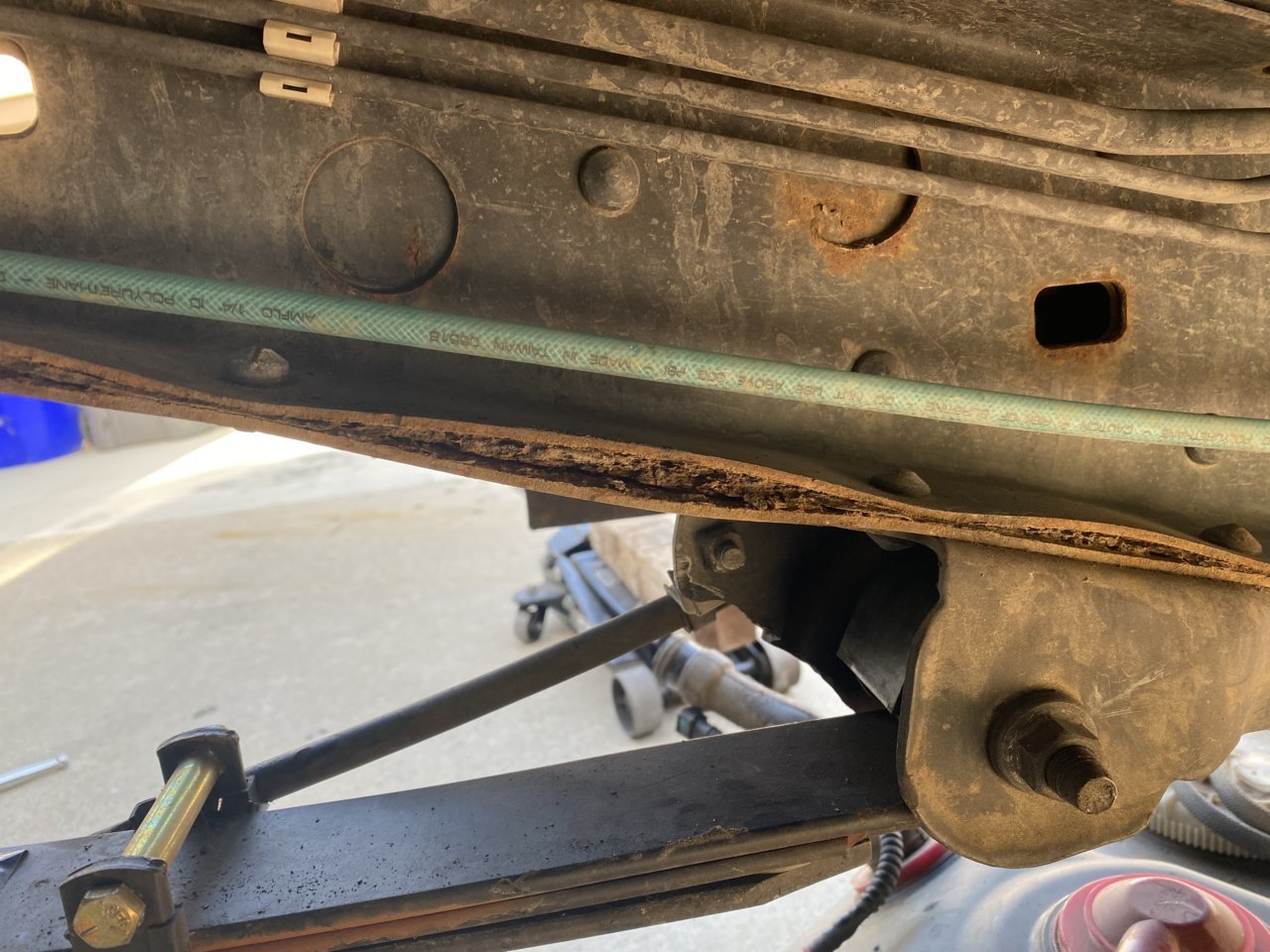

    The problem I had was the frame itself “deekyn” , apparently there was a recall. I had no idea. E726E305-D2D5-444B-93FE-9140EE665EBF.jpg

    I was looking under it after running through a hole and noticed it! Did some research and found out it was an issue. Luckily it wasn’t bent, i was able to line it with stainless angle iron. They make cookie cutter frame pieces to go on them

    That’s what mine looked like other places, rust all in it. It looks to me like they put 3 thin frames together with no coating between them. Water gets in there and rusts it out! Poor design.

    Exactly!!! I cut some spots out and had some stainless angle and channel iron i welded in there. I don’t really like to weld up frames but what did I have to lose! I think it was 05-06 that had the issue but I might be wrong.

    I found out after hitting a hole pretty hard and noticed the top of the leaf springs had pushed the frame up where it attached. Luckily it didn’t fold it up like a lawn chair!
