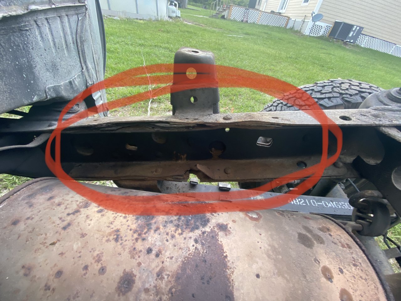

    Heck yeah, you made out! I ran the vin for a recall on mine but wasn’t lucky enough. I’ll replace or repair the the rear frame if I have too myself then get it coated and Itll be good to go!
    Also the problem with the coating is the rust is already between the layers of metal so it doesn’t even slow it down if it’s already in there

    yes, the dealership that did the undercoating sprayed right over the existing rust. Morons! I really went back and forth about getting a newer truck. Really liked my 2008, but 169k and things starting to be replaced and then the frame discovery, it became a no brainer. Good luck with whatever you end updoing.

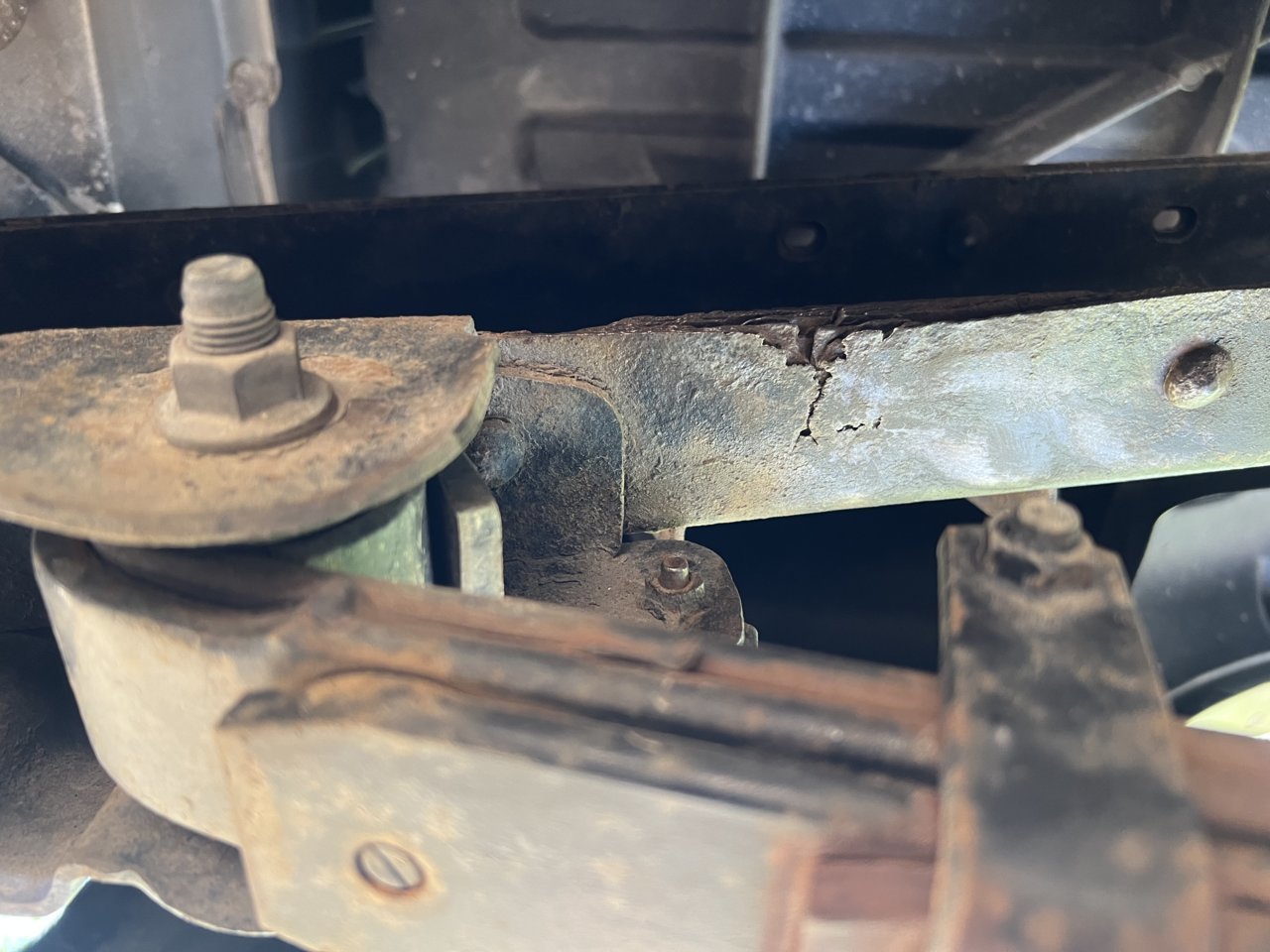

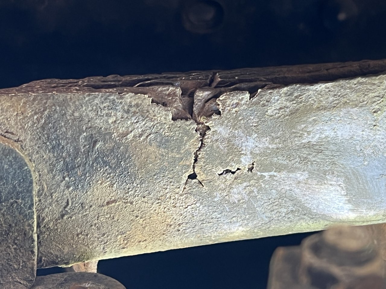

    Wire wheeled, degreased, metal prepped, and POR-15’d my frame today. Will post pictures tomorrow. But I did run across this and oddly enough you all are talking about it. Going to take it by a shop to get a weld quote tomorrow. 36941139-B546-4740-815F-C8ED8B0A2AAF.jpg020FB984-6E5F-42F6-9032-CE6BC26D61EB.jpg

    Did you check if those leaf springs are subject to a recall from Toyota? I had the leaf springs replaced for free as part of a recall on my 06 Tacoma. They were no way as bad as shape as yours!

    I’ve had the recall replacement. But these are actually Deavers that I installed.. not impressed at all with the rust that accumulated. Just POR-15’d them today.

    Hoping to keep her going. 12 hour job on the frame yesterday. Time to weld a few spots up.
