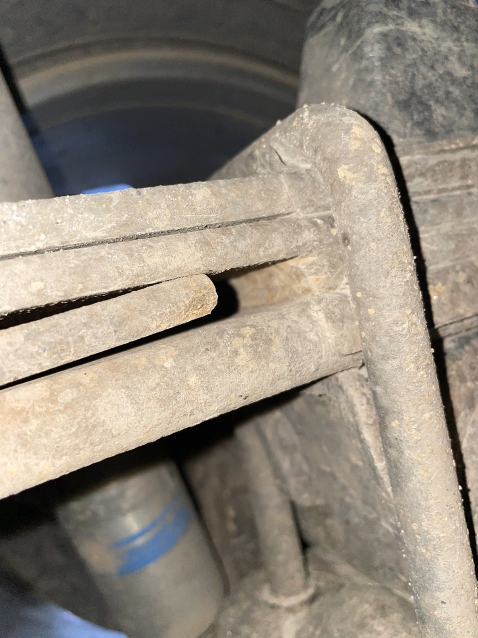

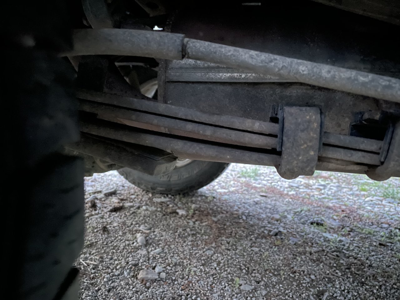

    Found this and guess my mod priorities have changed. Guess I found what I thought to be my mid body clunk.

    That sucks though, did you have any severe Taco lean prior to noticing?
    How long have you been hearing the "mid body clunk"?

    No severe body lean. 5100’s all around with front set at perch 2 to maintain rake when loaded. Ride was solid up until Memorial Dayish weekend. Noticed Memorial Day weekend was hitting the rear bump stops loaded going camping. Not crazy loaded by any means. Continued hitting bump stops while wheeling over the weekend once unloaded. Thought to myself that’s weird but nothing crazy. Pretty good dips and articulation so I chalked it up as eh. First noticed clunk almost immediately after that weekend. Only happened during suspension compression. Think pulling in/out of parking lots/driveways. Asphalt/concrete changes during city driving like approaching lights and of course wheeling or driving off road. My trucks spends at least 50% of its mileage off pavement. No joke. It’s rural out here. So while I might not be Moab or Baja running 50% of the time, I am regularly commuting on roads that some may consider “trails” in other parts. Checked exhaust and hangers. Checked out. Checked heat shields. Checked out. Checked sway bar. Checked out. Front end and driveline. Checked out. For whatever reason I never payed attention to the rear springs until today when I was washing the dust off the truck. While Spraying down the rear drums I noticed the gap in the spring pack. Under closer inspection noticed it was cracked.
    I’m Assuming off-road has taken its toll on the packs and my memorial weekend excursion snapped the leaf. Over the course of the past month the leaf has slide forward creating the gap and all the compressions and articulation has warped the remaining springs creating the gap and clunking I have been hearing.

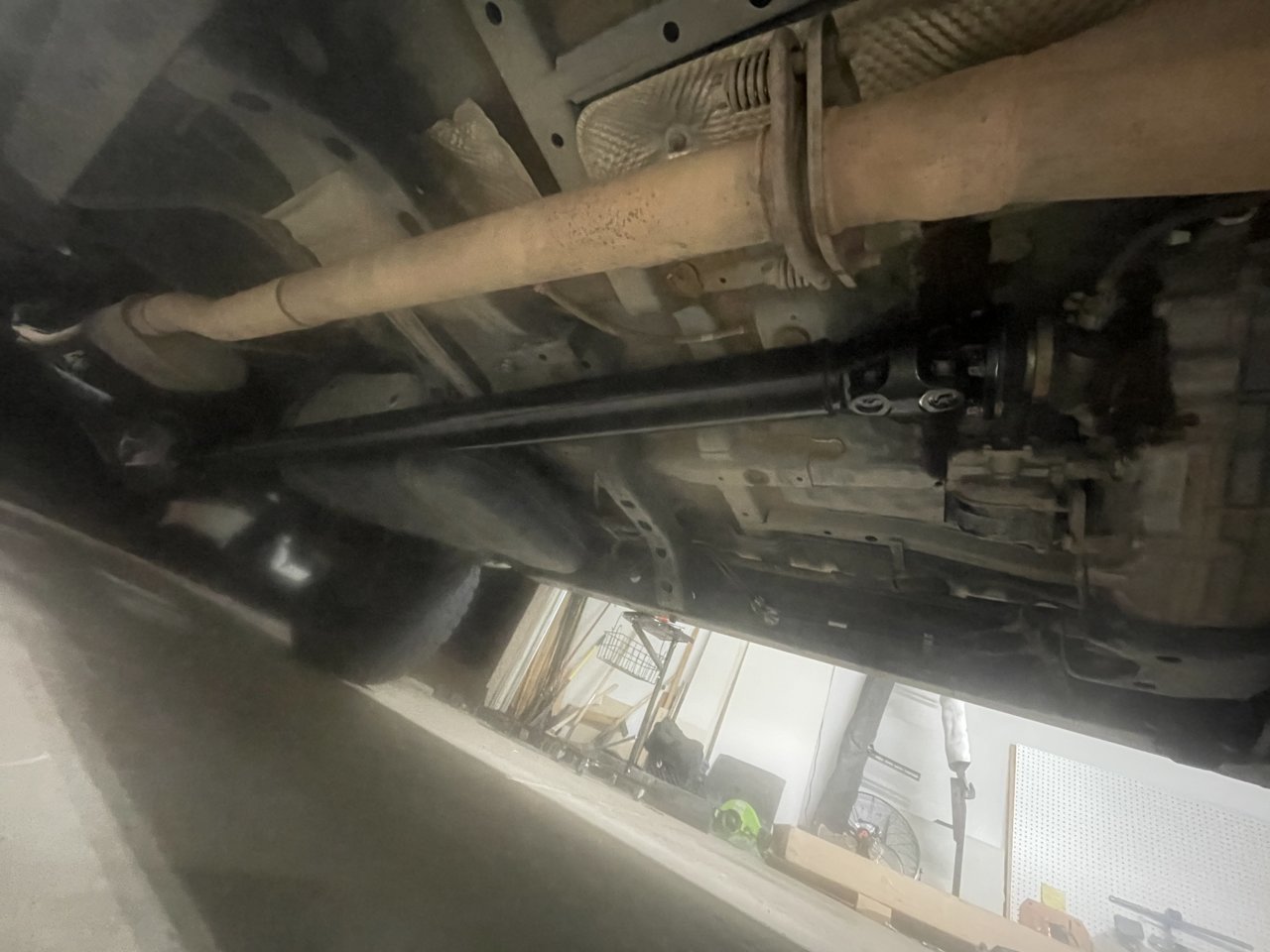

    Did mine two years ago and had the same success to stop the take off vibration after a 3” lift that axle shim and carrier bearing drop didn’t fix.

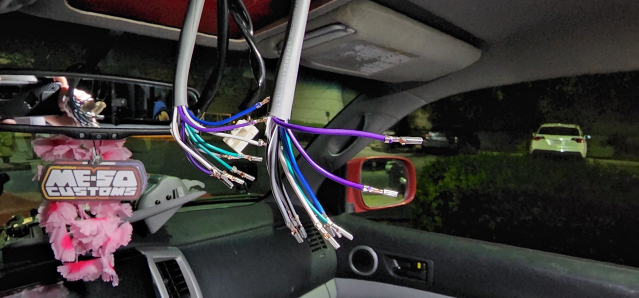

    What do you do on your lunches??? I work on crimping and pinning my connector. lol Took a 10 min and 2 lunches to finish. Just need to add 2 ground wires to the plug and everything on the upper console is done!!!

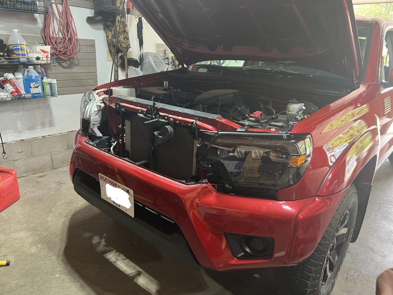

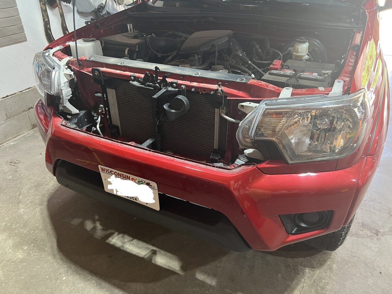

    Not today but yesterday I installed some jet black alpharex headlights and man does this thing look so much newer. I am really pleased so far with these headlights. The whole install took me about 4 hours I would say the hardest part was getting that third bolt. Also getting the fuse tap through the firewall which honestly should not have been that hard but it was.
