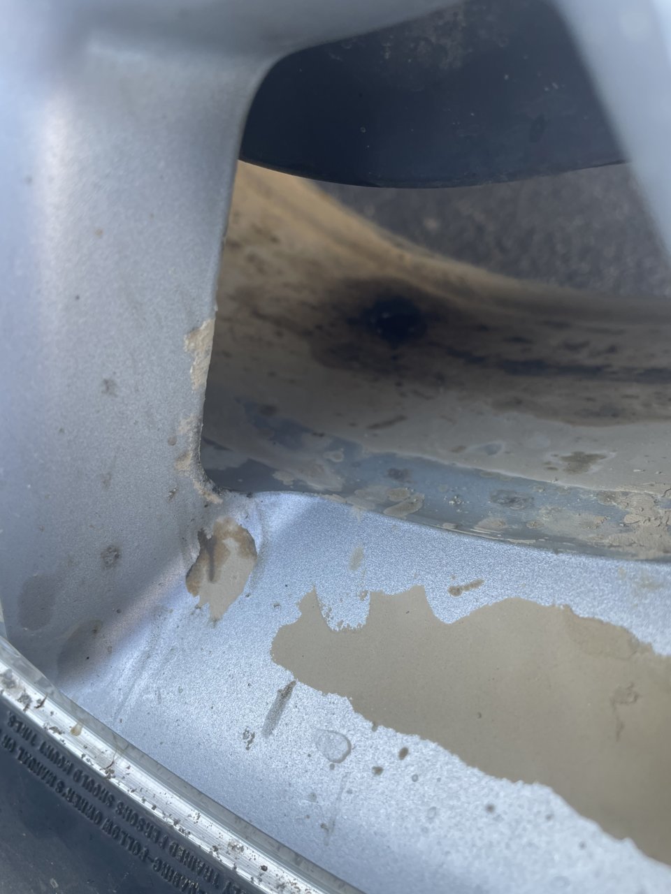

    Just got home from a 500+ mile road. The 500+ miles consisted of 7 mountain passes and roughly 350 of those miles were off pavement and 5 of the 7 passes were non pavement. Needless to say my truck is a dust bucket. While unloading gear I noticed my drivers side rear wheel was exceptionally nasty. Under closer inspection looks like I’m slinging gear oil all over the inside of my rim and is leaking profusely from the drum. I will do a thorough inspection tomorrow morning. Going to check if the breather is plugged too. It’s too hot outside to lay on the asphalt this afternoon. It’s 110 outside right now. Ive referenced the axel seal replacement write ups and I think diy replacement of the seal is outside of my wheel house due to needing a press and all the speciality tools. What’s a fair price I should expect to pay to have this done by an independent shop? I know it varies. Just give me ballpark so I have an idea when calling around.
    Trip was amazing for what’s it’s worth. 7 day journey of phenomenal fishing and trail running.
    Edit: also what’s the average life of these seals? Truck just rolled 102k. Been a shit month for the truck. First broken passenger leaf pack. Second driver side lower ball joint took a dump. Now rear axel seal. Fml.

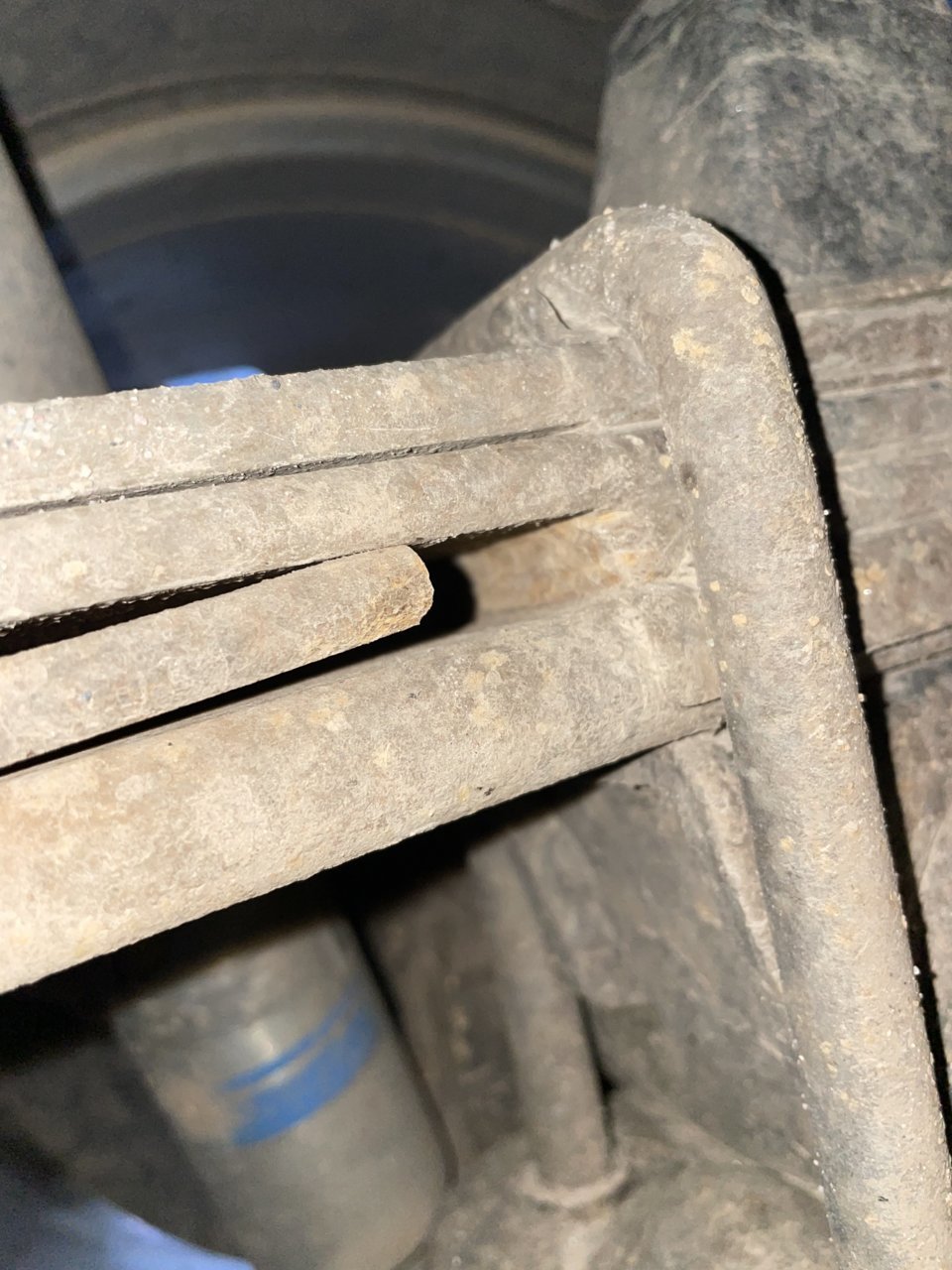

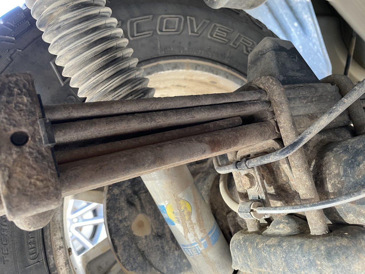

    Seal is leaking. Oil leaking from bottom of the drum. Breather may or may not have been plugged. Unscrewed and tapped the hell out of it and a bunch of dust and mud came out. Cap moves freely now and can blow air through it. Reinstalled. Time to go get some quotes on replacement now.
    Also while down there noticed the driver side leaf cracked and separated on this weeks expedition. Passenger side took a dump 2/3 weeks back. Secured 3rd gen take offs with aal’s. Hopefully can get them out on this week or coming weekend. Passenger side broke in front of the axel. Drivers side behind the axel. Oddly enough same leaf on both sides.

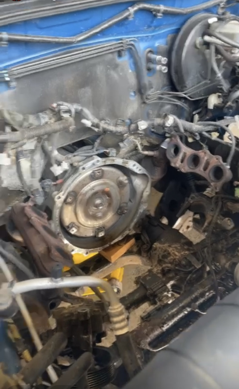

  10. Jul 30, 2022 at 12:18 PM
    Miller time
    Miller time Well-Known Member
    Jul 24, 2016
    #192823
    51
    Shawn
    08 Tacoma TRD off-road blue D-cab SB 4x4 with locker

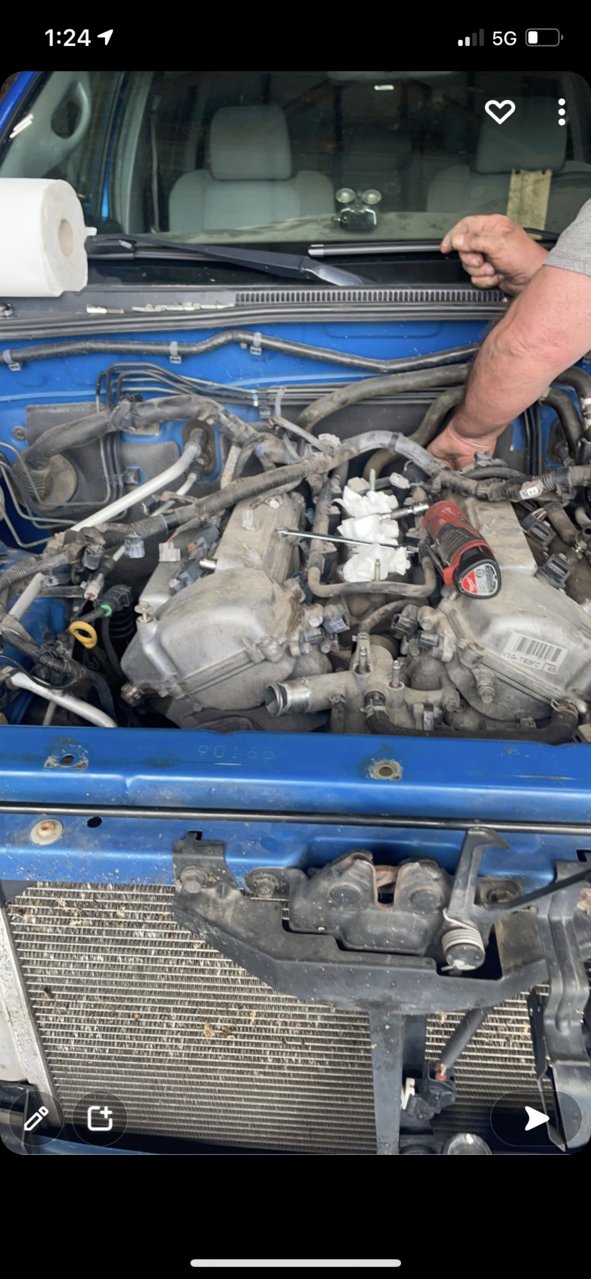

    what part of Illinois are you from? Would love help getting the engine back in.

  11. Jul 30, 2022 at 12:47 PM
    Squirt
    Squirt Samsung Aficionado!
    May 5, 2020
    #326856
    9,728
    Ben
    Cornfields of Illinois
    2016 F150 Lariat with 3.5L of fury!!
    Rexing front and rear dash camera, some LEDs, Weathertech HP floor liners/vent shades/bug deflector/underseat storage bin, OEM Ford bed mat, Diode Dynamics SS3 Pros in selective yellow, Diode Dynamics 18" light bar in amber and universal Carhartt seat covers. Bak Revolver X4S tonneau cover. Android Auto USB plug upgrade! H11 to H9. Sound deadened/insulated floors and rear wall. VLED license plate reverse light. Yokohama GO15s. Rokblokz mud flaps. "Custom" 3in Flowmaster Super 50 Series cat back with a 3in Speedys Snap resonator. J&L catch can. AMP Powersteps
    I'm up near Aurora. I'm no mechanic though :sorry:

    Local independent shop quoted just south of 400$ for seal and bearing replacement only. Just south of 700$ to replace everything including shoes if not save able.
    Went to Toyota for a quote and it was as expected. 1889.96 to replace everything including the shoes. Made use of the dealer trip though and picked up a new serpentine belt, plugs, and resupply of filters and gaskets.
