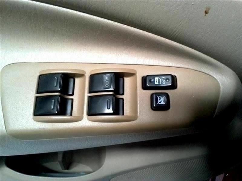

    The 05-11 has a different layout for the lock/unlock button and the window lock button.

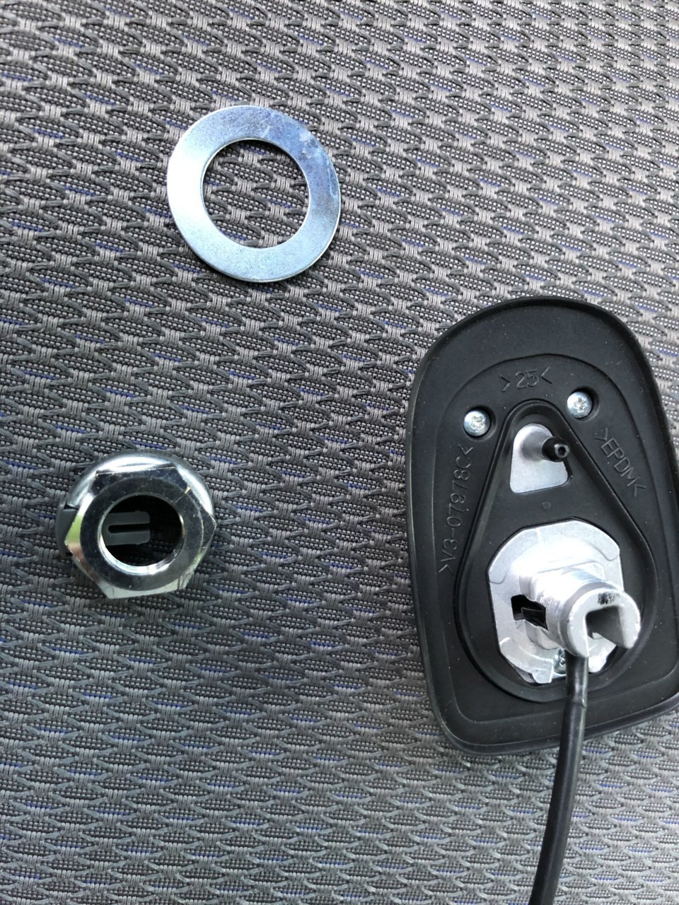

    I got the XM antenna permanently mounted. It's the first step in getting my interior back together.
    I had to find a washer that was the correct size but thin enough because of the thickness of the dashboard plastic.
    I found one at a local hardware store called a "machine bushing".

    They are the same but some wires are in different locations. Need to repin. Also need a new bezel from 12-15
    Different connectors on ac. Maybe use a few of the passenger side buttons and replace them in your existing setup.
    I want to do this also but not looking for another wiring project right now.
    @HAVOC , did the leg work to find out why it's not plug n play for the rest of us

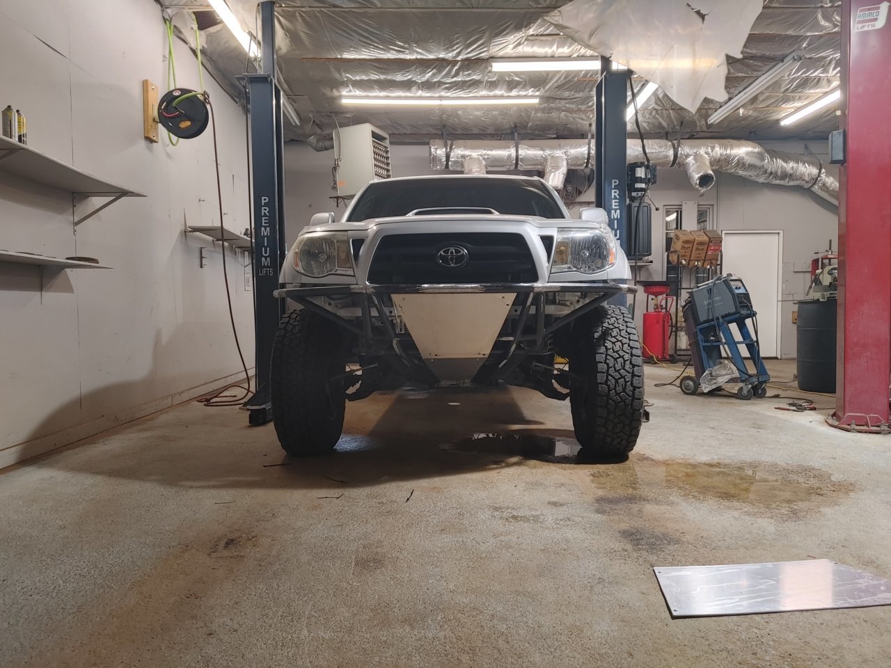

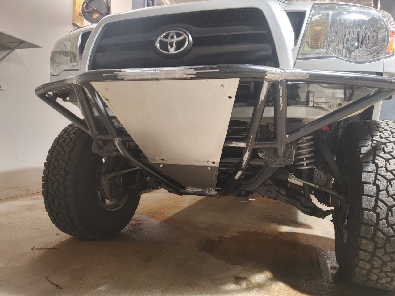

    Just waiting on the lights so I can weld those tabs on and paint. Had to reuse an old piece of skid until I can get to the metal store. Hence the extra holes in the upper skid.
