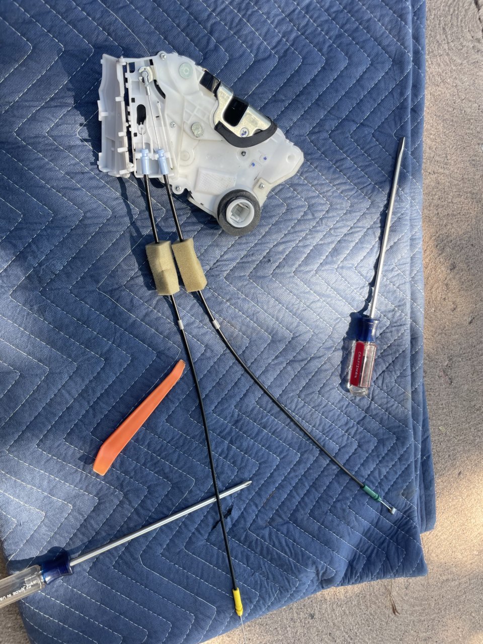

    That's my plan then. I mean I'll have to have a beer while testing the windows to make sure everything functions properly.

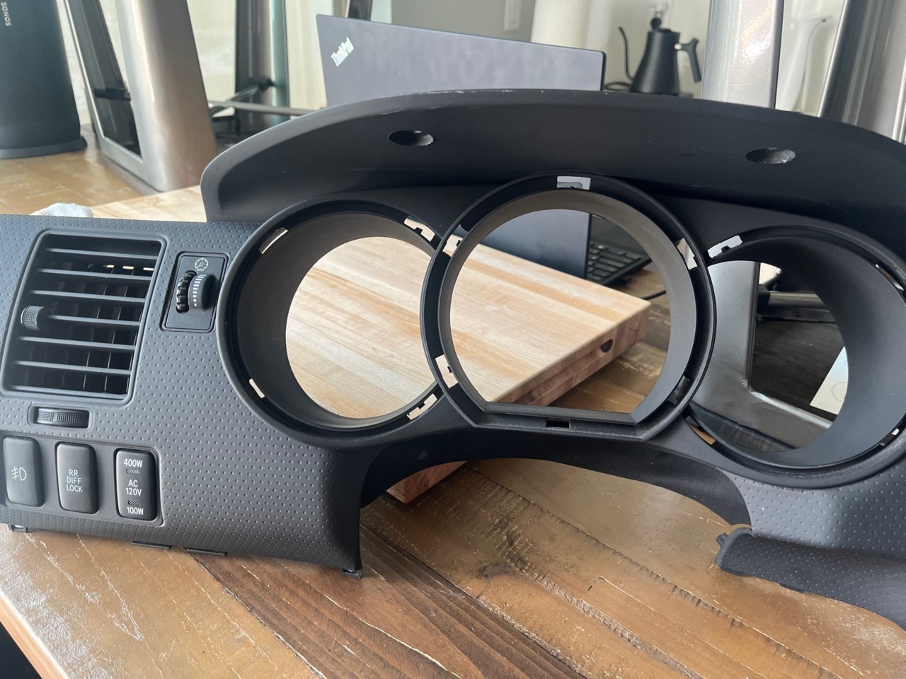

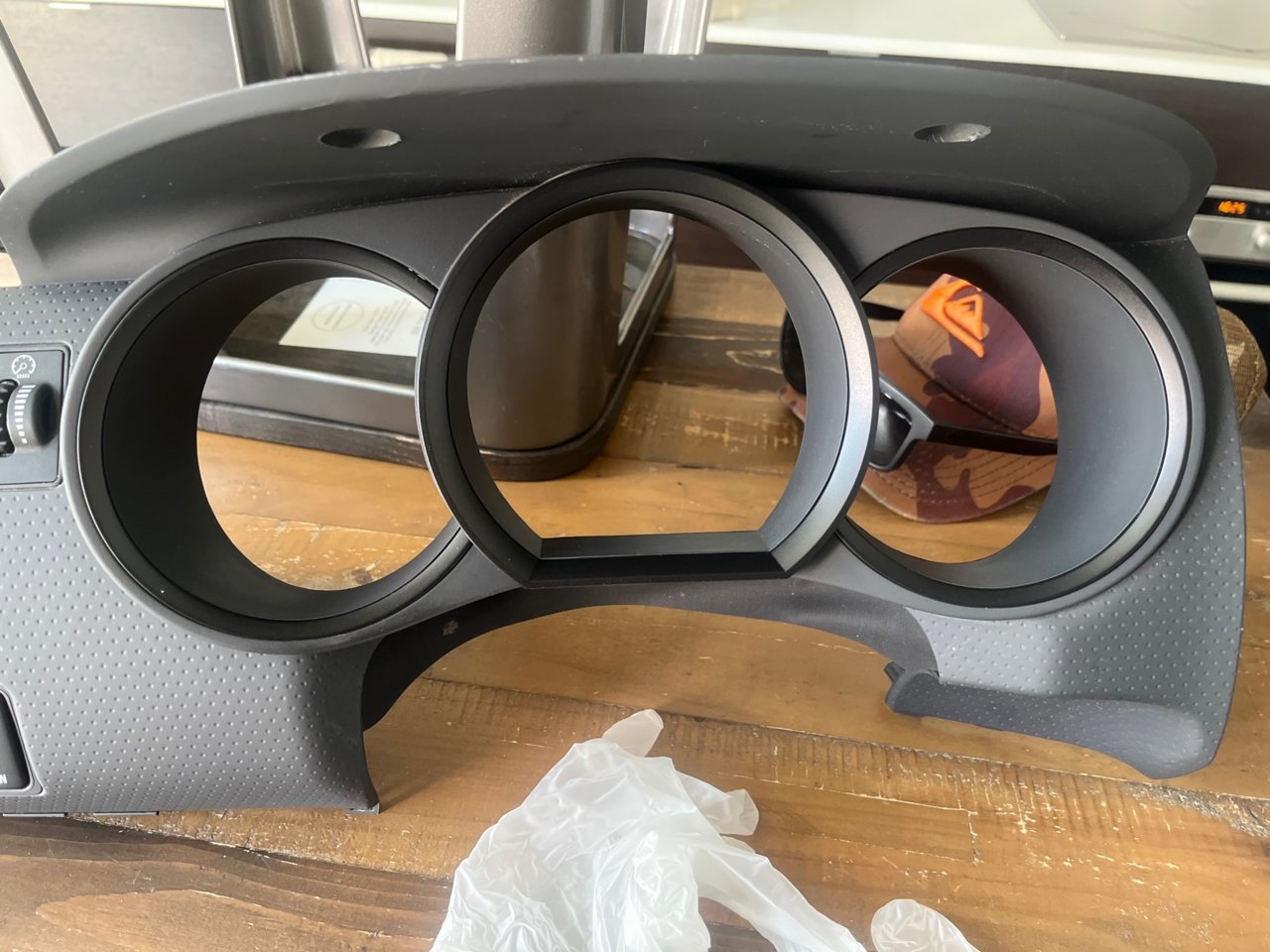

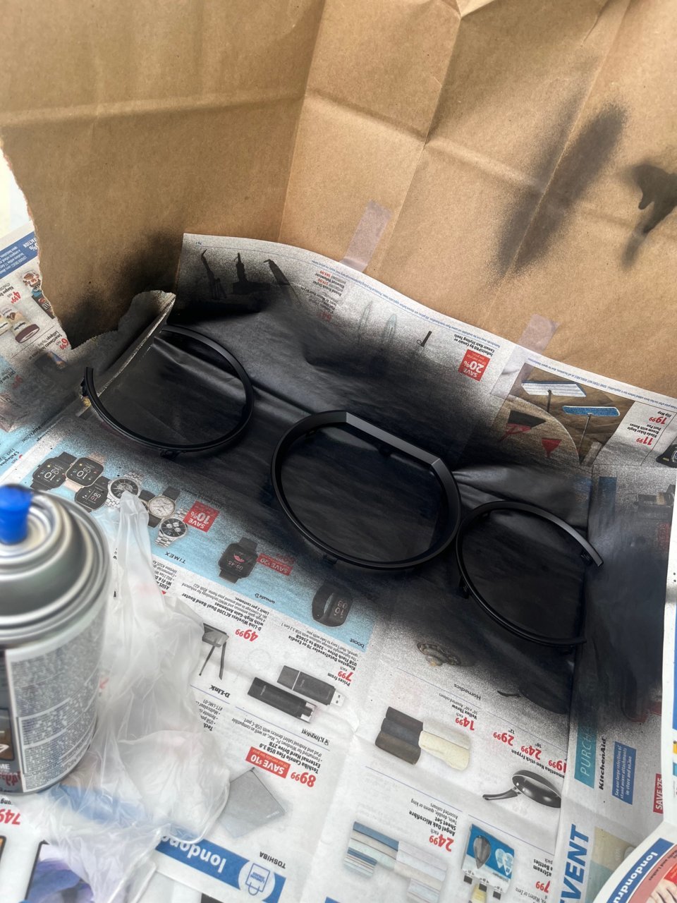

    Took out the dash trim, spray painted the silver rings, replaced the cluster plastic with a brand new one, used the Protech Screen Protector on the new plastic, although there is an air bubble right in the middle that's annoying the hell out of me, hopefully it works itself out!

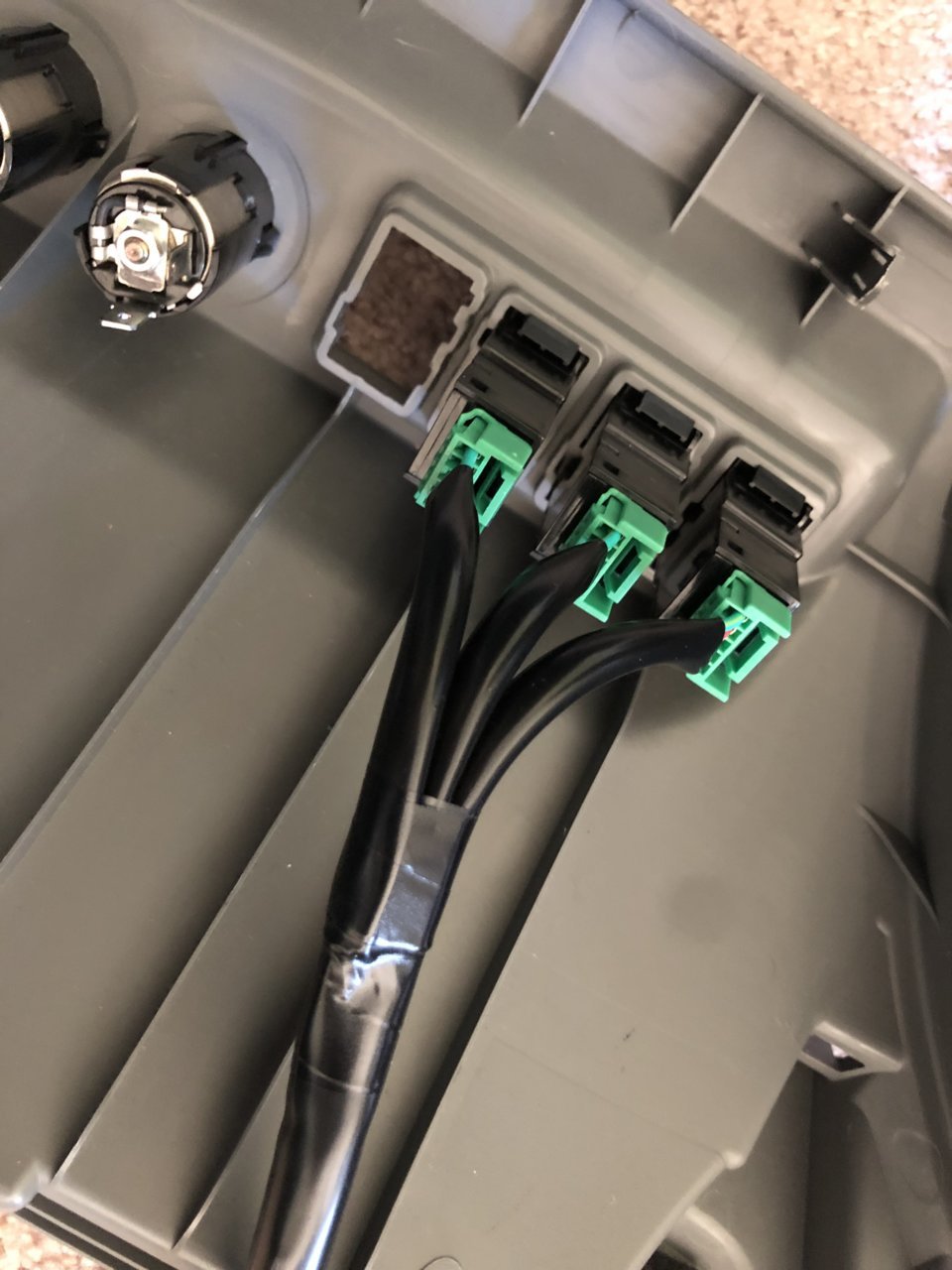

    Wired the switches for the front, rear and ditch lights. Now to install the panel.

    How closely do your green ones match the green switches in the truck?

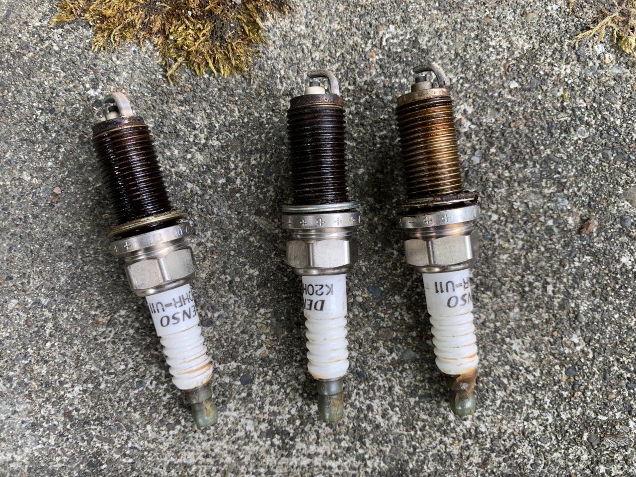

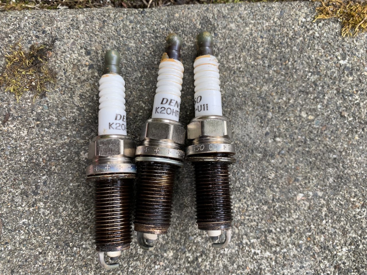

    driver side on the left: left to right is front to back / passenger side on the right: left to right is back to front
    roughtly 30k miles in between; concerning? last time i did this i might have put too much anti-seize reason why it is greasy. the electrodes look dry though.

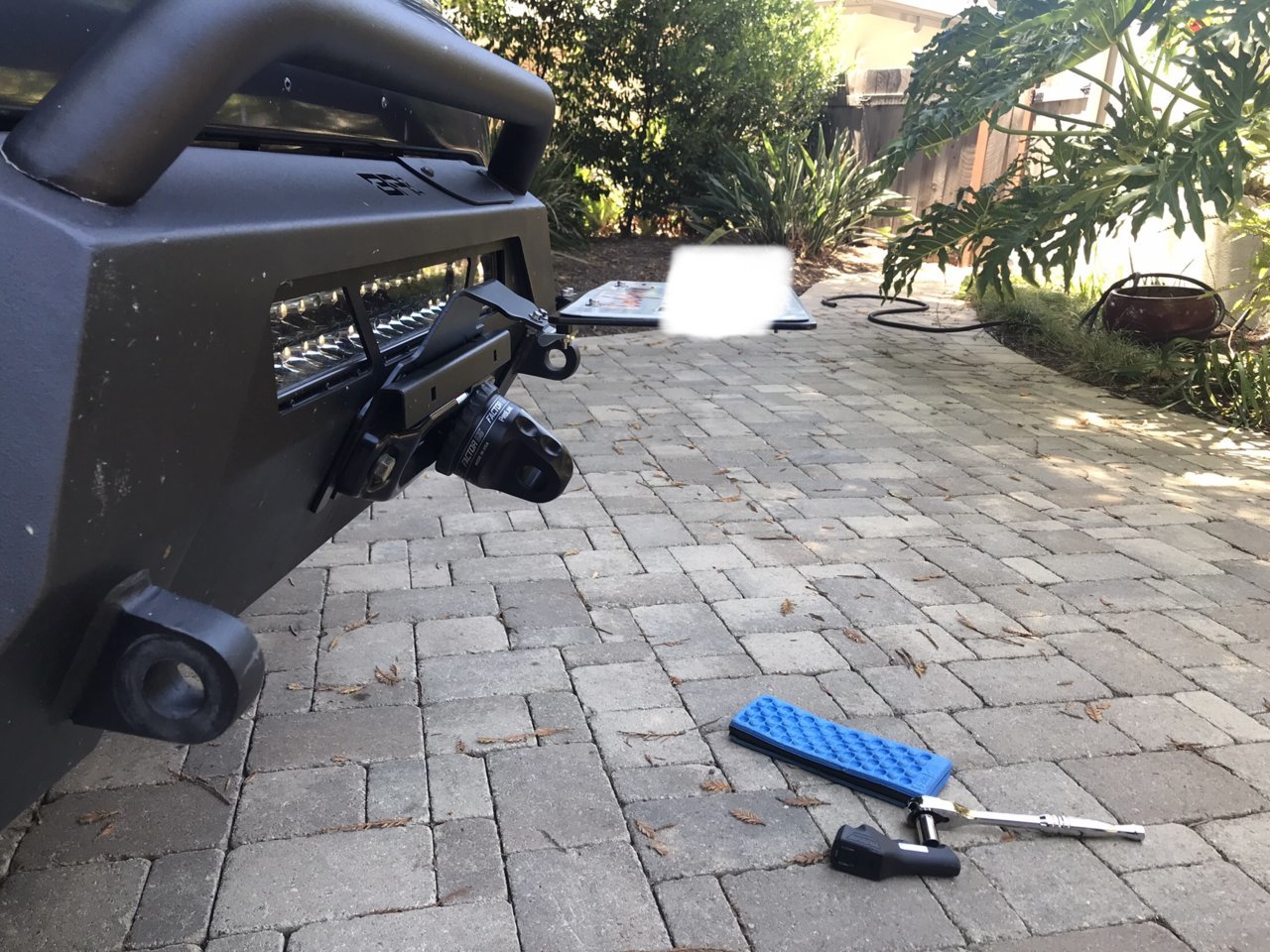

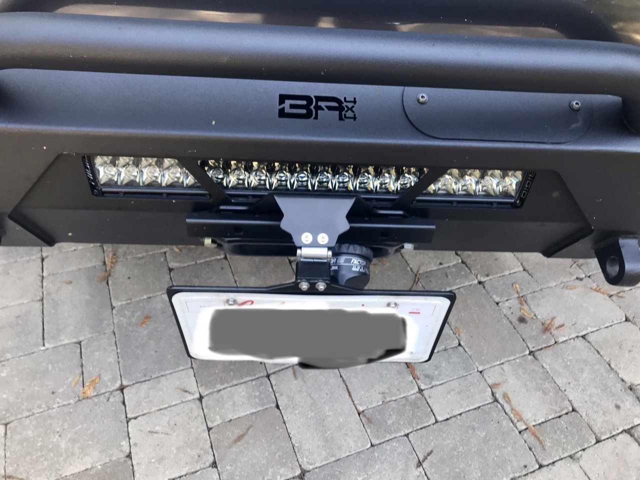

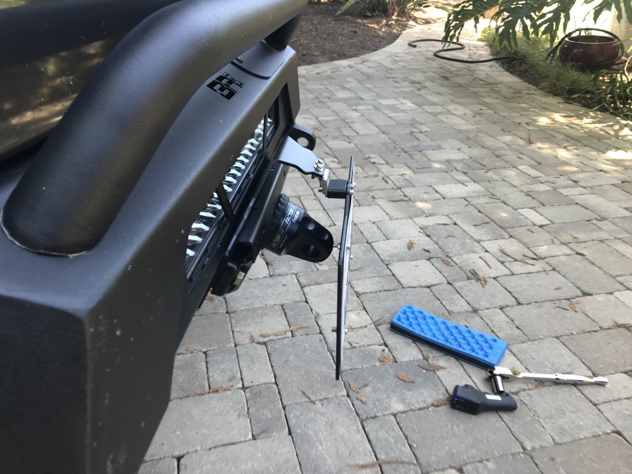

    Installed Cascadia Flipster V3, a necessary evil. Looks pretty good.

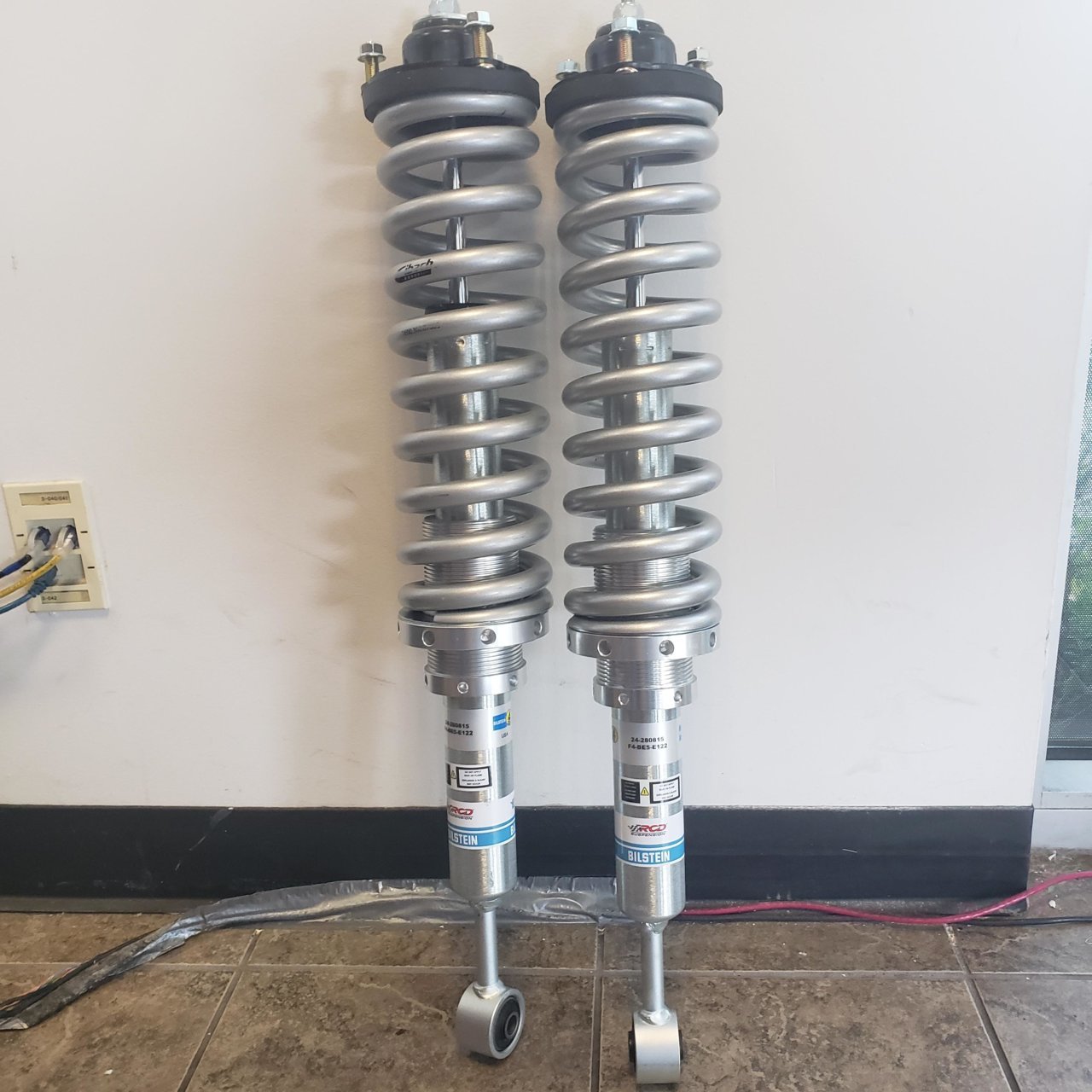

    Just got these coilovers. Bilstein 5100 extended length shocks with Eibach 700# coil spring. Ordered from Fat Bobs Garage, $981.00 shipped, installing later today, will post more pics after install

    That looks clean, I need to redo my switch wiring. I added them over time so its a rats nest, theyre all labeled and color coded but the wiring is horrible.

    Thanks, looking forward to that. The color is the only thing holding me back from making a purchase.

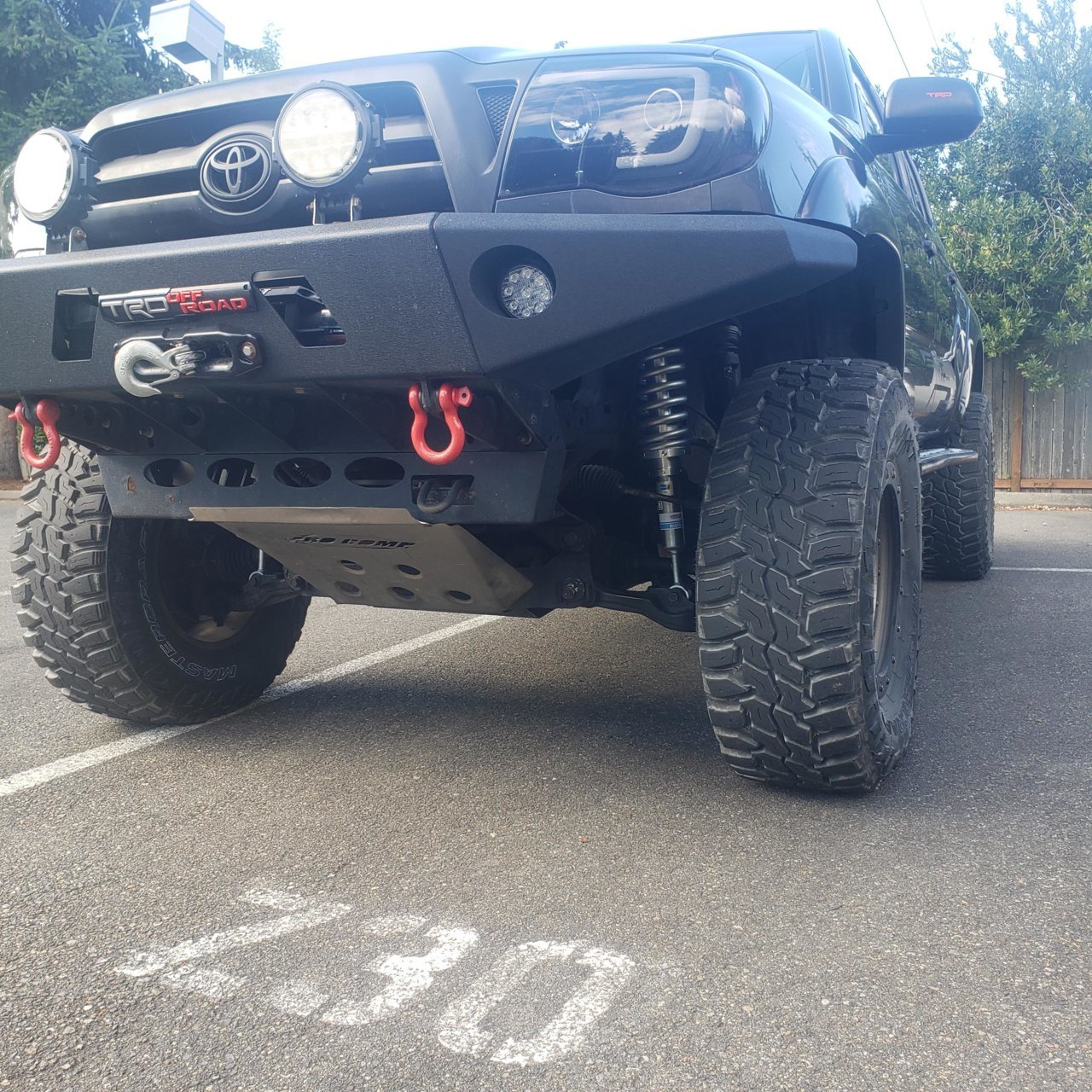

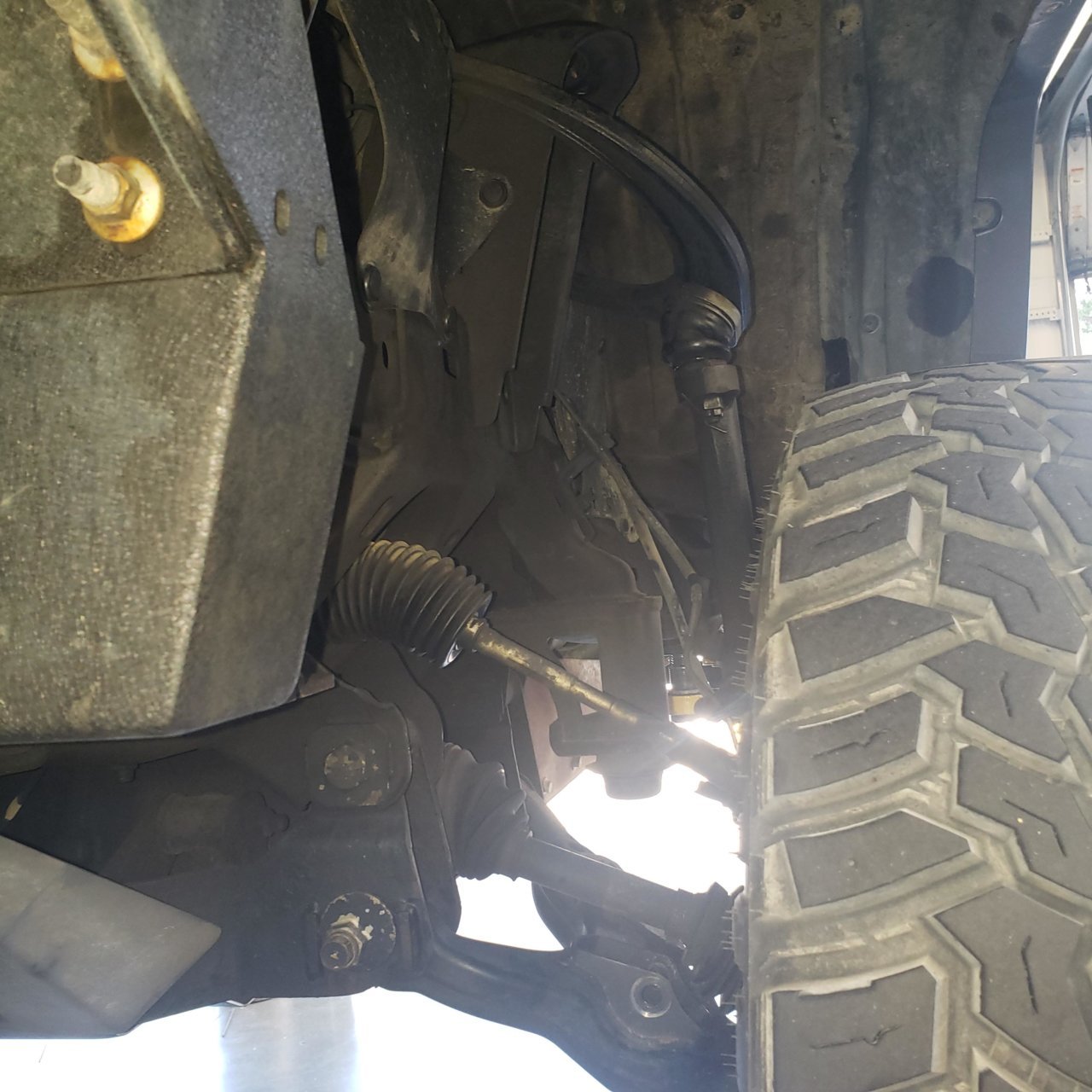

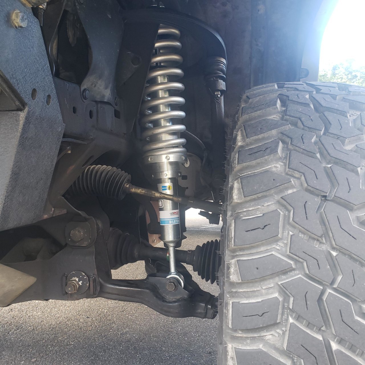

    OK, coilovers are in, went pretty smooth!! I was able to get them done without so much as removing the wheels. Unbolted, worked the old struts out, slid the coilovers in, torqued, done. I was glad I did not have to remove the ball joint, control arms, etc... Sits a little higher in the front with the 700# spring, but after a quick test drive, they seem to be settling a little already. Might have to adjust the ride height down a bit, but pretty much a bolt in upgrade! Now to get the alignment done...

    So no sway bar to deal with. Surprised that went so well. Hoping my swap to 3rd gen coils/struts goes that easy (I do have to drop sway bar).

    Yeah, I deleted the sway bar long ago, will never go back. It brings the suspension to life off road, not much more body roll at all. I probably would not even have notice if I was unaware it was removed. I actually picked up some used 3rd gen struts as a quick fix until I found the coilovers I wanted. They bolted right in, no issues what so ever

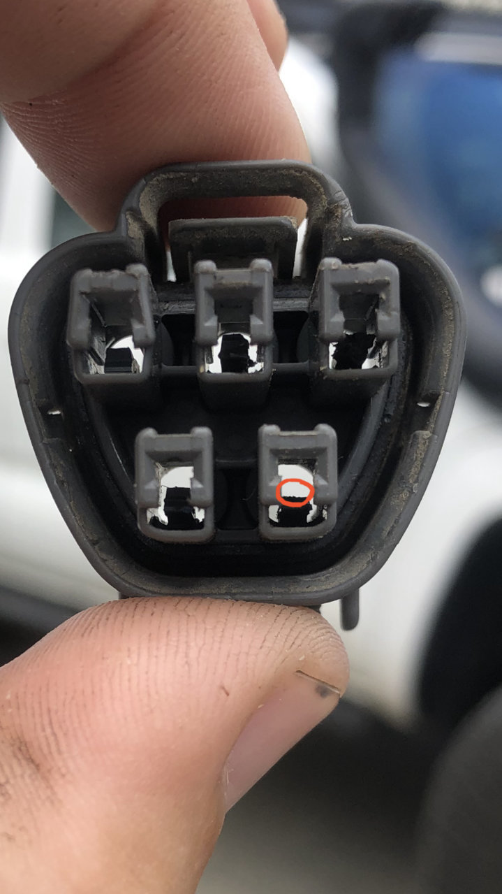

    I did the tweeter switch and the driver side has no sound but the passenger side sounds great.

    I’m pretty sure 6112 with spring is cheaper and a much thicker shock higher up in the Bilstein model line

    Check the wiring. Maybe the blade is not completely set in the connector. It is def something in the wiring. I assume you did the blade swap in the factory connectors.
