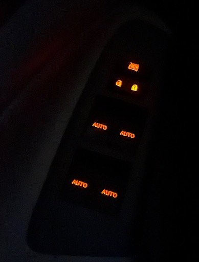

    I chose the orange/amber option and it's perfect OEM match. Dim enough to not bother my peripheral vision, but easy to see.
    https://cartrimhome.com/Door-Switch-For-Toyota-Tacoma-2012-2015

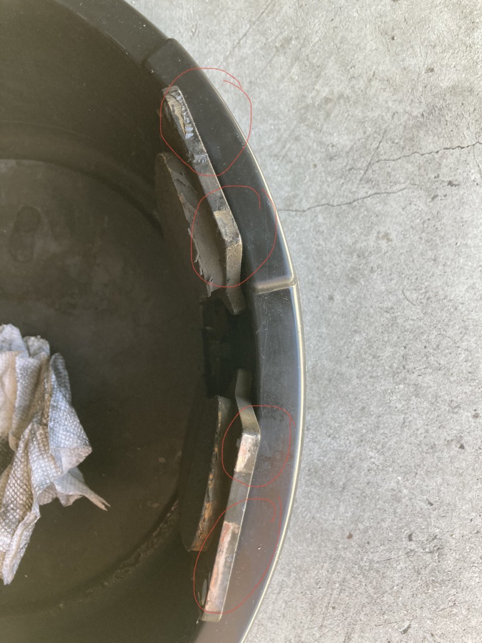

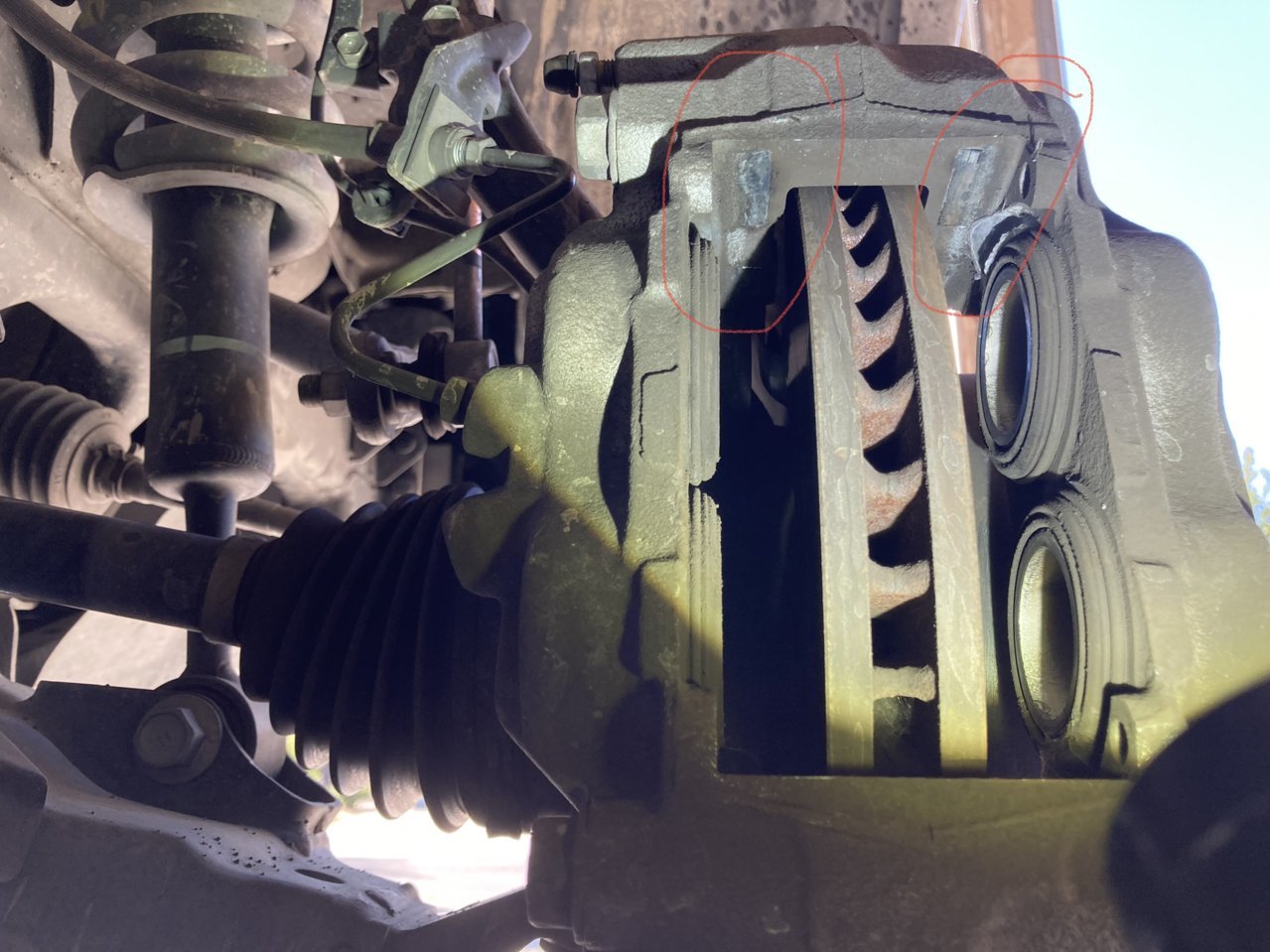

    Replaced the brake pads, retainer pins, retainer pin clips, and pad “springs” on my Taco. My son helped me out, and it was a good learning experience for him. I could see the change in his confidence level working with tools compared to a year ago. The rig had about 55k miles on the original pads, and there was 3-4mm of pad remaining, but we changed parts out in hopes of getting rid of the brake clunk after changing reverse to forward or vice versa. No clunks on the test drive after the job was done. Here are photos of where I believe the clunk came from. Added a bit of brake pin grease to the upper and lower edges of the pad backing plate, as well as other typical locations.

    I always hit that spot with a wire brush and add a small amount of brake grease.
