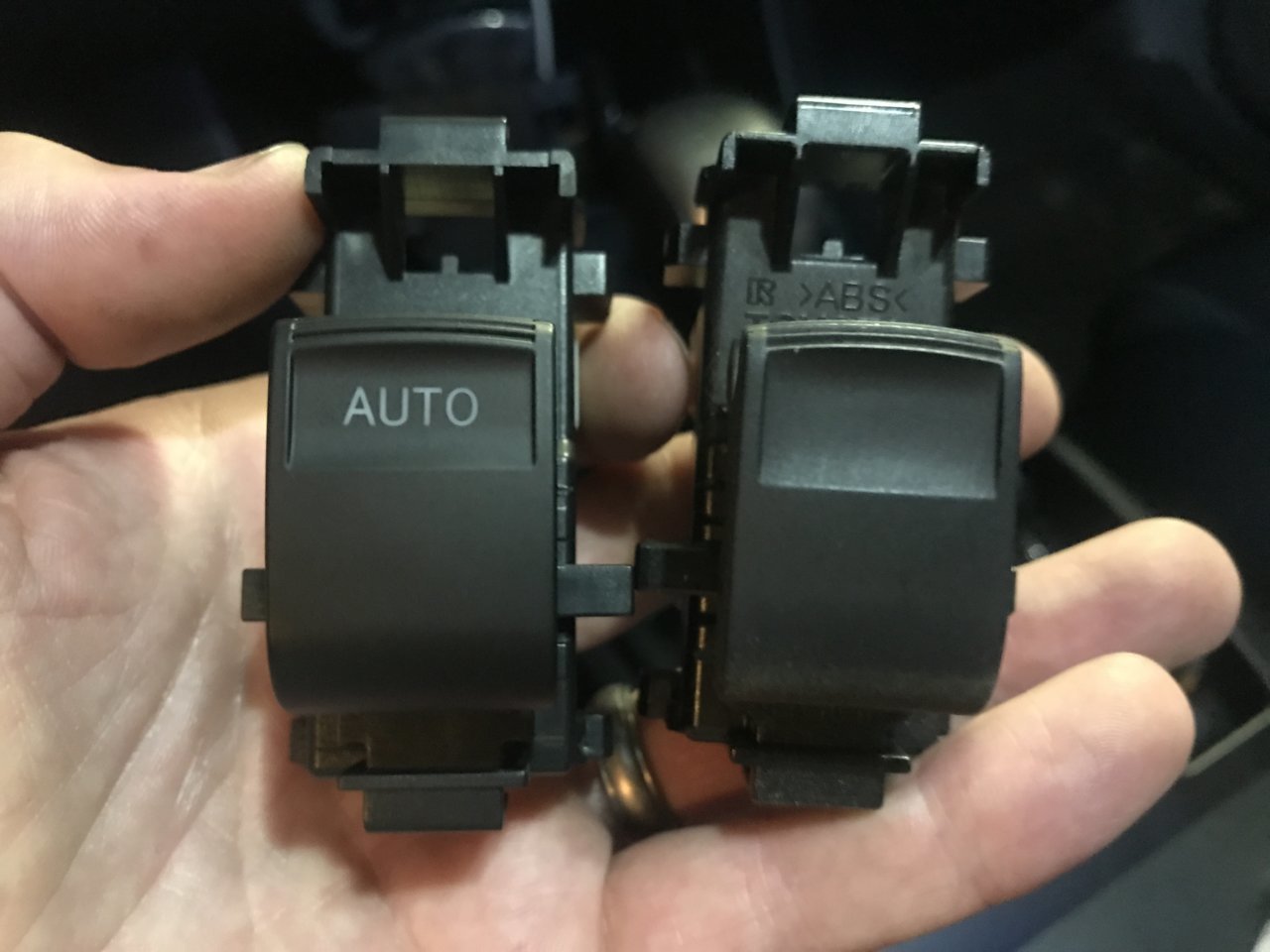

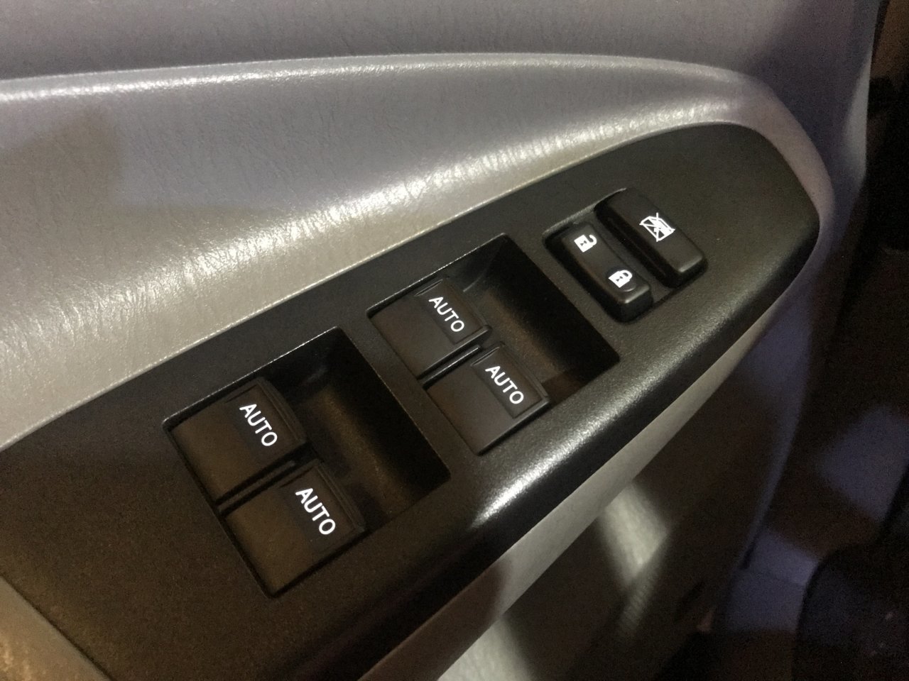

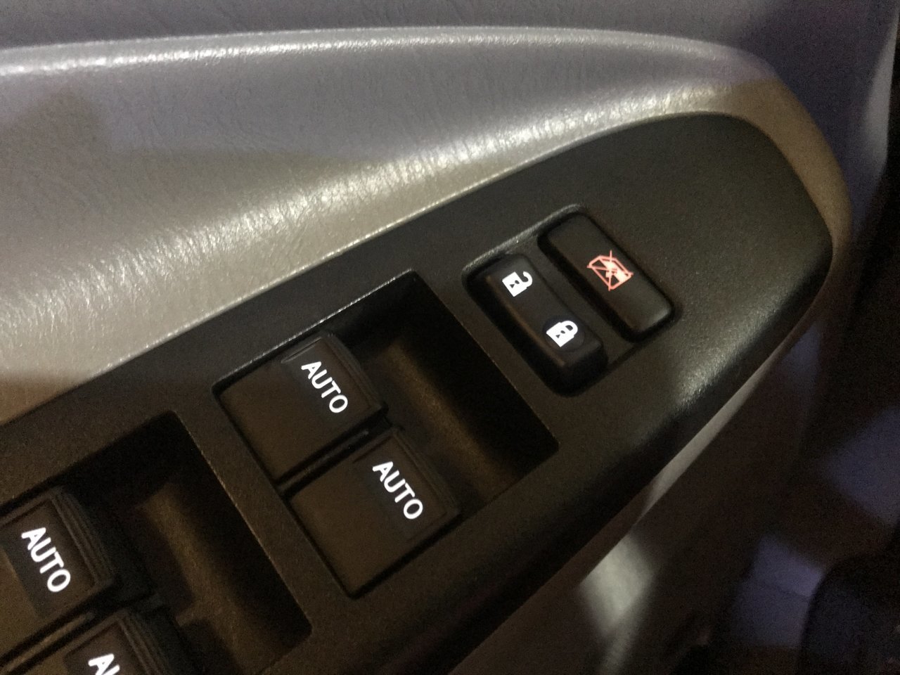

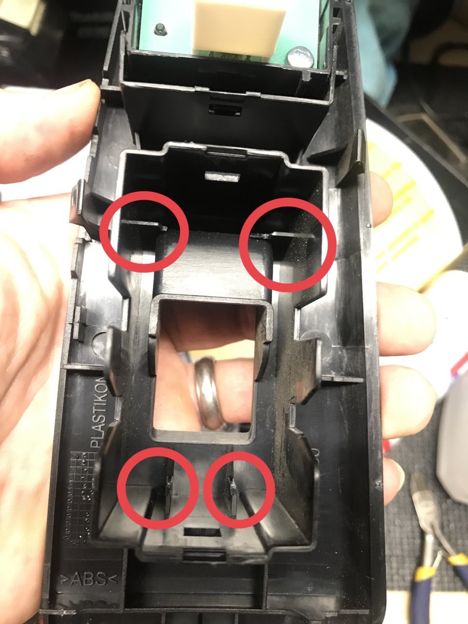

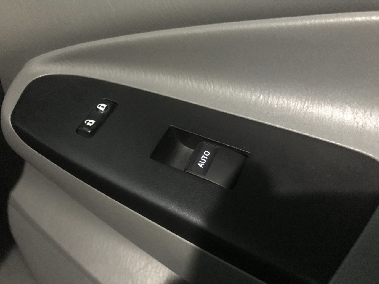

    May seem a little over-priced for a minor upgrade, but man does it make me happy. 4-door driver auto up/down switch AND passenger auto up/down switch. Their green is much brighter/deeper than our OEM yellow-green so I ordered white and it's perfect/subtle. Needed to shave a few spots on the passenger trim piece so it'd snap in properly but easy fix (see pic). Window lock light turns red when engaged.
    Use kingsev7 for $12 off. Paid the $2 shipping option and had it to my door in Simi Valley in 3 days. Also ordered their lighted driver door switch for our 2020 RAV4 (you know the pain if you own one) and the ice blue light matches perfectly.

    im ready to make the switch and buy the switches... problem i have right now is.. i found the driver side cover in black. its like 12-15 bucks or so.
    my problem is why is everyone selling the passenger side cover only for $50. wow just wow.

    Honestly, I would buy a can of Shadow Black Hyperdip and paint them both. After years of mixed results with Plastidip, I've been using Hyperdip lately with awesome results. Can't believe how much darker, smoother, and more durable the finish is.

    well im changing out the switches on both sides so the covers wont match. dont think the 2012 passsenger switches will fir in the 2011

    Nope, and I think the auto up/down feature only works with 12-15 wiring even if switches/covers fit a 2011

    The included auto up/down passenger switch DOES illuminate and matches the driver switches (whichever color you choose). Fyi, they all illuminate with the ignition and not the parking/headlight switch. In other words, they’re on all the time.

    is the auto function built in to the switch? I guess im asking if there is any additional wiring needed or just plug and play?

    from all the vids/reviews its a simple plug n play

    Plug and play, they've had Tundra ones out for several months and people have been using them. Some people have issues with the auto function not working all the way.

    Yeah, it’s important to know that with this window switch upgrade, the anti-punch feature only works on the driver side door since it’s built into the door mechanism, not the switch. This upgrade would definitely be risky with dogs and kids.
