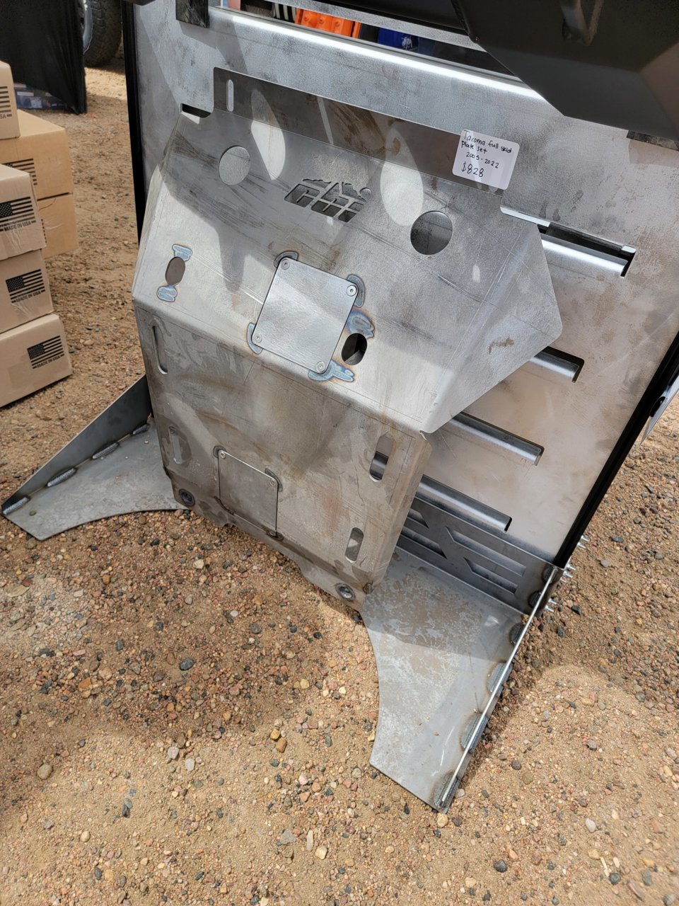

    Went to overland Expo and splurged a bit. CBI full skids.20220826_133103.jpg
