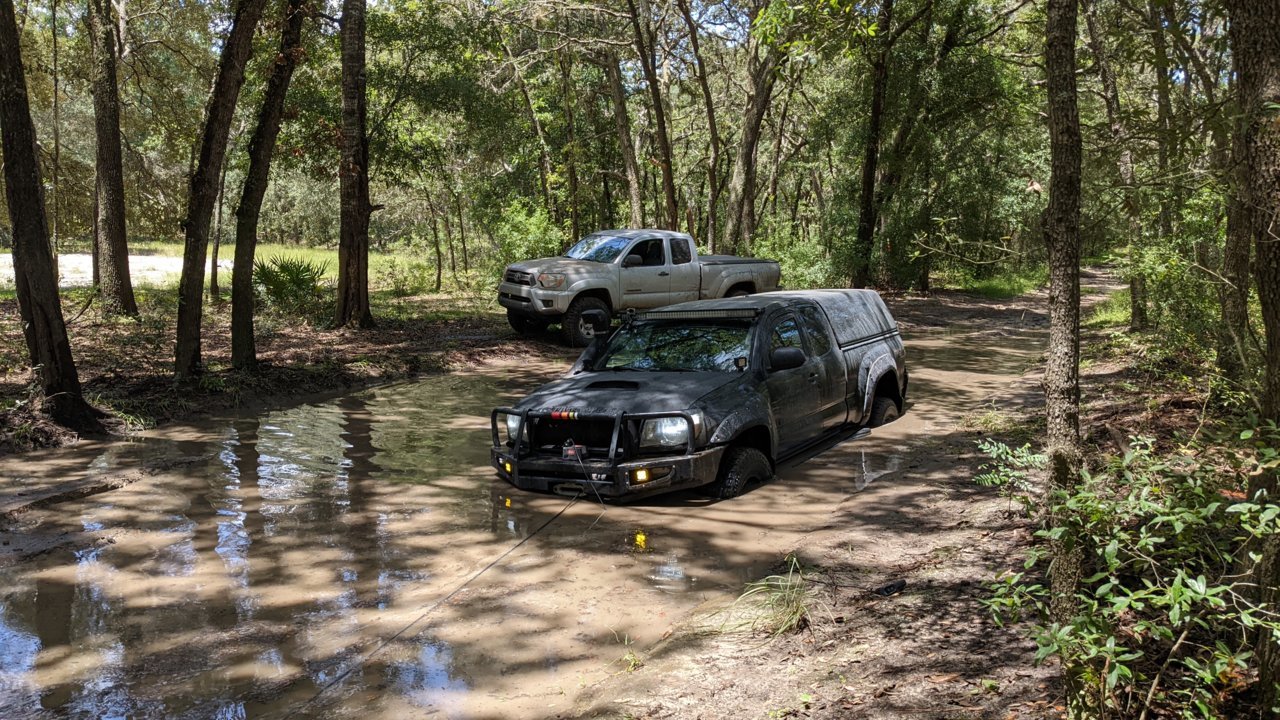

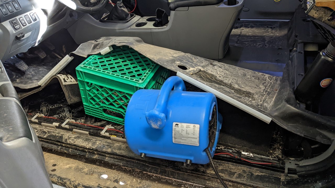

    Wow that's a lot of work! Just thinking are the differentials and transfer case totally sealed? I had to replace a Jeep rear end playing in the river once upon a time.

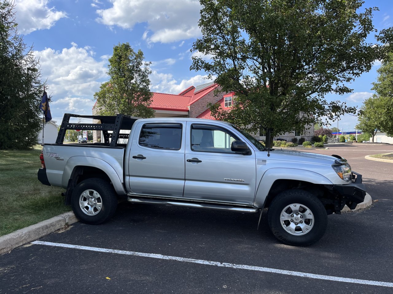

    My Truck lost some weight and gained a little back in the last few days.
    No more Leer cap, now with a KB Vodoo Max bed rack (thanks to a tacomaworld member).
    now to throw more stuff on the rack.. :D

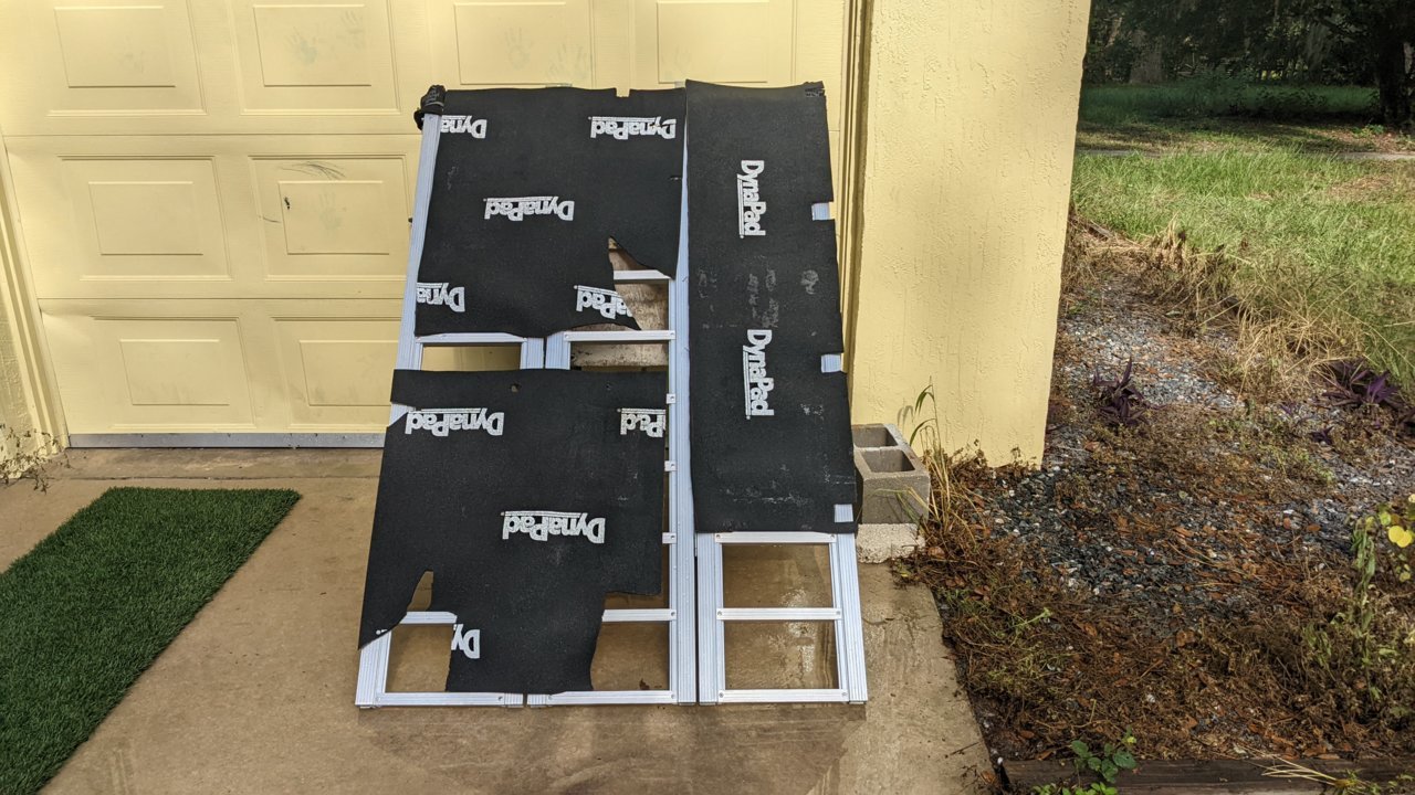

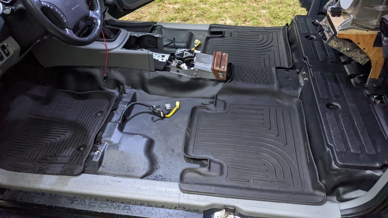

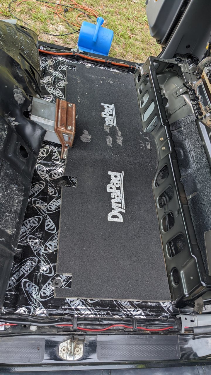

    Wasn't in there for more than about 5 minutes and it ran the whole time, my rear diff breather has been extended into the rear bed cubby and was dry and my trans transfer and front diff breathers have all been extended up into the engine bay so bo worries there.

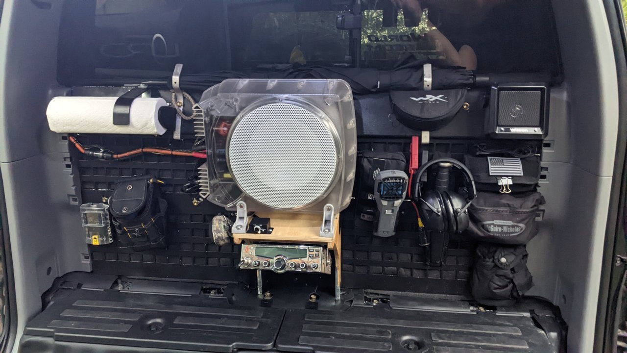

    Paper towel hanger is a must :thumbsup:

    One of my all time favorite mods. :rofl:

    Just need a disposable glove dispenser and you'll be dialed! :rofl:

    Don't have a dispenser but I do keep a bag of them in the trauma kit and another in the trail box.

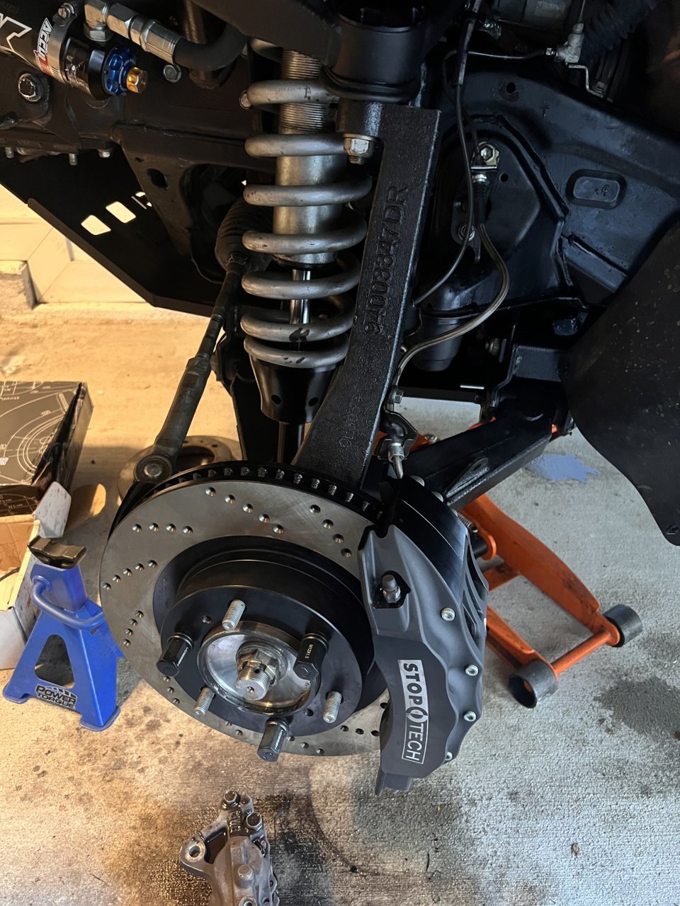

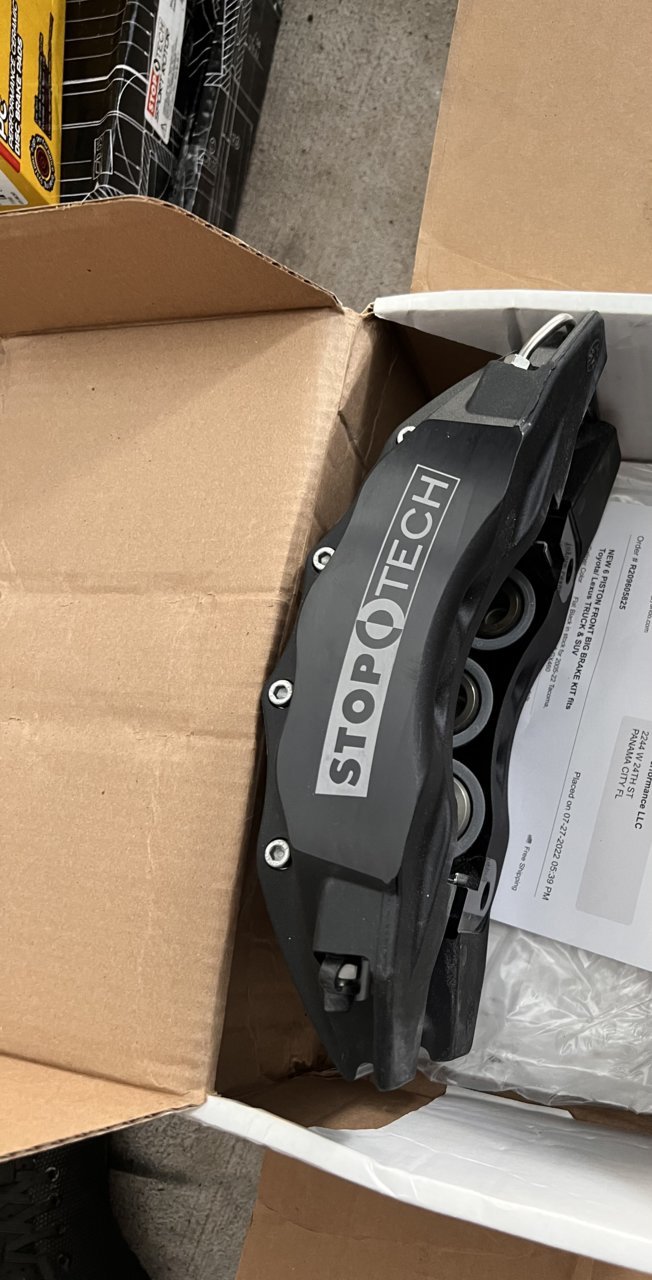

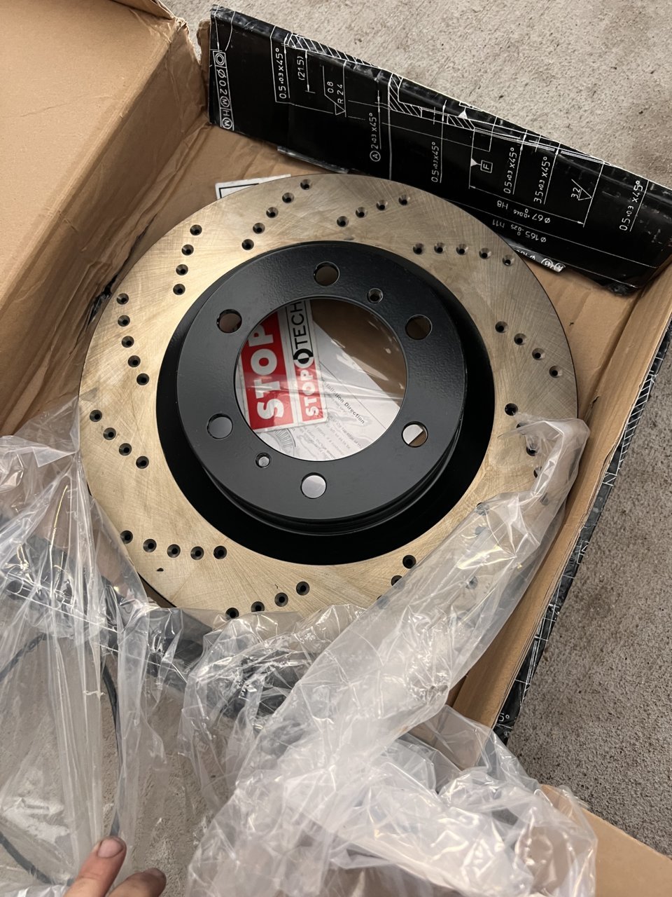

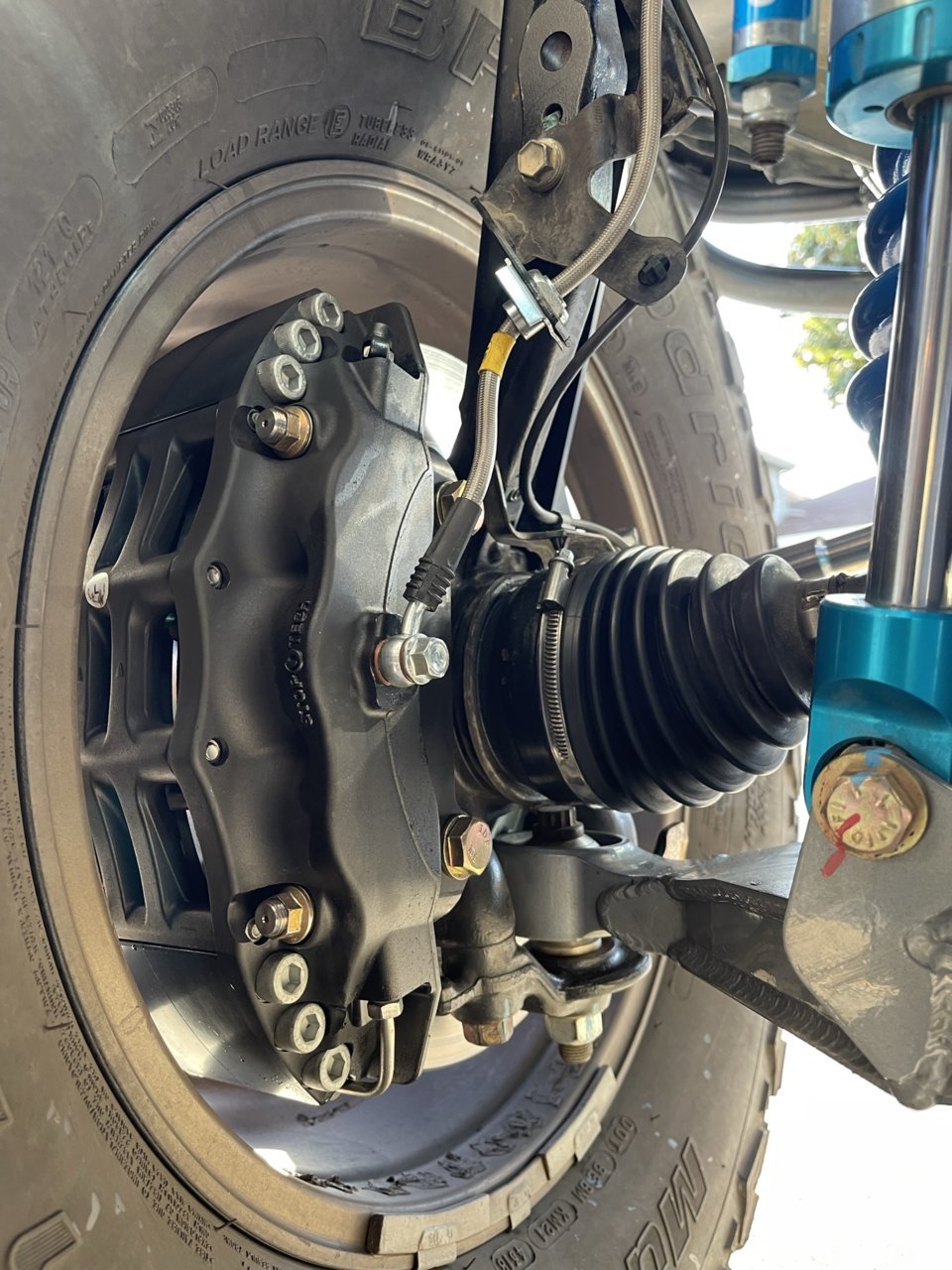

    Break job… now to bleed the breaks

    Can you do stoppies with those? :eek:

    I’ll tell ya once I get the spongy out of my pedal lol

    OOF, I hope you didn't drain the rear half reservoir in the brake fluid reservoir and get air in your ABS block.

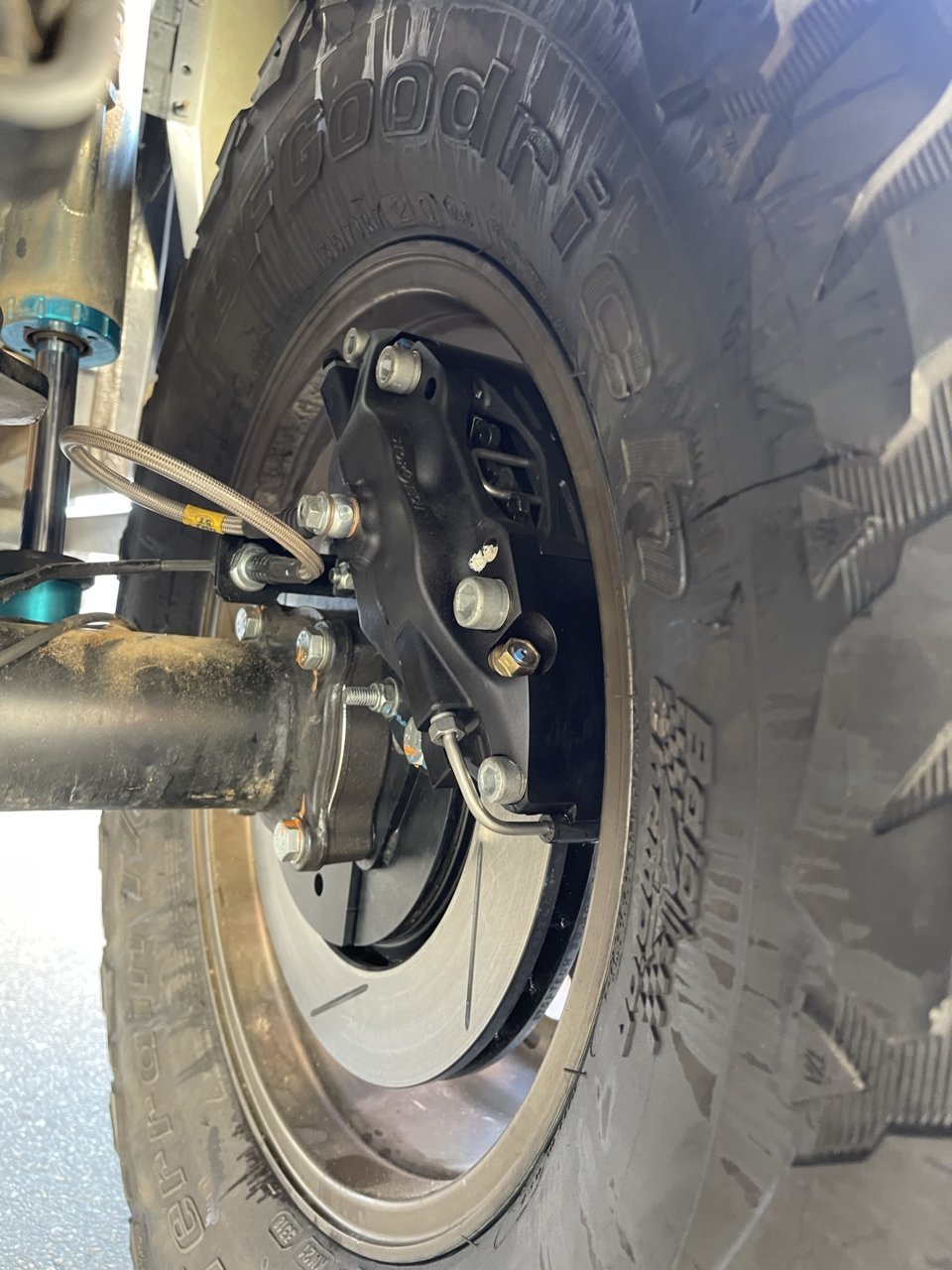

    Nice setup. I just did the same with matching rears. Great color choice! Not sure when you ordered but took forever to get the Matte Black 6 Pistons

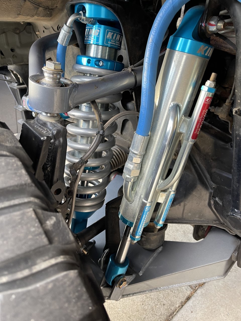

    Did you zip tie the break line to the abs mount on the spindle? Mine is a little long and I don’t want my tire to rub it I was thinking about opening that metal clip for the abs line and secure it in there with it

    I’ll snap a photo of see if I have one. Zip ties are def involved

    I also likely have longer lines. Forgot which ones we used but I had ordered longer ones after but Same principle.

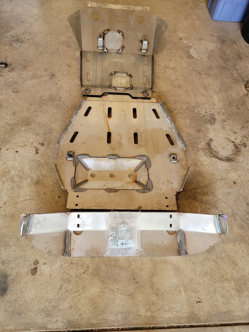

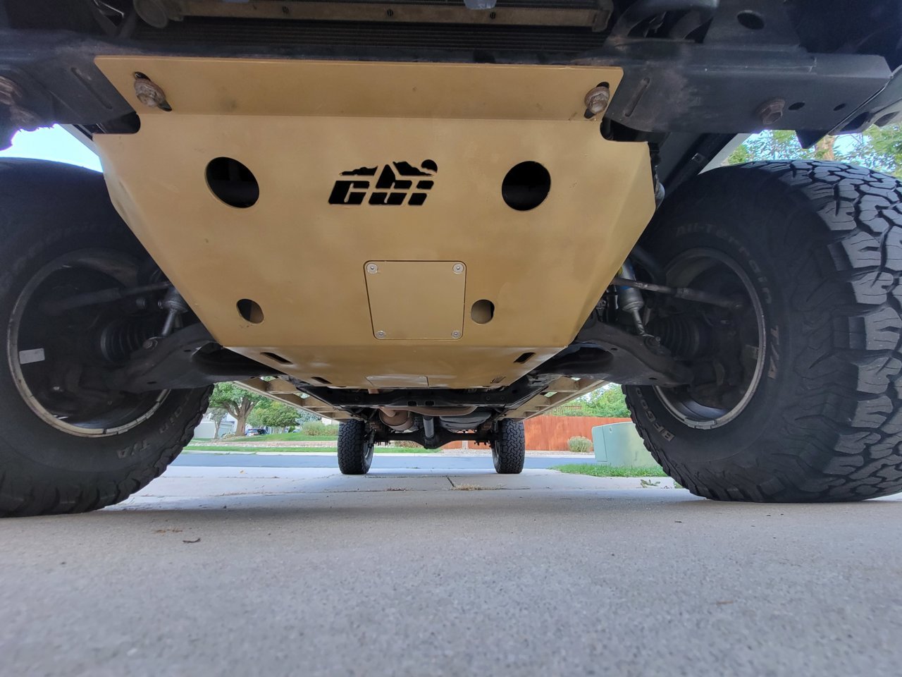

    Primed, painted, and installed the CBI skids!! 20220827_150138.jpg 20220827_185851.jpg 20220827_220326.jpg

    Oh man. I’m jelly. My brakes are fine for me, but jeez that looks awesome.
