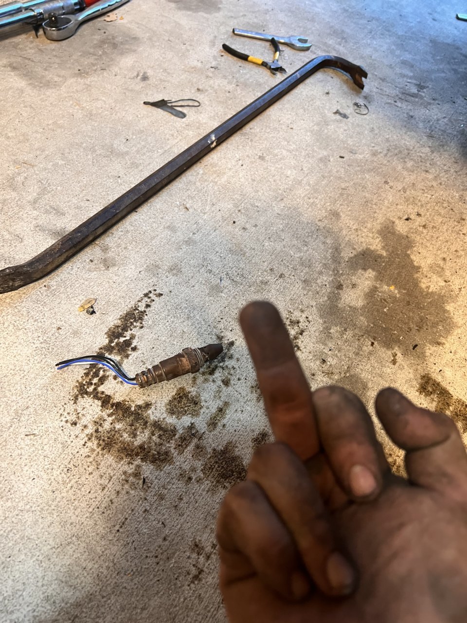

    Check engine light after using some fuel system cleaner… that’ll be the last time I do that. Code read lean on cylinders 1&2 turned out the bank 2 upstream o2 sensor wasn’t reading. So I swapped out both upstream o2 sensors with OE direct fit denso, incase you guys didn’t know these little babies are expensive AF $240 each and a PITA to change! passenger gave me hell ended up cutting a cheapo 22m wrench in half and using a pry bar to get leverage to get it broke free and get the job done.
    also added a little reminder in the cabin

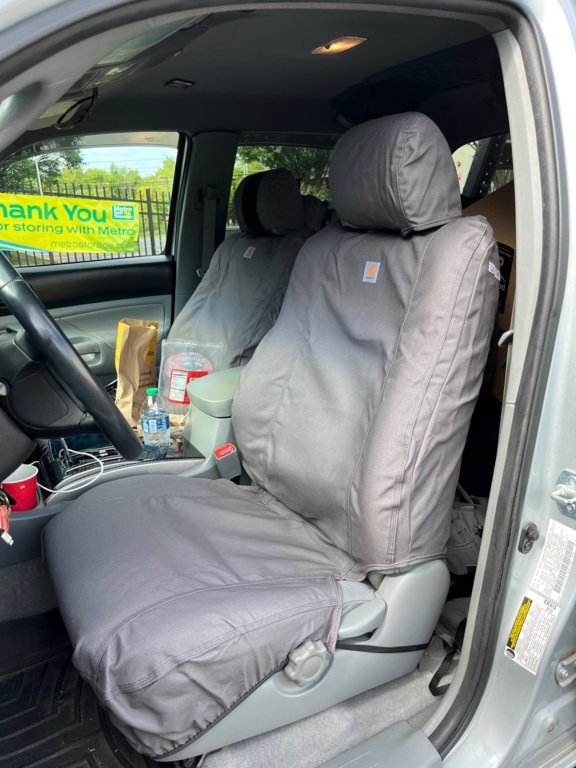

    Put on some carhart seat covers:

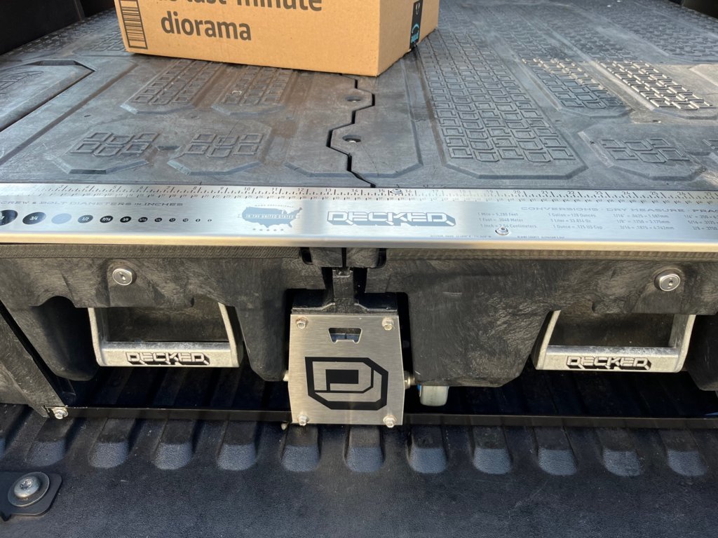

    And
    refreshed the rusty ruler and bottle opener on my Decked unit and installed their drawer locks.

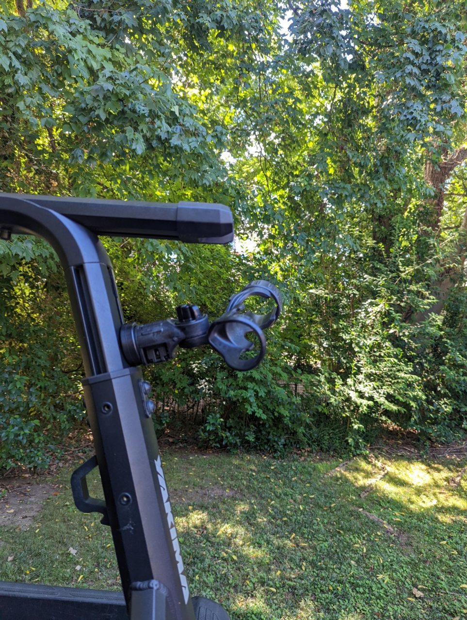

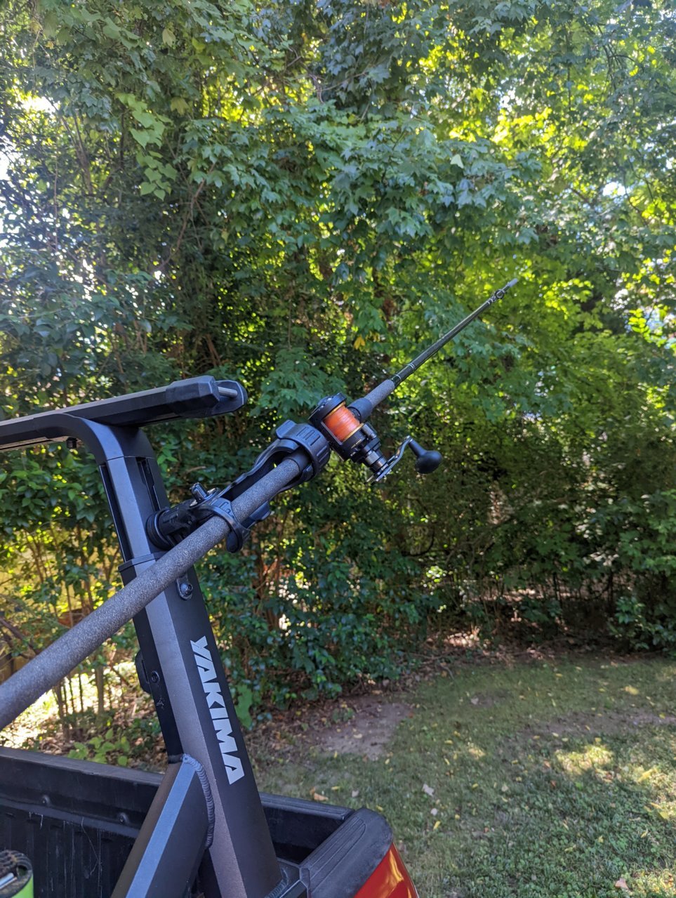

    Been looking for a park and pop surf rod holder solution that'll work with Yakima Overhaul towers. Yakattack Omega ftw

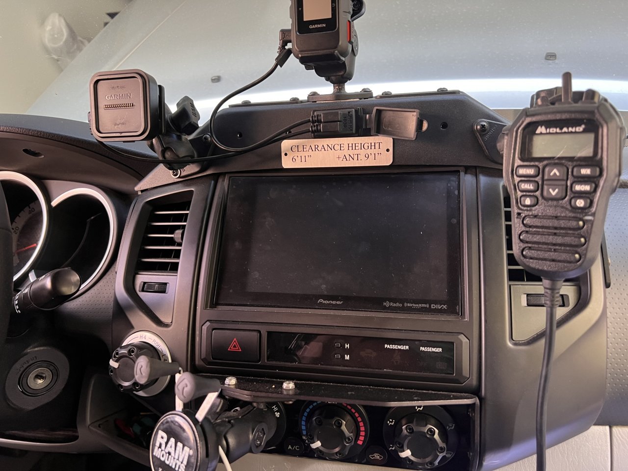

    Looking for what size fuse tap to power my CB? Is 15 Amp too much to connect to cigarette lighter or can I run it off the ignition?
