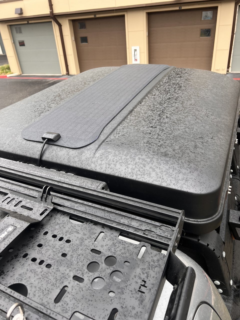

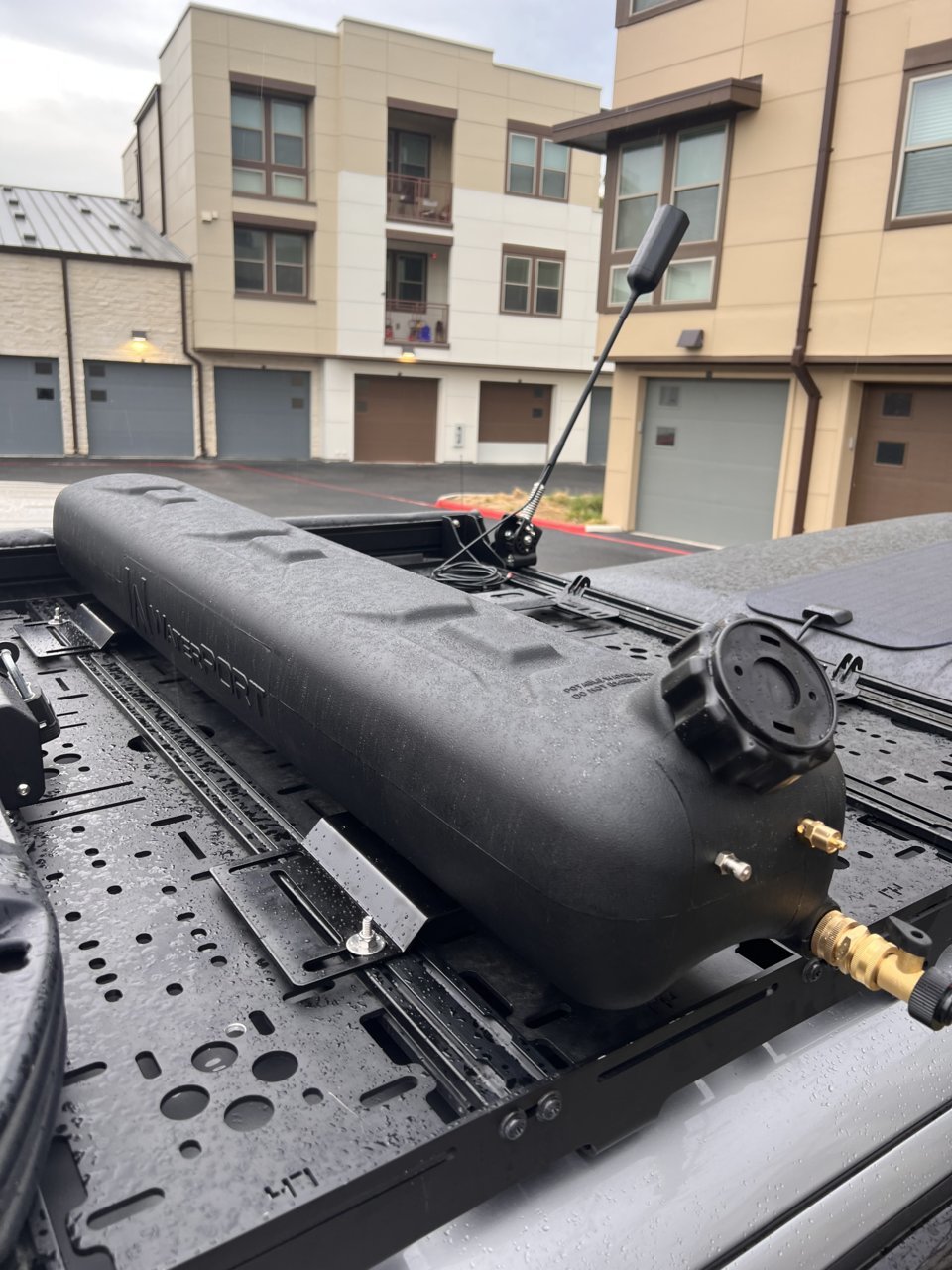

    Mounted waterport weekender as well as Half ass installed Weboost antenna and solar still need to tackle the fun part. I’ll do all the wire routing to the inside of the cab with the solar panel together.

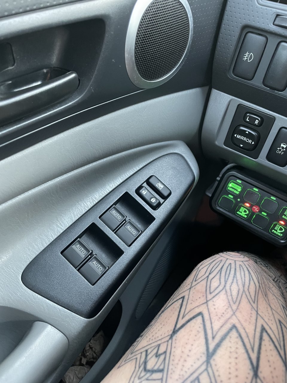

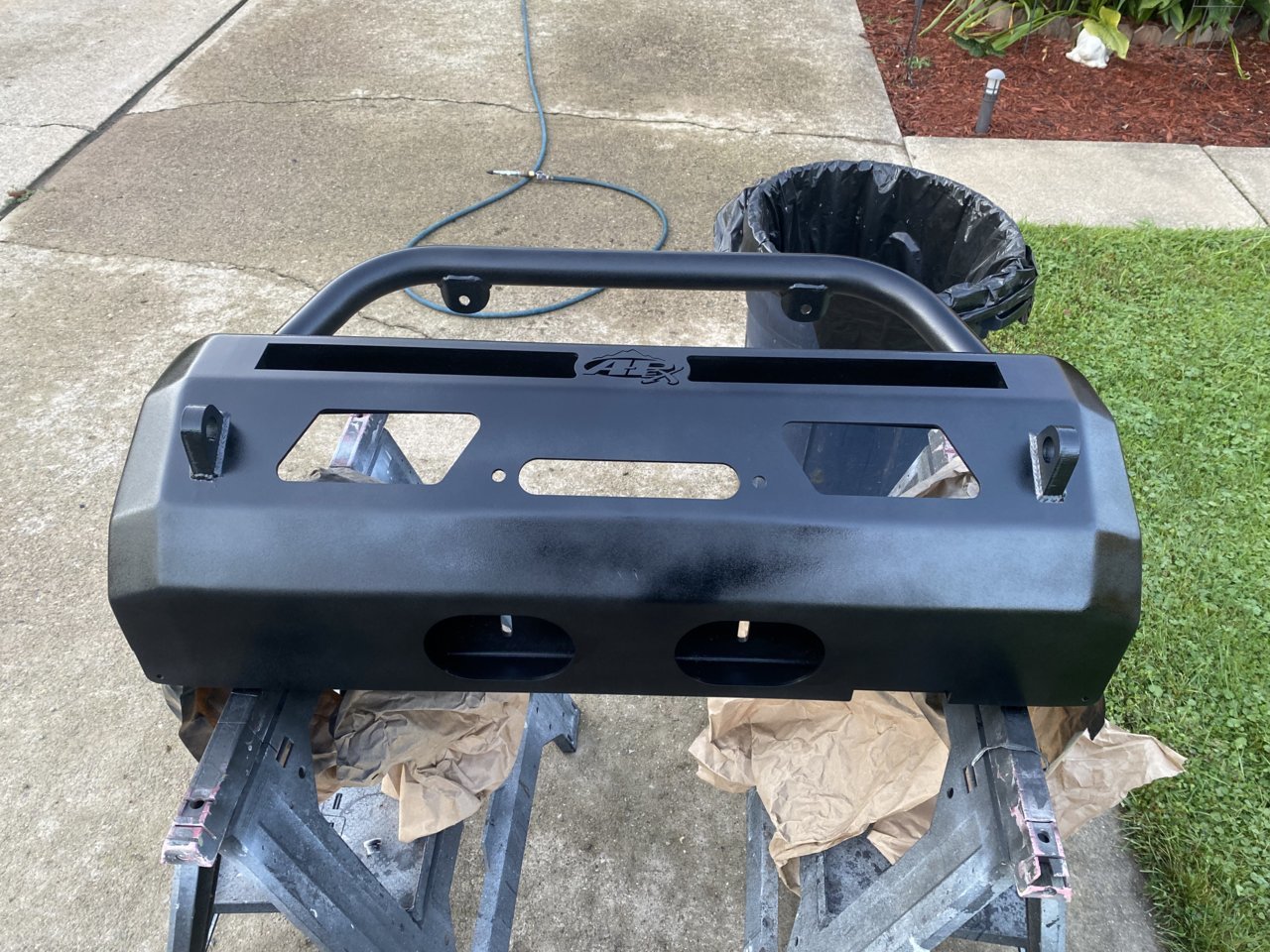

    Prep’d and painted the new front bumper.
    Still need to do a final top coat to even everything out.

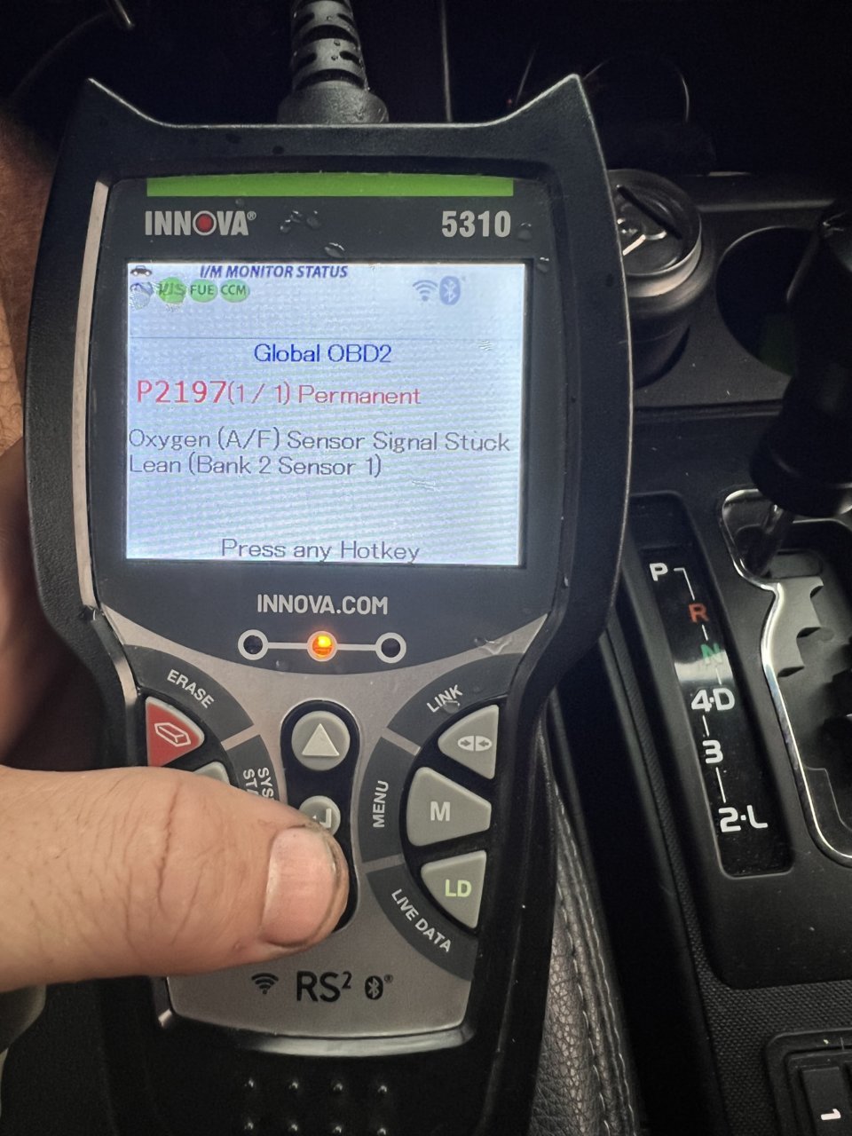

    Anyone know how to unstick from lean?

    I’ll start by visual inspection of the wiring. This code the sensor is out of parameter for 10 cycles straight. Once you have done you visual inspection I recommend you to disconnect and then re connect, just to make sure contacts are clean. Then you have to inspect for vacuum leaks in the engine past the throttle body. Easy way to trace some is by spraying start fluid(or something such as brake cleaner) in possible sections that could have a vacuum leak) and go from there. Avoid buying shit without testing them first.

    Already replaced both upstream o2 sensors wiring good

    Damn, in my entire career as Mechanic I have only replaced like 2 due to physical damage. Remember O2 sensor errors are telling you that they are recording an A/F ratio that it’s out of parameters prior or post cat’s.
