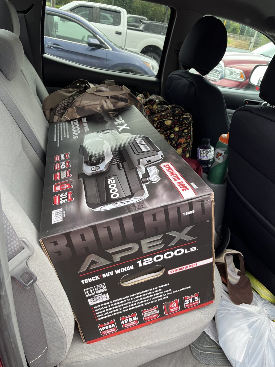

    Over the past couple weeks I installed some rough country seat covers. I work at a tire shop so my seats have been taking a beating, I needed something cheap I could throw in the wash when it got too dirty. I also drove up to Atlanta for a vacation with the lady and on the way back I finally put my harbor freight inside track membership to use and picked up the apex badlands winch and a soft shackle for a little over $500. Now I’m researching low profile front bumpers (and saving up money). I’m leaning towards victory 4x4 but I’ve heard some meh things about their QC, anyone have any experience with them?

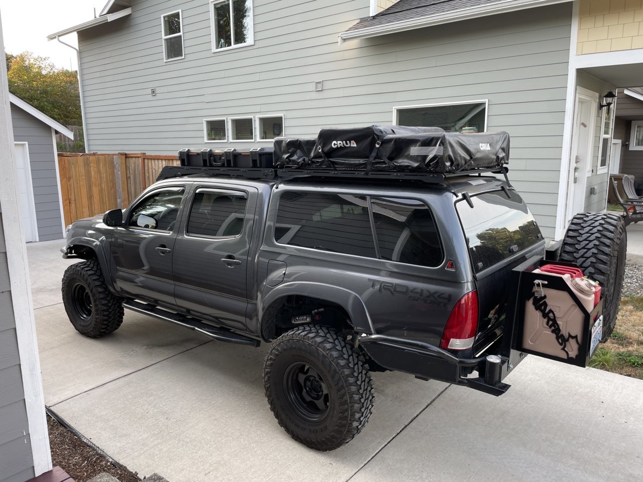

    5 tire rotation at another 5k miles 37A6803D-4819-4FAC-A81A-A80C6F0B91D8.jpg

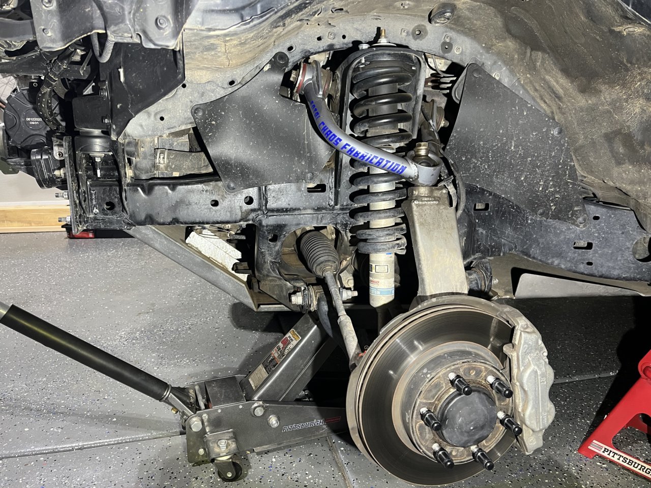

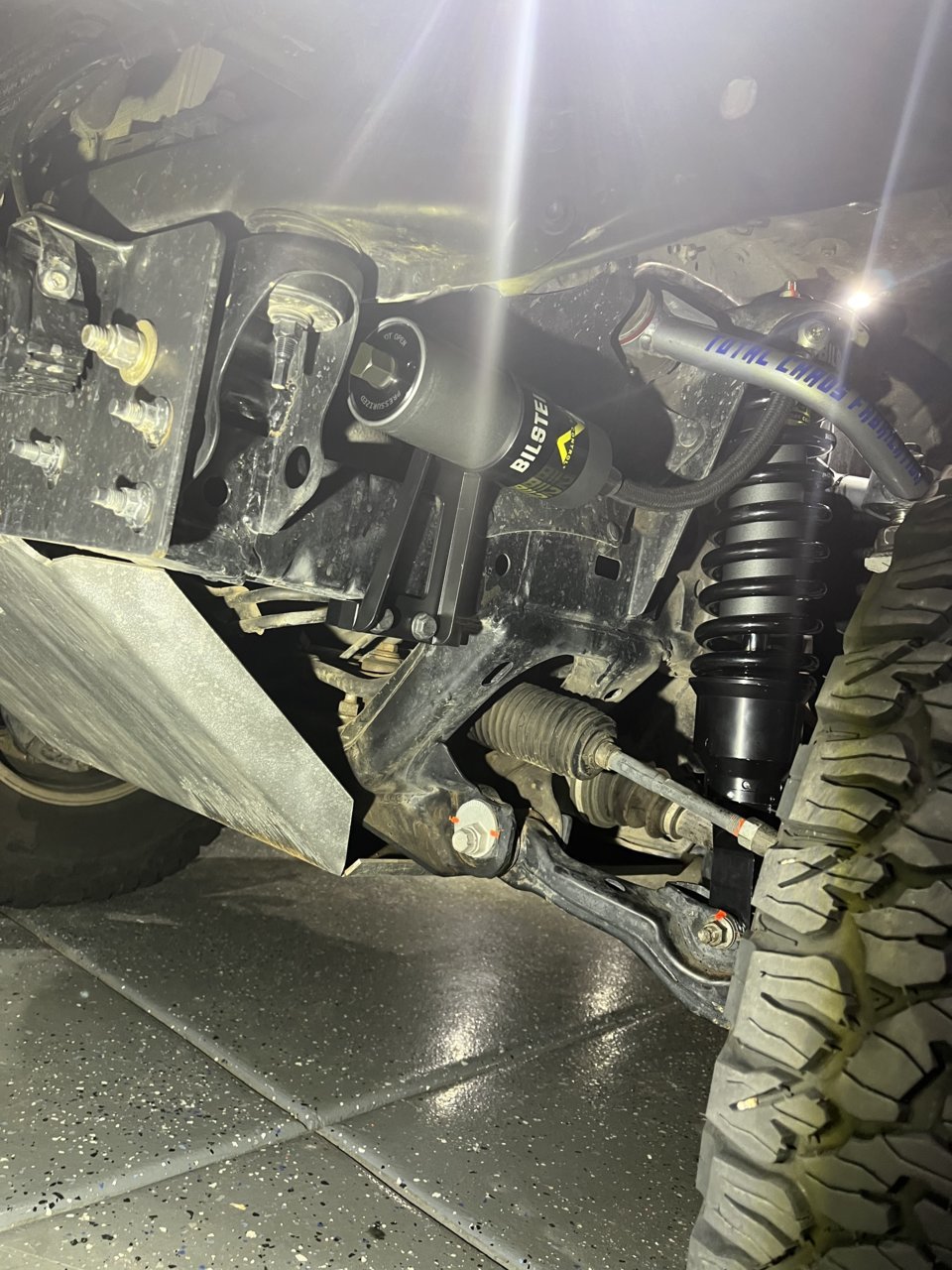

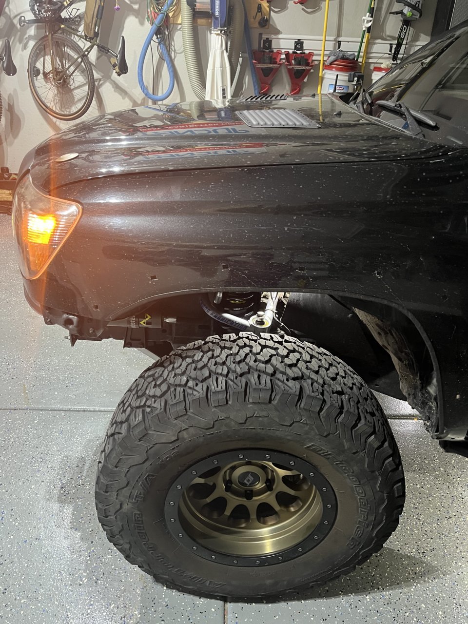

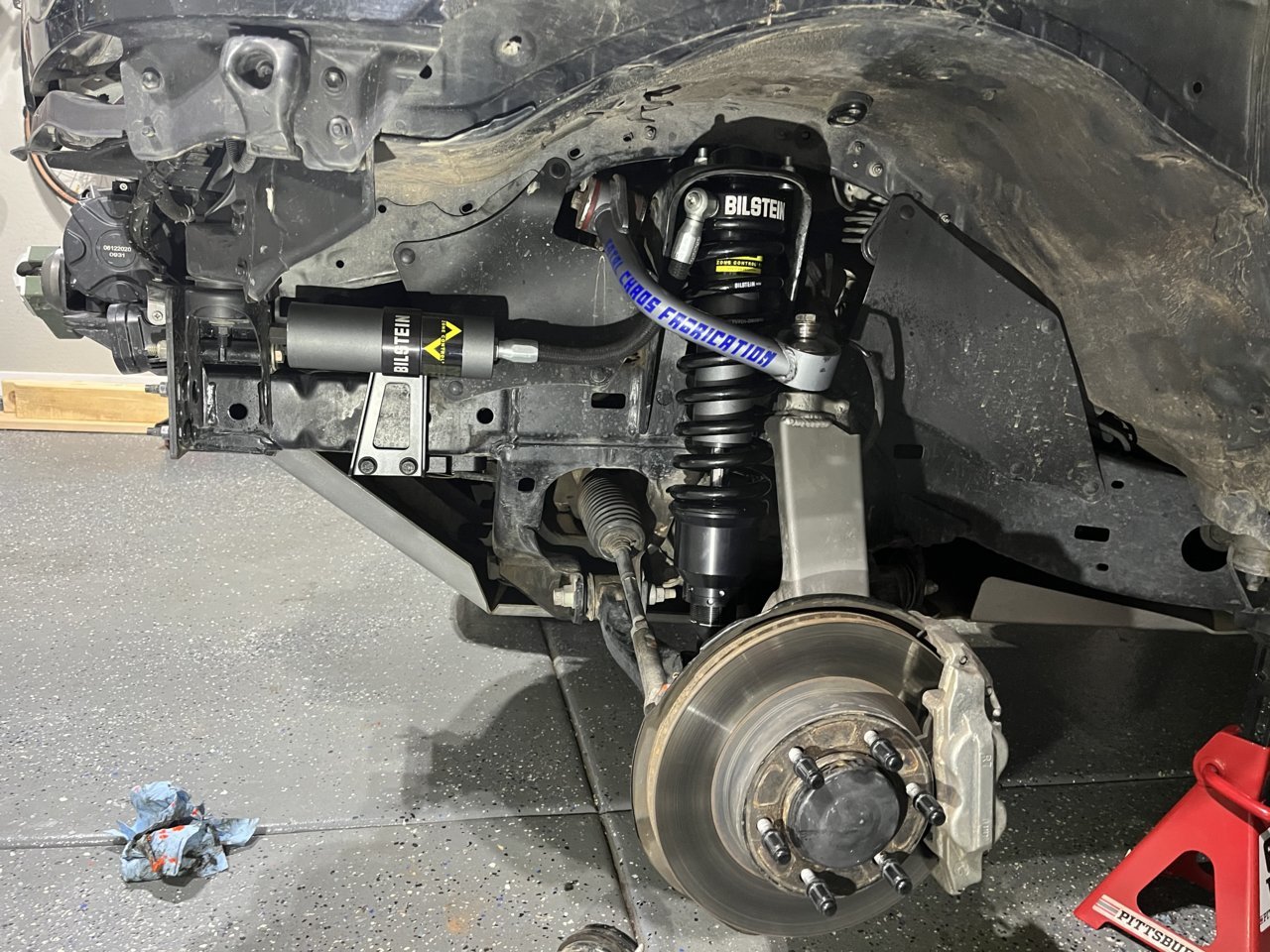

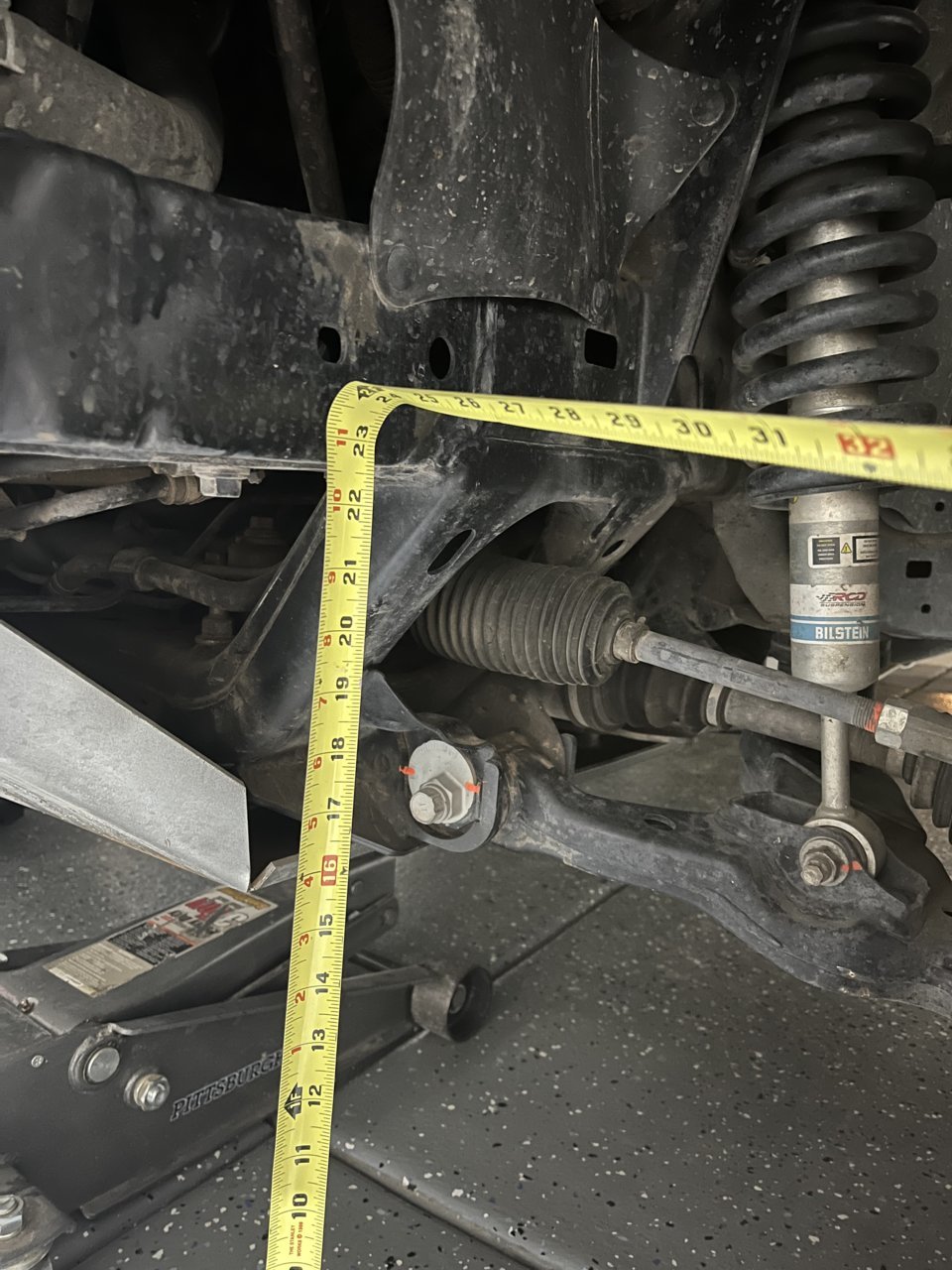

    Installed DS new coilover assembly. After 5 years of Bilstein 5100/ome885 + strut top spacer it was time. New 8112’s going in, did not make any height adjustments out of the box. For reference I’m at about 22.5” from ground to frame rails at the sway bar bracket (see last pic) with 315/70/17 ko2’s. Will do the PS in the next few days. What a difference. What. A. Difference.

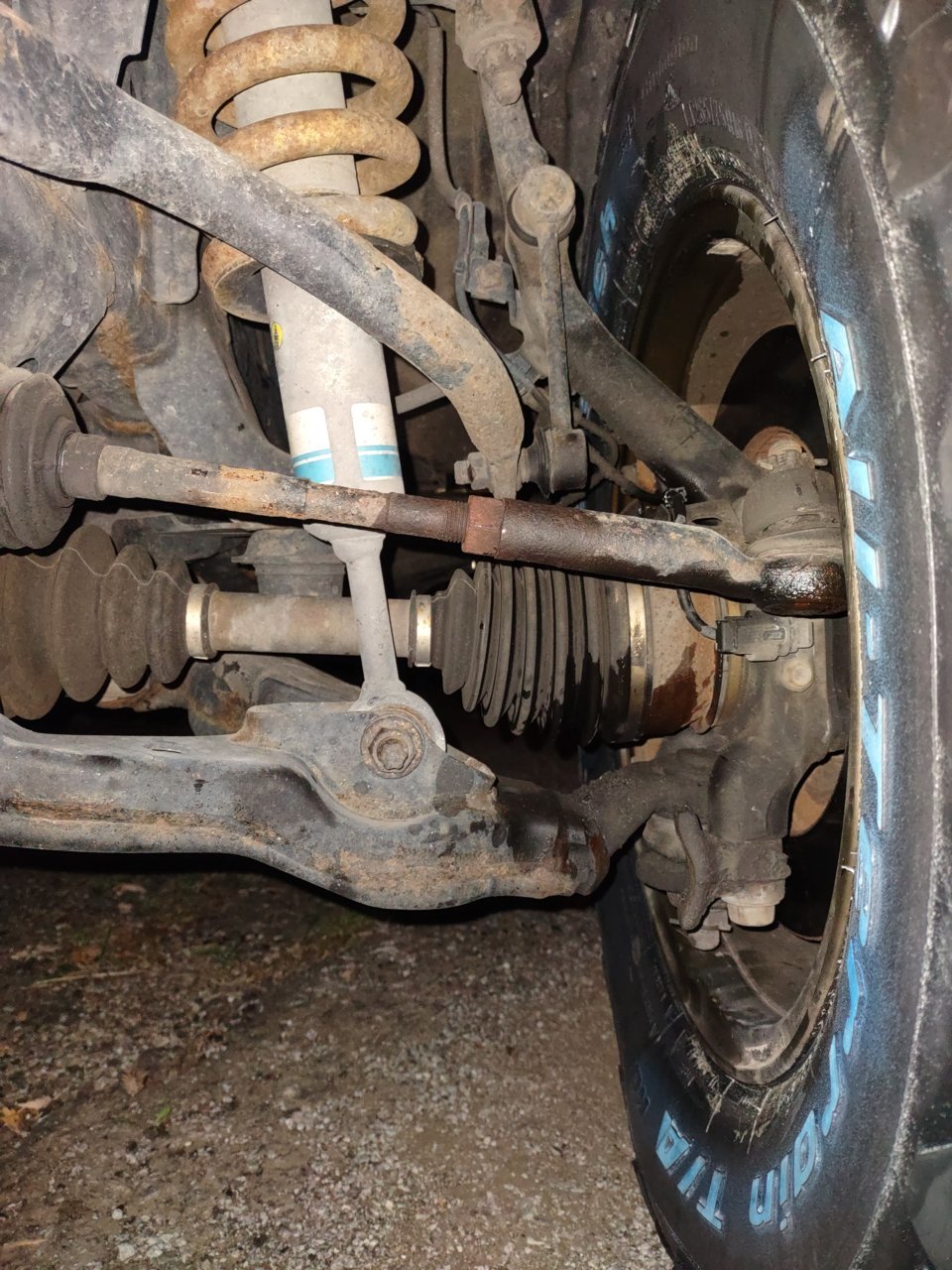

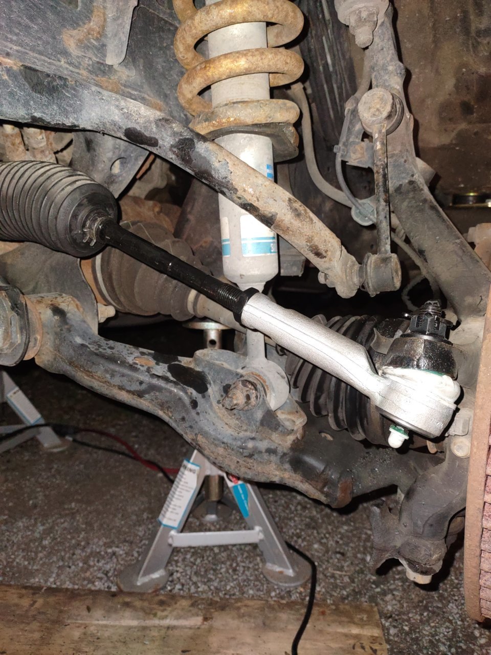

    Replaced inner and outer tie rods. When I went for an alignment they couldn't get the jam nuts moved enough to get it done. So last night I did the job; outers came off without too many problems, had to use a puller on one side. The jam nuts definitely were an issue; had to use the impact to get them off and ended up cutting the inner shaft on one side as it wouldn't go. :curls: It was challenging getting the inner clamp off the boot; there's not much space to work. Mine were the "one-time" use variety but I was able to just pry the clamp open and reclamp it after with my beer-line clamping tool. Getting the inner tie rod off the steering gear wasn't too bad; again just the lack of space. My new inner rod had a narrower flat area for a wrench so I ended up using a flat wrench from my bicycle tool kit; have some large ones for doing bottom brackets. All in all not too bad, about 3.5 hours. Could have went quicker if the jam nuts weren't jammed and it slowed down when it got dark; lights just don't get where they are needed.;) I ended up using the Duralast products as I have a camping trip happening and didn't have time to order anything else. Seems like an ok set and the outers have a grease fitting. Noticed a small split in a cv boot so I guess that's on my list now too. Neverending story.:alien:IMG_20220907_225902175.jpg IMG_20220908_224901038.jpg

    I love your truck! It's pretty much what I want mine to look like.

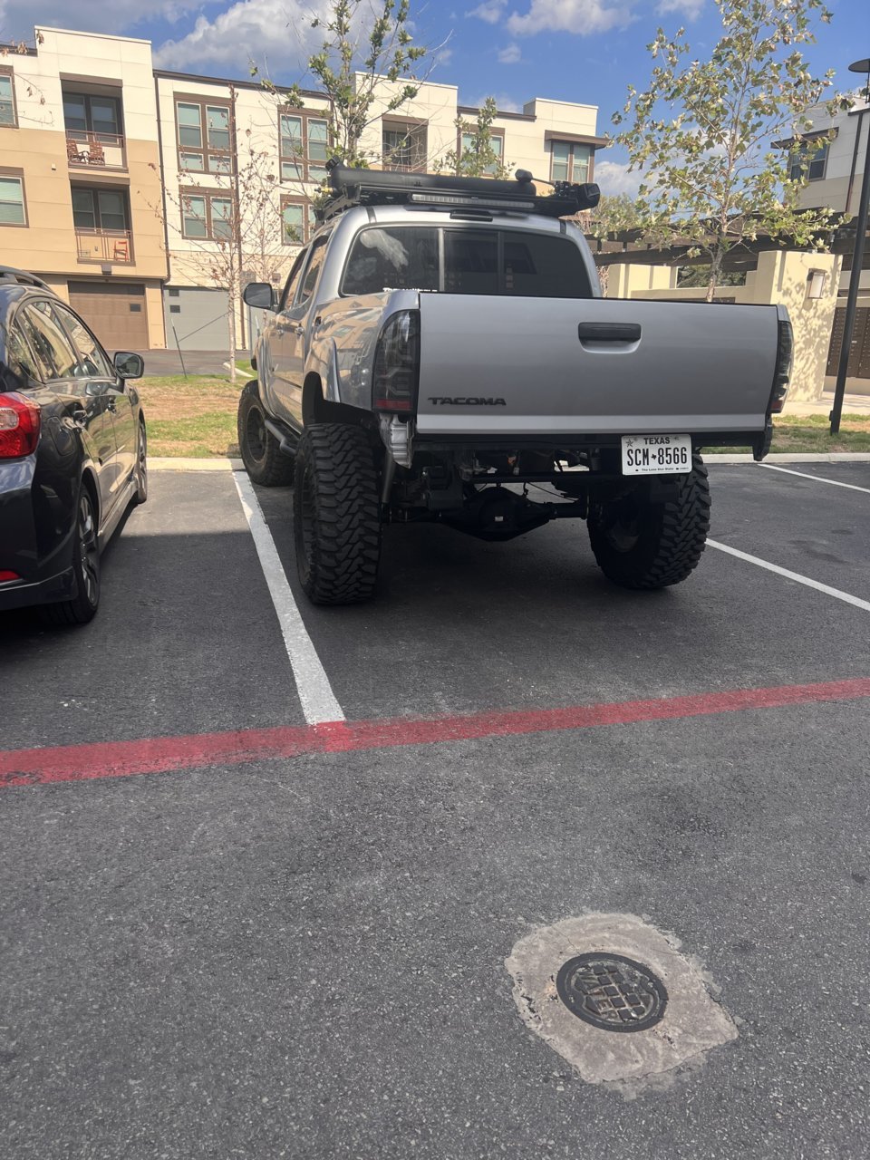

    Dropped the rear bumper bedsides mount up Tuesday
