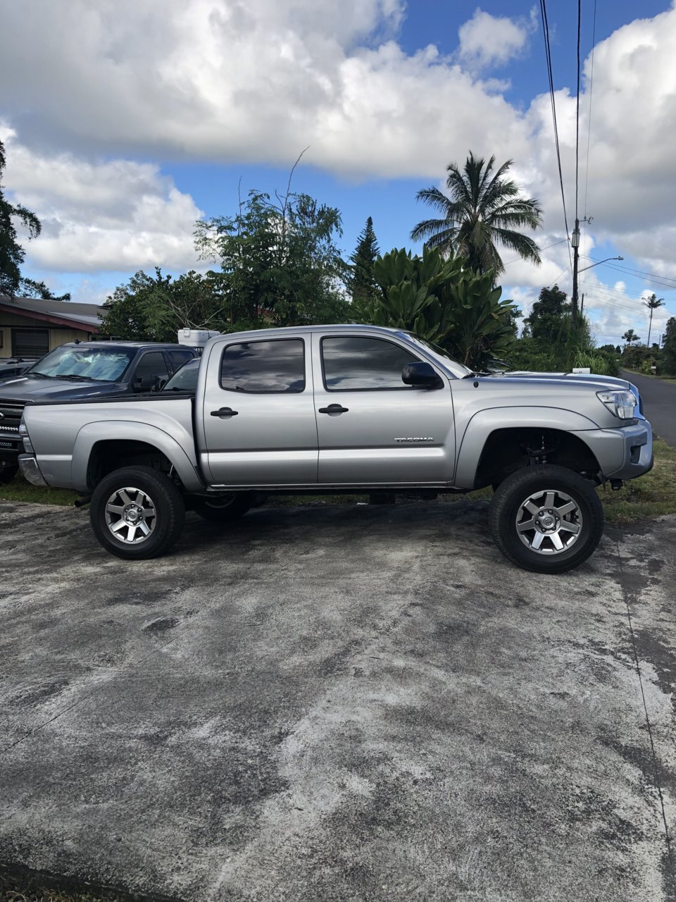

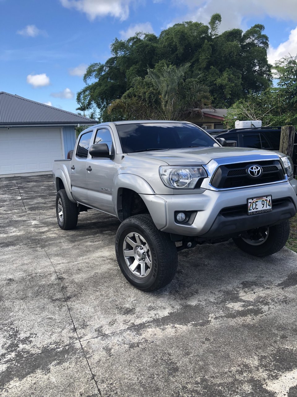

    97977D7E-797D-4A1B-AE0F-3C797B605A6C.jpg 5FB5709F-0450-44DB-9DF4-24EB1FDE0F76.jpg Installed 6” rough country lift with 1.5” spacers.

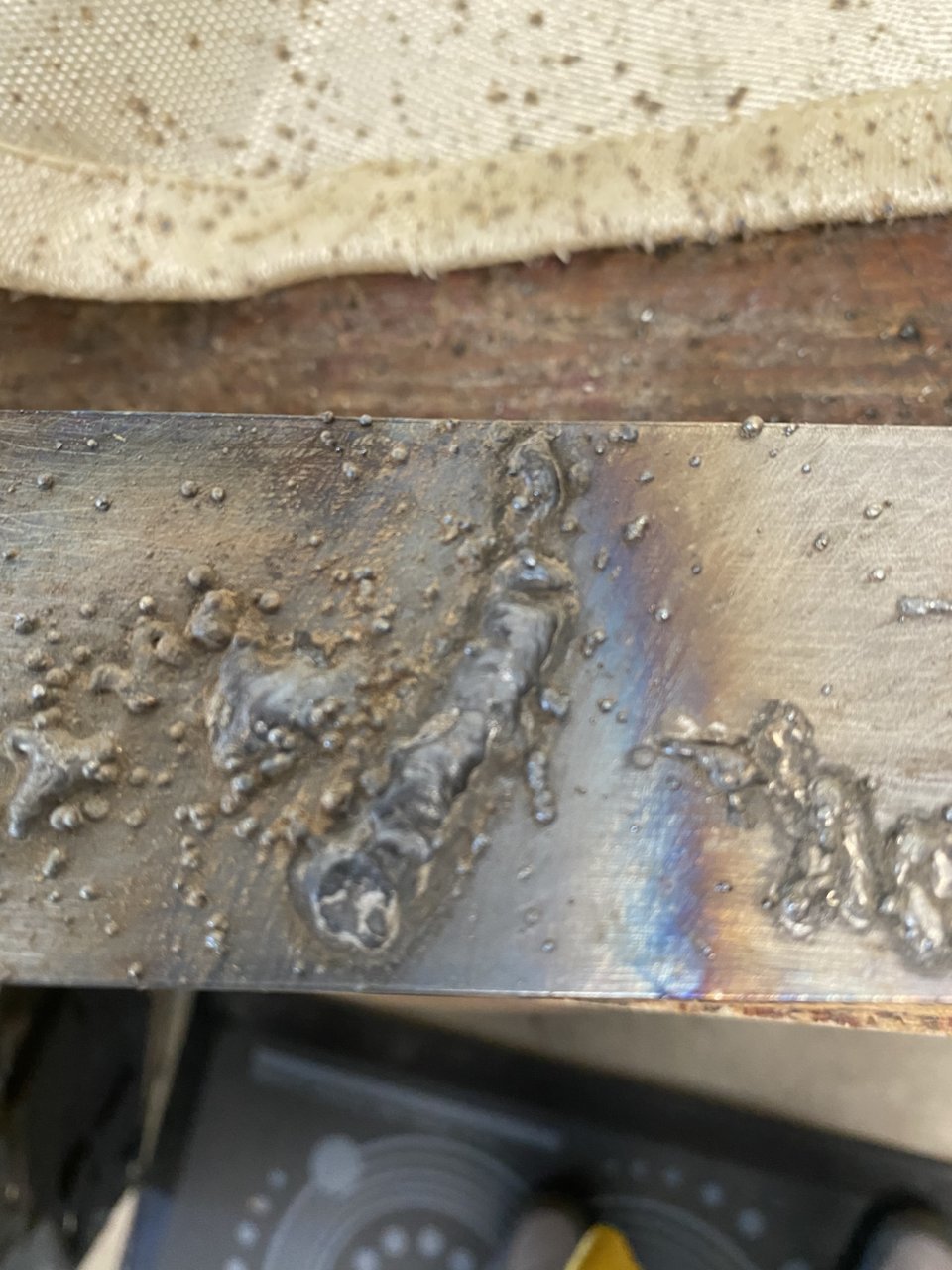

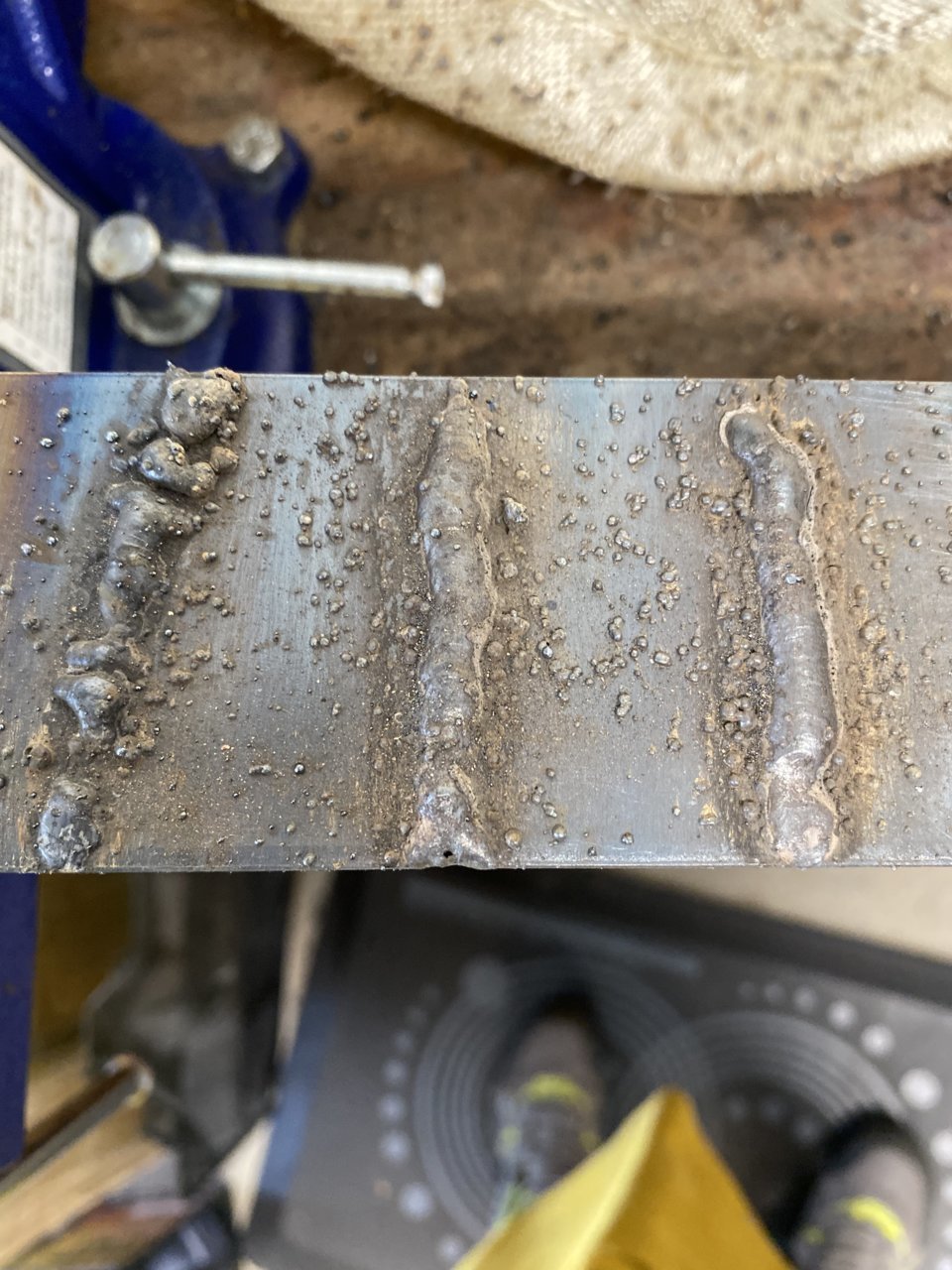

    Get you some CRC anti splatter spray for that flux core

    Nice stance to it!

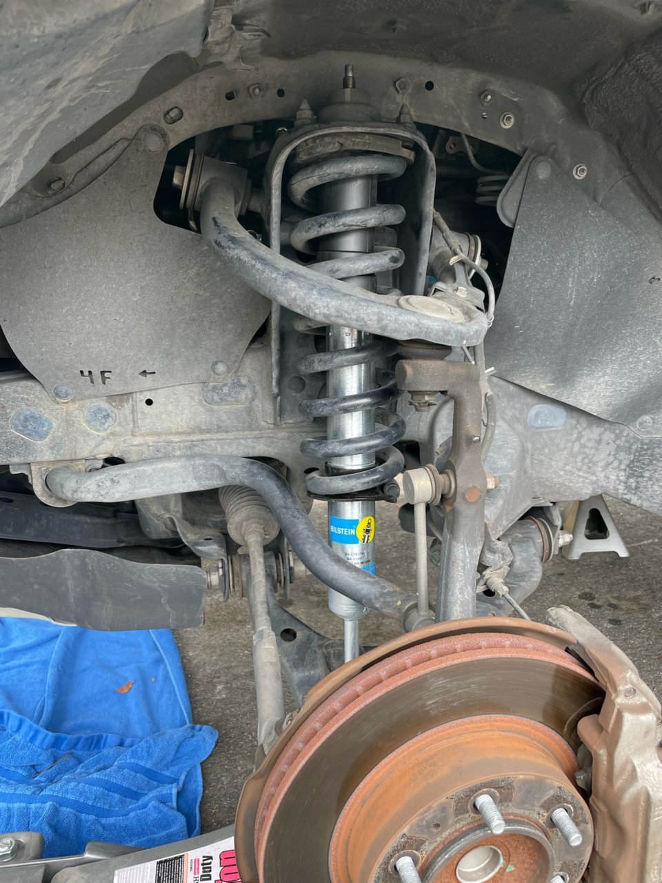

    Finally cooled down enough for me to get out and install new 5100’s all the way around. After 117k miles on my OEM shocks and struts it was time. Nothing crazy with adjustable ride height up front - second clip ring setting for .85” of lift to level her out. Factory springs.

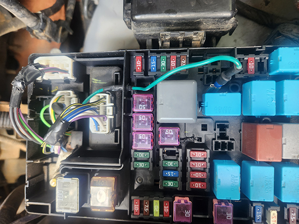

    Finally got around to doing the Any Time Foglights Mod

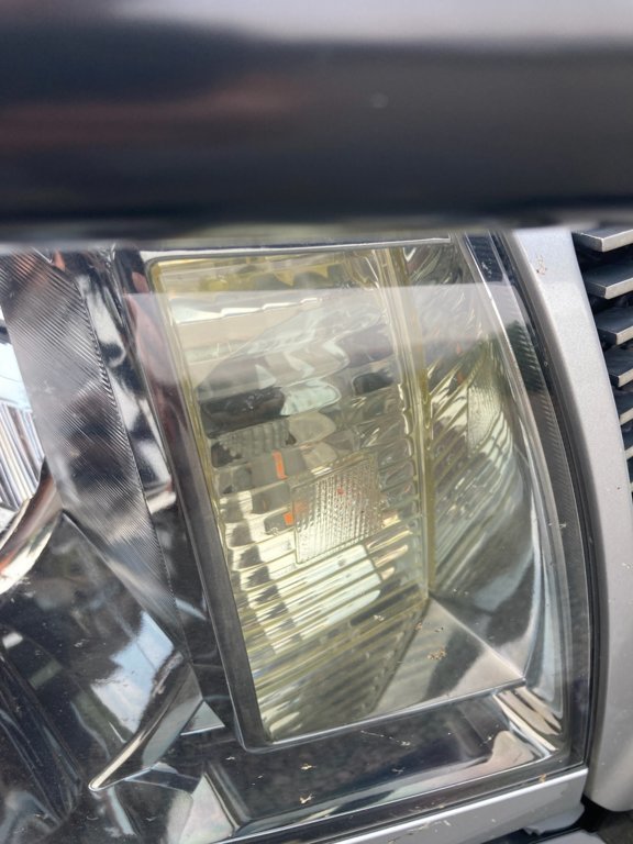

    I installed my Jumpers LED DTRL bulbs and wired in the resistors yesterday. One of the stock bulbs was crazy brittle and broke in my hand pulling it from the socket. Glad I had put on my gloves. New bulbs look great, resistors were pretty easy to install - had to drill 4 tiny holes to get the self tappers to catch. Hopefully this setup doesn't melt the plastic inside my headlight like my stock set did. How that DTRL issue passed Toyota QC in the first place is beyond me.

    Wish they made these for access cabs. And included the older year tacomas

    Looks good man! I had no idea of the Hawaii truck style until TW

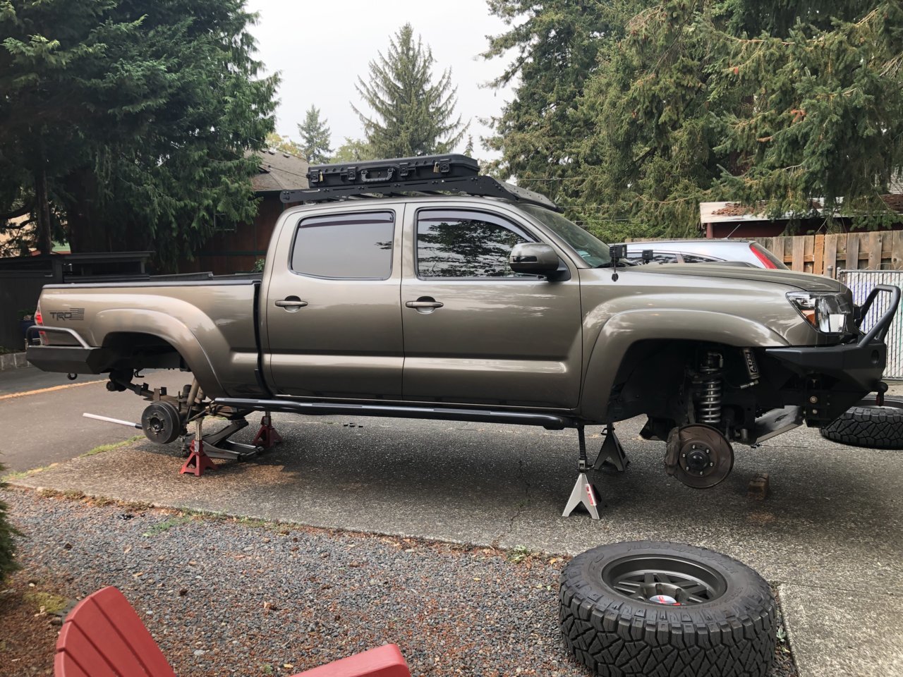

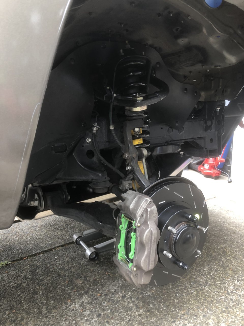

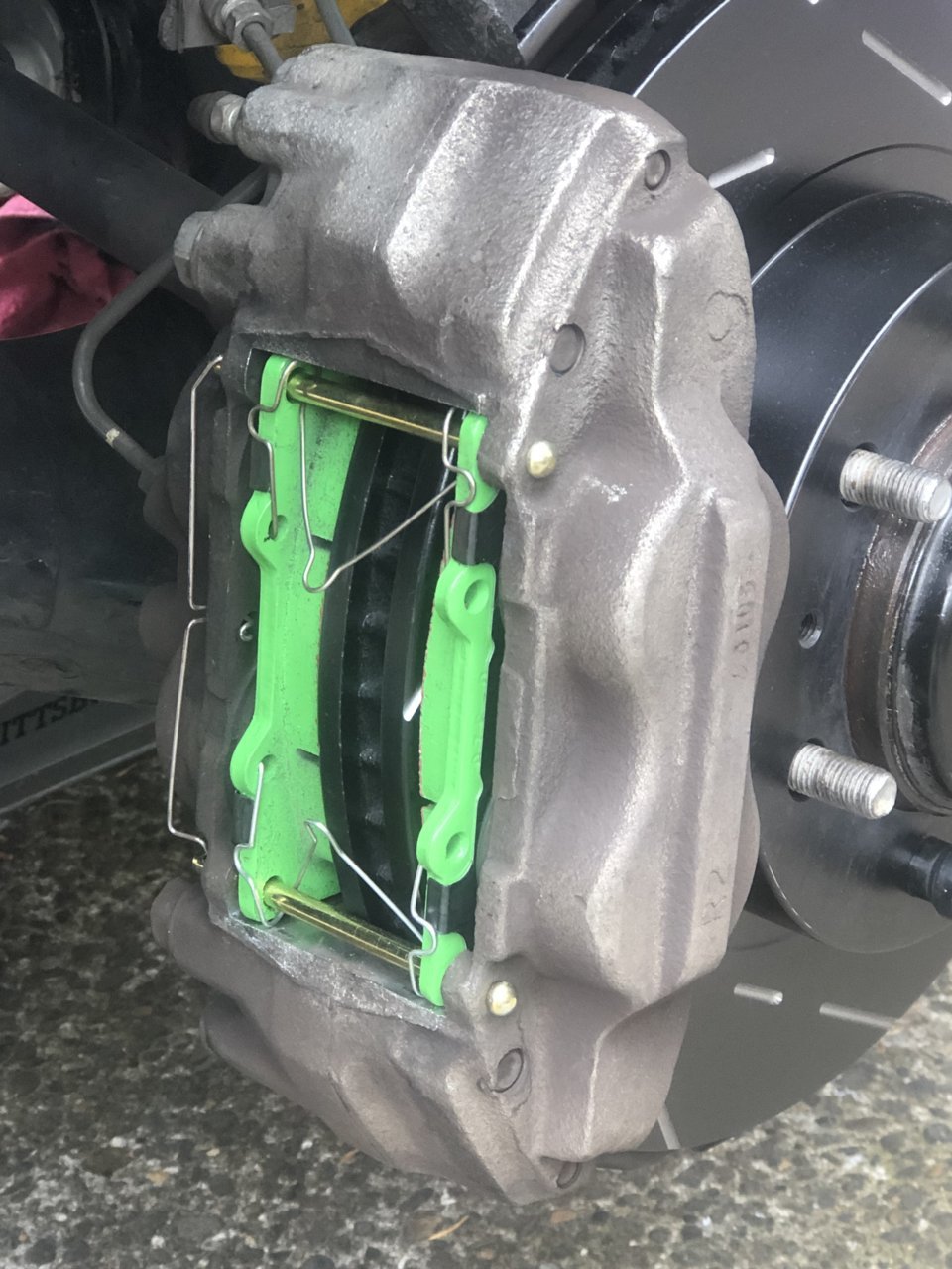

    Please tell me more about your front brakes and rotors. Would love to upgrade my OEM set sometime. Any links would be much appreciated.

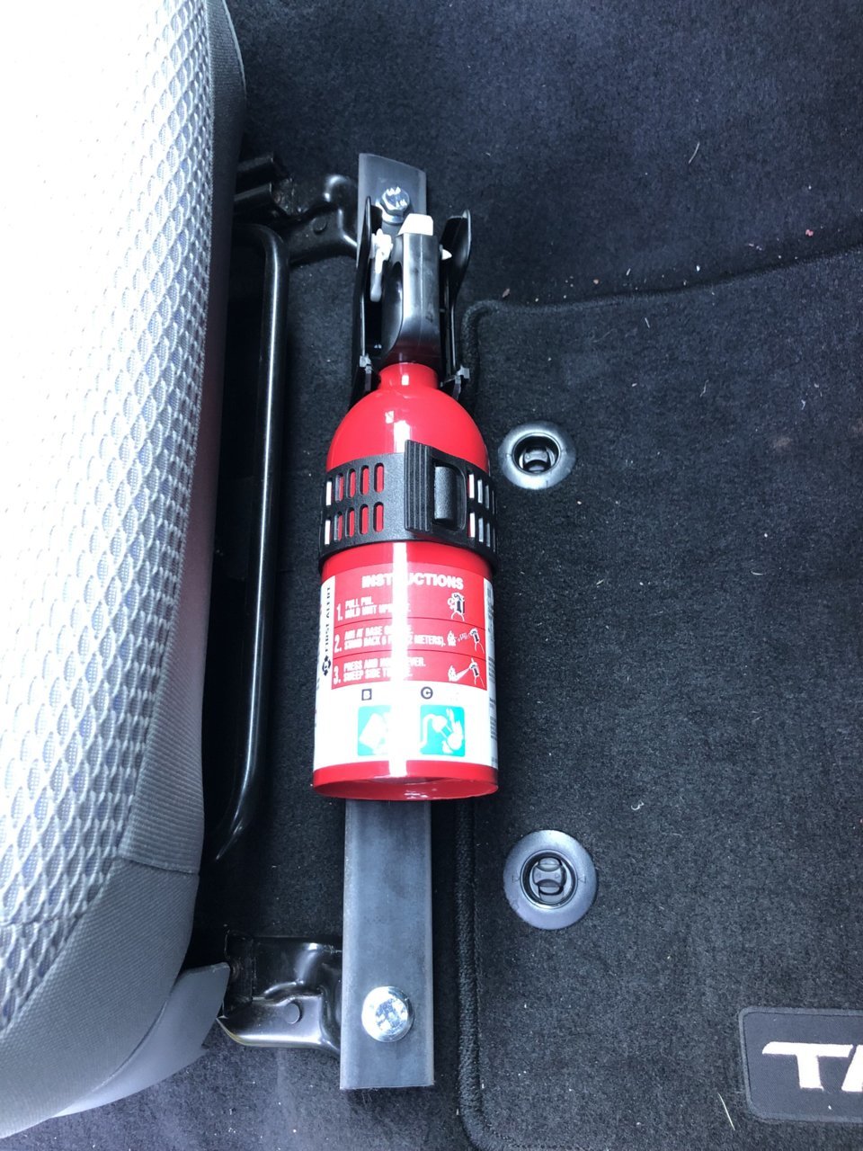

    Piece of steel, 1 1/2” wide, two spacers about an inch long and longer bolts for the seat.

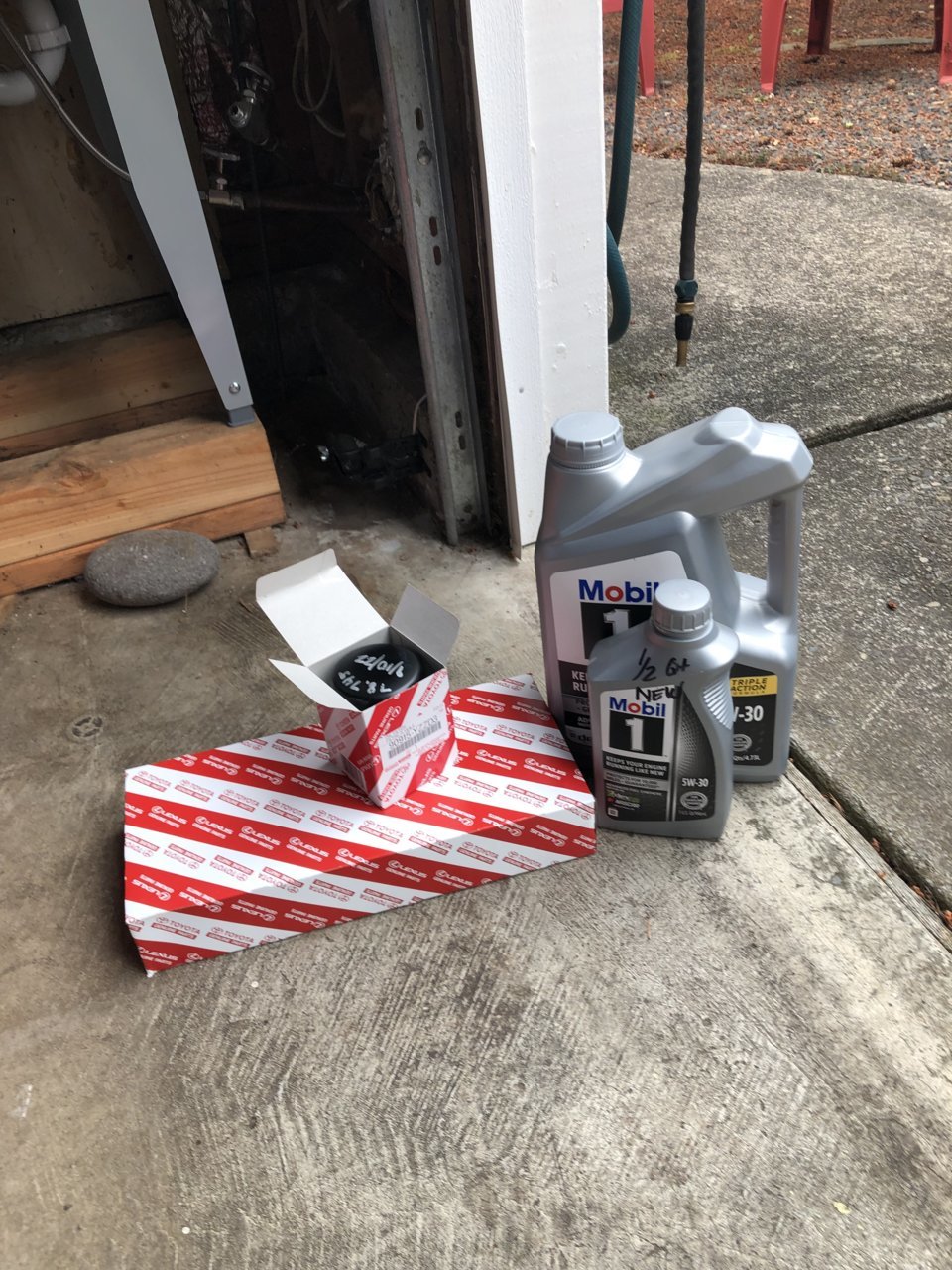

    first time doing oil change my self. 5 quarts valvoline synthetic blend 5w30 since that what the shop put in it last. also found out my local Walmart has the OEM toyota filters on shelf....nice
    dont know why i haven't always done oil changes myself. literally a 15 minute job even for my first time.

    EBC brake kit with Green pads.

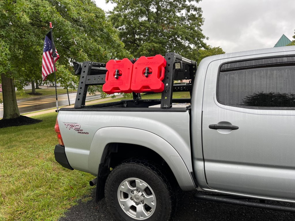

    Spent several hours in the rain, wishing i had a garage or a car port to work under, while mounted some lights on my rack, installed Rotopax stuff, and continued to try to figure out how my KB Voodoo MaxTrax mounts are supposed to line up.
    Been a frustrating afternoon.
