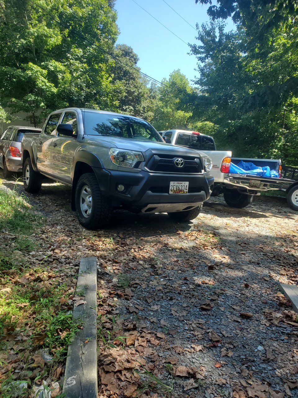

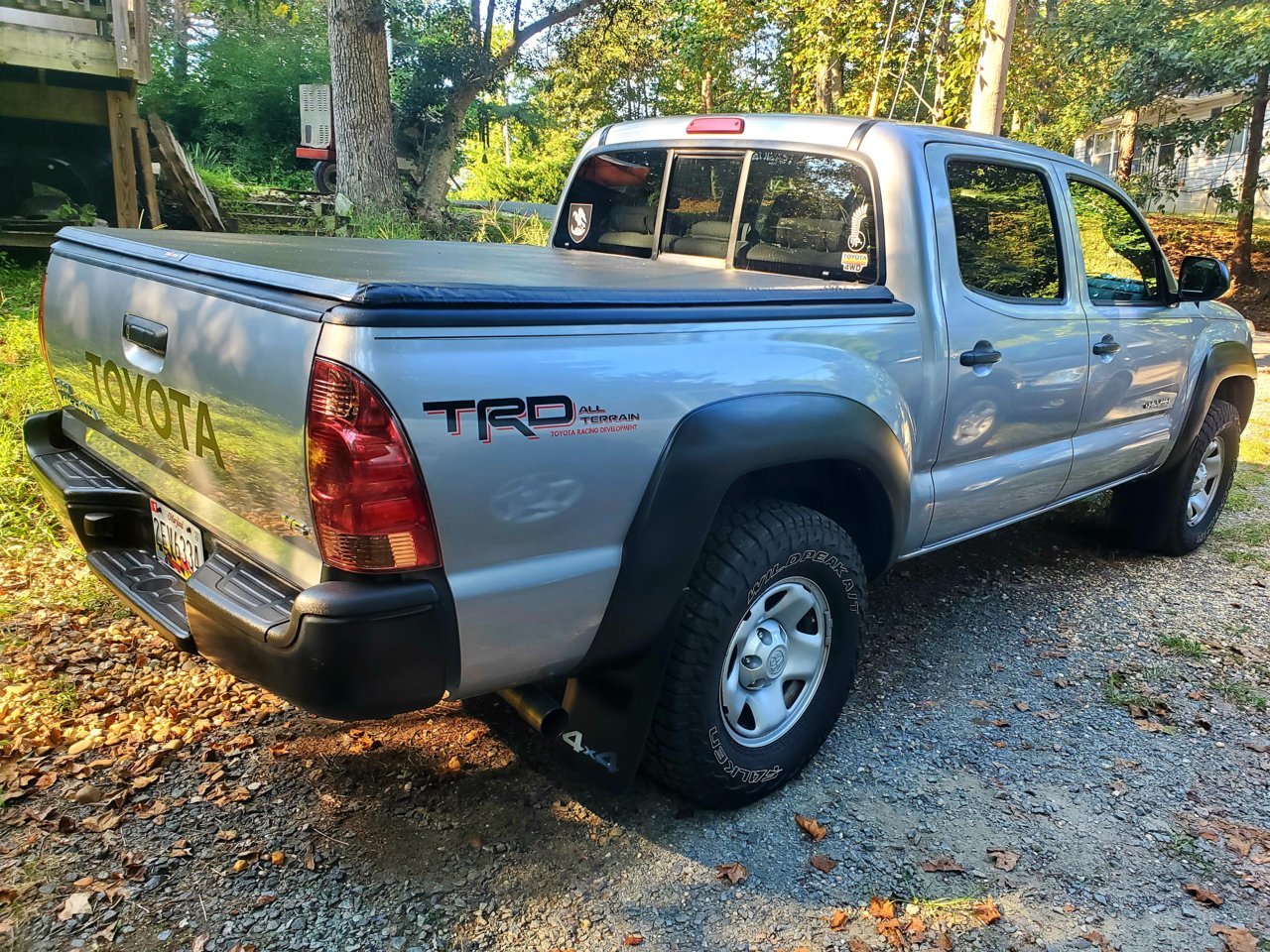

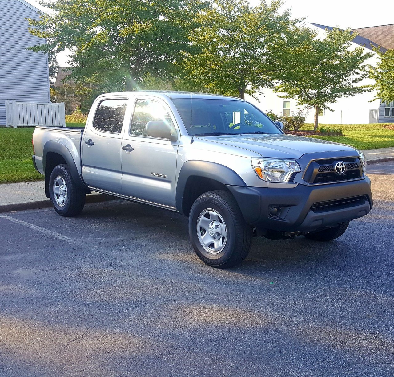

    I've owned my truck 1 year today if that counts lol
    In that time, I've done a few things.
    Done:
    OEM Skid plate added
    Falken Wildpeak AT/3
    Secondary breather filter mod
    4lo TRAC mod
    Total Chaos Bed Stiffeners
    Bed Cover installed
    OEM fogs and switch installed
    Shift knob upgraded
    AC knobs upgraded
    Planned soon:
    OEM alloy Rims (have, need installed)
    Harrop Rear locker scheduled 10/21
    ECGS front diff bushing
    Tow Hitch
    Rear diff breather kit
    Diode Dynamics fogs
    Bilstein 5100 shocks
    More to come:
    Dobinsons Snorkel
    Upgraded leaf springs
    Transmission cooler?
    Smoked headlights?
    Window tint
    Gas tank Skid plate
    First bought: 36,600
    Today: 45,400

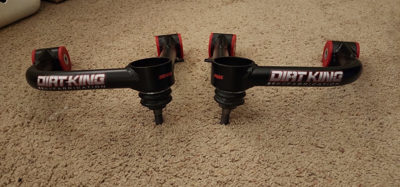

    I'm going to rebuild them because I have the rebuild kits. Then I'll either sell them or save them for when I need to replace these.

    Yes. I am replacing my 149k OEM with these upgraded ones, UCA should prob help you. I wanted ball joints and they are one of the few companies that make them. I currently don't have any issues with alignment or tire chatter, 6112s on 2/1 clips. It's different for everybody's truck though.

    What were you thinking? free 99 :rofl:

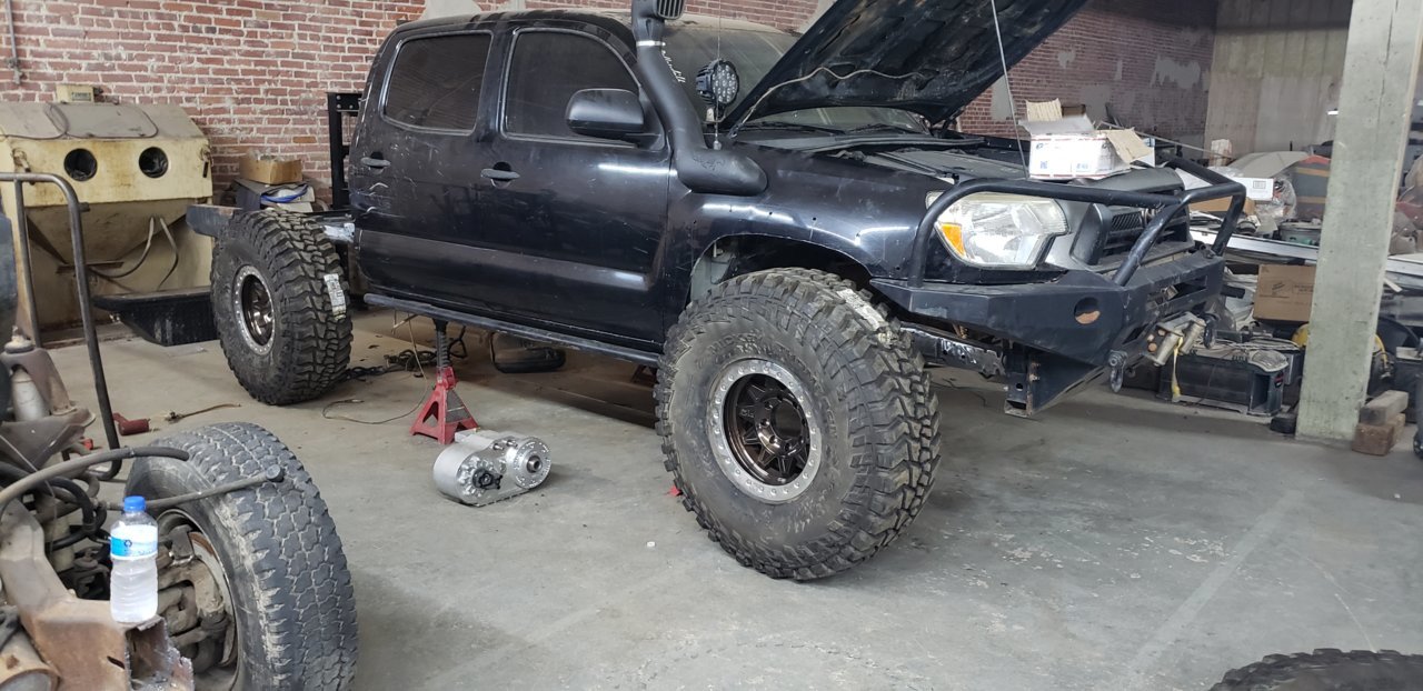

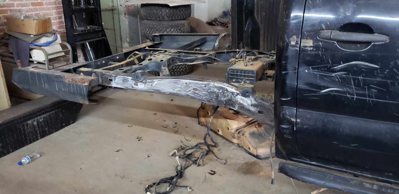

    Atlas will be in soonish, removed bed to install fill plates in the c channel frame. Hopefully soon we will mockup suspension cycle it then glue it all together. Aiming for a 22 inch frame height on 40s. Rear 14 bolt will get a shave also. I think OX locker should be coming in soon for the front

    I mean yeah why not I really have no use for them anymore.
    These lasted well over 100k miles and 7 years until the drivers side seal finally started leaking. And they saw pretty heavy off-road use, I'm really impressed.
    PM if you're serious!

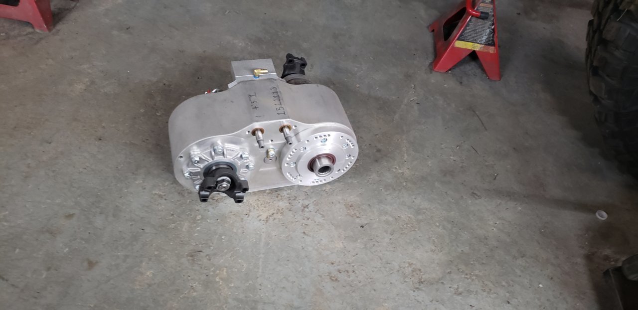

    Random stuff. Oh! and converted to non ADD 4x4.
    image.jpg So long sucka!!!!
