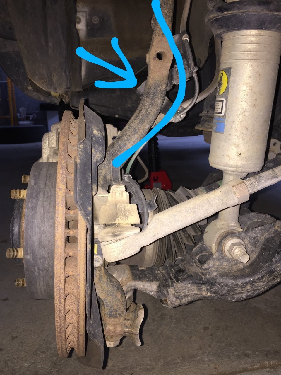

    Got signed up for an alignment whether I wanted one or not.... hit a stump going around a corner while doing some of my favorite FRFA today... seems like this happens to people a lot so fingers crossed its nothing serious

    FRFA?
    Also do you have spindle gussets?
    Hopefully you didn't bend a spindle, seems like impacts like that when the wheel is turned is usually what does it.
    If not I strongly recommend getting your spindles gusseted.

    Fire Road Fuck Around. I don't currently have spindle gussets. Really hope I didn't bend a spindle. Sounds like more fun that it's worth.

    I only hit it doing around 10mph

    Hopefully not, but believe it or not that's plenty of speed to do it.
    They're really strong in all directions except sideways it seems, most likely for collision safety, probably designed to fold where the tend to.
    Basically if you turn to avoid something the wheel becomes "face on" to the object and if you slide into or can't fully miss it with the wheel the force bends the spindles in the middle.
    Tried to find a picture of a bent one but couldn't, plenty of carnage picks of trucks doing the "kerchow!" but no noticably bend spindle pics.
    Hopefully you just knocked the rack over amd that's why your wheels is cocked.
    If it still tracks straight and the space between the tire and UCA is even on both side you're most likely okay, even still if bombing down FRFA is your thing, get some gusseted spindles.

    I'll go check. Thanks for the helpful responses

    Look and see if the tie rod is bent. That would be the first thing I would look at since it is in front of the wheel.

    Whelp, anybody have a passenger side spindle for sale? Haven't confirmed yet but seems like that's the case.
