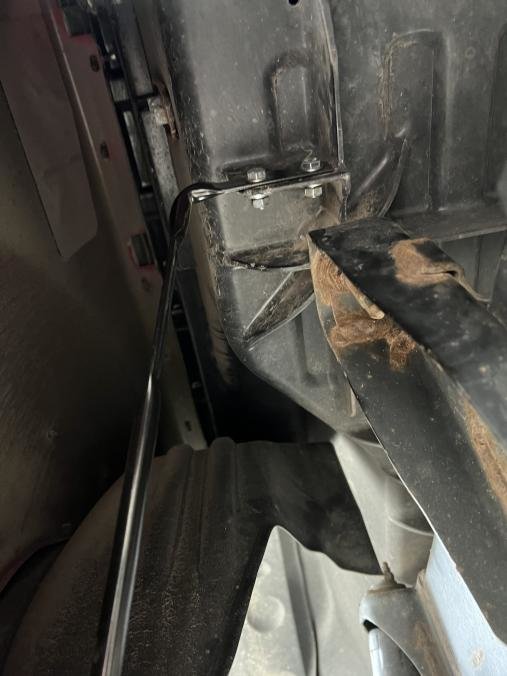

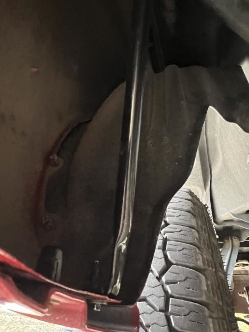

    This rusted/broken brace topic seems to keep popping up here lately: https://www.tacomaworld.com/threads/rusted-out-bracket-on-bed.778507/#post-27834194
    As was mentioned in the link(s), w/o soaking those rusty bolts well in advance I'm not surprised they snapped on you.

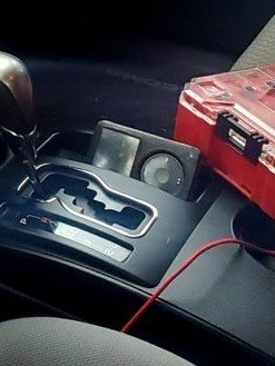

    Mine actually came with the base knob too. This is an OEM black and silver knob that I bought from a guy with a TRD Sport. I saw this in a few photos of peoples trucks and thought the same thing as you. I put a WTB listing in the market place with a photo and some guy came along and had a take off from his truck and sold it to me for like 20 or 30 bucks.

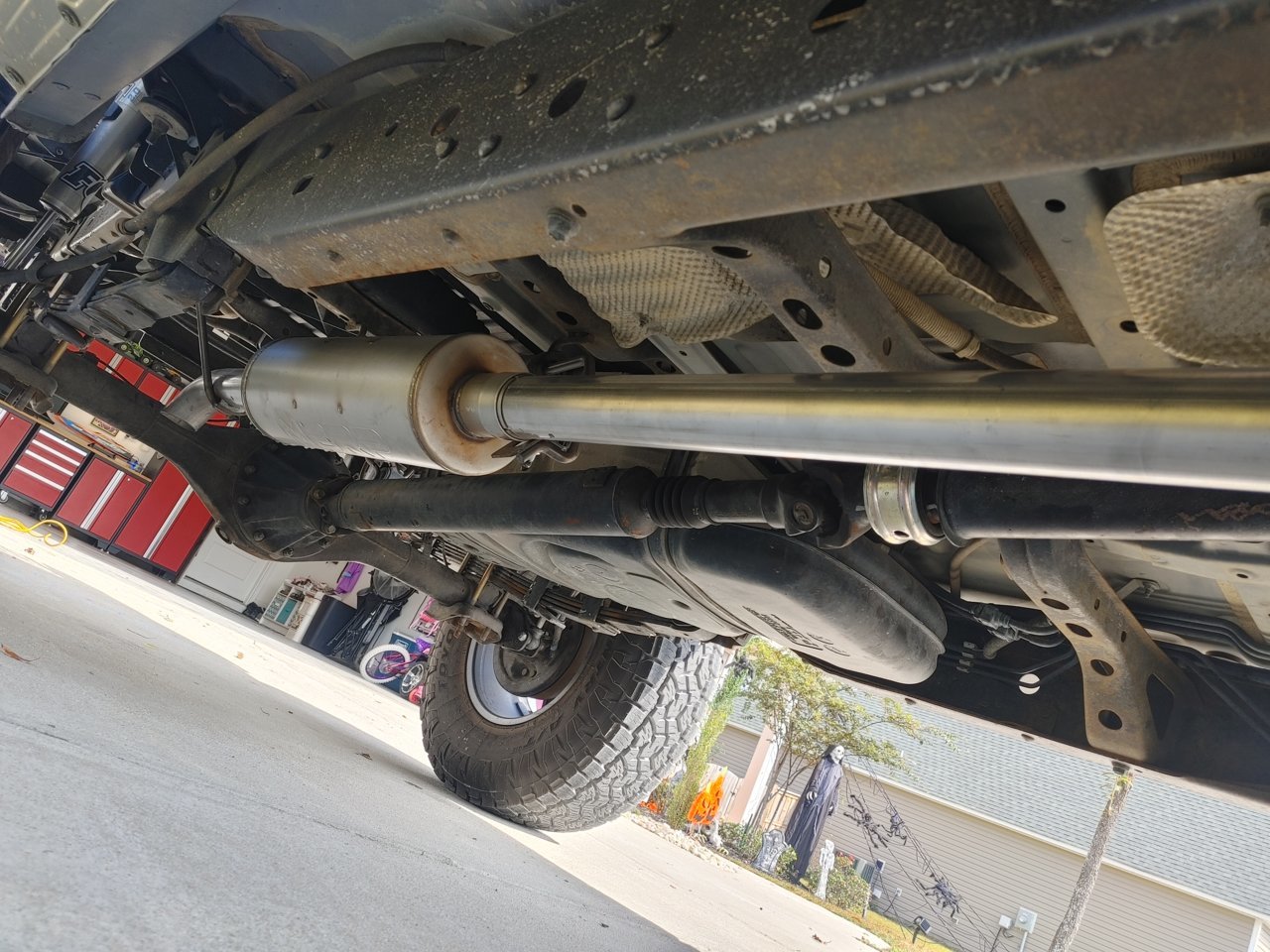

    In the process of replacing the driveshaft/exhaust. Took this weekend off "to rest" :confused::rolleyes:

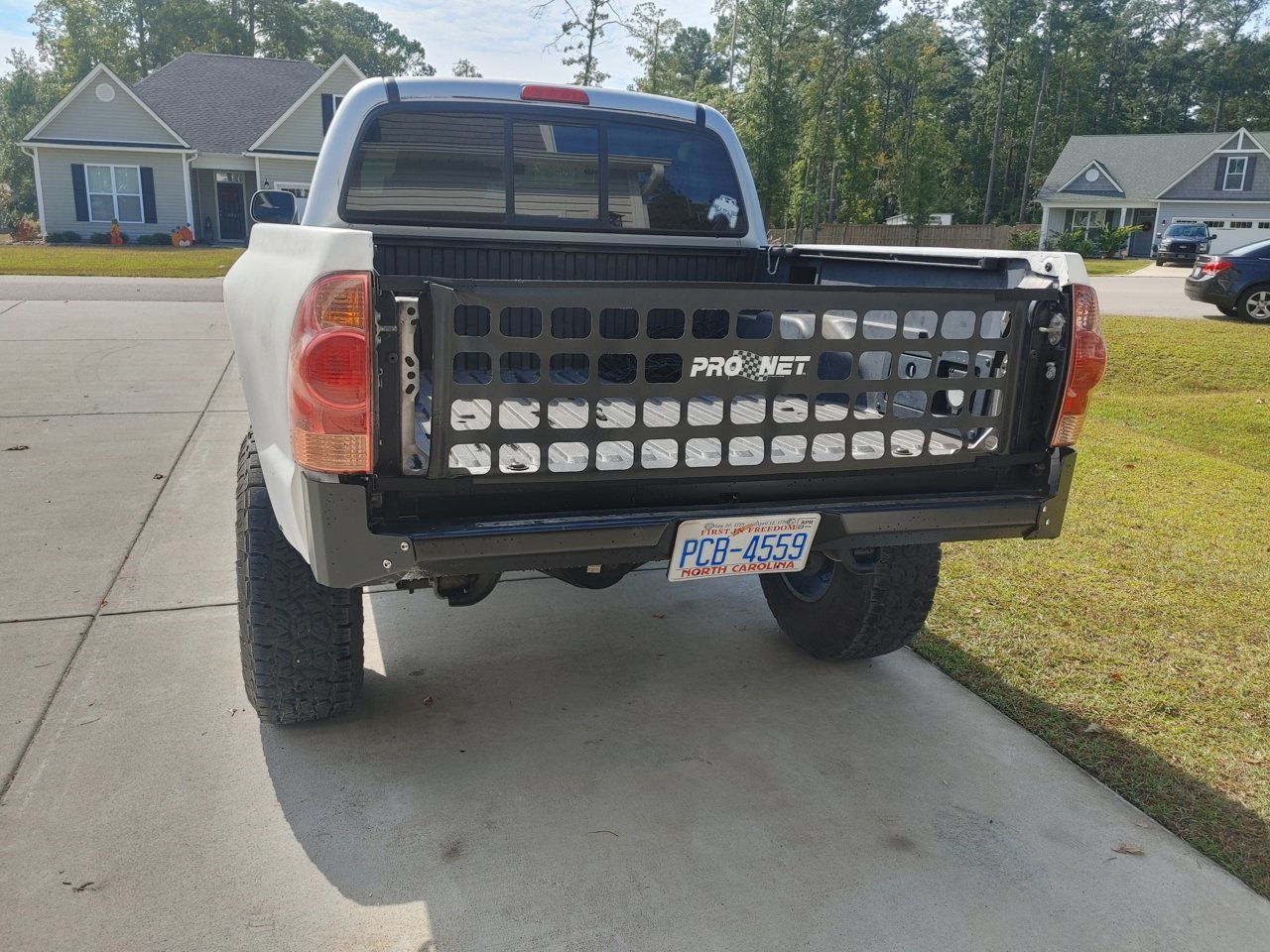

    Mbrp.
    At the helm bed stiffeners.
    Ditched the tailgate.
    Trimmed rear lower fiberglass to match mazulla bumper.

    I want shiny exhaust

    MagnaFlow 17115; I just noticed yours is pretty much the same setup but MBRP :cheers:
    I'm done with it, wow, I got rid of every single vibration on the damn truck :bananadance:

    Was that an oem driveshaft?

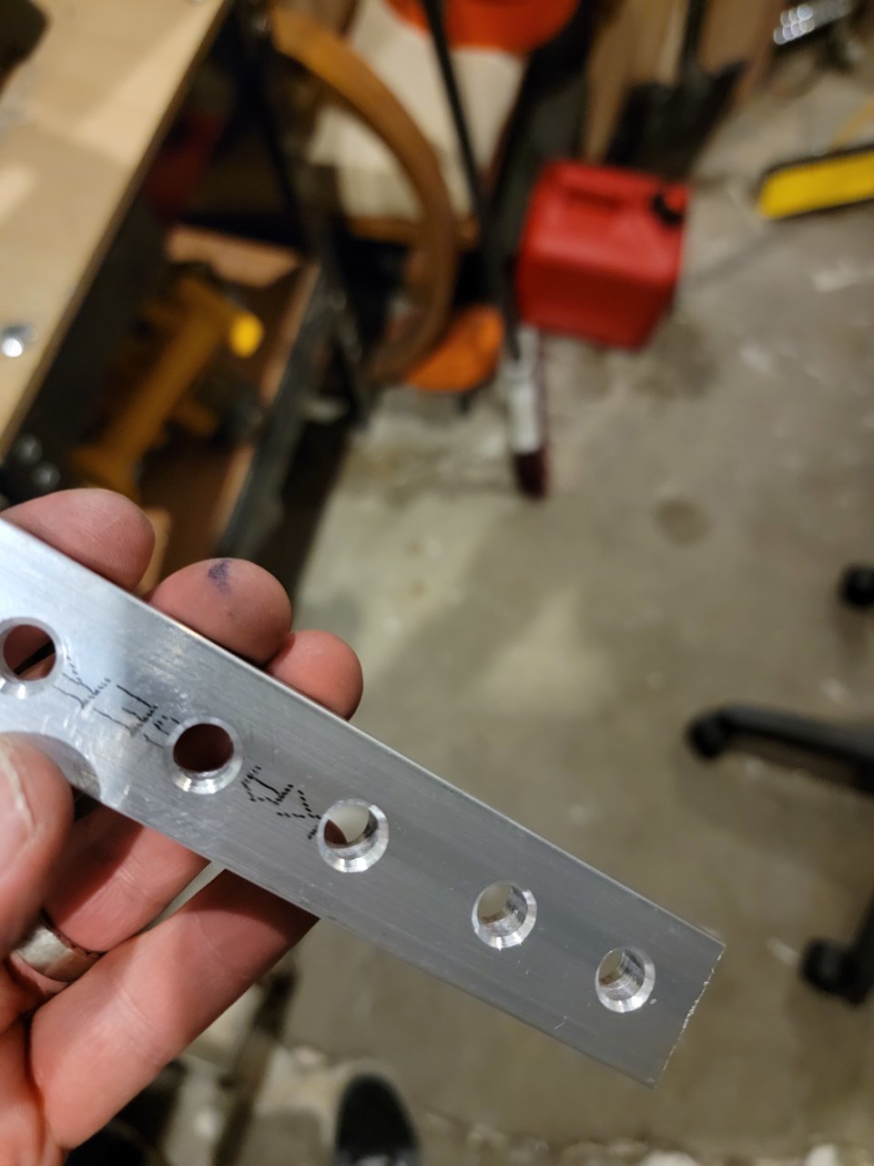

    Made myself a couple grab handles. Basic idea 100% stolen from uptop overland. Nowhere even close to how stylish theirs is, but it'll do the trick.
    I ordered flat bar aluminum and some aluminum spacers. Drilled out a bunch of holes in the bar, ground the corners round and used the spacers as risers. Ordered the actual handles online. I had some paracord lying around (im not sold on the red, and I may change it out for all black) and used some steel cable as reinforcement since i dont trust weather beaten paracord. I used primer, rubber undercoat and spray paint so the finish is kinda ugly but should hold up.

    Yup. Mine is a PreRunner; Tom Woods don't make a 1pc for the 2wd folks.
