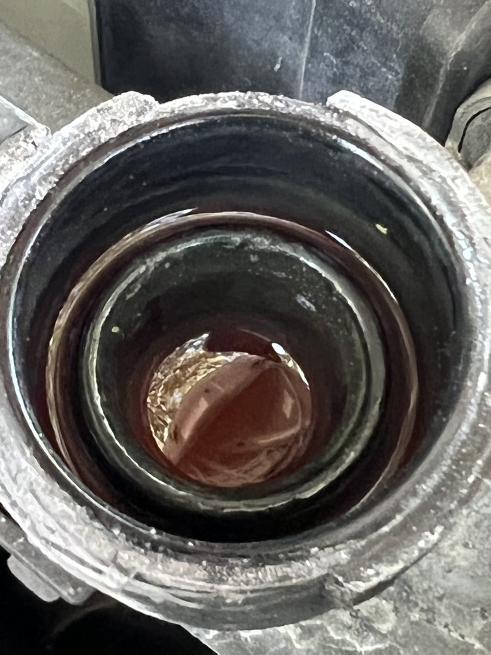

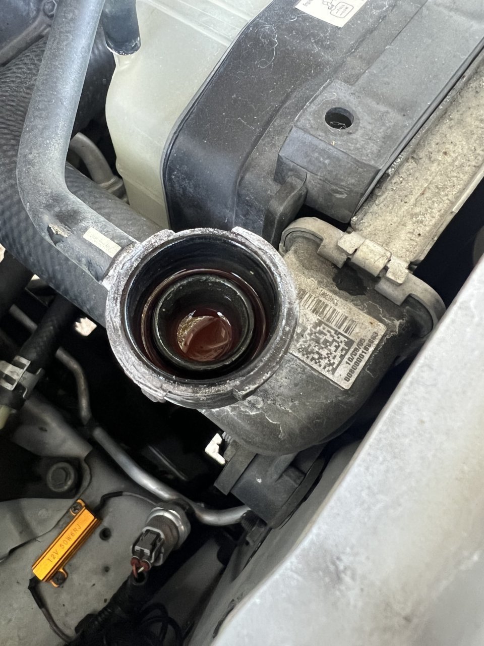

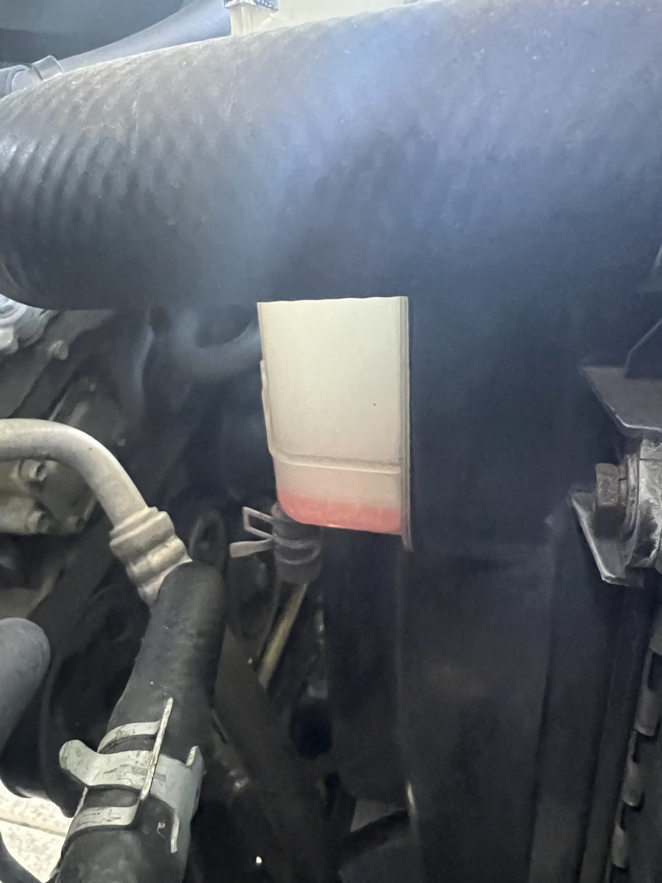

    I need some sanity check here…
    I’m in the middle of a big project, started on it about 5+ weeks ago. Right before that the Taco was driven daily, and garaged. The radiator coolant expansion/over flow tank was between low and full lines with cold or hot engine, as applicable. No issues.
    The Taco was moved to the driveway (have no room in the garage to do all I need to do). It’s been seating outside on the driveway ever since.
    Today, I noticed this…
    The million dollar question is: Is this normal?
    • The water pump was replaced in 2019. OEM Toyota water pump.
    • Have been on my back, on a creeper, almost every day. NO wet spots on the driveway. NO indications of ANY fluid leaks.
    • Checked EVERY hose. No cracks, no leaks, no white chalky spots anywhere on any of the hoses.
    • Checked very closely with a light and an inspection mirror EVERYWHERE, in and around the WATER PUMP, and follow the whole shape of the water pump.
    • Check the whole engine block for ANY signs of LEAKING or WEEPING. No white chalky residue ANYWHERE.
    • Bottom line EVERYTHING is clean and dry.
    Also looked at the radiator neck coolant level and looks SAT.
    DABF498C-D646-46F1-8DCC-664C6E21F891.jpg 169ADDDF-4336-4507-9DCD-83D2AF52DA73.jpg
    Like I said, the vehicle has not been driven in 5+ weeks and the engine hasn’t been turned since also (battery is out of the truck).
    It’s beginning to cool down a lot at nights here in TN (low 40’s)
    I can’t find ANY indications of a leak, the radiator is full… what gives?
    Why has the level on the expansion/overflow tank has dropped so dramatically?
    Maybe I’m tripping here, just looking for some clarification in case I’m missing something.
    Never had leaks of any kind since I purchased the truck in 2005. Just curious, am I missing something?
    Thanks for the help!
    PS - Should I top off the thank with the Toyota “pink stuff “, and if so, how much?
    Rick

    Very thorough observations, I wouldn’t be concerned honestly. I’ll say drive and inspect soon after you reach operating temperature. Cheers!

    Try a new radiator cap. Or do a pressure test on the system if you can. We've had this happen to a Tundra and a tacoma in the past couple months where the cap wasn't regulating pressure correctly and the coolant in the resvoir had back pressure. It was releasing the fluid out of the res overflow. One easy sign to see if the cap is bad is the nipple on the bottom of it may be missing.

    I didn't know this was a thing. I am going to do it tonight for sure just for good measures.
