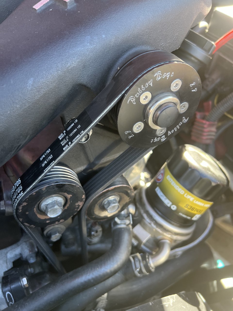

    New belt +oil change + air filter. Previous owner didn’t do shit for maintenance. Pretty sure the truck loves me more!572B5759-D4F2-490A-9062-9769102C1410.jpg
    Anyone know if there is a bigger oil filter that works with the 4.0 ?

    Yes sir but is there a bigger oil filter than the oem the can work with the 4.0 ?

    Out off habit I guess. On my 3.4 i can add a lager oil filter. It might be 4.0 filter and its 2in bigger than oem 3.4 filter. it adds extra oil more filter media more miles between oil changes. Just thought 2nd Gen peps might have found a bigger one than oem that fits . Hopefully someone has!
