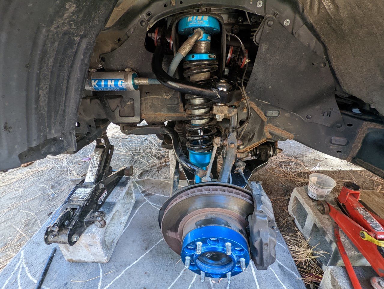

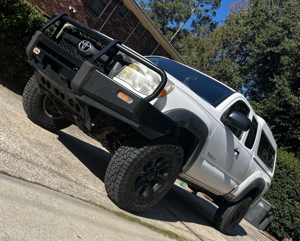

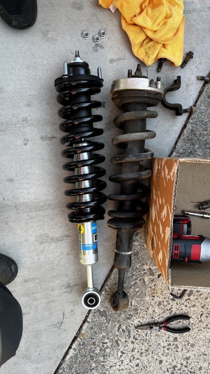

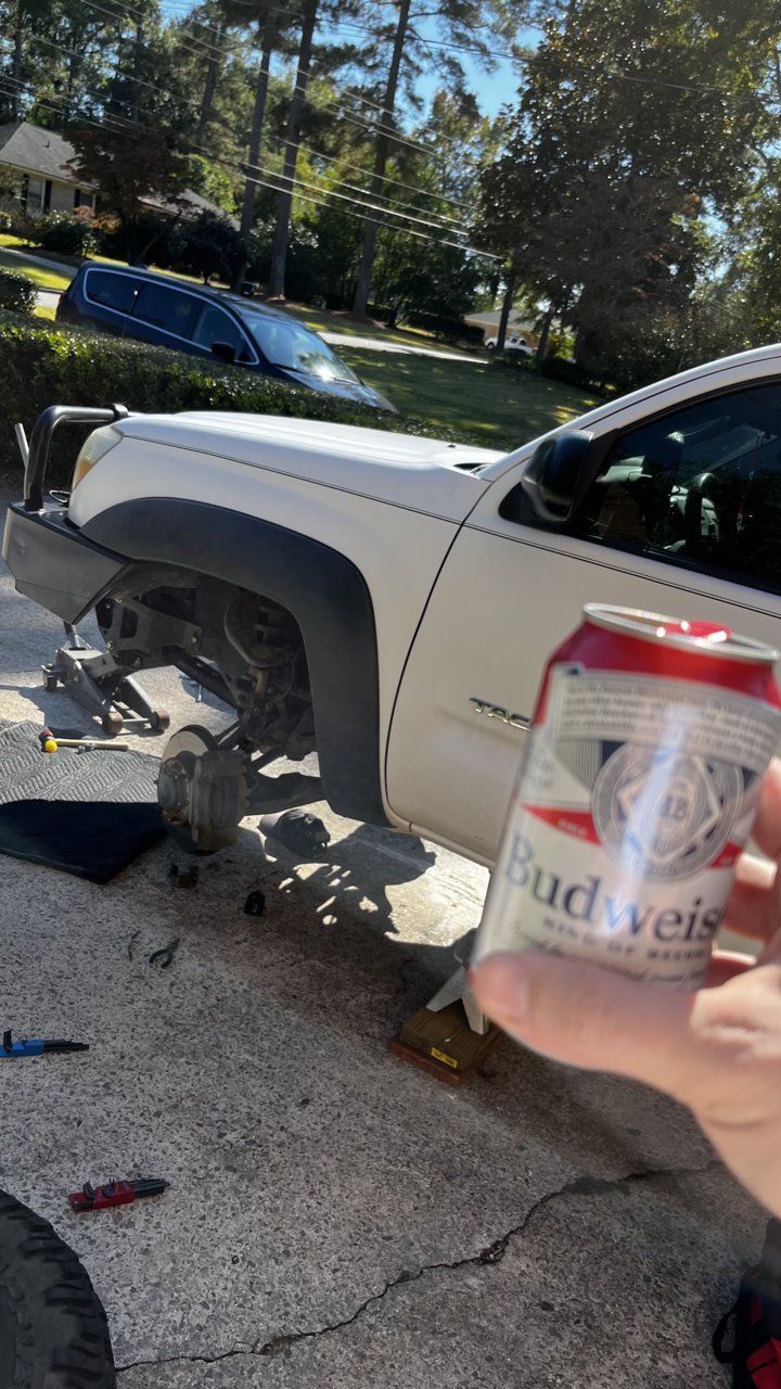

    Installed a real lift yesterday and put on the new shoes with pizza cutters. 5100s front and rear, 885 coils and a Deaver AAL. 4Runner wheels with Falken AT3 255x80r17s.
    The factory rear struts were so worn I can compress them by hand and they take a few minutes to extend back out.
    Can’t express how much better the ride is. Full support for the ARB bumper, no nose dive when braking, no rubbing so far but I haven’t gotten into anything rough yet to feel it when articulating.

    I ended up having to move the clip up 1 notch after a year with a steel bumper and winch to get some height back after the 885s settled. Be prepared for some sag after a while. Looks great though! Good job

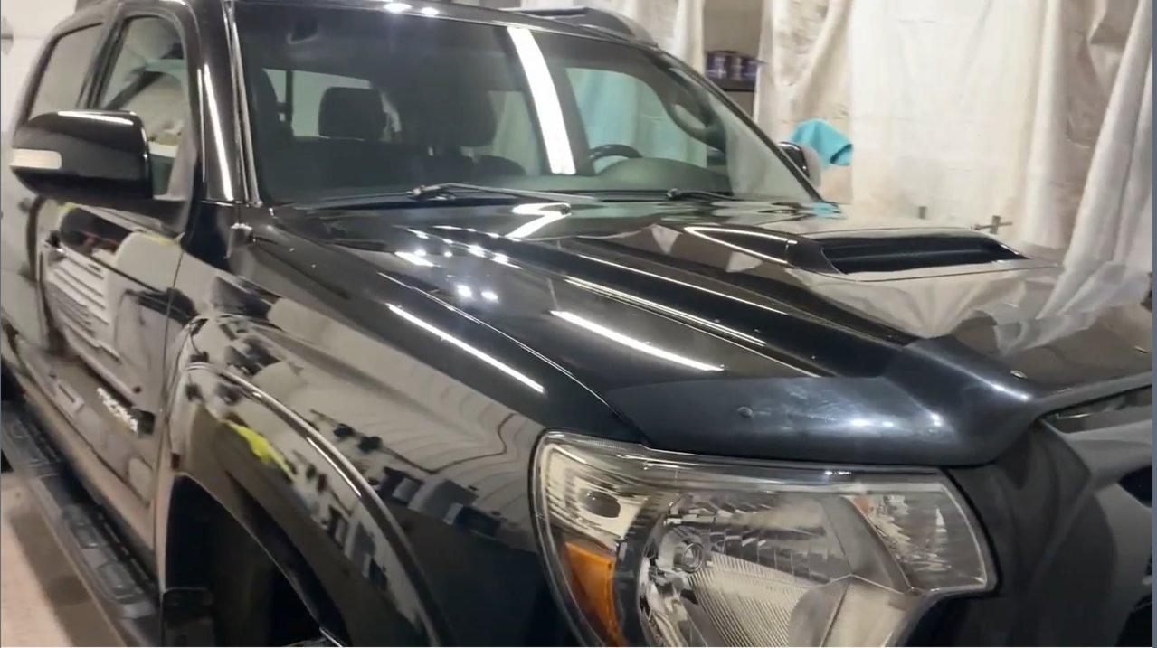

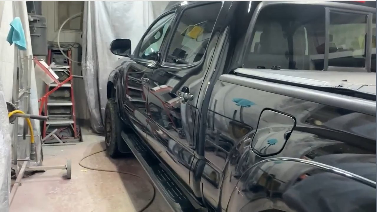

    The truck got some love. A full cleaning and polishing got the shine back and for protection a ceramic compound applied for the winter. The paint bare the 144 000 Miles of salty and sandy road hazard. The front bumper is sanded to the plastic, and there so many stone chip. If you walk by it will look good don't go too close ! The guy told me that the paint was good, there was some paint work done on it in the past, some doors paint work is visible. I have some rust on the rear bumper, i will probably change it so rust proofing will suffice for now.
    It look good.

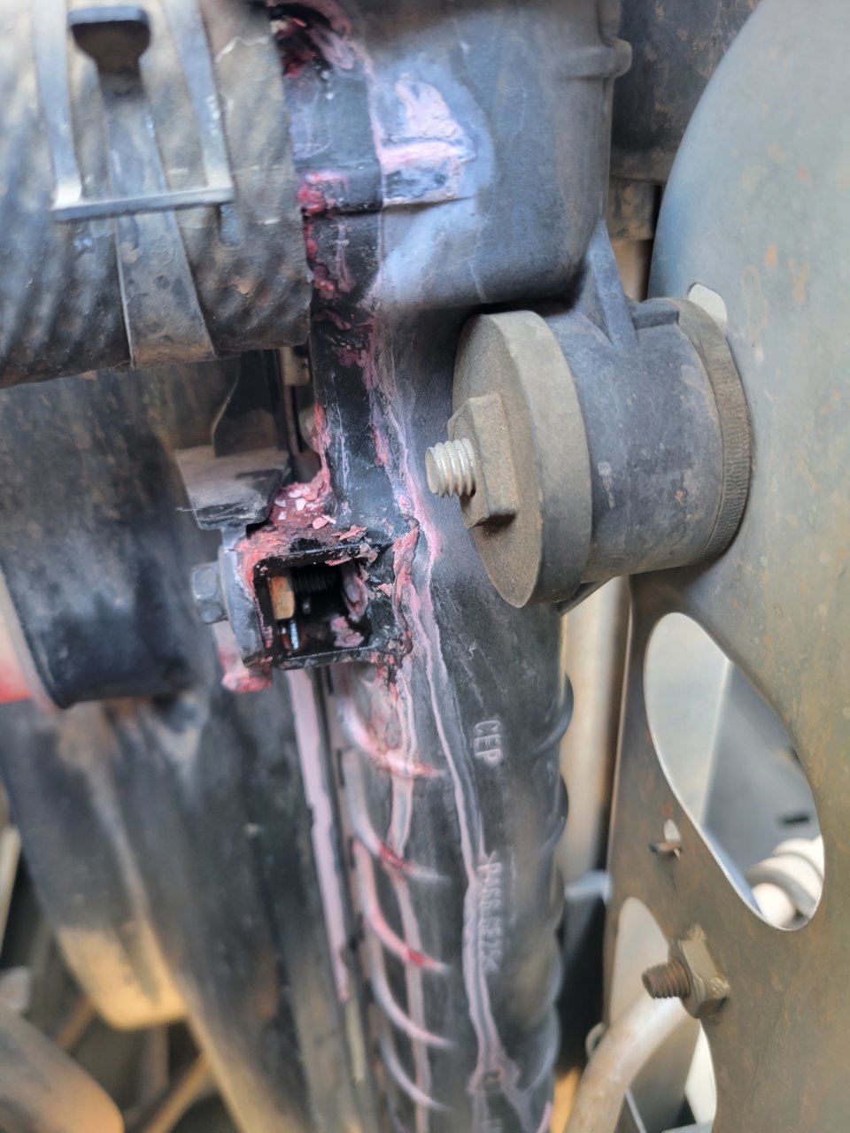

    Changed the oil and installed my Diode Dynamics CF18 Flasher module. So now my truck is extra "flashy"...!
    Also noticed this which I wasn't too pleased about:
    Trying to decide how concerned I should be... :notsure:

    If you haven’t ever done any cooling system maintenance it would be a great excuse to. At the very least do a coolant flush, clean up the crusty coolant and see if the leak continues.

    Looks like the radiator hose clamp needs replacing.

    Does it matter if we use the regular home depot kind?

    You can use a regular hose clamp, just make sure to not over-tighten it, you don't want to damage the plastic of the radiator.

    Mine did that. At first I replaced the upper hose and hose clamp. Thought it was good. Drive to and back from Northern California last December, and discover that it started leaking again. Took the hose off, and discovered that the nipple on the end of the radiator turn was gone. Had to replace the radiator, and now no leaks.
