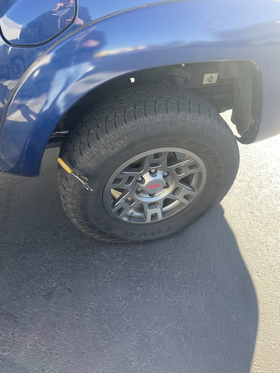

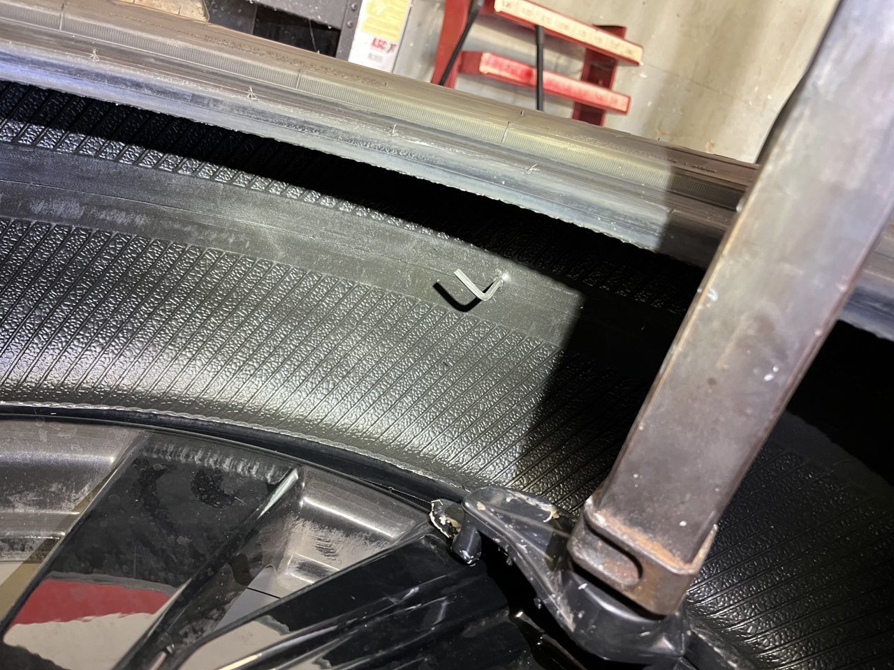

    This was a perfectly good hex key I pulled out of a customer’s tire once

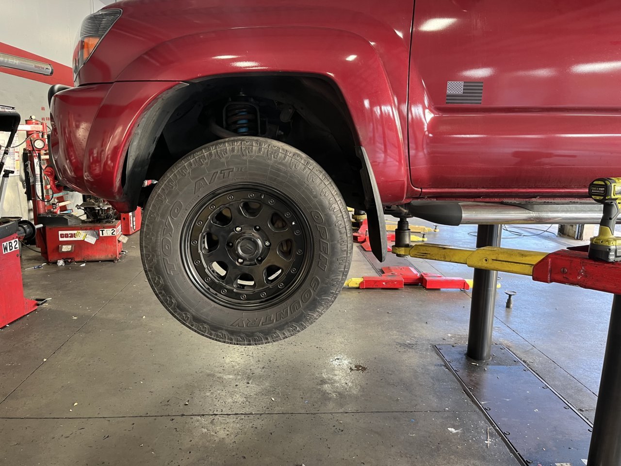

    Today I took one of the wheels I bought on Wednesday and test fit it. Found out I need to order extended thread lug nuts and some hub ring spacers. Also got my package of 5100s so next pay day I order my 2887s and the pay day after that I bring everything in and lift my truck. Still stuck between KO2s and Trail Terrains though, the trail terrains look like they’ll perform better on the road when it’s wet and my boss said he’ll just have the store cover whatever extra cost there is from getting them out of network. For reference: my cost for 5 new TPMS sensors and 4 255/75R17 KO2s was ~$750 so my cost for Trail Terrains will be ever lower. KO2s of that size we have in network (hence the low price) but Trail Terrains we’d have to order.
    Anyway, if anyone has experience with both the trail terrains and KO2 in the rain please chime in, they’re so new that I don’t have any customers who have had both tires to ask yet.

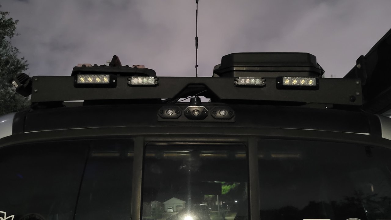

    Put in a 3rd brake light that you can actually see..

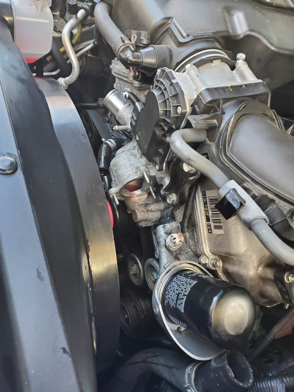

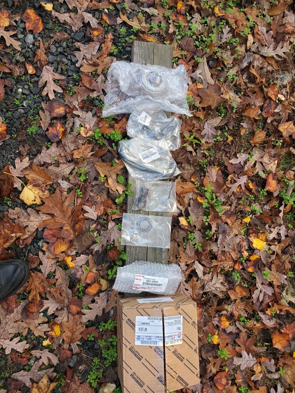

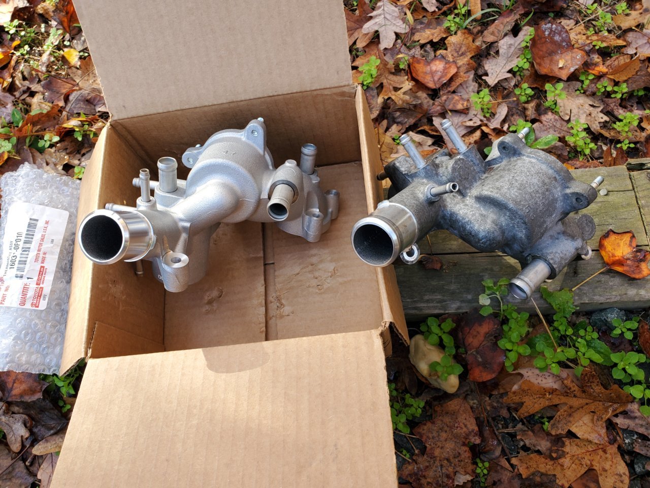

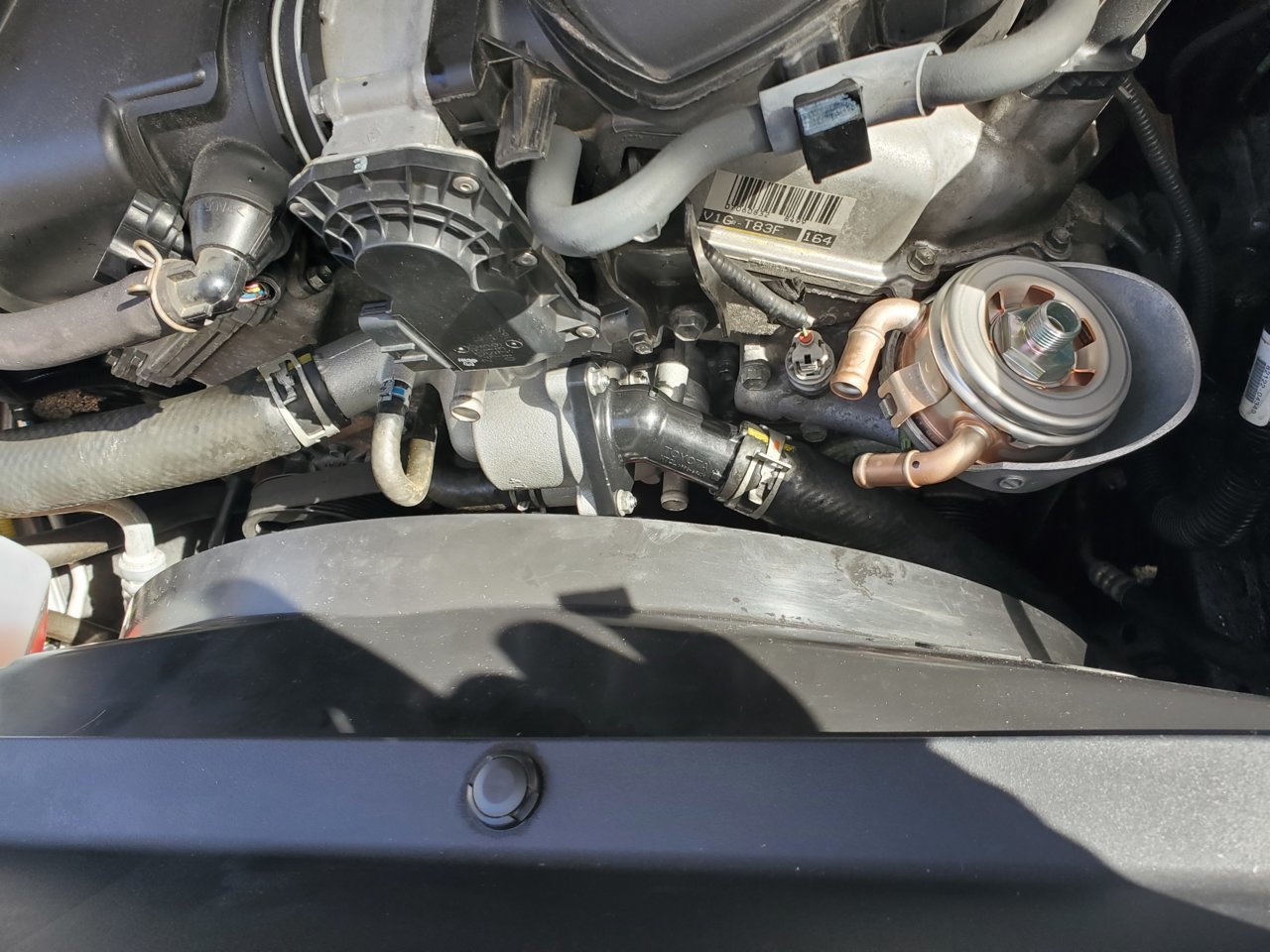

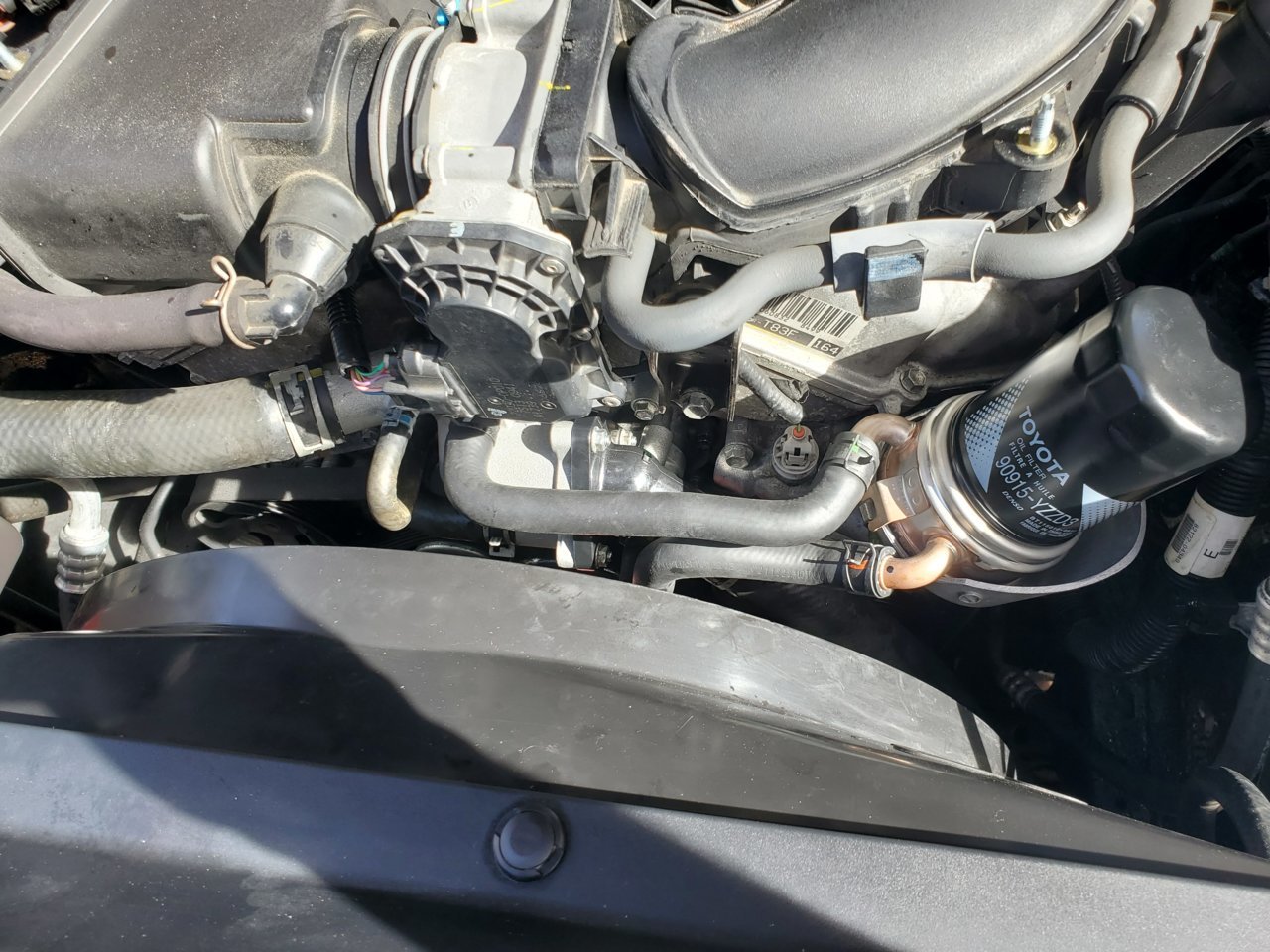

    No tow package. Bought the truck used last year with 36k miles and didn't realize it didn't have the beefed up components. Basically added them myself. Today was the last component.
    I installed the OEM Toyota oil cooler kit. Swapped water inlet housing, new thermostat, hoses with clamps, O rings, and the cooler assembly itself. Took about 3 hours taking my time and not beating myself up.
    This "cooler" is more like a regulator and warms up the oil on cold days to reduce engine wear. When towing or hauling heavy loads, it helps regulate the oil by keeping it cool by circulating coolant around a high flow point (filter housing).
    Everything came as a kit and was $445.
    Some photos:

    Any more details about the 3rd break light? Is it your design/fabrication or aftermarket?

    Mine came the same way, so I need to do the same as you. Where did you get the kit?

    Sourceone auto from eBay. Here's the link below. All the parts are OEM and literally half of the price of just the cooler assembly from the dealer. It's a pretty simple job. The difficult part was pulling the hoses because over time they get formed really tight. A lot of twisting with channel locks is what I had to do. If you're interested, I took pics of the process and can do a write up.

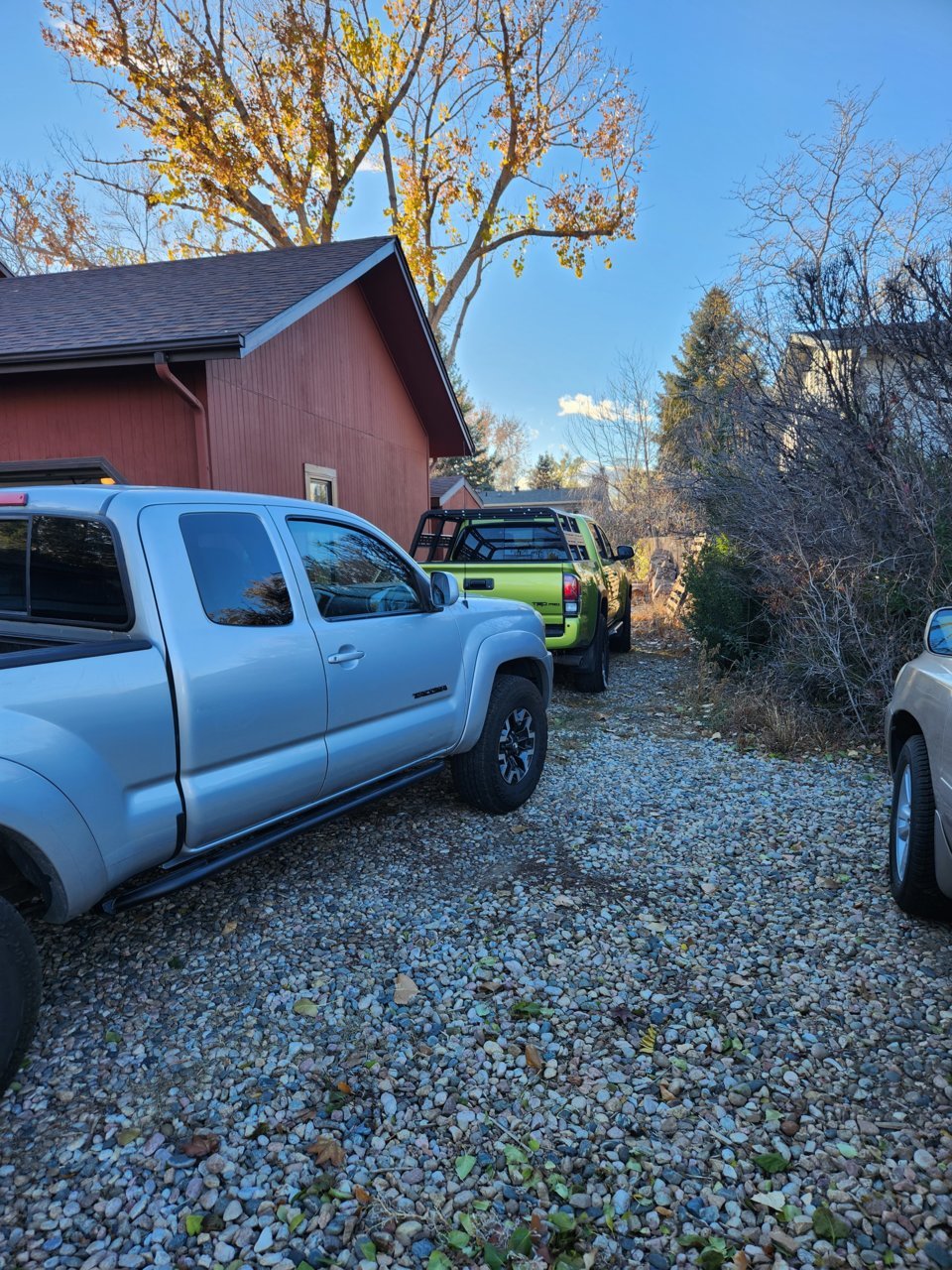

    A few, mainly added skids. I like leaving the suspension alone. I drive forest service dirt roafs in the desert west extremely extremely too fast. Toyota nailed this suspension going 65 across desert terrain. Changing it is dumb unless you have a specific need like crawling or mud.
    I didn't "do anything to it today" but I love driving this old manual 4.0 sooo much. . The shiny EML taco has sat for almost 10 days. I could drive either at any point. Old clutch wins. Love the torque curve, love the manual, love the CD player with a CD that skips. Happy Saturday "Clutch"...
