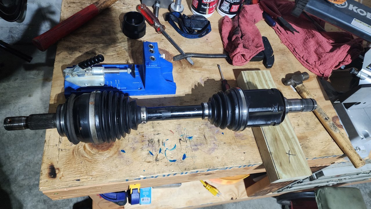

    Success on the ECGS bushing and rebuild of my CV axle.
    Was hoping that a new/rebuilt CV axle would solve my front end bouncing like a mofo when doing about 60-65mph. But not the case. Back to the drawing board. I replaced damn near everything suspension wise.
    Sway bar links, tie rod ends, sway bar bushings, upper control arms, shocks front and back, now CV axle, ECGS bushing.
    The only thing I haven't done is the LCA and inner tie rod. So frustrating.

  7. Nov 11, 2022 at 10:54 AM

    How about the shocks.?

    Oh yeah replaced those too. Bilstein 5100's like 6 months ago maybe a little more.
    I'm now leaning towards my previous owners wheel and tire selection. Lol

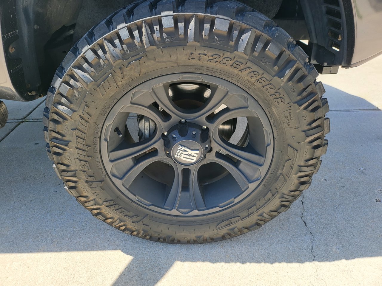

    I had some Mickey Thompson tires a while back that America's tire couldn't balance if their life depended on it. Random thick spots. Had to road force them. Even that wasn't that great. Would get the meanest shudder like braking with severely warped rotors. Played hell with the front end.

    Yeah I might have to invest in a whole new Wheel and tire set.

    I had a set of Pro Comp wheels with BFG A/T’s mounted that would not stay balanced. Maybe have them balanced again and swap front to back and see if there’s any difference.

    I had a similar experience, chasing down a seemingly unexplainable wobble. Turned out all along I had a faulty tire from the manufacturer that the place I bought them from hid. When I bought the set they apparently hid the in ability to get it to balance by designating it as my spare (full size spare with matching rim). Drove off with no wobble. When it was time i did a 5 tire rotation moving my spare into the rotation and the wobble began. Next rotation it was still there, and so on as it moved positions each rotation. It wasn't until I went to a different place for a road force balance they informed me how much weight they had to add to that tire in one spot to get it to balance. No wobble since and it's now been designated as my spare.

    I think that's my next step. Just can't break the bank right now.

    The road force balance was the cheapest mod possible in comparison to all the stuff I did chasing it down. Most frustrating part is I kept going back to the shop I bought them to have them rebalanced because of the endless wobble and they never mentioned it. Just swept it under the rug since they were under Warranty.
