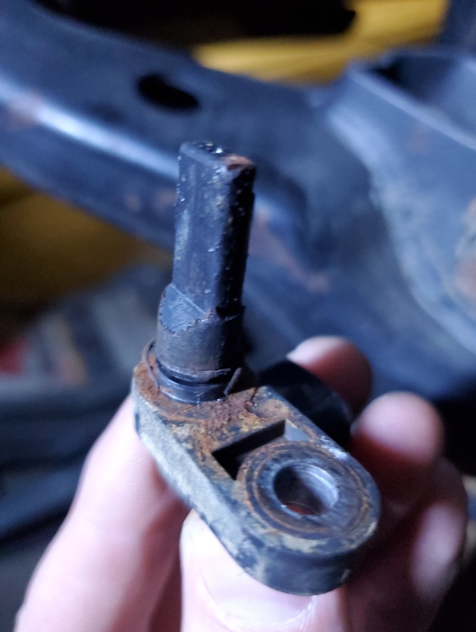

    Had my trac and ABS lights come on about a month ago, figured it was a stretched wire from my lift. Took it to the stealership to pull codes and they found 4 codes. Open or short in both front end wires, bad ABS sensor driver side, and a steering column sensor that they thought was weird. Charged me 85$ to hook it to the scanner and read out codes.
    Decided I should just invest in a better obd scanner that pulls ABS instead of giving it to a stealership again so I ordered a scanner that does ABS, a new ABS driver side sensor, and 2 new front ABS wires. Replaced the ABS wires, broke 2 bolts I need to remove now, and pulled codes myself. it was still reading all 4 codes. Didnt realize I could clear codes so after reading the manual I cleared the codes drove it for 2 days ABS and TRAC never went away. Pulled codes again and only ABS and Steering codes this time. Finally got around to pulling the ABS sensor and what do ya know o-ring is split open and its all gunky. I must have accidentally sprayed PB blaster near the sensor and it ate the o-ring letting junk and moisture inside. Popped the new sensor in and cleared codes and the lights went away this time and the codes didn't come back.
    Now I just need to fix the blower motor wiring and resistor and she's back to a good state

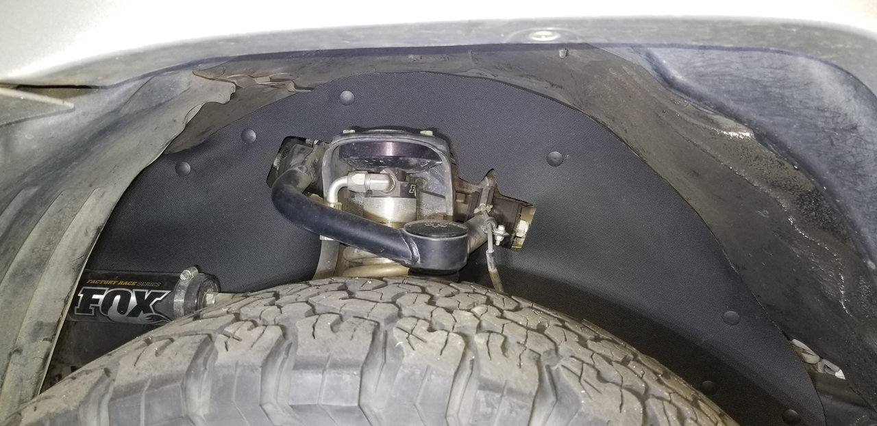

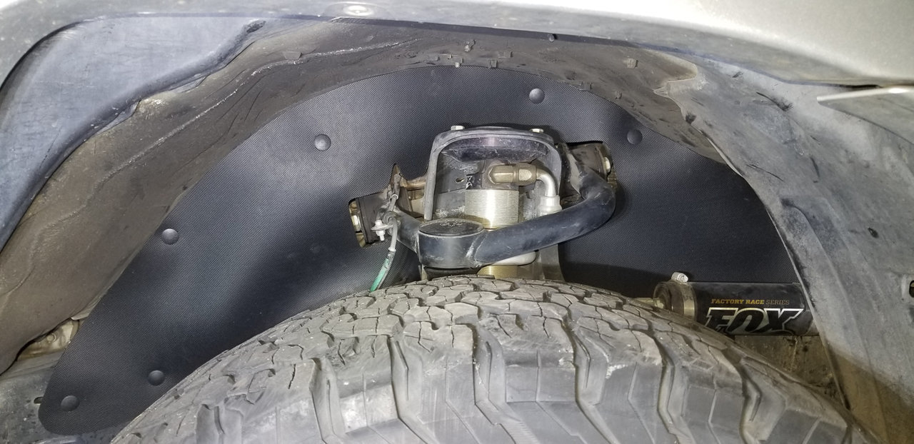

    Used the splash guard thread to make a new set:

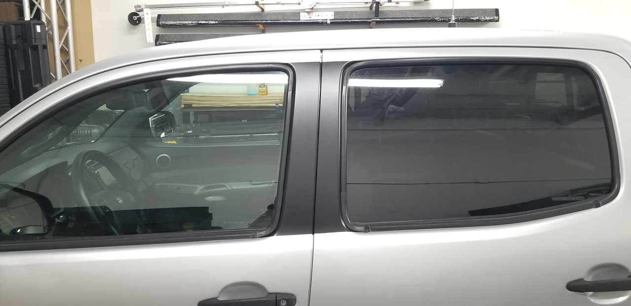

    And wrapped the B pillars in satin black. Not bad for never having vinyl wrapped before.

    Part number for the wire and the sensors?

    What scanner did you wind up with ??

    Any more info on the homemade splash guards? Those look pretty good!
