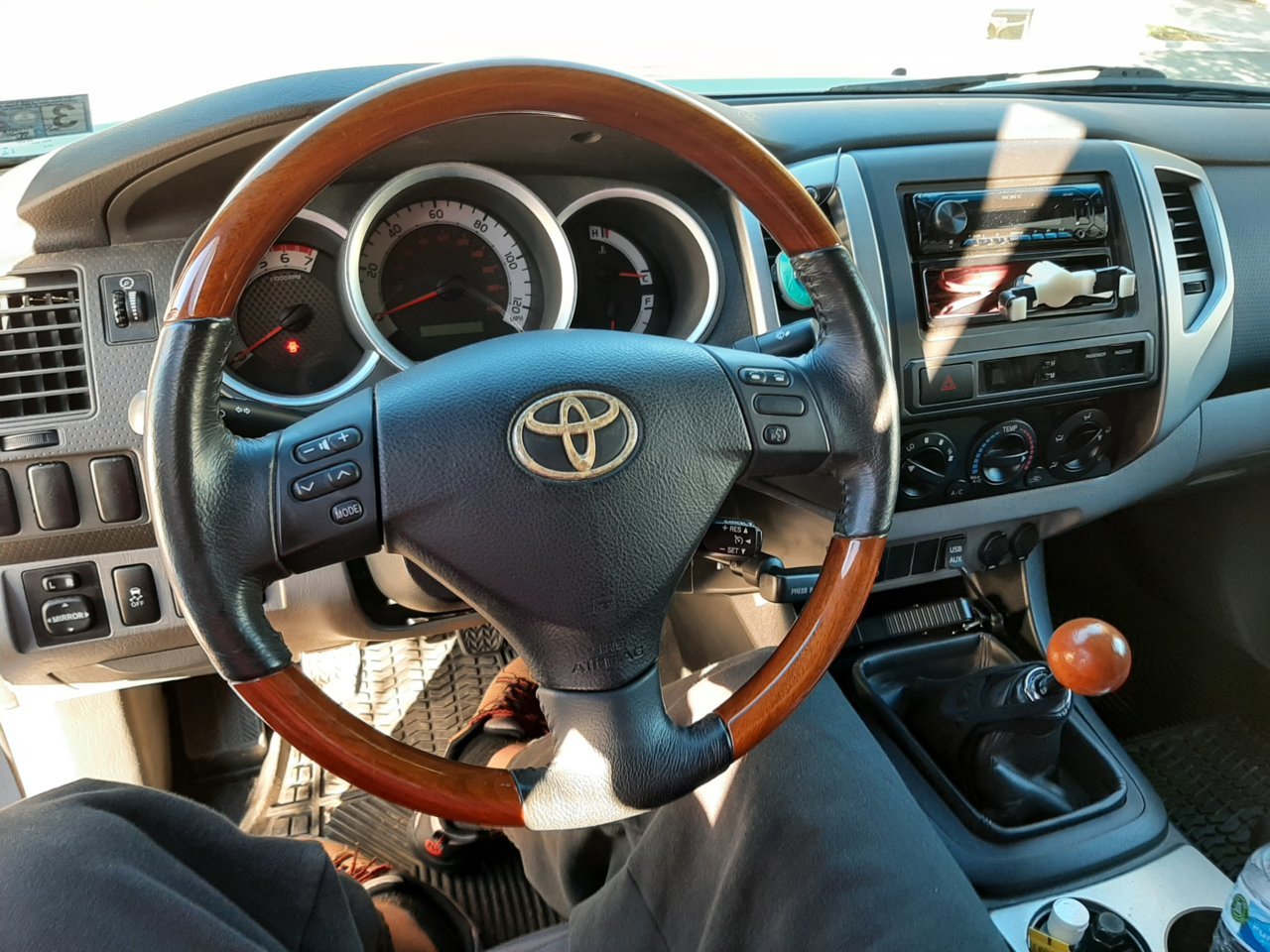

    I classied up my interior with some woodgrain.

    Nice…what’s that knob? Did you make that or purchase it somewhere. I just made one from a pool ball and for something so simple I like it a whole lot better than the factory one.

    2009 RX 350 wheel, 2006 Solara airbag, and I made the knob myself from some birch wood stock and stained it to match the wheel.

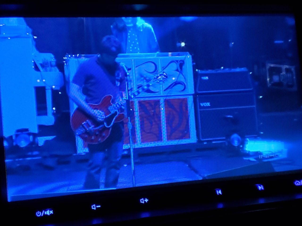

    Not what I did to my Tacoma but what I did in it. 30 minutes to kill waiting for my grandkid to get off work so I pulled up an old Oasis concert on the ole Atoto. Good jams. :rockband:

    Looks great, did you drill and insert a nut in the ball? I expoxied a lock nut into the one I made but getting the 5 to line up straight I ended up putting a jam nut on also.

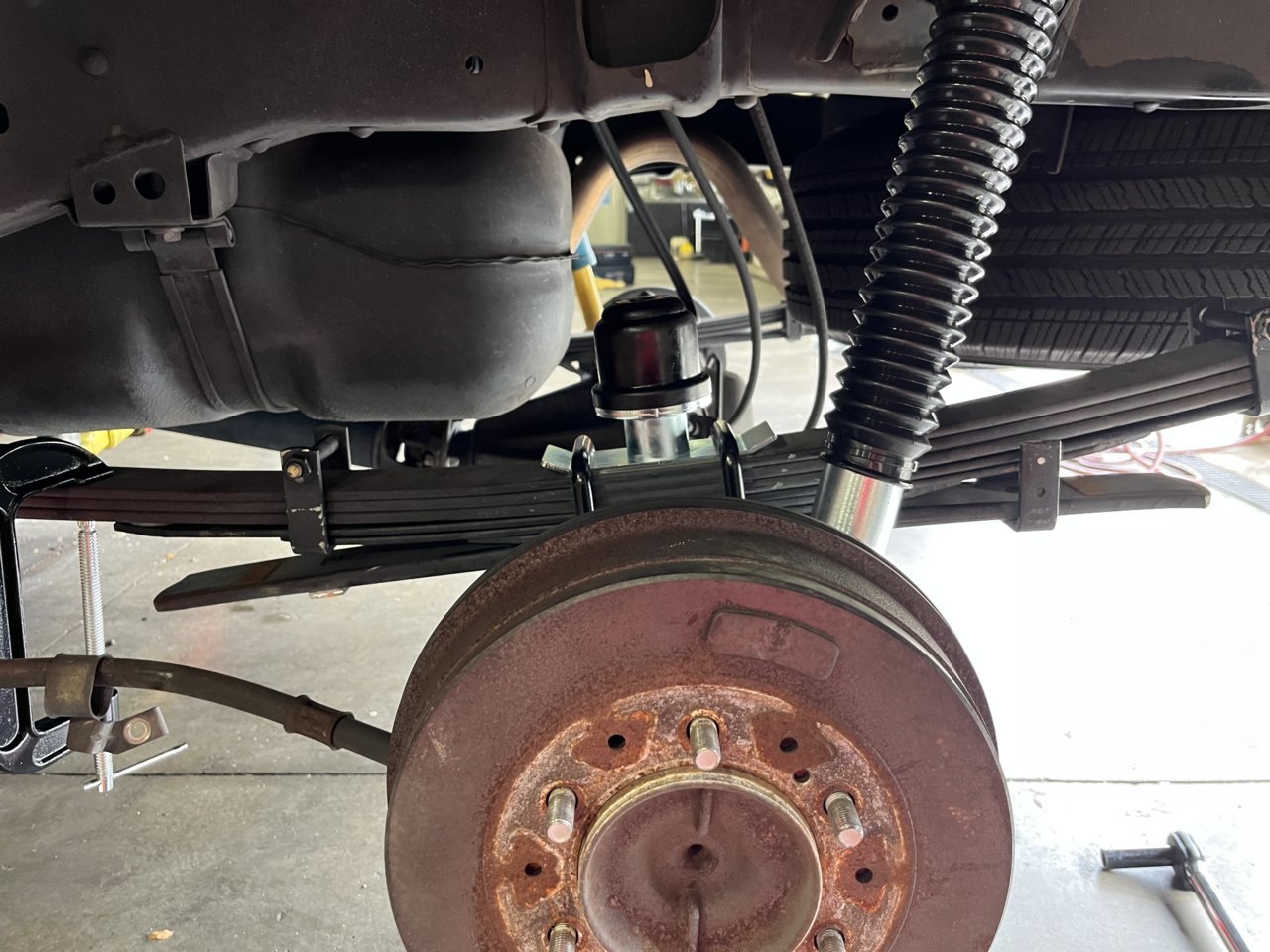

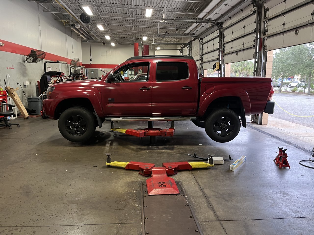

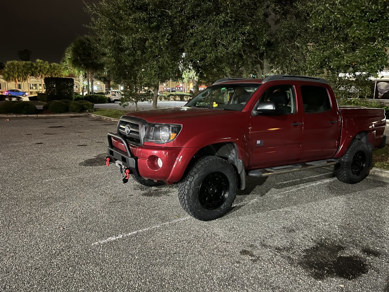

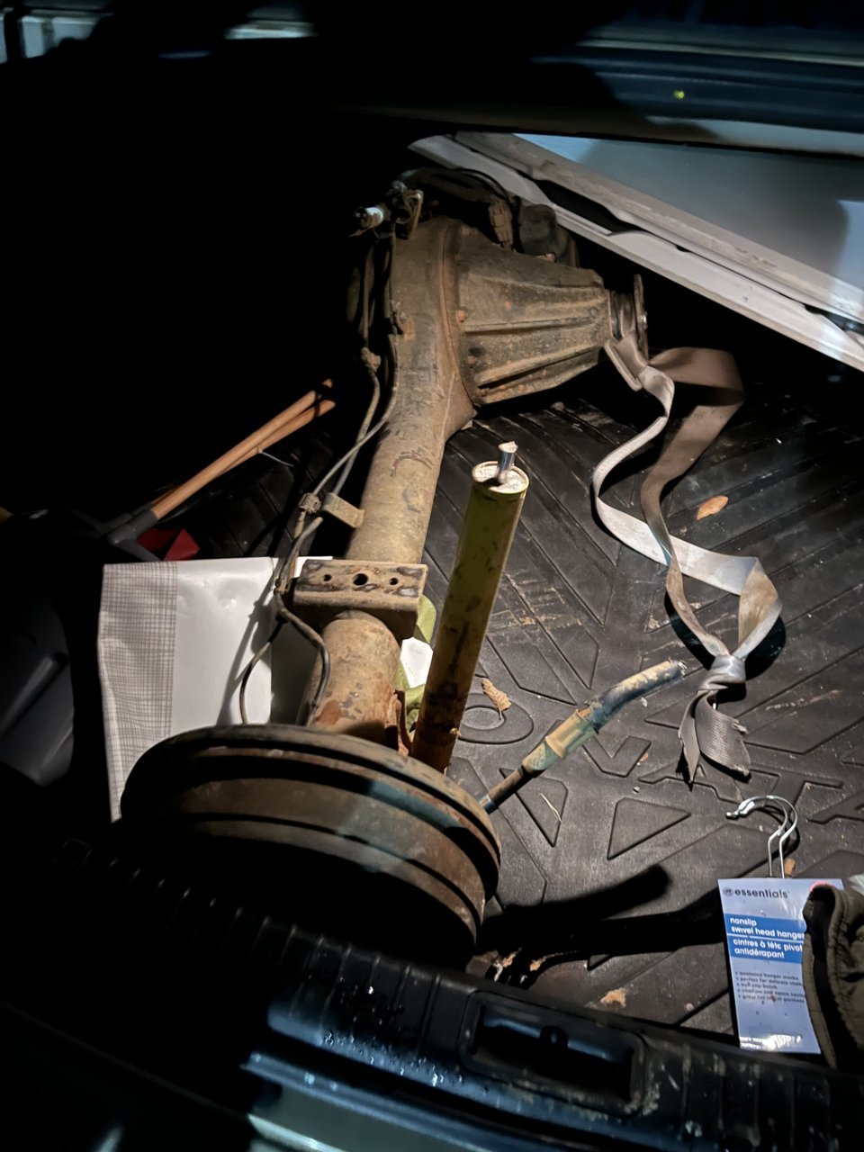

    It’s been an interesting week. On Monday I messaged a guy about a rear axle from a TRD-off-road down in Orlando. It was a junkyard with predetermined prices so it was only $450 and I was scheduling a time to come pick it up on thanksgiving. While I was at work on Tuesday I asked my girlfriend to call him and ask him a question for me since I was at work and he hadn’t answered my message from the night before. She went ahead without telling me and paid for the axle then drove down to Orlando to pick it up for me… in her 2009 Hyundai Sonata.
    I’m gonna marry that girl but she definitely jumps into things without thinking sometimes. Eventually I’ll get her car to the shop and try to finagle it out with an engine hoist and a few more hands. Then I can find a way to test everything and see if I need new gears for it (does anyone know how I could test this once I get it on jack stands?). Then on Wednesday I brought my truck into the shop and finally got my new suspension installed.

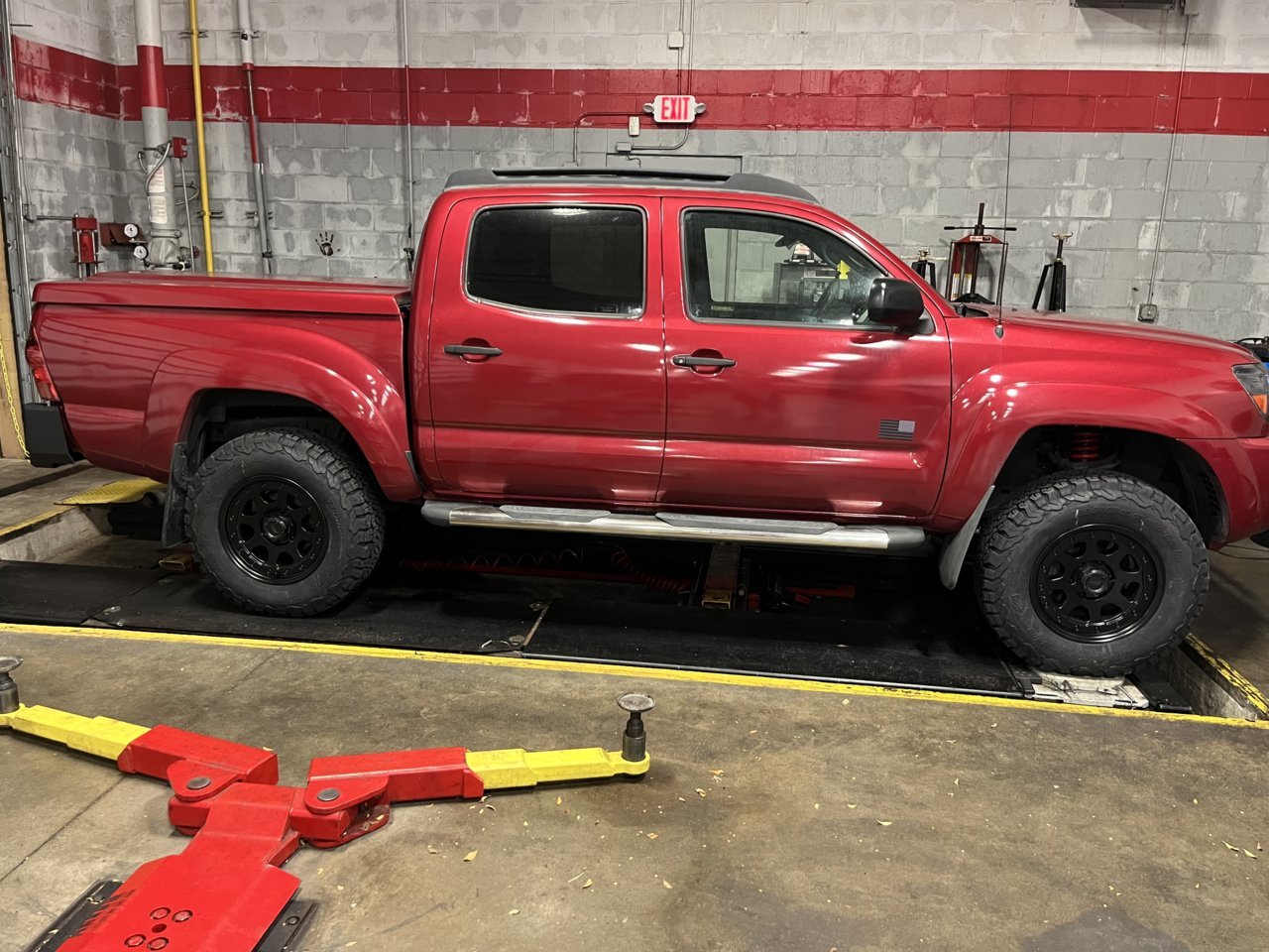

    Before:
    During:

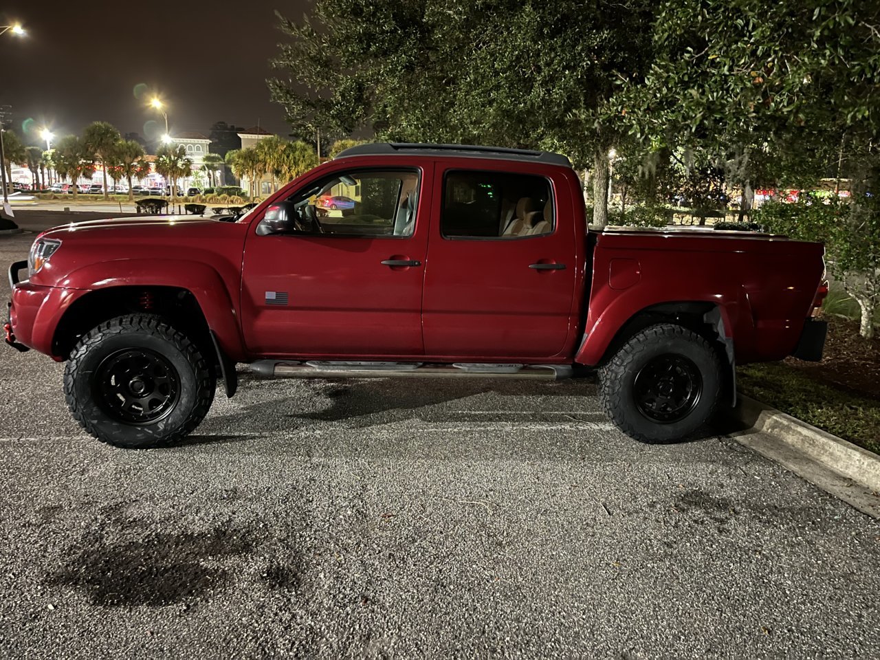

    After:
    6F7CE553-69B7-48CD-90ED-45253F70D94C.jpg 24F737D2-ADDE-4D5E-B307-A9C8CB86BFC4.jpg
    I love it, but is that much squat normal for an Icon AAL with the overload leaf still in place? It’s got a few hundred pounds of tires, wheels, and some tools I like to keep at home in the bed in that picture. I put in Bilstein 5100s all around, C59-314 Dobinson coil springs up front with new top hats, Icon AAL in the rear with the overload leaf kept in place, Pacer Nighthawk wheels with 255/75R17 KO2s and 5 new TPMS sensors so I can finally be rid of that light on my dashboard.

    Nah, I just sent a tap straight into the wood. The threads bite just fine and it doesn't seem to be going anywhere while driving around.

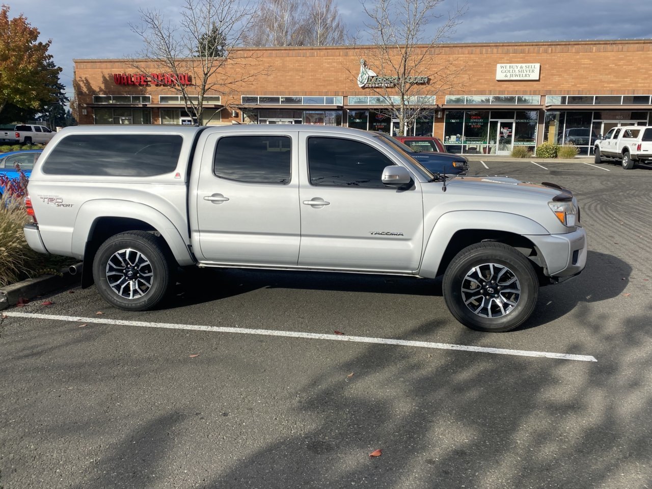

    Just got a set of stock 17” for better mpg. Keeping the old set w/ wild peaks for off roadin
