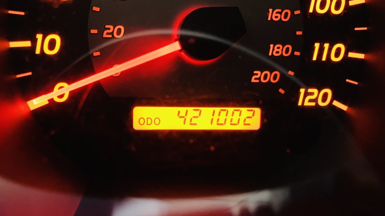

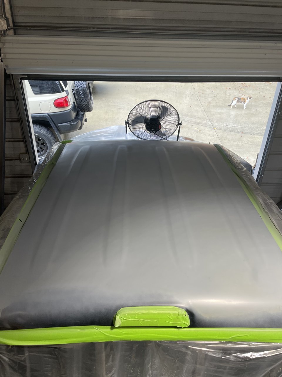

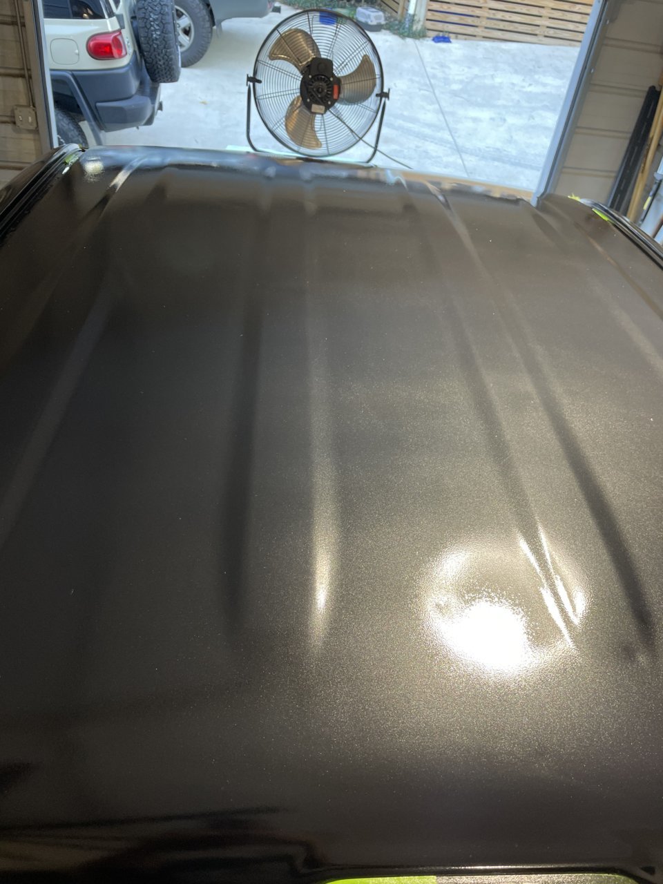

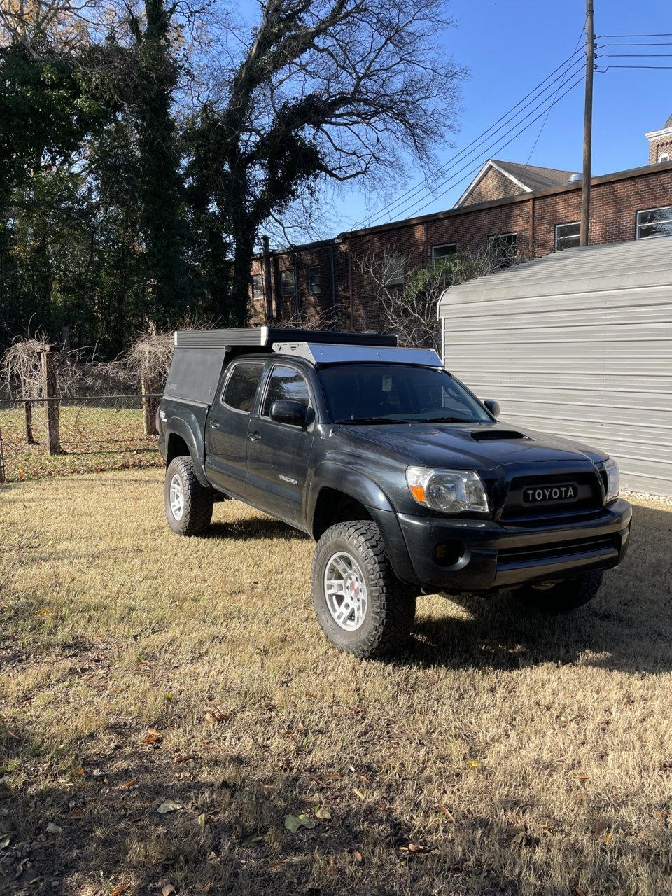

    Been a while since posting, but I've finally gotten around to a few items that were really plaguing the truck:
    • Roof had major rust issues developing. I was in line to drop off the truck at the body shop and kept experiencing delays. Finally, I just went and got the materials and the color-match rattle cans and did it myself. It's just the top of the truck and no one will ever really see much of it. I had painted my rear bumper before so felt confident enough to tackle it.
    • Added the Sherpa Animas rack I'd been waiting to install after I corrected the roof issue.
    • Installed some much need axle shims from Tom Woods for the vibration I was getting around 10-15 mph accelerating. I did all the measurements with the GFC on the truck, then installed the shims as I was painting the roof. Since I didn't have the GFC on the truck after install and test drove I still had a slight vibration at around 5 mph. Once, I set the tent back on the vibration seems to be gone. Any slight vibration I feel now could be gone after I replace carrier and u-joints.
    Feels like an enormous monkey off my back getting the paint and vibration issue addressed.

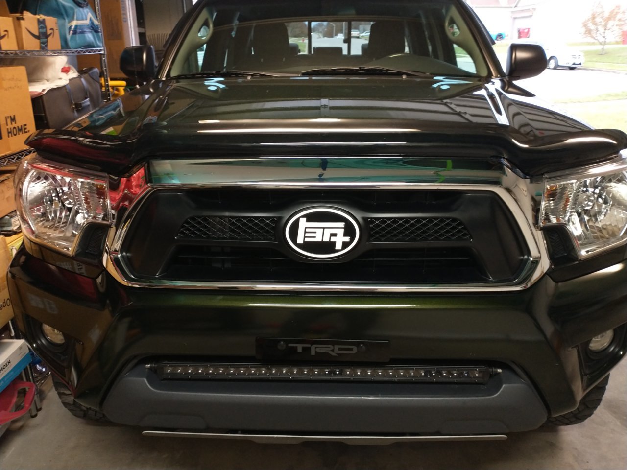

    Put on a new grille emblem and took a quick photo

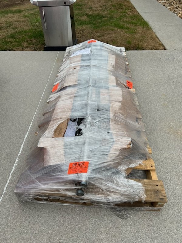

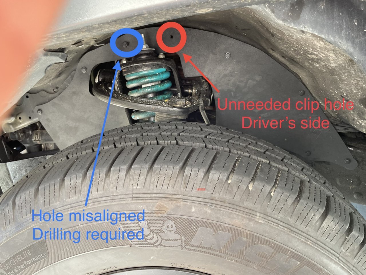

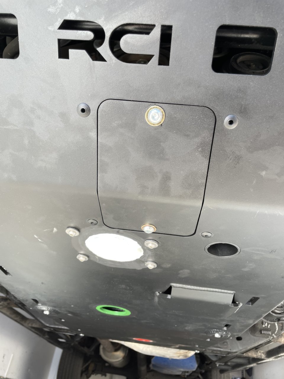

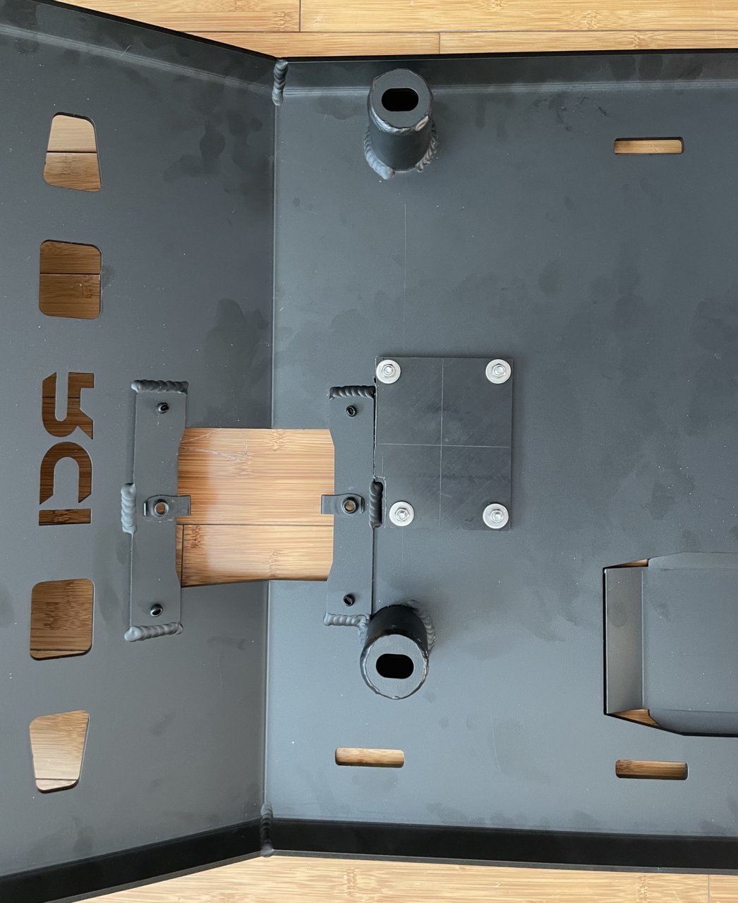

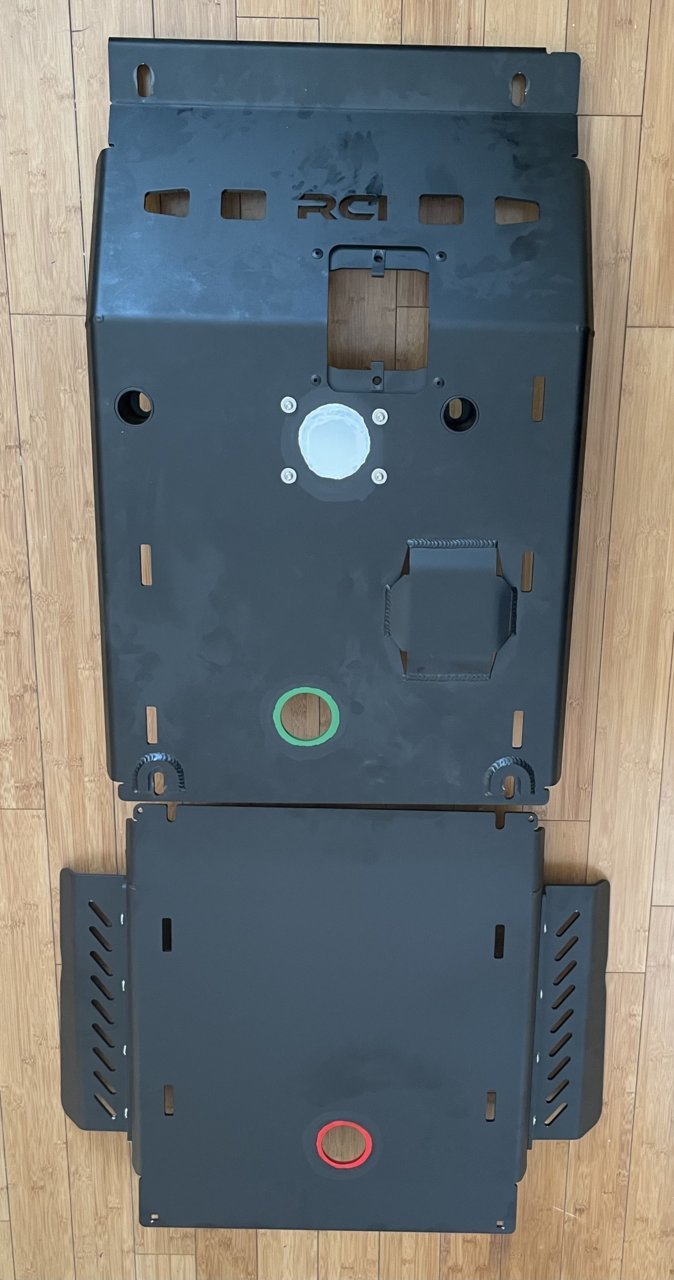

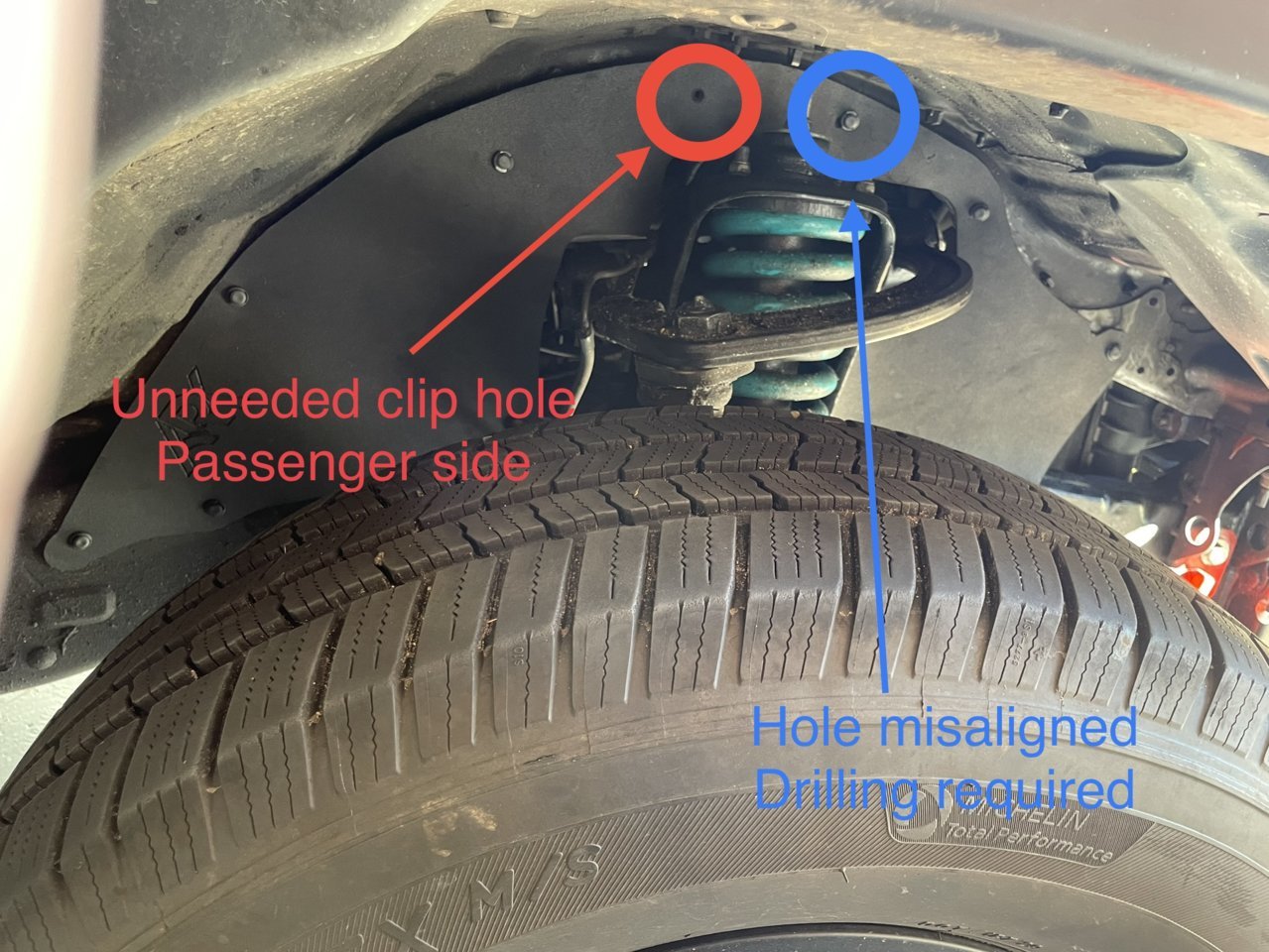

    It has been a helluva busy week in my garage.
    Modified and installed my RCI engine skid + trans skid + cat guards.
    Installed ARK splash guards to replace my shredded OEMs.
    Installed SDHQ billet battery terminals.

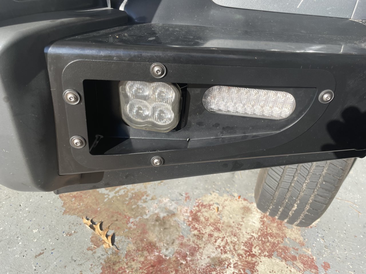

    Refinished my rusty Slee ARB foglight surrounds. Slee's stuff is great, but their powdercoat sucks.
    And, most importantly, added EPDM sealing washers to every stainless steel bolt I've installed thus far. Rework is a pain in the ass, but dealing with the consequences of galvanic corrosion would be a lot worse.
    Details, if you're interested:
    https://www.tacomaworld.com/threads/a-non-enthusiasts-tacoma-build.667560/page-9#post-28078268
