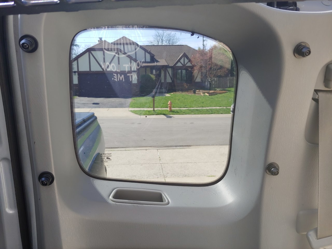

    see if theres a brace in the back where the handles would go and rivet nut them in.

    I am pretty sure that my dad's 2005 TRD OffRoad has driver and passenger A-pillar grab handles.

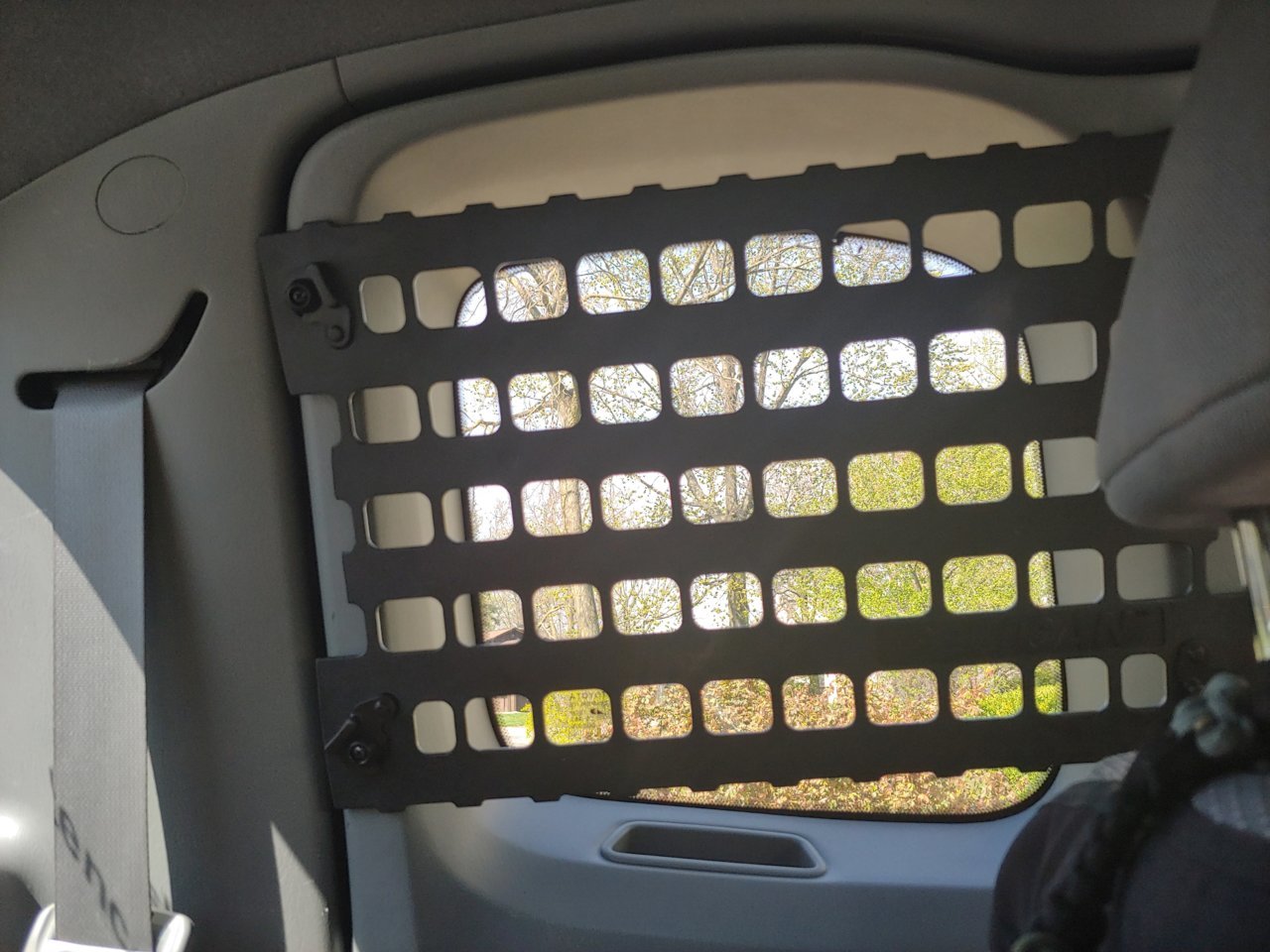

    This is exactly how you install it, there is a square hole you insert a rivet nut into. You do need to cut a hole in the headliner. I have the meso kit installed on my 05, but I wish I bought a standard molle pattern one, the hex pattern is not great for threading the molle straps through.
    This is for the roof area in the behind the front seats.

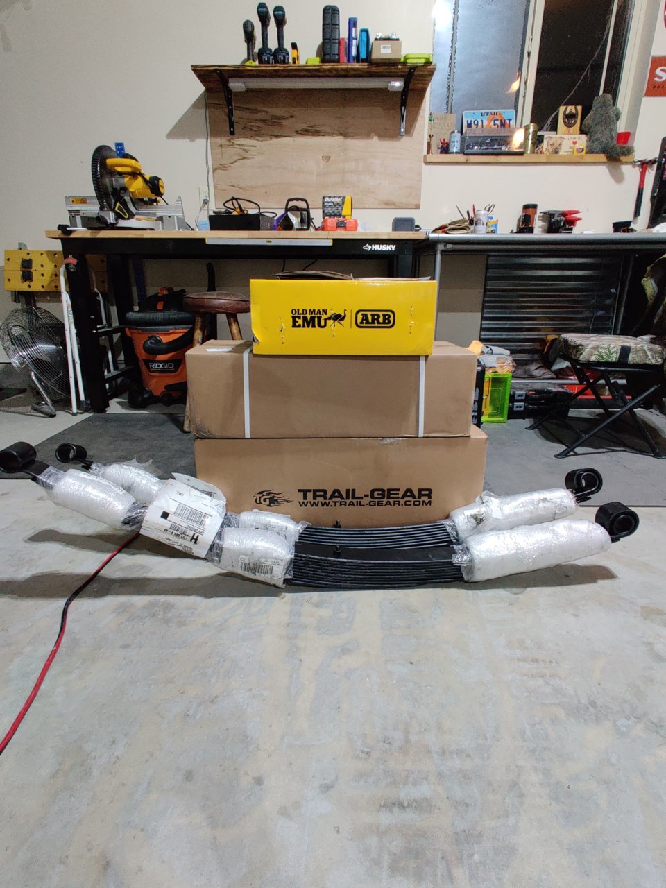

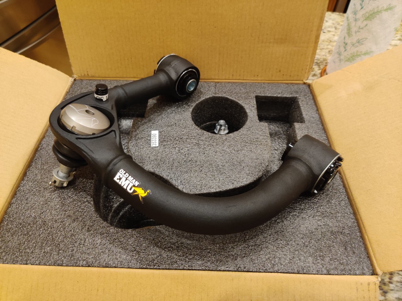

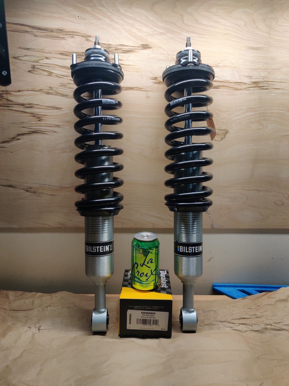

    Finally picked up everything I needed for the lift!
    Went with the Wheelers Trail pro Kit, which seems to just make things way too easy.
    Bilstein 6112 w/600 lb coils up front, 5160's and All-Pro Expo Springs for the rear. I also picked up a set of OME UCA's which are incredibly beefy for the price.

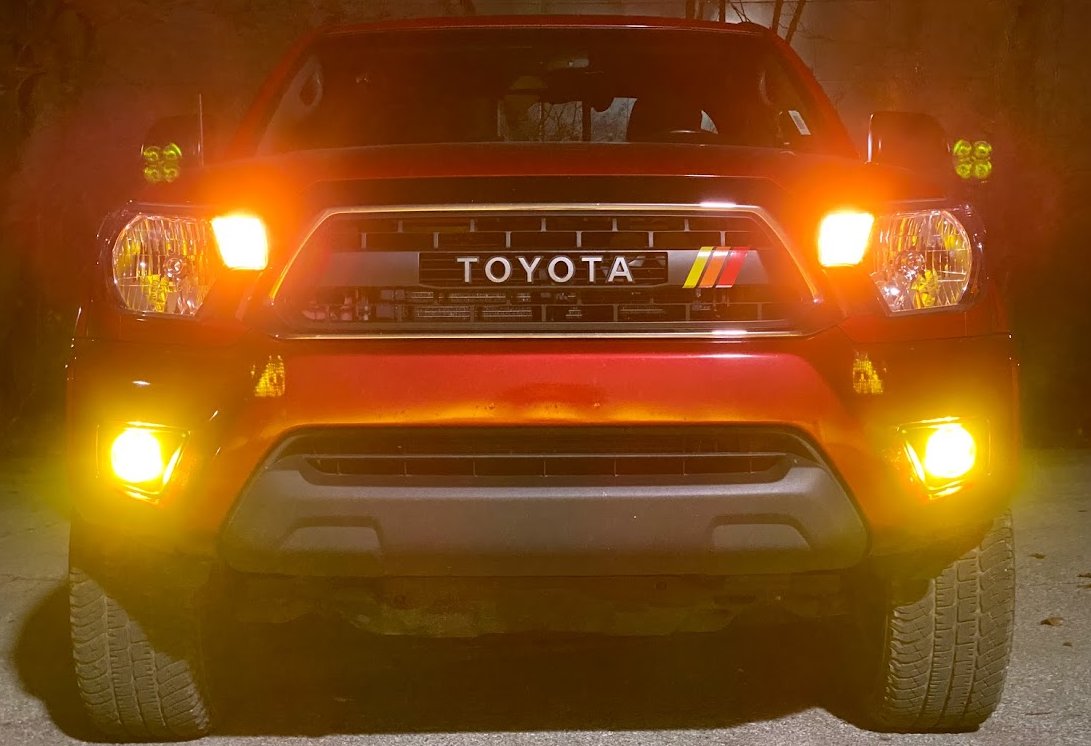

    No issues with mine but mine is a 2011 so it’s probably a little different. I would contact Diode Dynamics.
