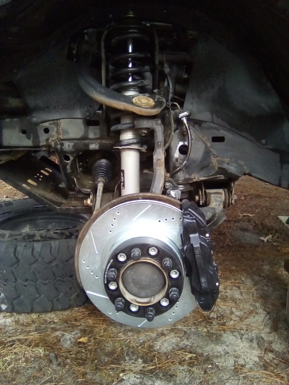

    Last 4 days-
    Replaced the worn out outer tie rod ends with Moog greasable ones and replaced the inner boots.
    Took my sway bar off, will see how I like it.
    Finally put the new brakes on. Rebuilt the calipers with new seals, and knocked off 182k miles of crap and painted them. Replaced the rears too. Installed the extended front and rear brake lines for some piece of mind. All the hard lines gave me trouble. I replaced the fronts and managed to get the rear off and back on. PITA.
    Relocated the diff breather. Wish I would've done that way sooner by itself as an "easy win".
    Lastly I put replaced the upper bushings on my rear shocks and put new shock boots on.
    Rotated the tires while I had them off and just have to bleed/flush the brakes tomorrow.
    Now I need to find about 800$ for some UCAs..

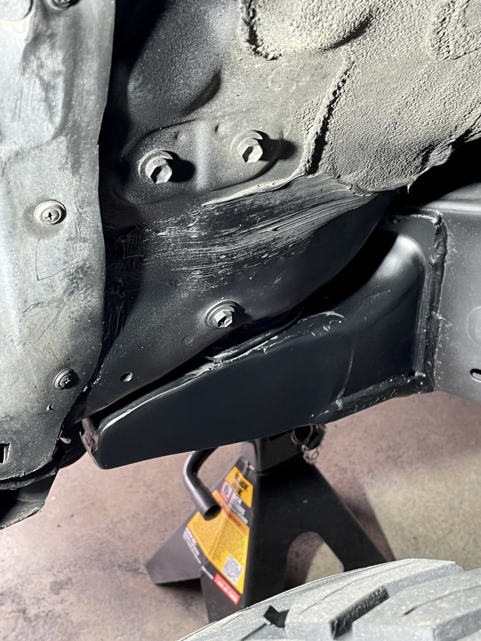

    Took a crack at a DIY CMC with my buddy, came out pretty well if you ask me. Also hammered the pinch weld outwards so I could fasten the wheel well liner to it. Time to make the next tire size jump…

    Looks really good! I beat my pinch welds outward for the same reason, but we'll see if I ever put some liners back in. I cut my fenders so it'll be a from scratch thing. Y'all did a clean job.

    Thank you! Grinder and paint make me the welder I ain’t lol. That’s another reason I’ve held off on trimming my fenders is the liner

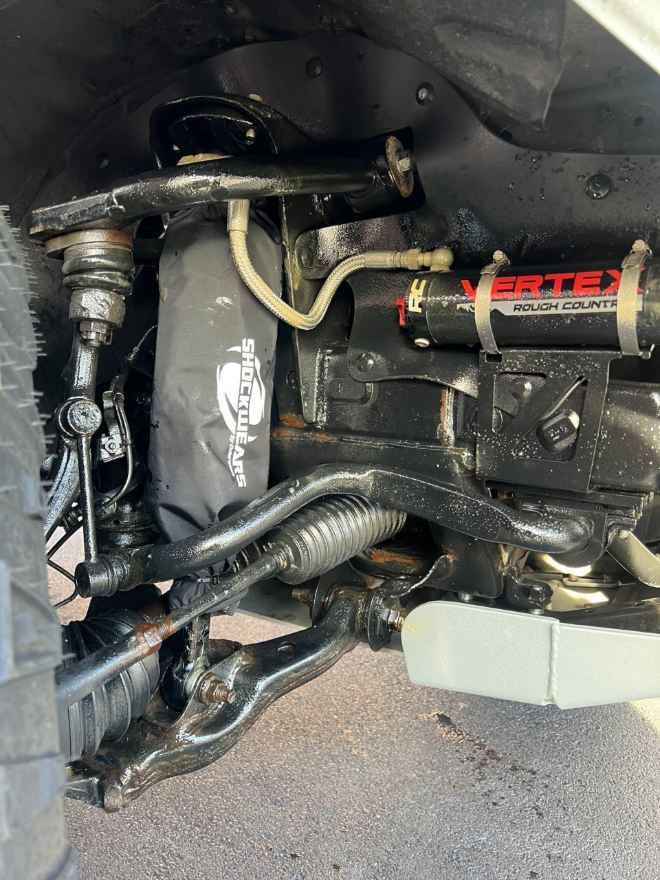

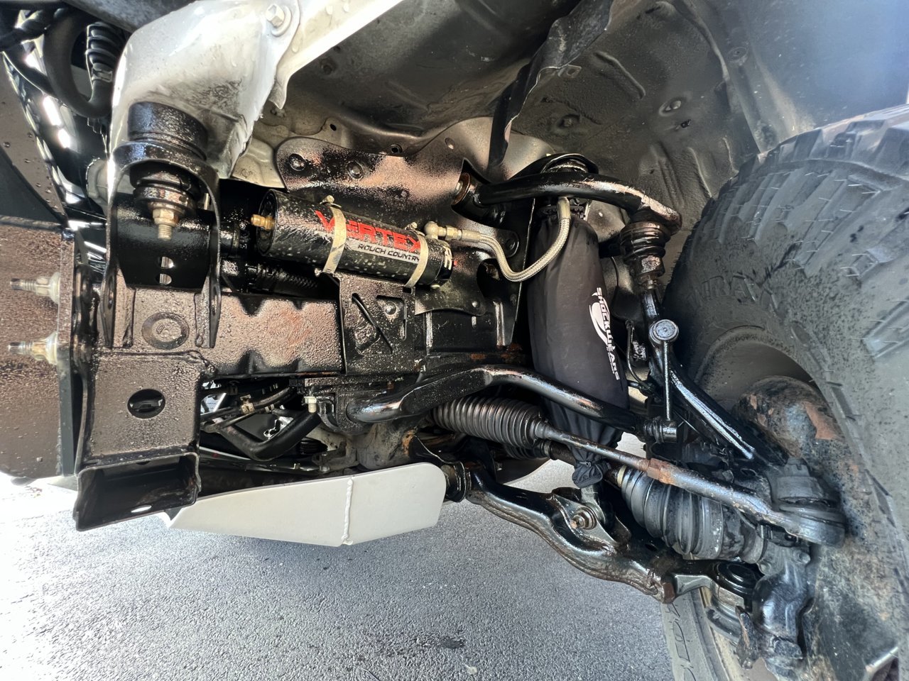

    My first set of coilovers, taking some precaution before they start throwing salt and all the good stuff up around here.
    Applied fluid film and coilover covers.

    Got the rear brakes dialed in and brakes bled. It stops well and isn't spongy. Broke them in as per manufacturer instructions and went to load up on animal feed. Took my normal windy back roads and I am 1000% pleased with having the sway bar off. I was on the fence since my truck is a daily driver and have my wife and son in fairly often. I felt none of the body roll even during some higher speed curves and with 300 pounds in the bed. Recommend giving it a shot if you're thinking about it.

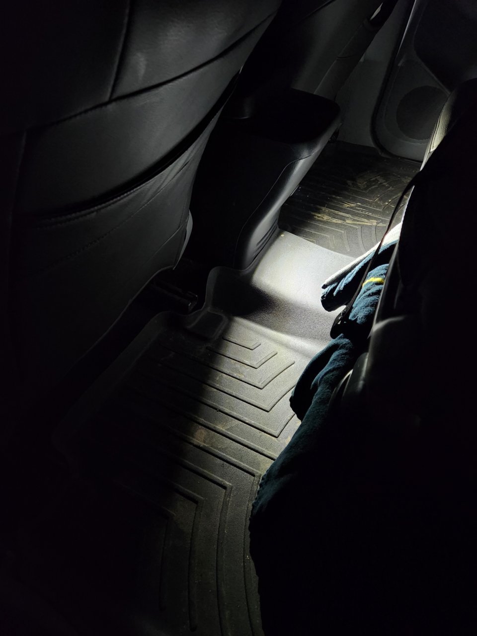

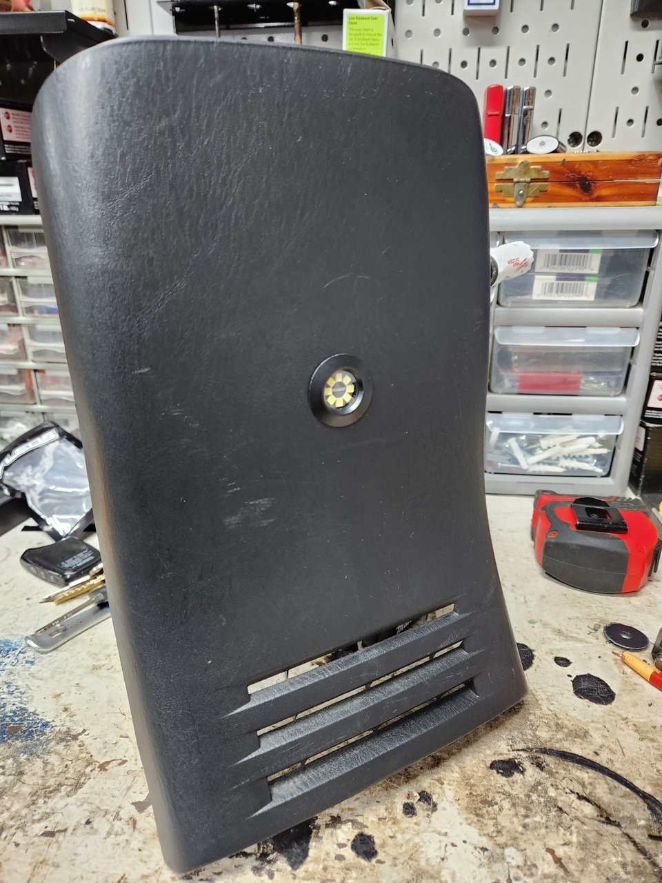

    Finished up the courtesy light project (stage 1 was front footwells) with a single max pod in the rear. Gives off just enough light to find my 5yo's socks when he starts chucking them.

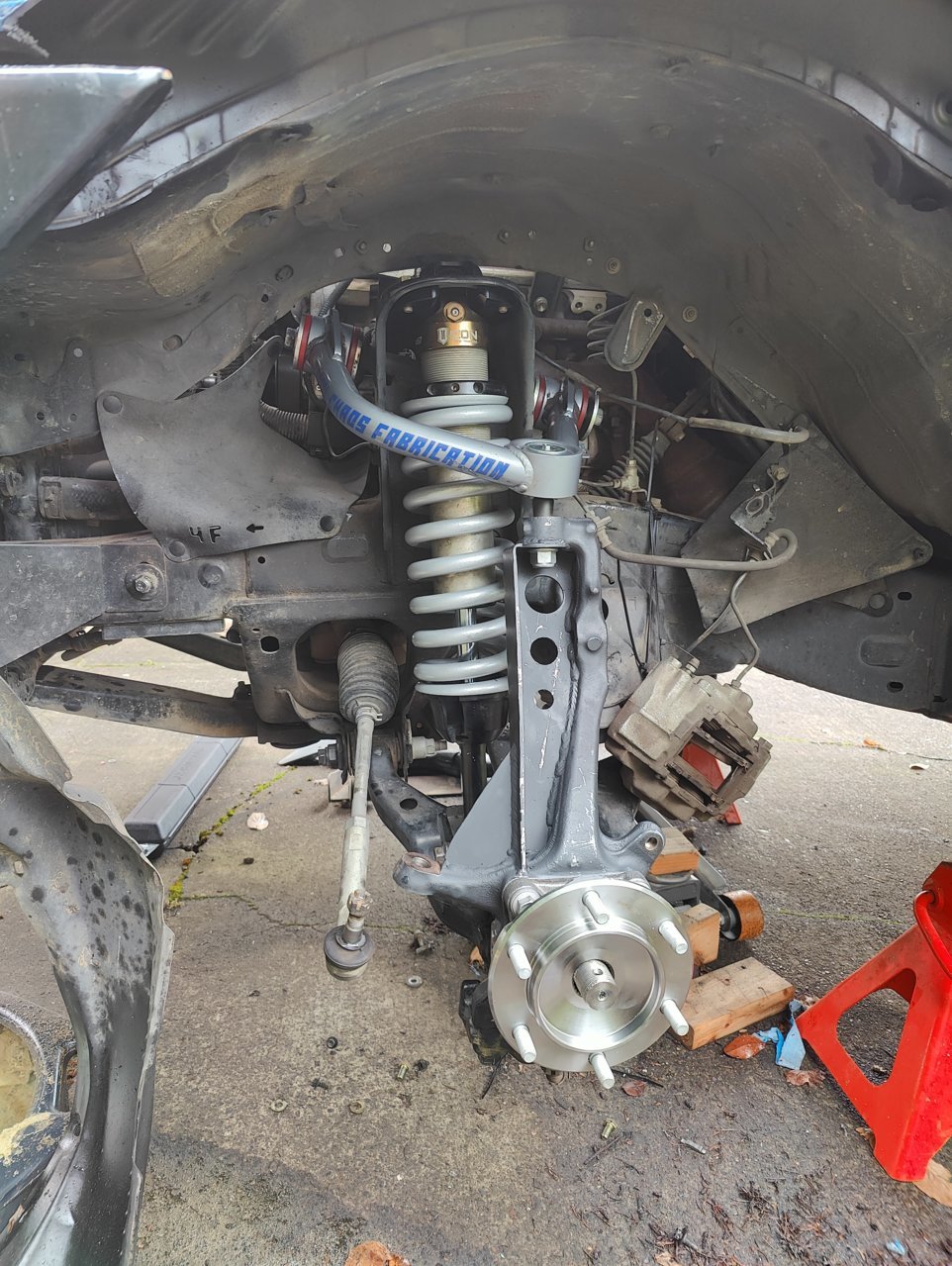

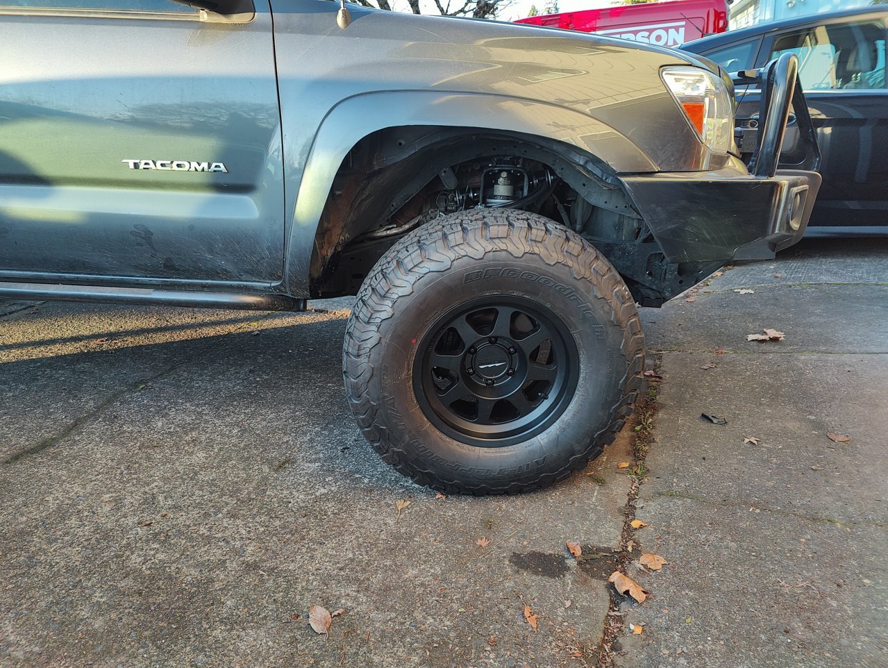

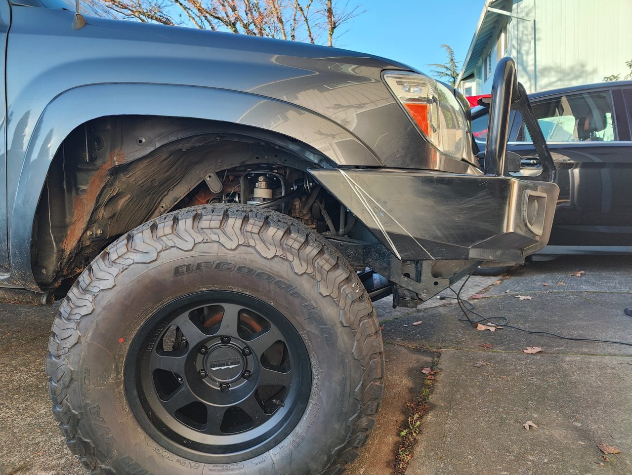

    I've been too busy to post as I went. Had a lot going on I missed all summer wheeling, truck been down since Aug.I got the final alignment today.. So here is what I did today , and some if what I did doing a 63 Chev spring swap, rear shock relocation, gusseted spindles, marlin lca weld on armor, going to 35" tires. Doing the delta joints on my TC ucas then swapping for spcs for camber correction. A custom car grills fron grill. As for today I trimmed the ARB to match my fender trim
