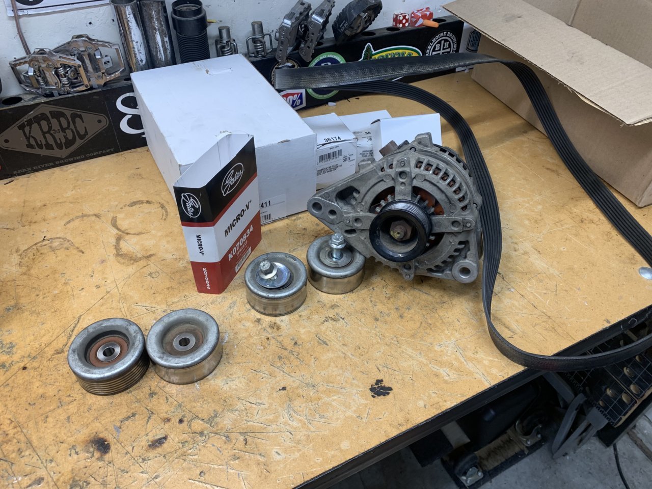

    Pulleys and belt fixed the whine on Sunday. Alternator fixed the rattle today.

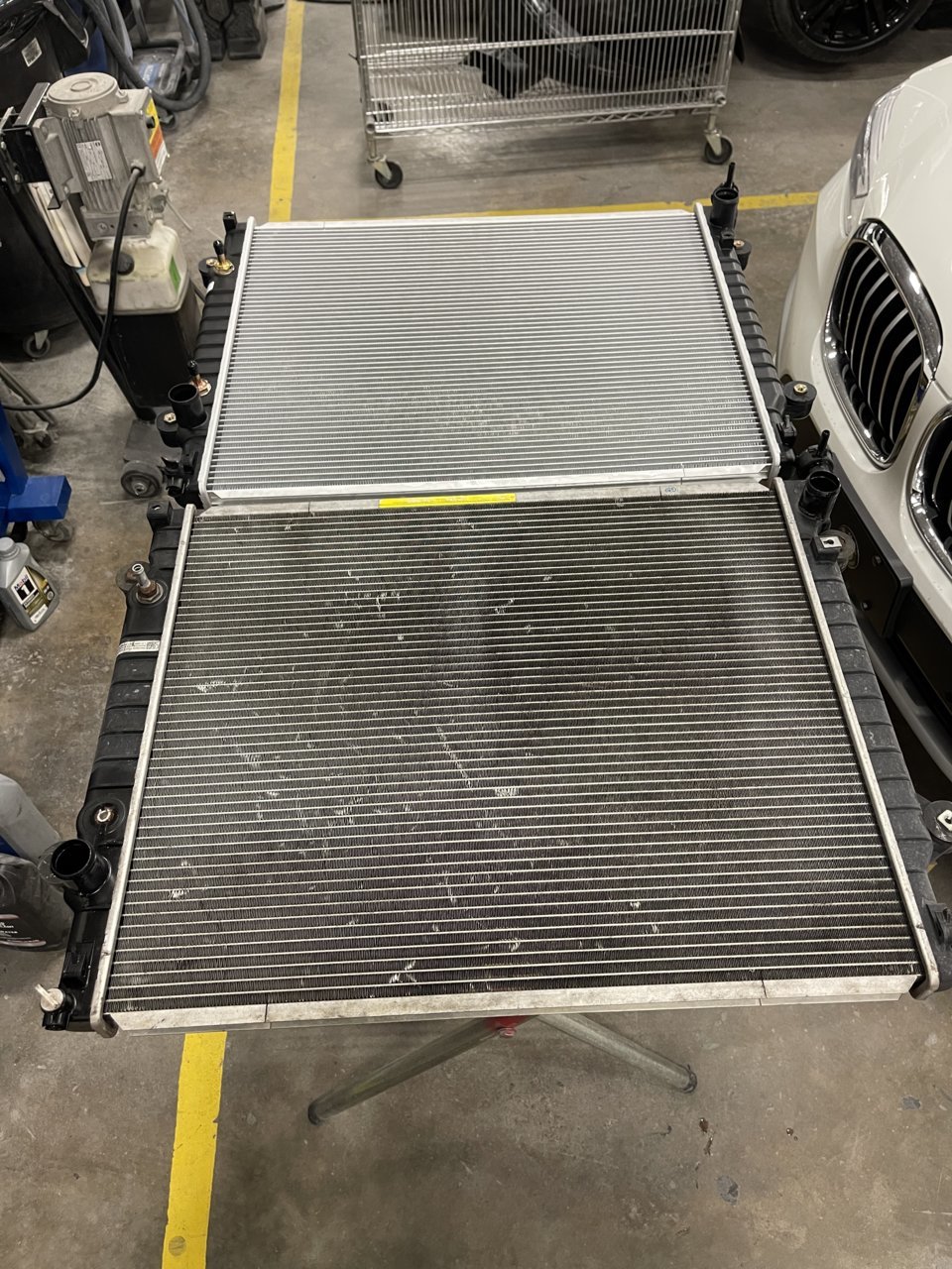

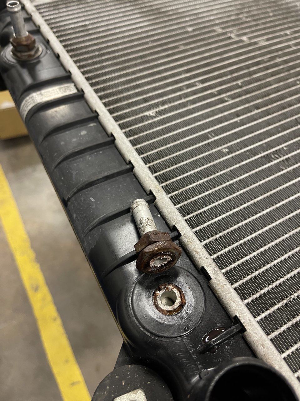

    Last time I buy an aftermarket radiator.
    Transmission ended up being 2 quarts low.

    That sucks. Good reason to completely bypass the radiator and install a large transmission cooler.

    Umm, no. Coolant is used to heat up the trans fluid to operating temp. There is such a thing as running it too cold

    Duh, yeah, that's why the good ones have a bypass to heat the fluid to operating temps.

    Lol, no. Not the same thing

    I have used transmission coolers, bypassing radiators, on some vehicles, with zero issues. One was a Tacoma that I personally drove over 100k miles with the radiator bypassed. Never had a single problem with that transmission.

    What Is trying to say…I think…is that in cold areas, it takes a while for your transmission to warm up.
    Like me…when I wake up, it’s 32 degrees outside. So as I’m driving, the engine is warming up, and warming up the tranny fluid as well. So my transmion heats up more quickly.
    if you bypass the radiator, then it will take a longer time to heat up your transmission.
    I’m all for getting up to operating temps as soon as possible as well.
