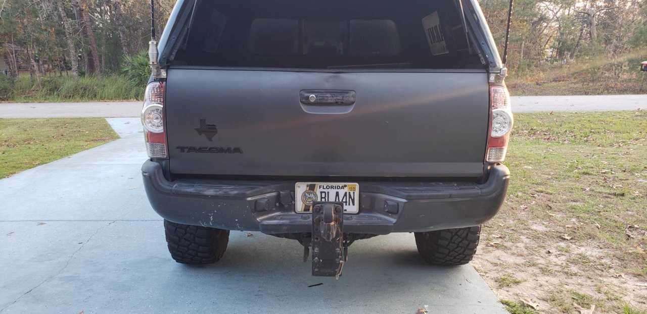

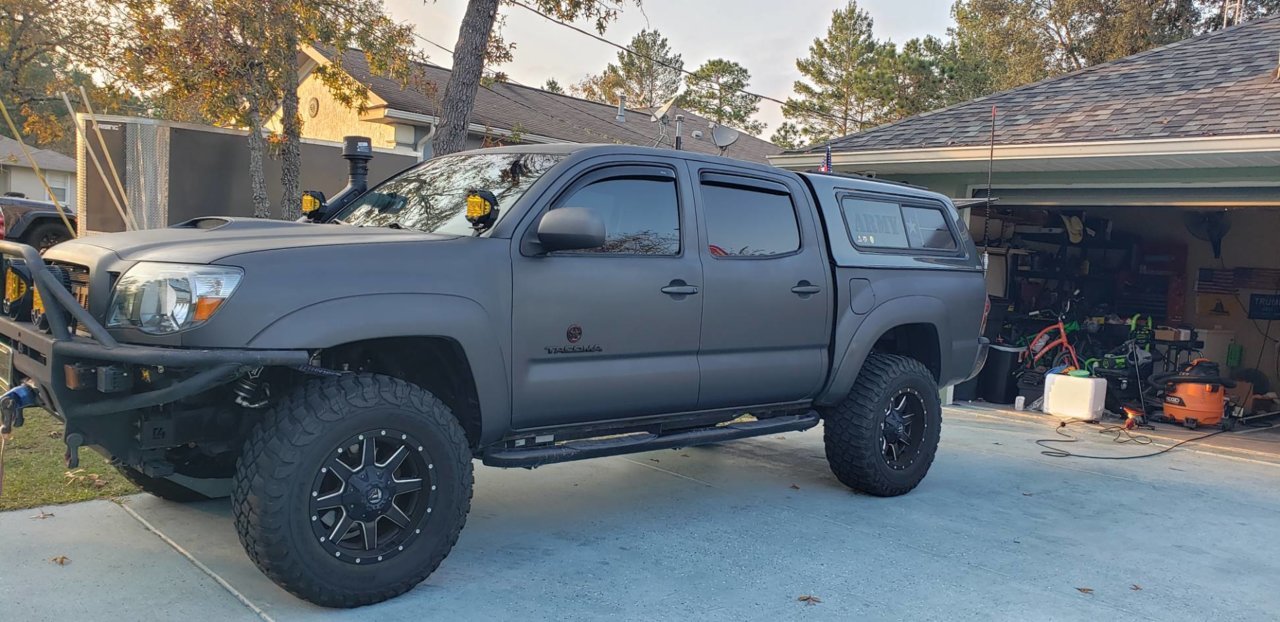

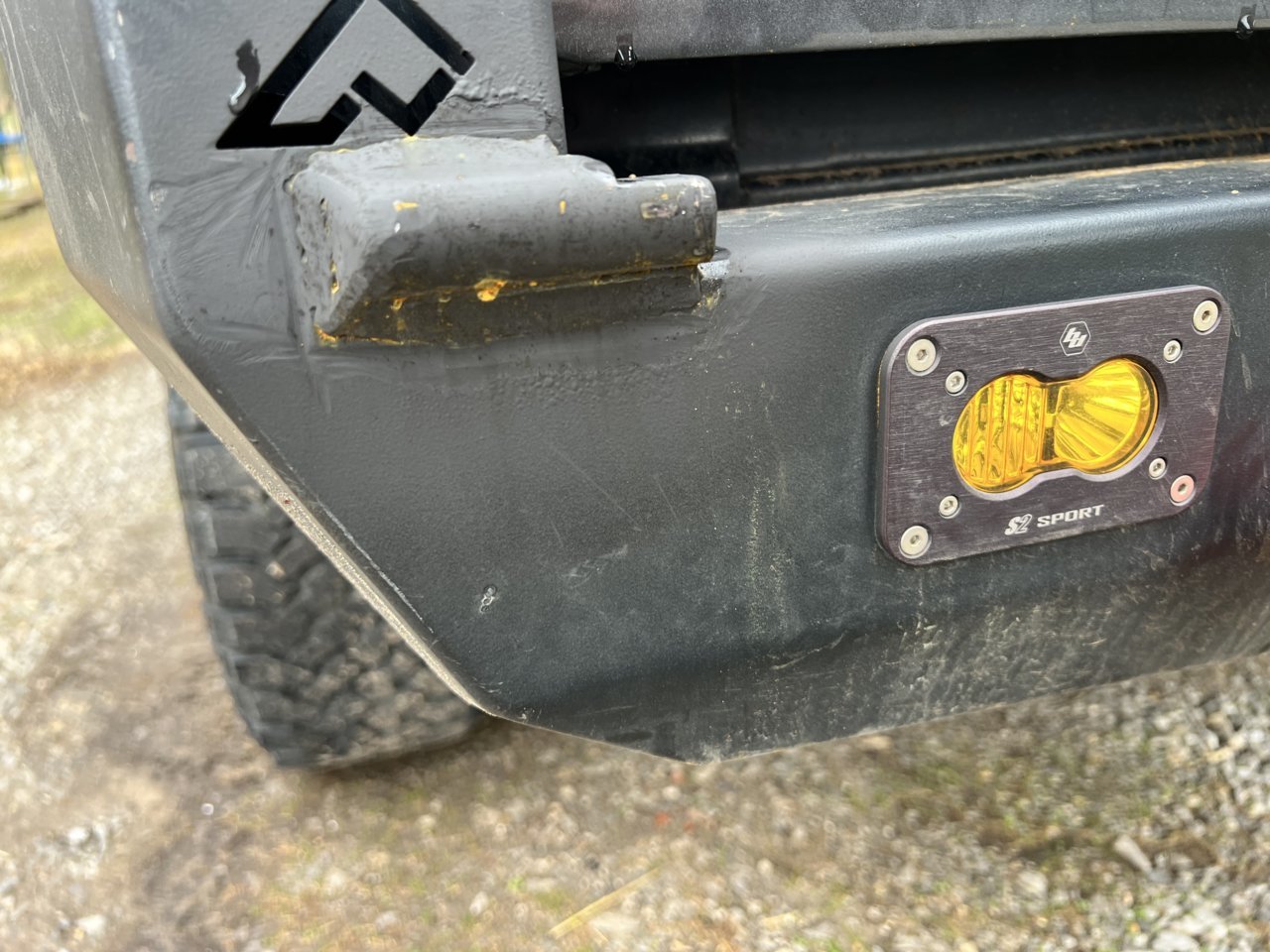

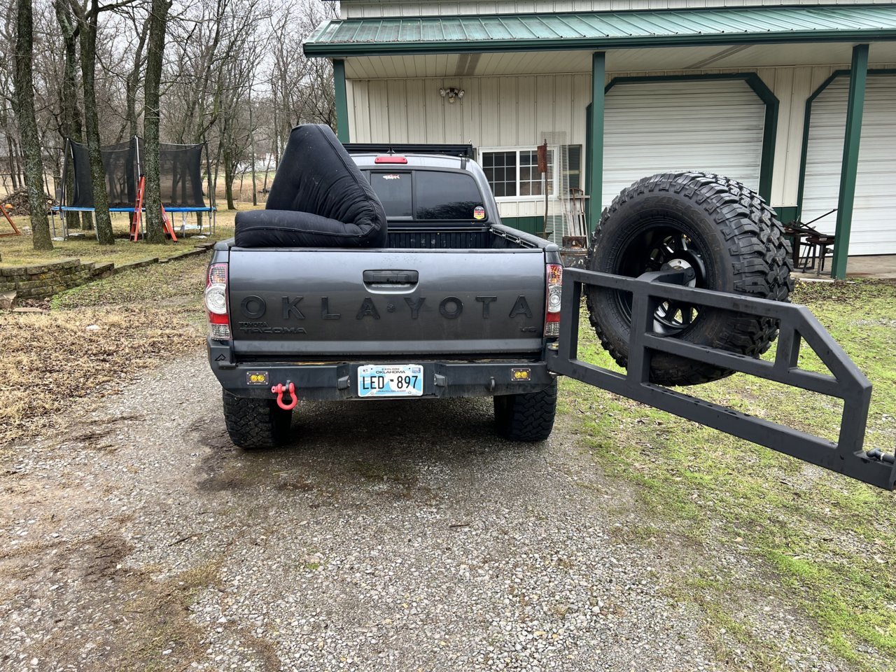

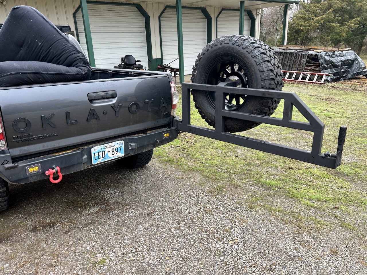

    Done by me: decals, plastidip, and vinyl. More to come. Not done by me: Icon front/rear suspension; Total Chaos UCA’s; Method wheels/34” Falken tires; Prinsu cab rack/LED light bar; V1Air compressor piped to a 2.5 gallon underbed tank; Pelfreybilt front/rear bumpers; Smittybilt front winch.
    Took a bunch of pictures for you. Don’t mind my rust spots where I need to go back and do some cleanup :rolleyes:
    First two shots are pulled open to 90 degrees from bumper, third is pulled open fully to the second detent position. Being a moron like I am, when I first welded the spring pin in place I had it fully open at 90 instead of the second detent, which pulls it away from the truck. Don’t make that mistake lol. 4C4309E5-9587-4570-B631-43248FF05A02.jpg D3FEF8B4-9E2B-48AC-8434-04BB7E083FD3.jpg DD0FBA0E-8934-47A3-BF32-0DC0C94DB8C1.jpg

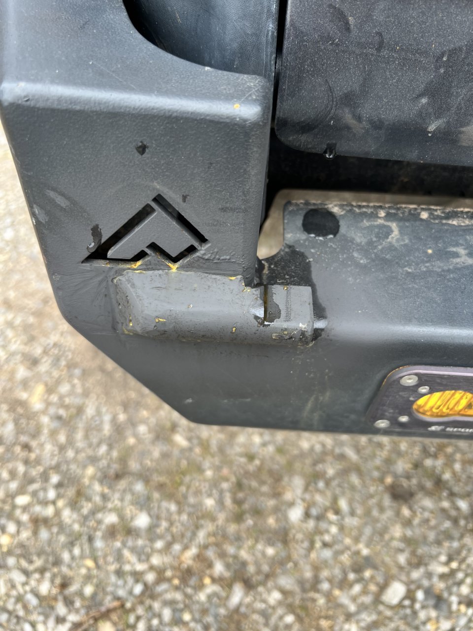

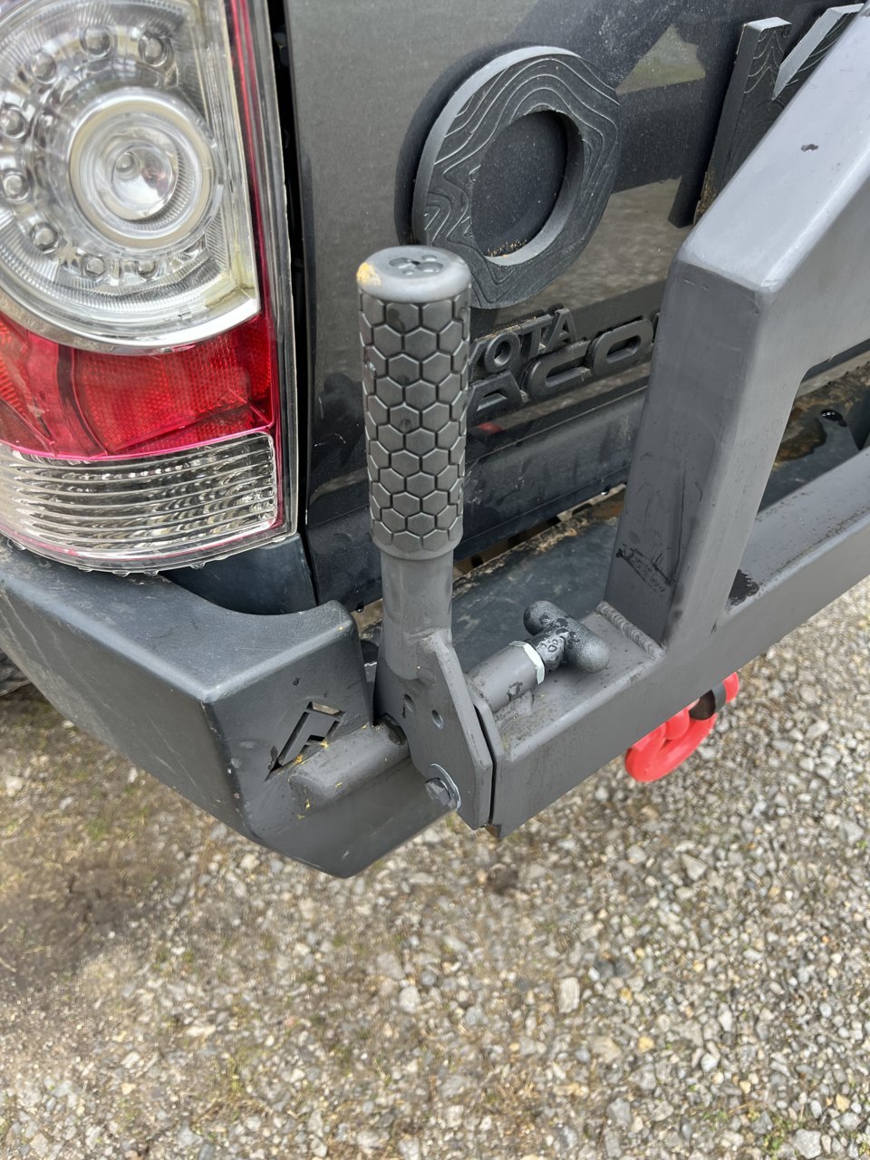

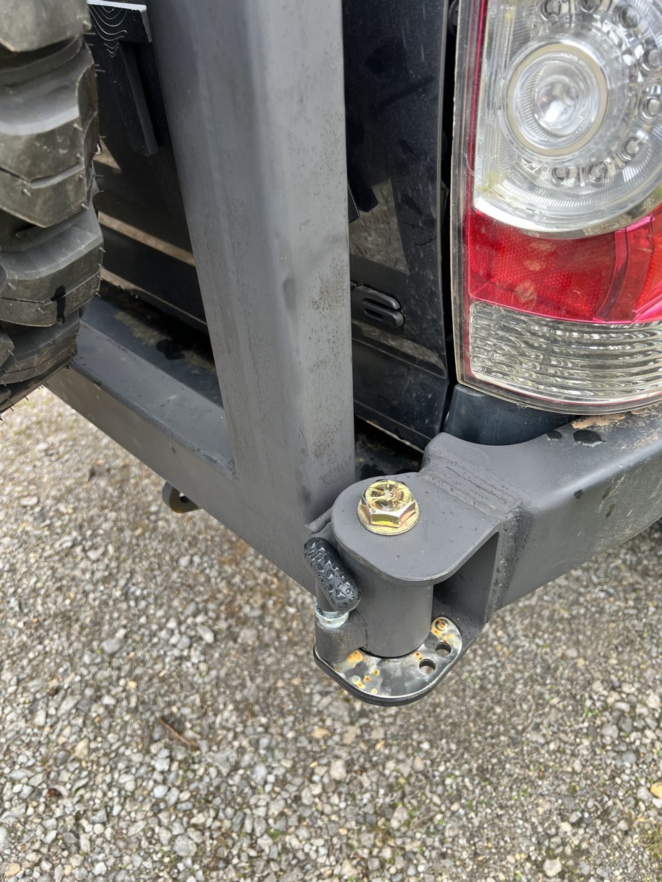

    The next 3 images are of the release handle. This was the cause of an entire change on the build for me, but it wasn’t 4x’s fault. I had intended for the whole swingout to be level with the flat of the bumper, but the Pelfreybilt bumpers upper portions are almost perfectly in line with the tailgate where it drops down, so I had to drop the round bar portion that the handle latches around. I also had to mill this in a way that the left side was half cut away to flush with the bumper, the right side was cut to drop it lower, and the top was cut to allow the bumper to drop without hitting it. All while leaving enough meat for the the handle to latch. Also had to trim down the handle where it wraps around the round bar to where it would lock in place.
    That’s a lot to basically say I had to custom fit this to make it work. I somewhat shot myself in the foot using 2x3 tube, the plate that the latching handle locks to and holds the spring pin seems to be made for 2x2 tube. B9F5376D-262B-4A01-83FA-93157F249158.jpg 75D6B9C1-C2F9-45E8-B66F-062819981184.jpg 29808B73-1504-43E8-82F0-B0F84C27B4CA.jpg The hinge end is relatively straight forward. This was another area where I had to custom fit for sure though, as the area where I attached it to the Pelfreybilt was on a negative angle, so I had to weld in some reinforcement to position it more vertical. The rust on the stainless steel glide plate is cause I’m dumb and welded with it attached :facepalm:.E05F7A7A-FDE5-4FD1-B4A5-1CFACACE4775.jpg
    The only other thing I got from 4x was the tire mounting plate. It comes with a nice gusset to weld between the tube you attach it to and the main swingout, but doesn’t come with studs so account for that.
    As far as other build notes, I made the tire placement to line up with the right edge of the tailgate and the bottom edge of the swingout to not block the tail lights or lose clearance with the bumper. Make sure to only tack the spring loaded pins, then remove the plastic handle before fully welding it!!! Don’t ask me how I know :rolleyes:. Also, make sure there’s clearance to allow it to be removed/installed as it has wrench flats.
    Other than the custom fab required, which is probably going to be present in anything like this, I thought the 4x Innovations kits were great.
    Edit to add: I am going to have to move my backup camera, which isn’t a huge deal as I’d wanted to get the Anytime Front/Rear backup cams in the future anyway. I’m also probably going to have to move my license plate, but I’ll probably hold that off until I get pulled over lol. I tried to make it in a manner where I can add Jerry can/Rotopax holders later, as well as a drop down table to cook off of. It was a fun build, I got in a lot more time on my MIG welder and relearned a bunch of technique I’d lost for lack of using it.

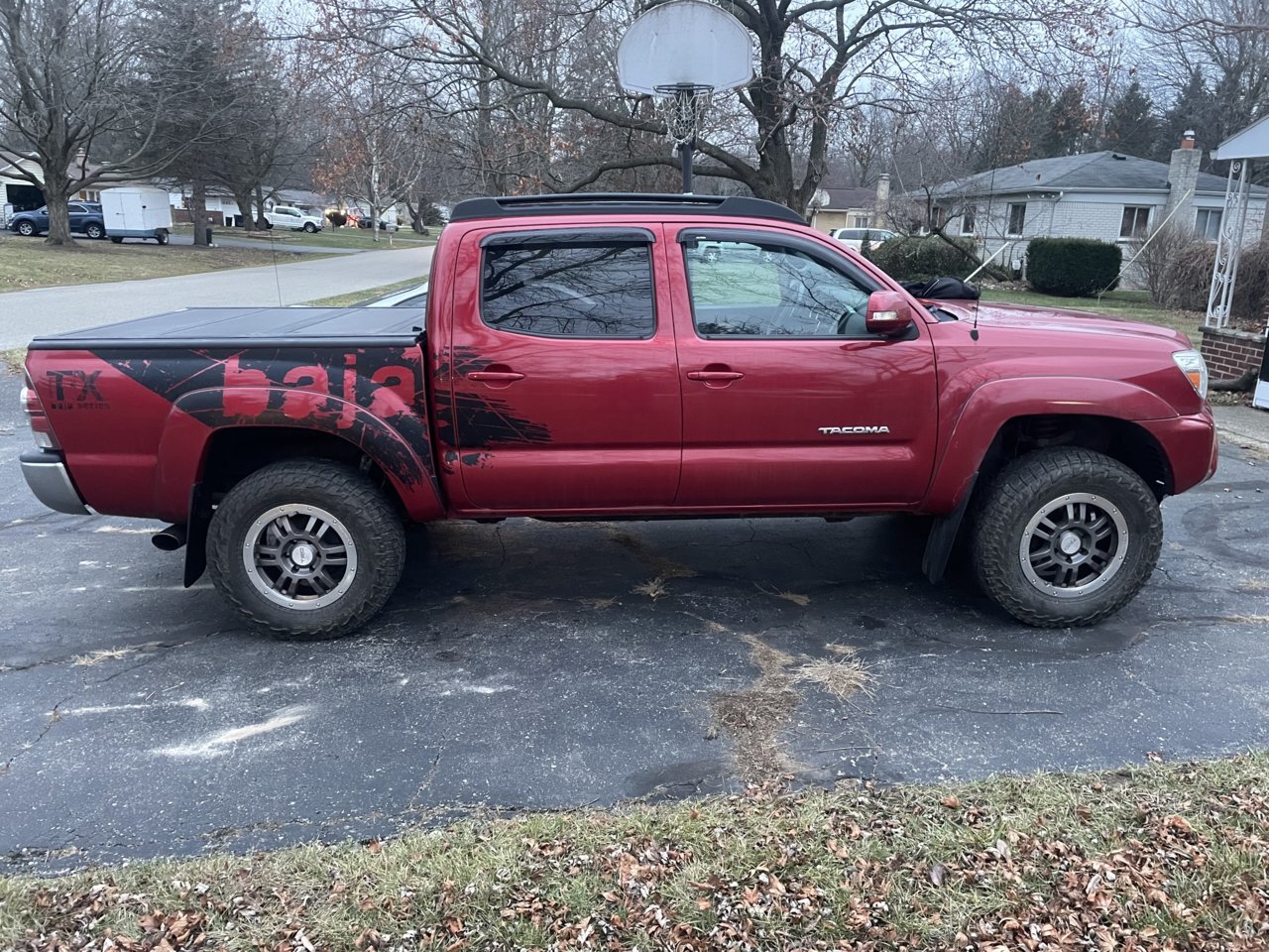

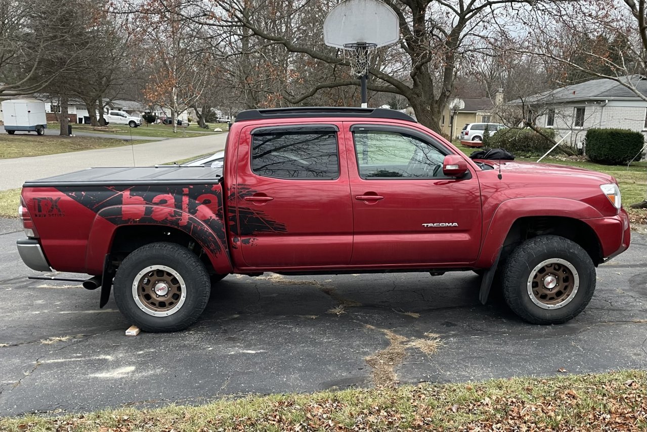

    Got the new (new to me) kicks on today and lovin it!
    Before:
    After:
  10. Dec 12, 2022 at 8:20 PM
    TireFire
    TireFire Superunknown Member

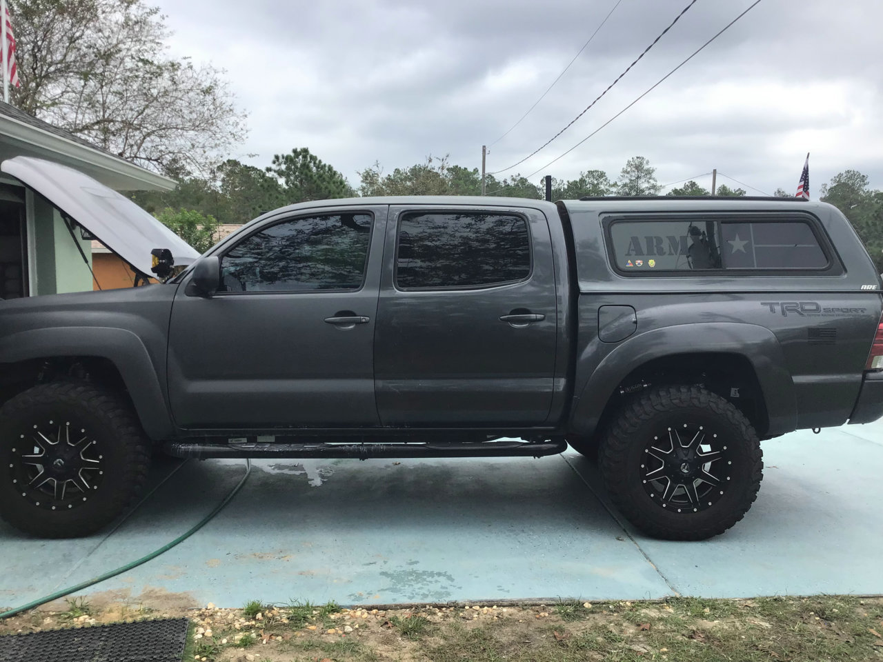

    Lighting: Phillips LED headlights, BD's S2pro fog lights, LP4 pro and LP9Pro Racing LED's, Black OaK IR cubes. COMMS: Cobra WSX75 CB, Icom 7000 Ham Radio, antenna; Alpha MotoSS HF 80m-40m, CA-2x4SR tri-band 2m/70cm/ - AUDIO: ALPINE ILX-W650, KTA-450 Amp, S-A60M 300Wt mono amp, F/R door speakers, JL Audio C2-650X, JLAudio Micor 8" sub. C4 Fab Hybrid Bumper, Warn VF12000S, Locking Rear seat Gun Vault. Locking Console Gun Vault, FPV winch Camera,
    Found the clear coat I wanted from where else??? Summit of course ROFL, 2 part mat finish, turned out almost Textured, exactly what I was hoping for! still have a bit of light buffing to do, then I Need to come up with Graphics for the bed...
