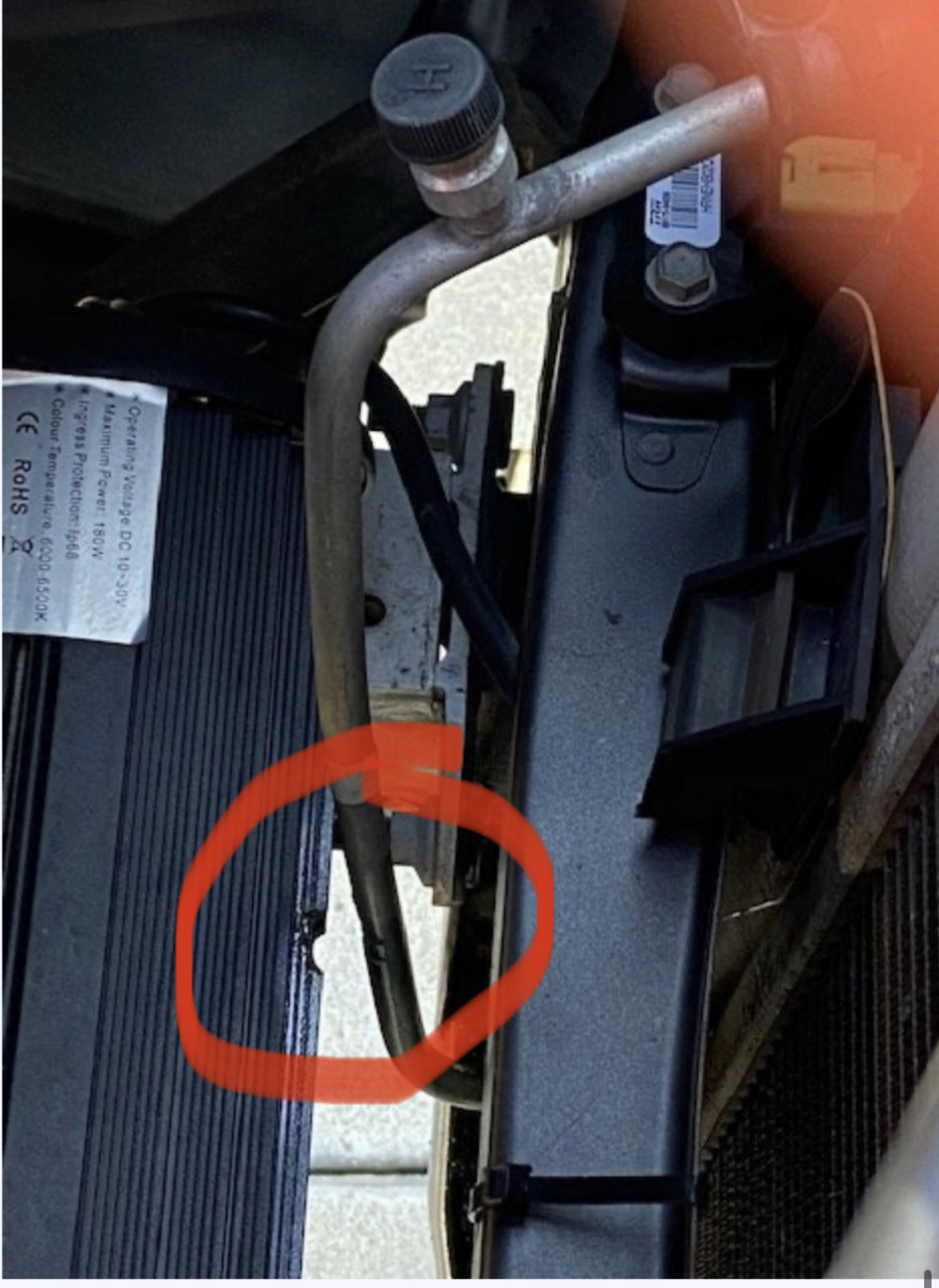

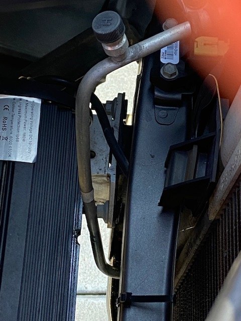

    My truck sprung a leak on this pipe. Its in front of radiator. anyone know what it is? green liquid came out. can I just patch and repair later on?IMG_0288.jpg

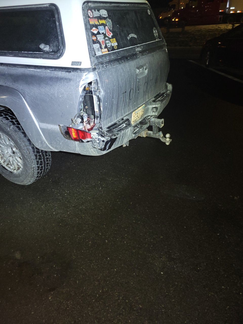

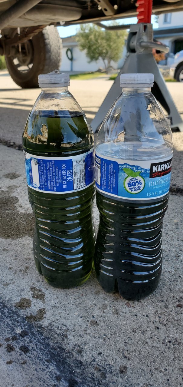

    My morning...
    Philrab and mark_tga like this.

    I think that’s the AC refrigerant line. The black cap is the refill port. Don’t use the defrost setting or AC to keep the compressor from running and take it to an AC repair shop.

    oh crap that sucks. I assume everyone is ok?

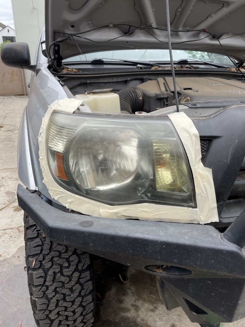

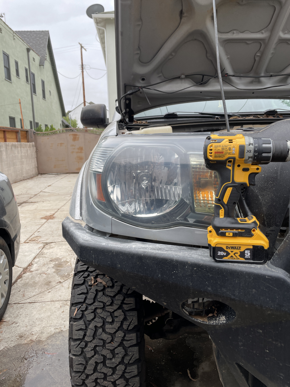

    [​IMG][​IMG]

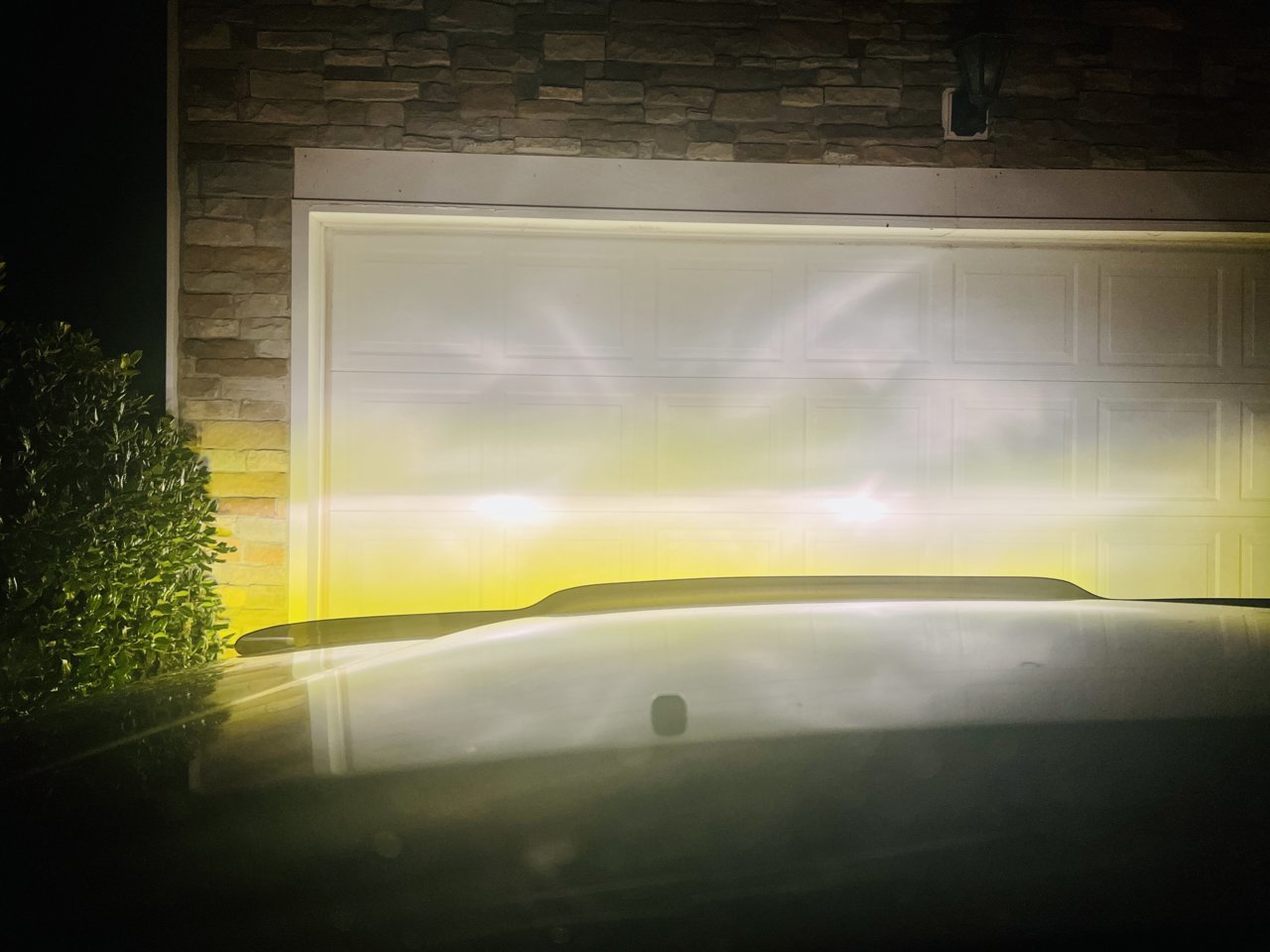

    Resurfaced my headlights. Made a HUGE difference in visibility

    Yes everyone is ok...thanks!
    Buzzkill657[QUOTED] likes this.

    Before you do anything else try to pinpoint and mark the leak area. Sometimes they get damaged simply by rubbing against something. Sometimes they can crack by simply bending them. Once you pinpoint the leak you can just unplug the connector on the compressor. When you get a replacement line make sure you get the o-rings with it. Simple job just swapping lines. Unplugging that will stop pressurizing the a/c and give you time to deal with it. When you replace that line would be a good idea to replace the receiver/dryer at the same time. Anytime you have an opening in the a/c system, for a long period, it is wise to replace that r/d as it accumulates moisture (basically a bag of rocks inside of it). You will have to purge and refill the a/c system with freon-oil mix anyway. Being in warm CALI you may want to get it done soon and maybe save the receiver/dryer. Sometimes, although rare, the schrader valve under the black cap gets stuck. If that is where it leaks take something and push on the valve and see if it pops up enough that is closes off the leak. Wear safety glasses. Freon is blinding.

    You can see where the leak most likely is coming from, after you fix/get it fixed, put a piece of rubber hose over it to protect that spot in the future BBD95012-B29C-4670-8930-0C9C30D928AE.jpg

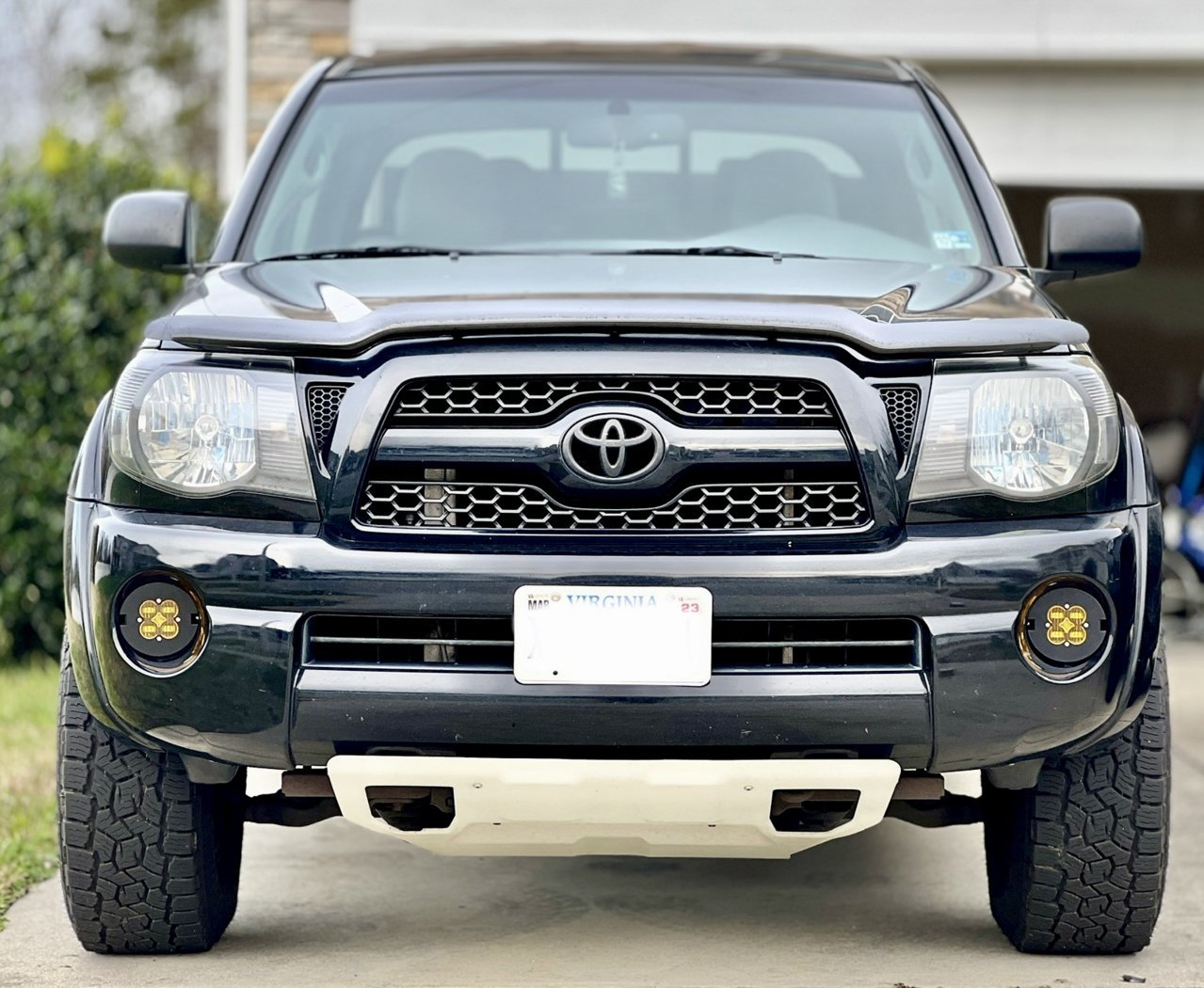

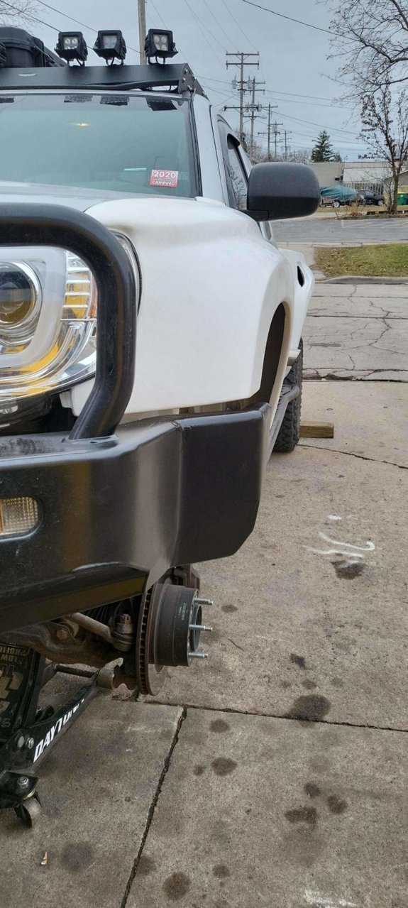

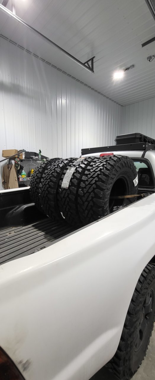

    Jesus these things are way more beefy than I thought! received_3013561628941012.jpg
  19. Dec 14, 2022 at 2:20 PM
    Northbound_Taco
    Northbound_Taco Well-Known Member
    Nov 15, 2018
    #272775
    1,243
    Nowhere Fast, Everywhere Eventually
    09 Off road build
    RCI skids/armor, SPC UCA, Fox 2.5 front 2.0 rear 16" TRD PRO rims/ 285/75/16, SS3 Pro fogs, Sherpa Roof Rack

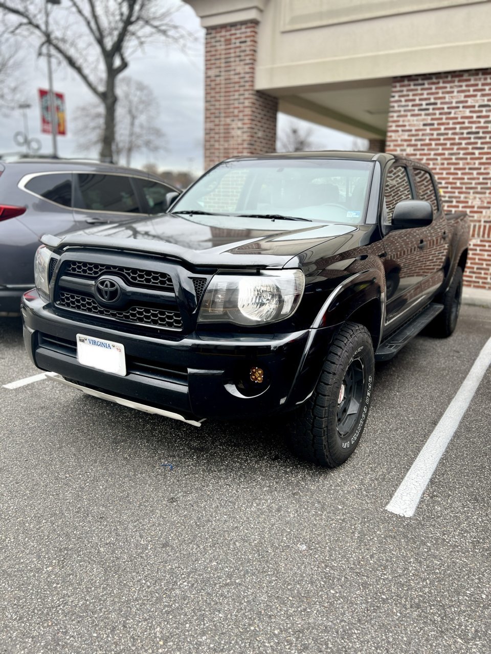

    Check your local laws. Here in MN the light from fogs needs to be 4 inchs lower then the center of the lamp at 25 ft FIRC.
  20. Dec 14, 2022 at 2:27 PM
    Ricardo13x
    Ricardo13x YT: @UrbanOpsOffRoad IG: @urban.ops.offroad
    Feb 9, 2020
    #318785
    2,931
    Upland, CA.
    05 OR DCSB ProRunner(4x4 conv.), Chevy 63”s, NWF EcoCrawler, 35”s
    Random stuff. Oh! and converted to non ADD 4x4.
    Did you do cerakote? If you didn’t, I highly recommend it and encourage you to do it! Cheers!
