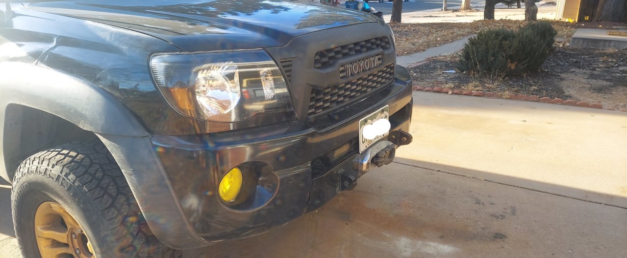

    Got some cheap black headlights from marketplace. I'm satisfied for $20 and about an hour of buffing. I screwed up coating the driver side so I'll likely redo do it. Luckily the students at my school are buffing headlights next week.
    Also did the one-click unlock all doors mod but didn't take pictures as I hate working in that part of the dash.

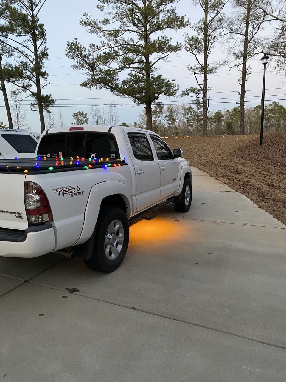

    Put some Christmas lights on my truck for my Granddaughter 31A0EAF2-2CC9-4A5F-A1FE-2ECC567A5F25.jpg

    You had me at granddaughter. My first granddaughter is due to be born within a week or two!

    Congratulations, Praying she is healthy and everything goes well for her and her Mother

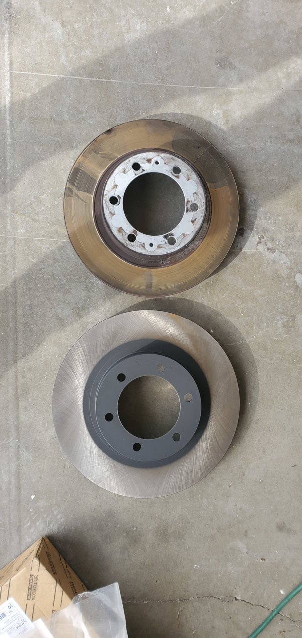

    Lexus GX470 rotors, calipers and dust shields. The rotors are noticeably larger than stock.

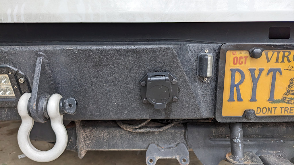

    A few weeks ago I went on a wheeling trip :mudding: and at one point the rear end of the truck hit a low spot, ran over a rock, and busted up the 7-pin trailer cable socket. Buying a new one from Toyota was going to be almost $300 :eek: and I'm like "Fuck that.":luvya:
    So Amazon to the rescue. I found a universal socket for like $20 and spliced it onto the cable of the factory socket. The cable wasn't damaged; just the socket.
    And just to make sure such a incident never happens again, I mounted the new socket in the bumper itself rather than the original bracket that hangs off the trailer hitch. No more clearance worries. :D

    How is the pedal feel with the larger front calipers and the stock vacuum booster? Nice upgrade!

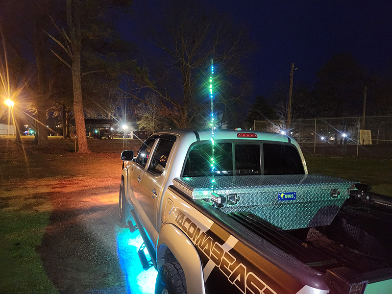

    Getting into the Christmas spirit.

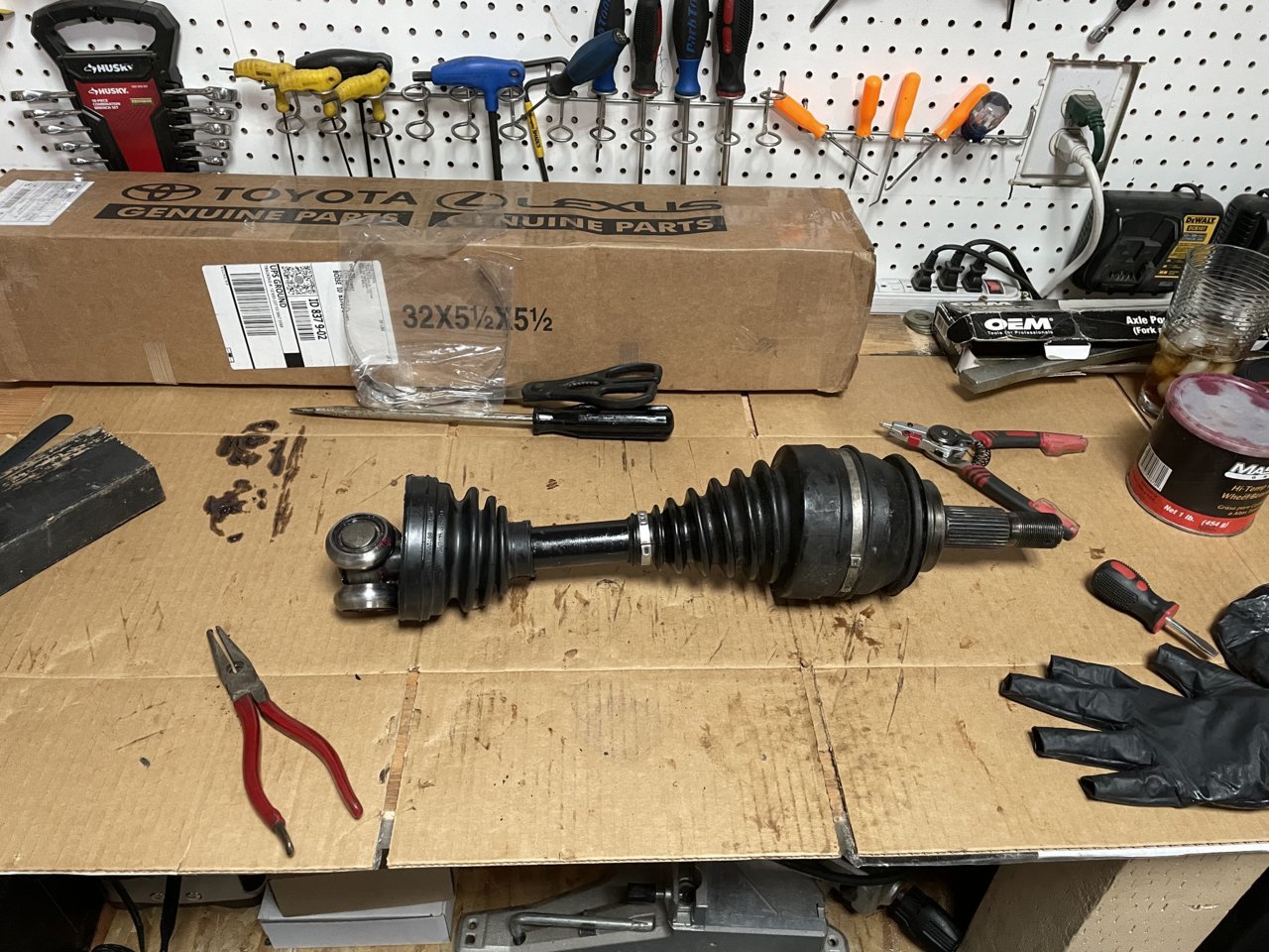

    Curious if anybody has a trick for getting their tripod off a CV axle when rebuilding. I have always just used a hammer and screw driver and slowly worked around it, but during the 20 minutes of going round and round I started thinking that someone probably has a better method here. New axle is going in, but am rebuilding this for a spare. upload_2022-12-16_22-37-41.jpg

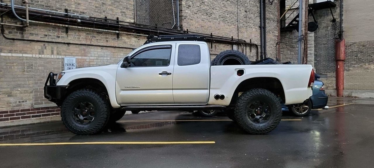

    I can honestly say I’ve never seen anyone dump the exhaust through the side of the bed before. Not saying it’s good or bad, just refreshing to see something new

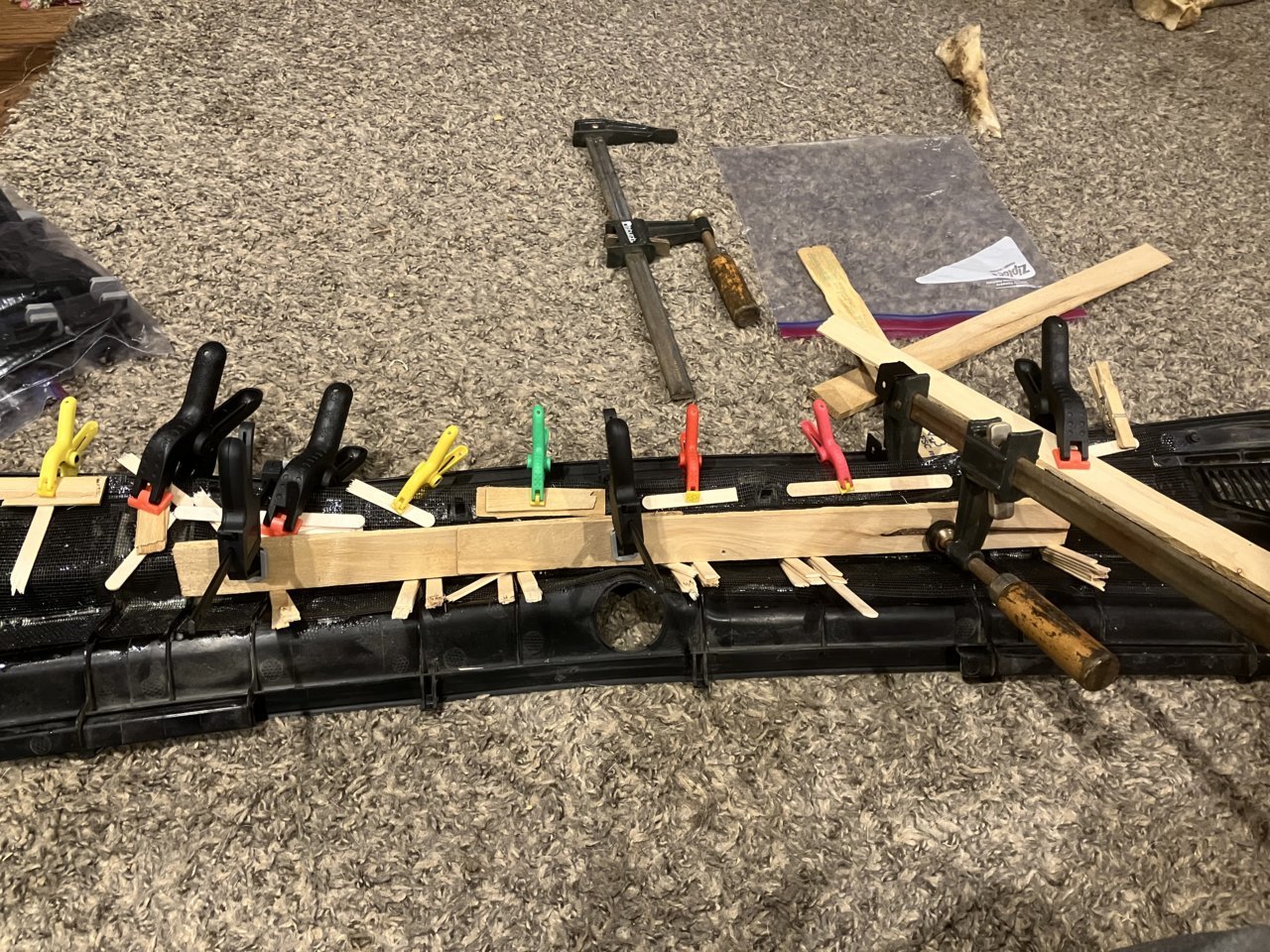

    Cleaned out the leaves and junk from the cowl area. Adhered some window-screen material on the backside of the cowl vents as a preventative measure to keep nature out, but the screen isn’t as tight as it should be. Chalk it up to installer error. I’m reluctantly expecting the leaves will get stuck between the cowl and screen, clogging it up. Maybe rip it apart and try again.
