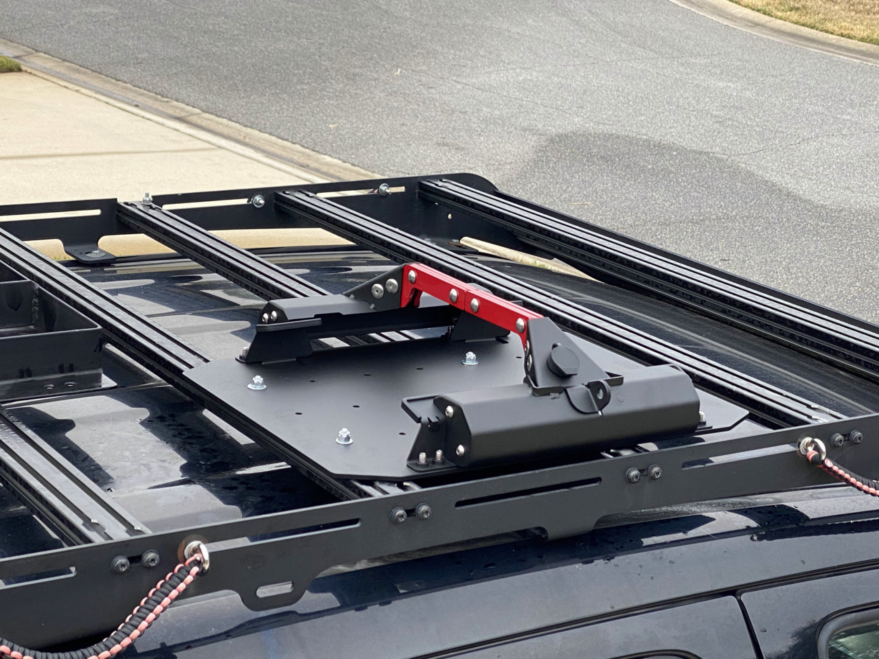

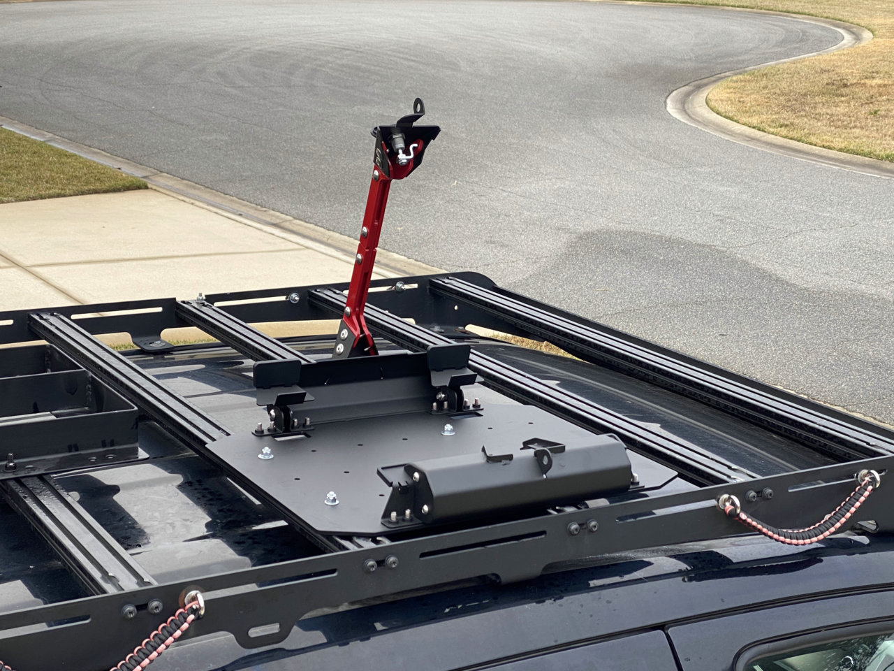

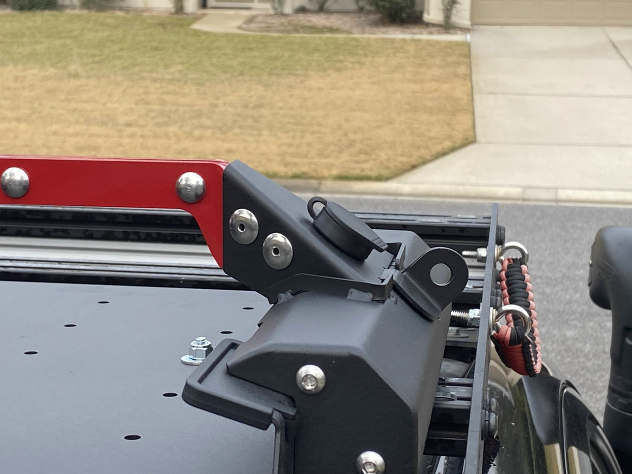

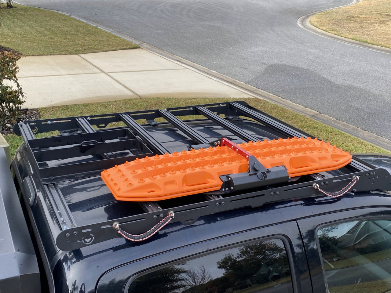

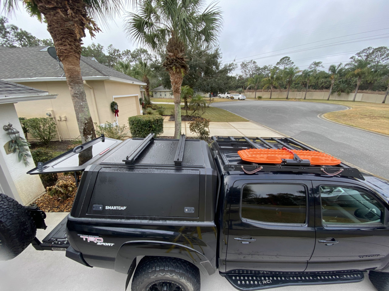

    Just added a MaxTrax Recovery Board Quick Mount to the Prinsu. I was planning to mount to one of my RSI Smartcap wing doors but was concerned about the double wall buckling/warping with the attachment hardware and also didn't want to swap the gas struts if the mount and two MaxTrax boards were too much weight making the internal molle unusable without the strut upgrade. I had plenty of roof space even with Bajarack Adventure Jerry Can Holder, Yakima Road Shower 7 gallon, KickAss Shower enclosure and ARB Awning and tent installed (but not currently).

    very nice :thumbsup:

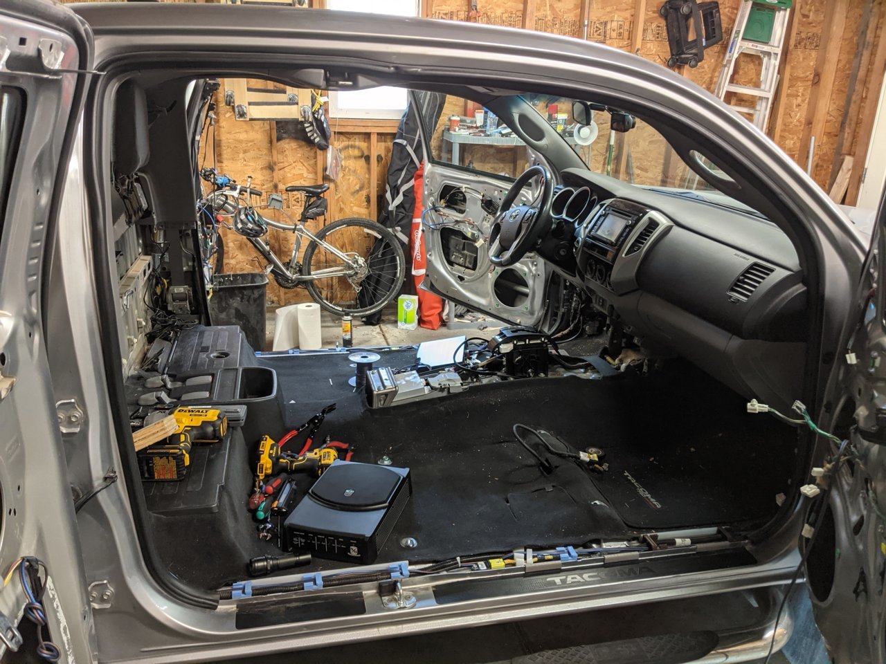

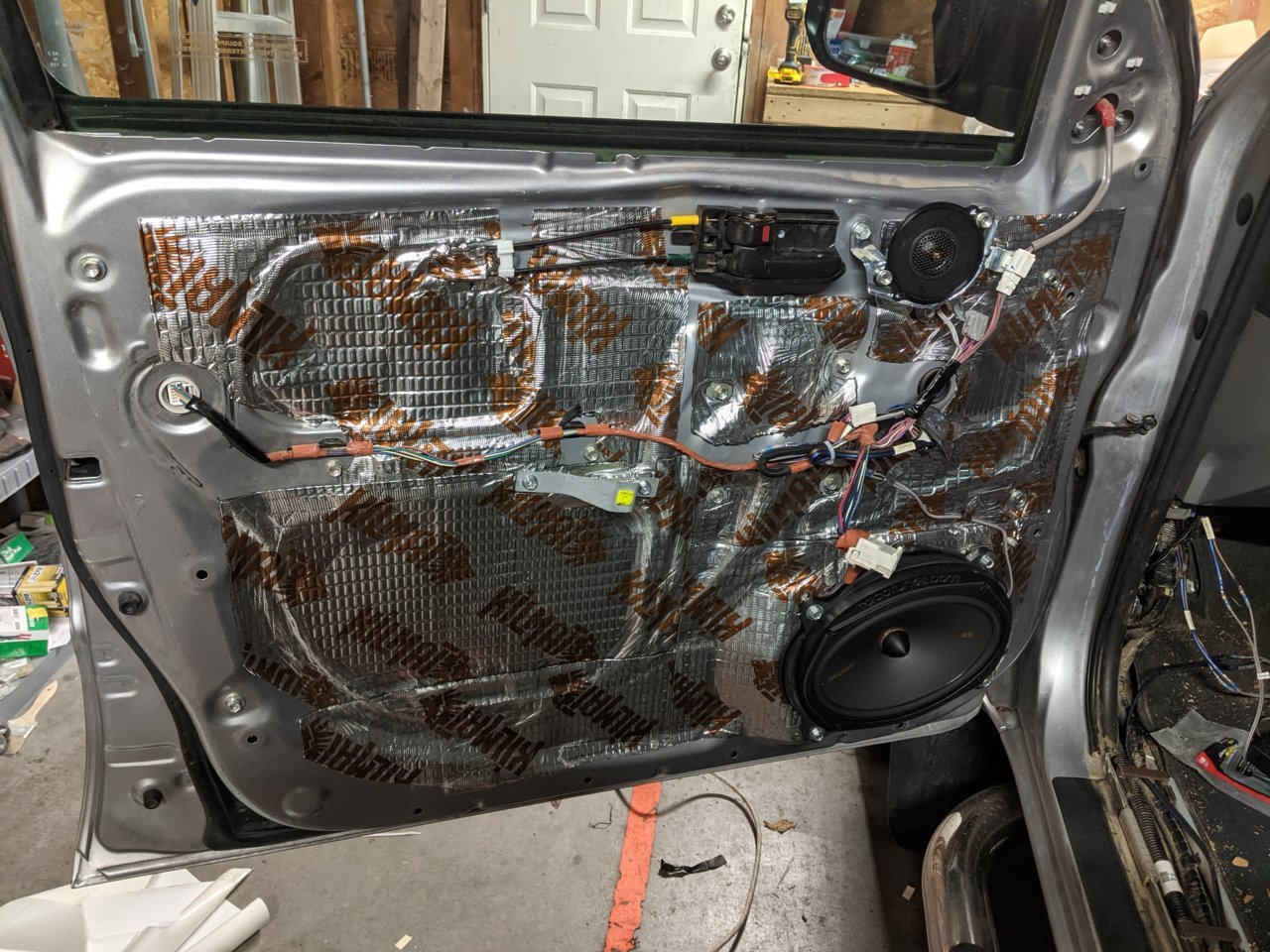

    Finished the sound system upgrade. Kicker k series speakers front and rear doors, audio control DSP amp, sound ordnance 8" sub under the passenger seat. Now that it's all back together you can't tell it's there. Sounds good though.

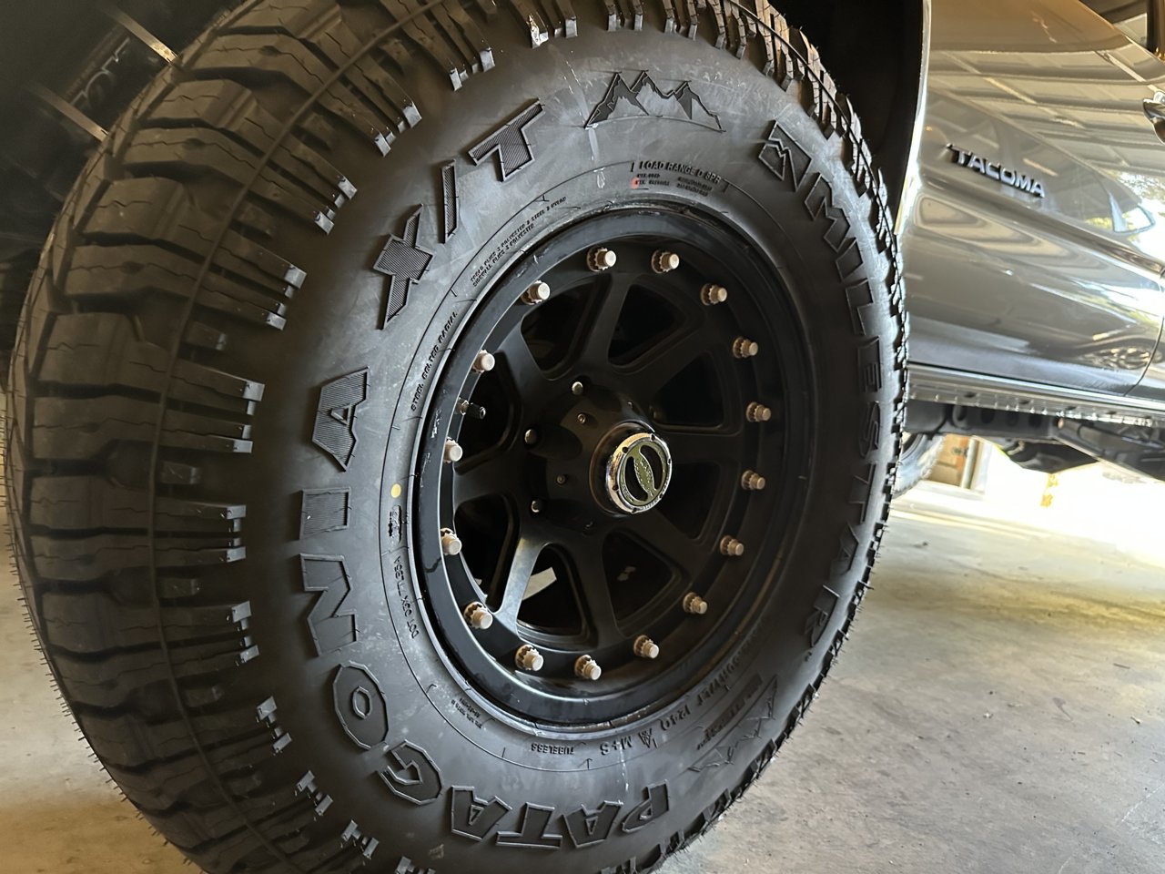

    Got some new shoes. Going to try these 37s XTs out. I know the Pat MTs seem to be a mixed bag.

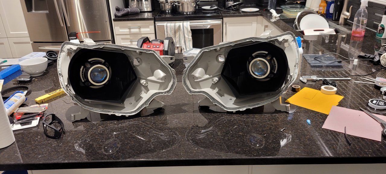

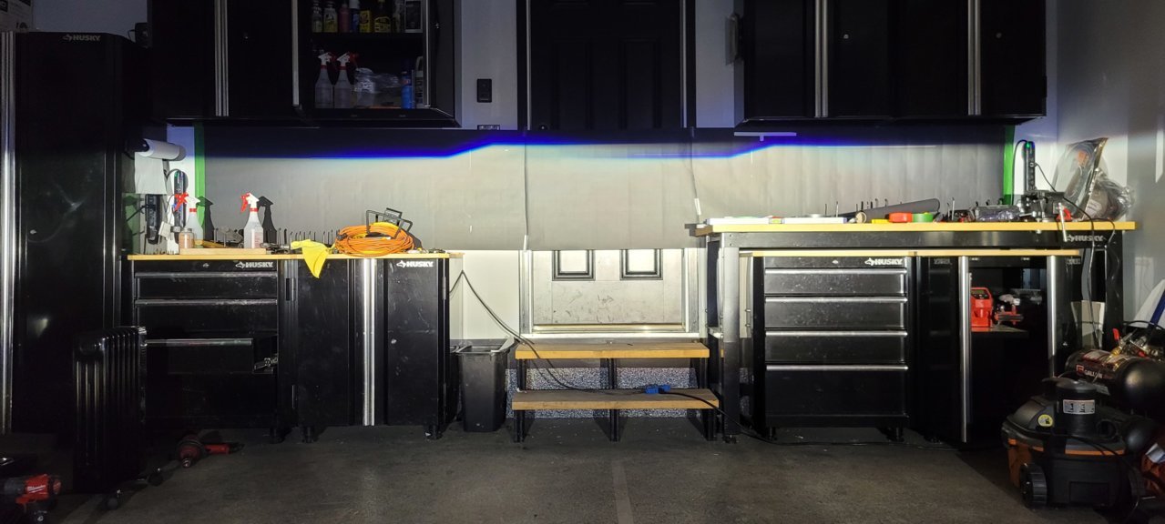

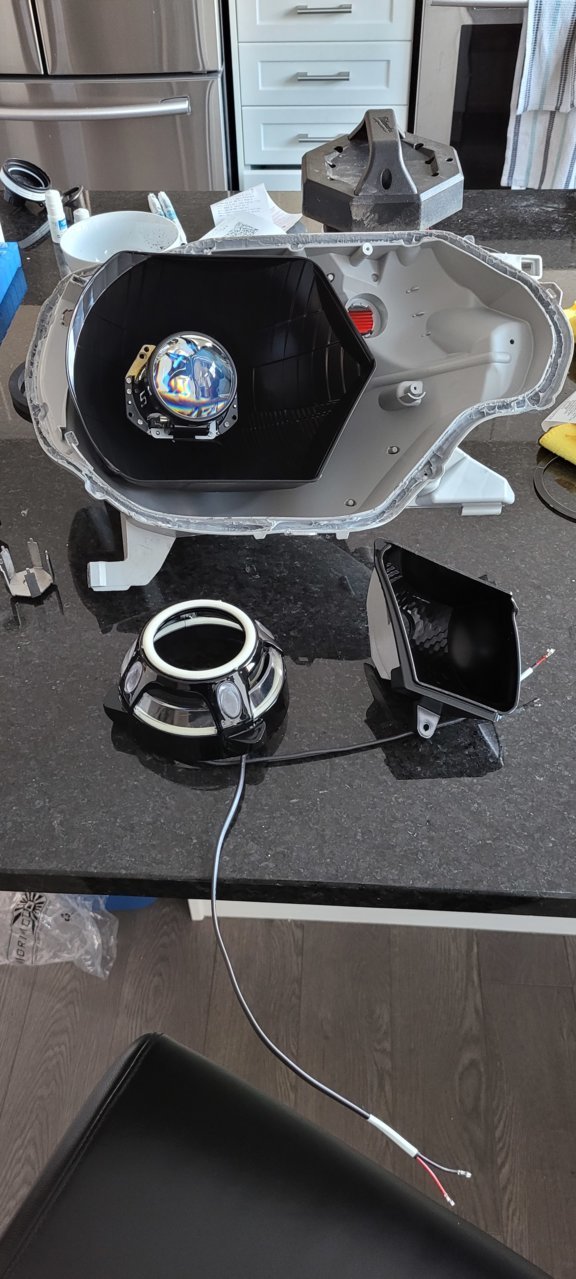

    Almost done my retros. Got them aimed up last night. There were some more adjustments after this picture was taken. The driver side was a little higher than the passenger. Most important part was to set the level. Output is amazing, much cleaner cutoffs and more output than the "Ultimate Headlight Upgrade" I've been running the last few years (upgraded harness with high output halogens). Final assembly tomorrow hopefully...

    I know people have talked about this extensively on here, but thought Id ask - was the sound deadening mat worth the effort?

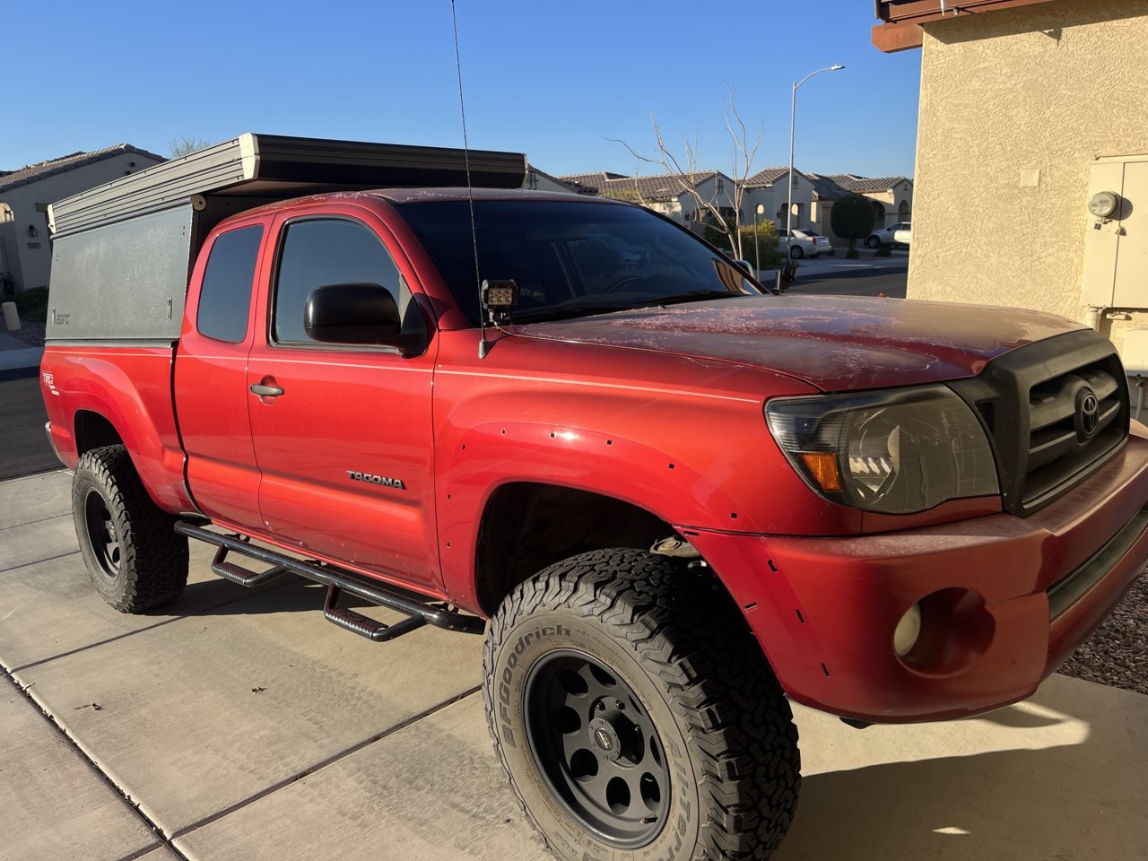

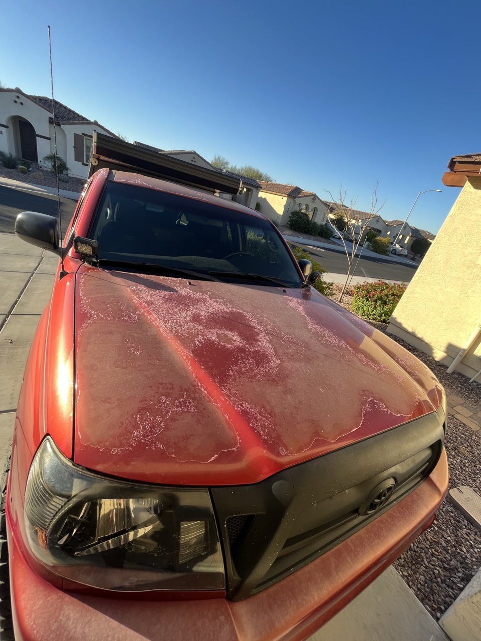

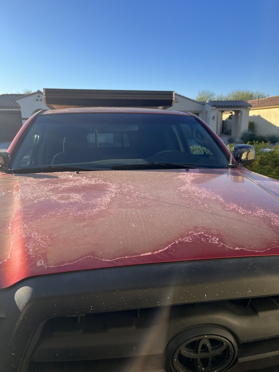

    I tried doing my hood a couple of years ago with duplicolor and an expensive professional 2 part clear coat since that’s what everyone said was the only way to go. Prepped and cleaned everything properly, followed all of the instructions and timelines on the cans, and my clear coat still peeled off less than a year later. I know lots of people have had good luck with rattle cans, but I didnt at all.
    I decided to try some diy vinyl wrap next and Im loving it. I used a brand on Amazon with good reviews that was cheaper than the big brands because I thought the first attempt might be a throwaway. It’s not a color match, but it looks good, is way easier than painting, and was waaaaaaay cheaper than the paint and clear coat that didnt last.

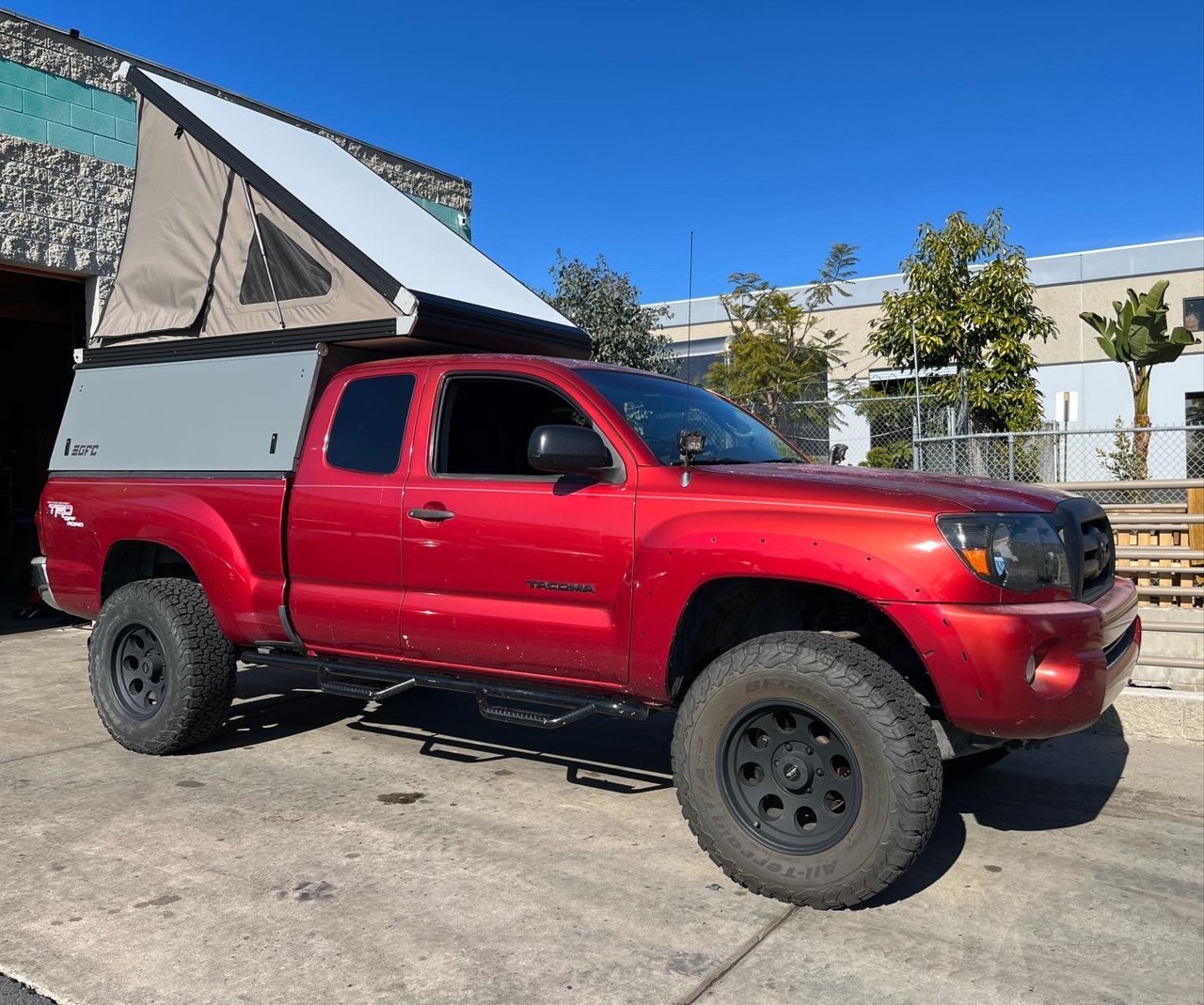

    Love the look of that truck.

    Probably. It didn't make the road noise any better, but things in the door rattled before the upgrade and I haven't heard any rattle after the install. That might be because I ziptied all the wires up better, it might be because the sound proofing.

    not seeing any uplight in that pic

    Totally worth it. Made the sound system sound far better.

    Got a pic of the sun under the seat?? Was thinking
    Got any pics of the sub under the seat?? Was thinking of doing something like that

    I had to remove the cable protector from under the carpet and run a 1.25" front seat spacer and 0.5" rear seat spacer. This lets me run the sub sideways and pushed as far forward as possible, but everything clears with no interference and the wife said she doesn't notice that the seat position has changed. The power and signal go into the carpet, over the center console hump, and come out on the other side at the main amp. By cutting away most of the last switch blank, I was able to mount the bass control knob in a stock looking location.
    The last thing I'm trying to get right now is the remote turnon with the stock head unit. I used a "plug and play" harness from someone online, and it gives a constant 12 and accessory power +12 option. I'm using the accessory 12 so the amps come on with the key. This is causing the sub to buzz for a second while the stereo and main amp boot up. I bought a few cheap 555 delay timers from Amazon and will play around with delaying the accessory 12 volts from reaching the remote turn on lugs for a few seconds and see if that gets rid of the buzz at startup.
