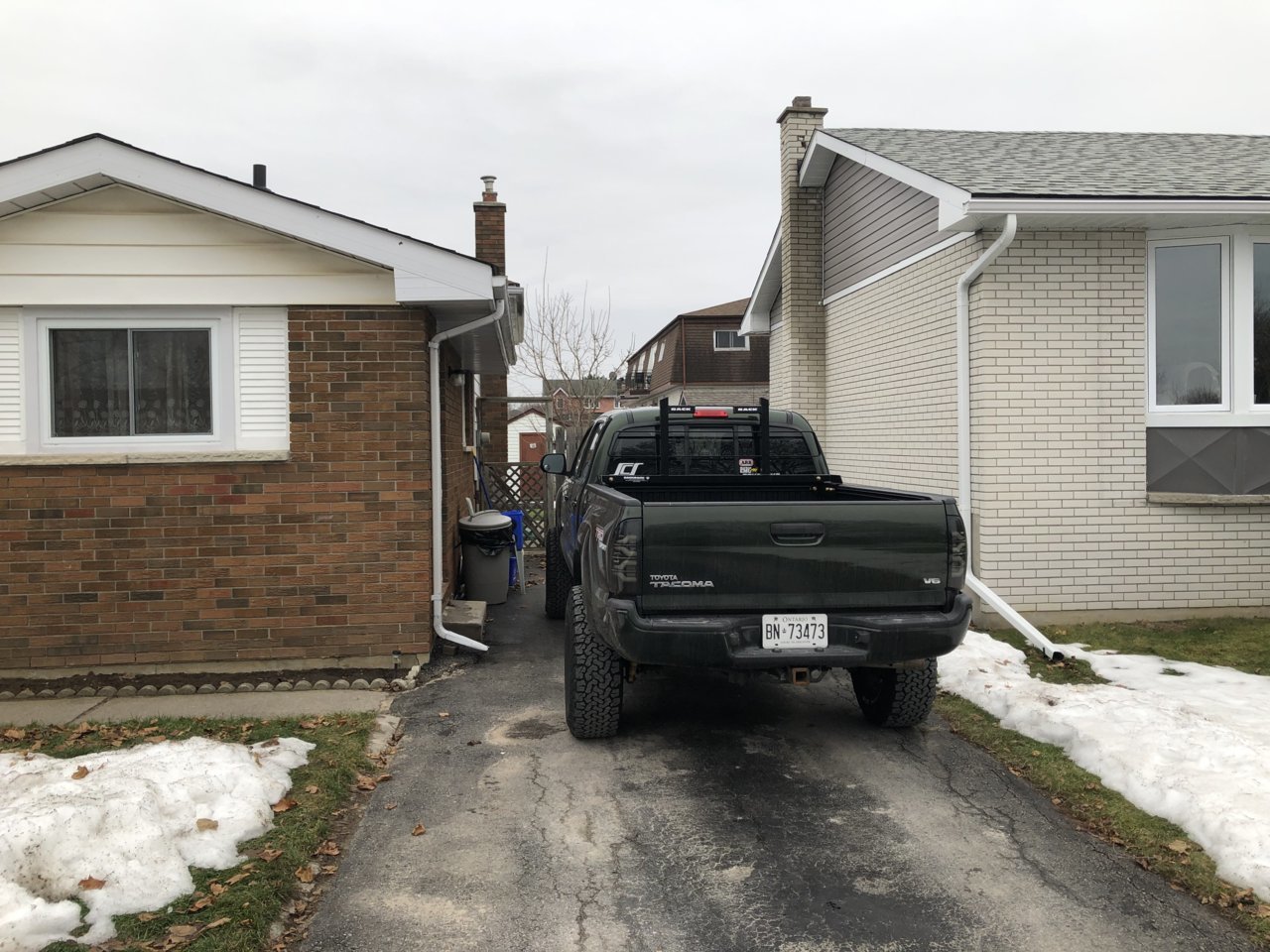

  13. Jan 4, 2023 at 6:40 AM
    wildland89
    wildland89 Well-Known Member
    Oct 7, 2022
    #407527
    79
    2013 Tacoma ACLB
    Installed the Pop and Lock tailgate lock, back up camera and Mountain Hatch today on my 2013 ACLB. Ran the wiring into the cab, just have to finish wiring in the camera to the head unit now. The Pop and Lock system is so nice to have, although the manual lock does feel chintzy.

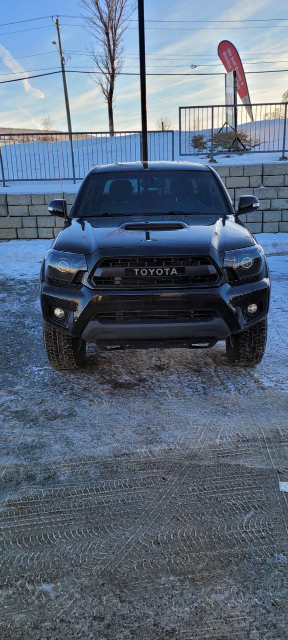

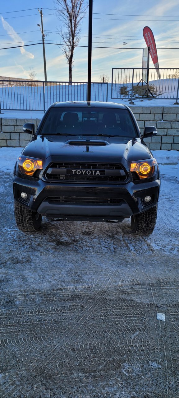

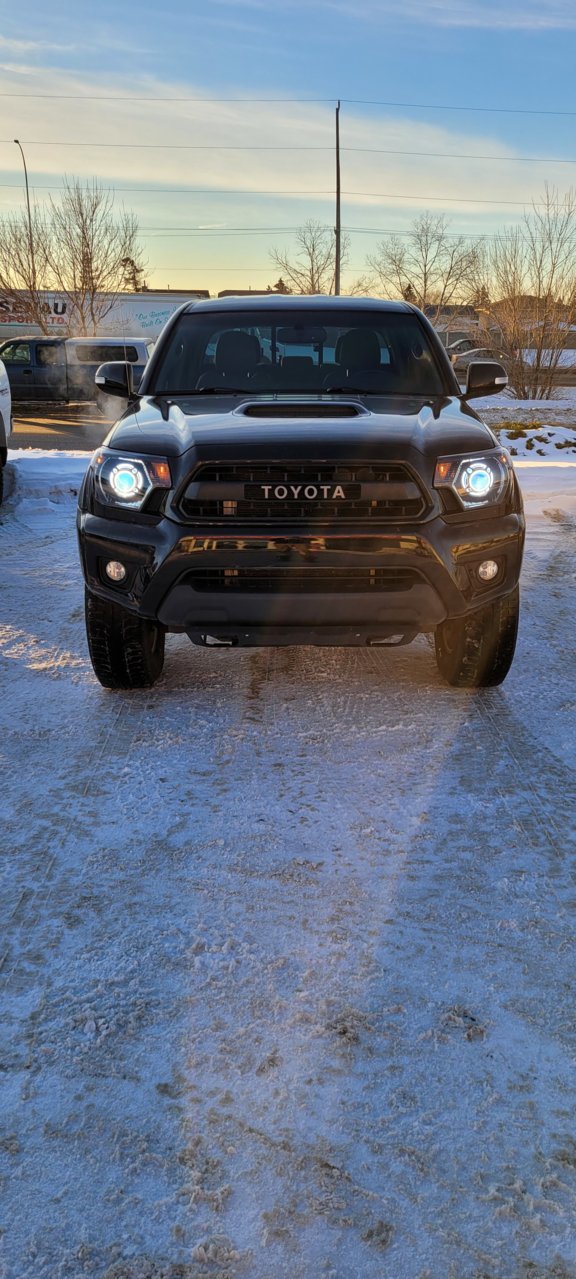

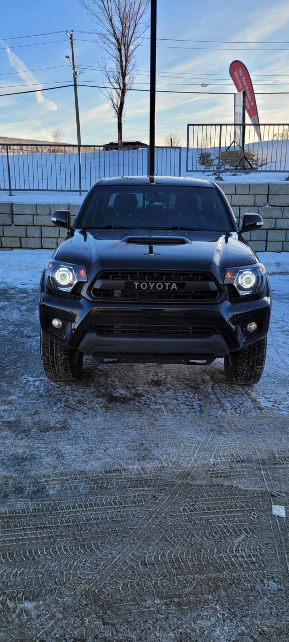

  17. Jan 4, 2023 at 12:08 PM
    Audi403
    Audi403 Well-Known Member
    Aug 30, 2019
    #303774
    200
    2015 Tacoma TRD Sport
    Retrofit complete!
    With the lights on:
    sshadow69, lo2hi, KOG89 and 23 others like this.
