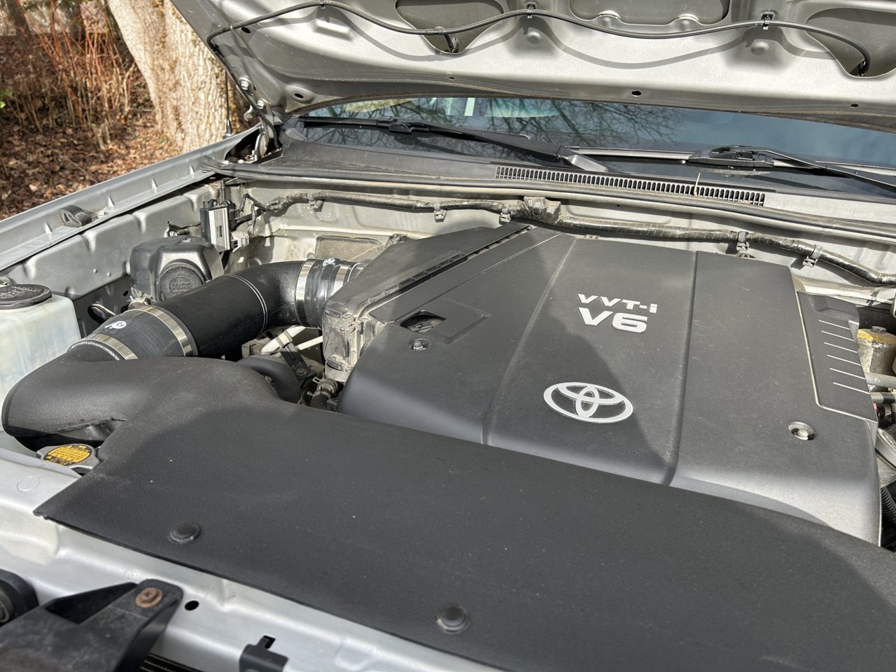

    I think it would depend on where you get it smogged. The two places I use would not pass that. It is really how much they scrutinize the smog laws. Even though all you are changing is the location of the inlet, the filter housing isn't being modified, they consider that modifying the intake. Therefore it would not pass visual. I asked him about the PCV catch can and that would fail too. Because you are modifying a part of the emissions. California can suck when it comes to cars. That is why I prefer pre 75 cars. No smog required.
    I think in more recent years the smog techs have become more strict because their license could be at stake.

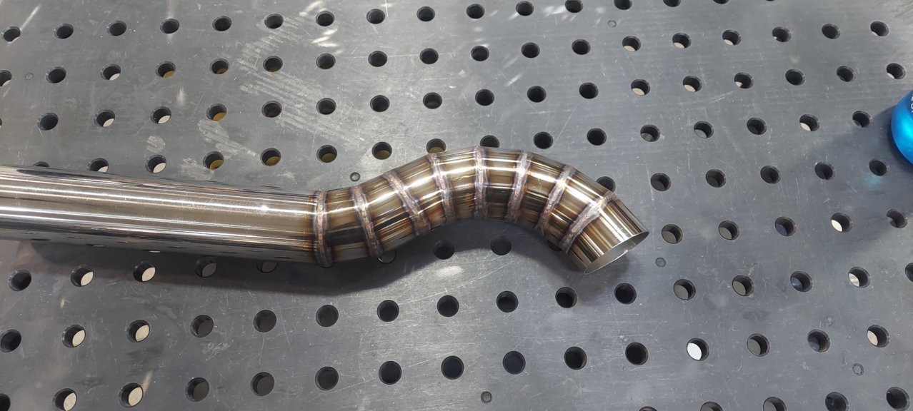

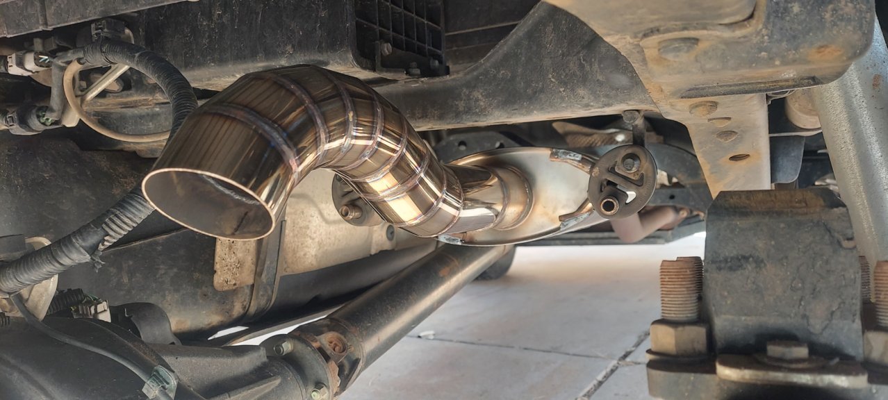

    Installed a Borla ProXS (40364) today, my factory muffler split at the seams. 2.5" stainless tubing slips nicely over the stock tubing. I'm too cheap to pay the $25 for a stainless turn down/axle dump so made my own out of tubing I had on hand. I'm happy with it for the most part, sounds alright with the cowl snorkel.

    wow that is sexy! I need something like that on my 09, you said the 2.5 pipe slid over the 2.3 piping? very nice to know, maybe it's time to grab a set of calipers and see what is actually under my truck, was going to throw 2.5 with a glass pack style resonator and likely some sort of straight though or chambered muffler.

    Thanks! Yes, I had a feeling it would work but I was happily surprised with how tightly it fit. That actually fit better than the 2.5 into the muffler which kind of surprised me. I'm thinking I might add a resonator as well a little later.

    hows the exhaust note? any drone under load? i may still just go pull my exhaust off and go grab some mufflers and have them weld me up some 2.5in and dump it though i may have them angle it towards the outside or something.
    again, those pie cuts are sexy!

    It's decent, quieter than I expected. Also, not as deep as I expected. There's a slight attenuation 2500-2600 RPM but it's not terrible. Again, my old stock muffler was split so I am somewhat accustomed to noise in the cab. I'll likely sound deaden in the spring.
    And thanks again, I love pie cuts and they're pretty simple.
    EDIT: for anyone interested, I did a 30° turn up to 90° turn down on a 6" CLR in 8 pieces at 7.5° either side. I forget my long wall length, I think it was 1.58".... sorry. It follows the axle housing proportionally.
