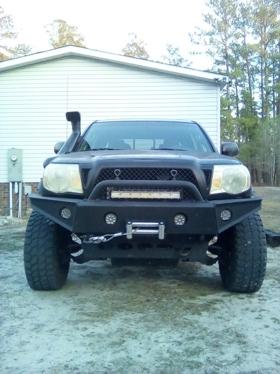

    It honestly isn't bad for 600, once I don't suck at welding I plan on fixing some issues and things I don't like. I mean you get a lot of metal that bolts together into a decent bumper that's budget friendly, better approach angle and tire clearance.. I'm happy I got it

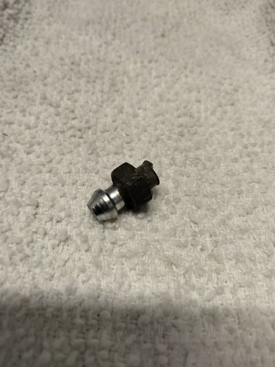

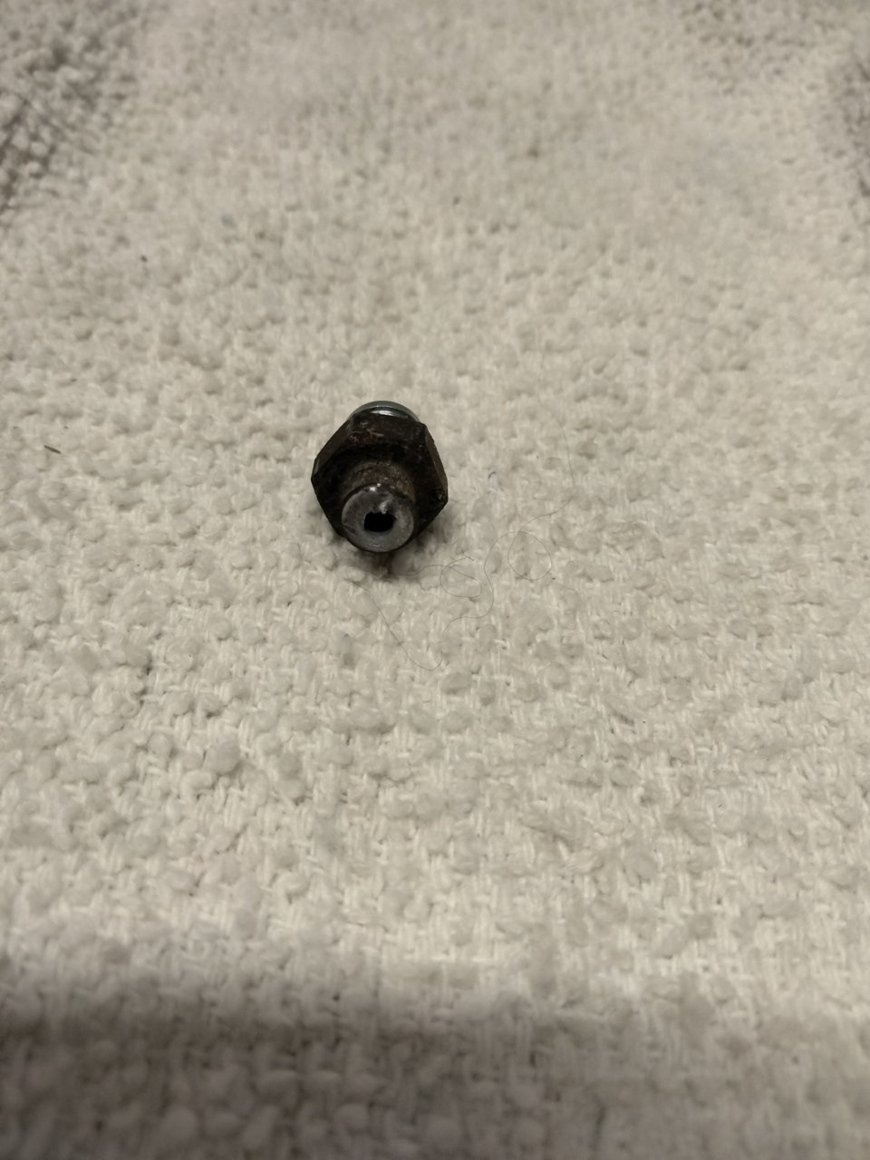

    Bled the brakes, well almost...
    Got to the last one, the driver's side front and the nipple sheared right off :frusty:
    Now I have to figure out my best course of action. Ideas?
    Robsharp06coma likes this.

    did this once. pulled out my extractor. had it removed in 5min. just make sure to have a new bleeder ready to go

    I assume your problem is getting the other half out?
    If you have a step drill bit set then the easiest way is to use the existing passageway through the middle of the bleeder valve as a guide and use consecutive increasingly larger sized drill bits to slowly drill out the bleeder valve. At one point you should be able to pick our the pieces and get it completely out. The tricky part is to make sure you do not drill too far in and damage where the bleeder valve seats.
    Edit: Or use an easy out.
    Bagman[QUOTED] likes this.

    you can remove the rest of the bleeder with an extractor
    Use heat penetrating oil etc on the area first
    If that doesn’t work, should probably replace the caliper which could use a rebuild by now anyways, at best
    69 Jim and Bagman[QUOTED] like this.

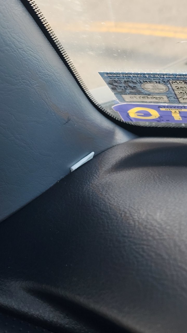

    Dash rattle fix. :frusty:
