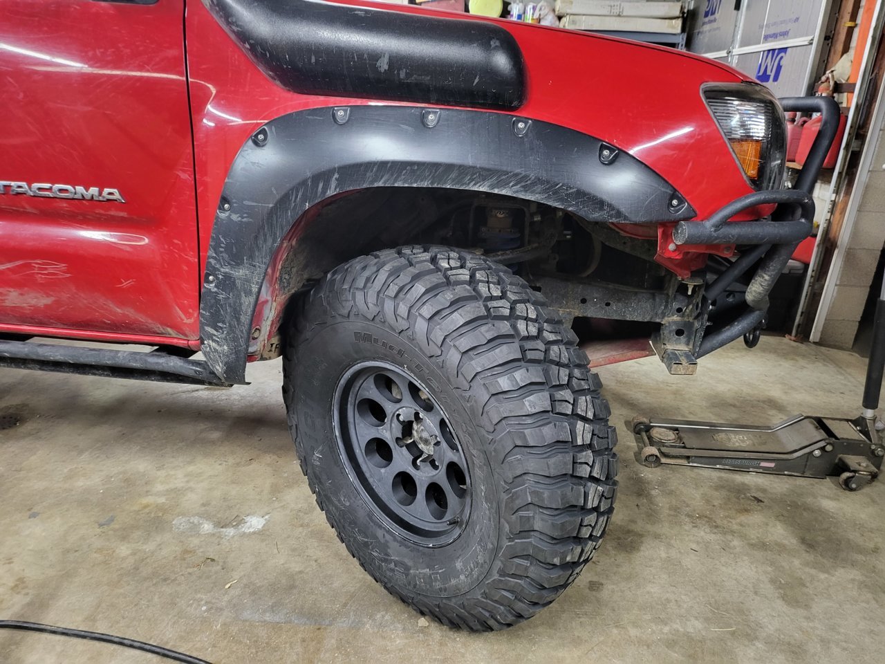

    What suspension modifications did you do to manage this? And are they rubbing? I've got spc uppers and Bilstein 5100's as well as cmc think I'm good

    37's,lockers, bumpers, bobbed etc.
    I've got Fox factory series coilovers, along with a mild cab mount chop and rokmen race series uca. It needs a more extreme chop for sure. Also, fenders have been trimmed 2 inches. As far as alignment, I've got a shade over 2 degree forward caster.
    Also, it does rub the cab mount at full lock hence the need for a more extreme cmc.

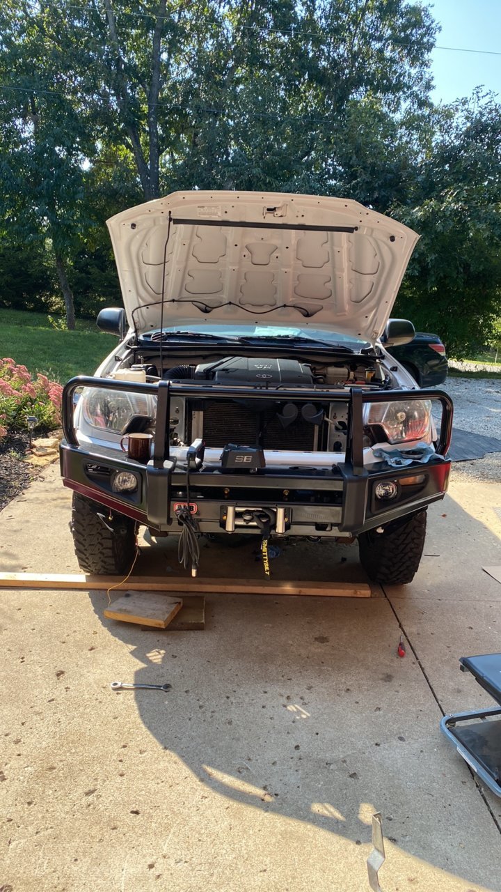

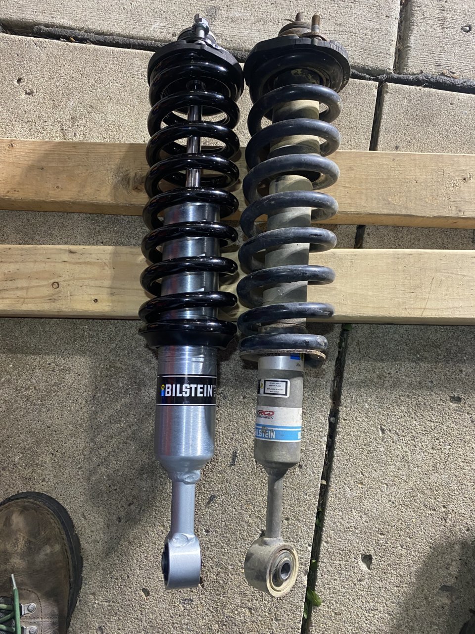

    Full truck overhaul in progress. ARB bull bar and 6112 with 700lb springs. Last week of December we drove to Wisconsin to meet the guys @4xinnovations and got rear bumper fitted rig dual swing outs. Hoping to install rear bumper today
    next will be beefing up the rear leaf packs to compensate for the extra weight and new shocks

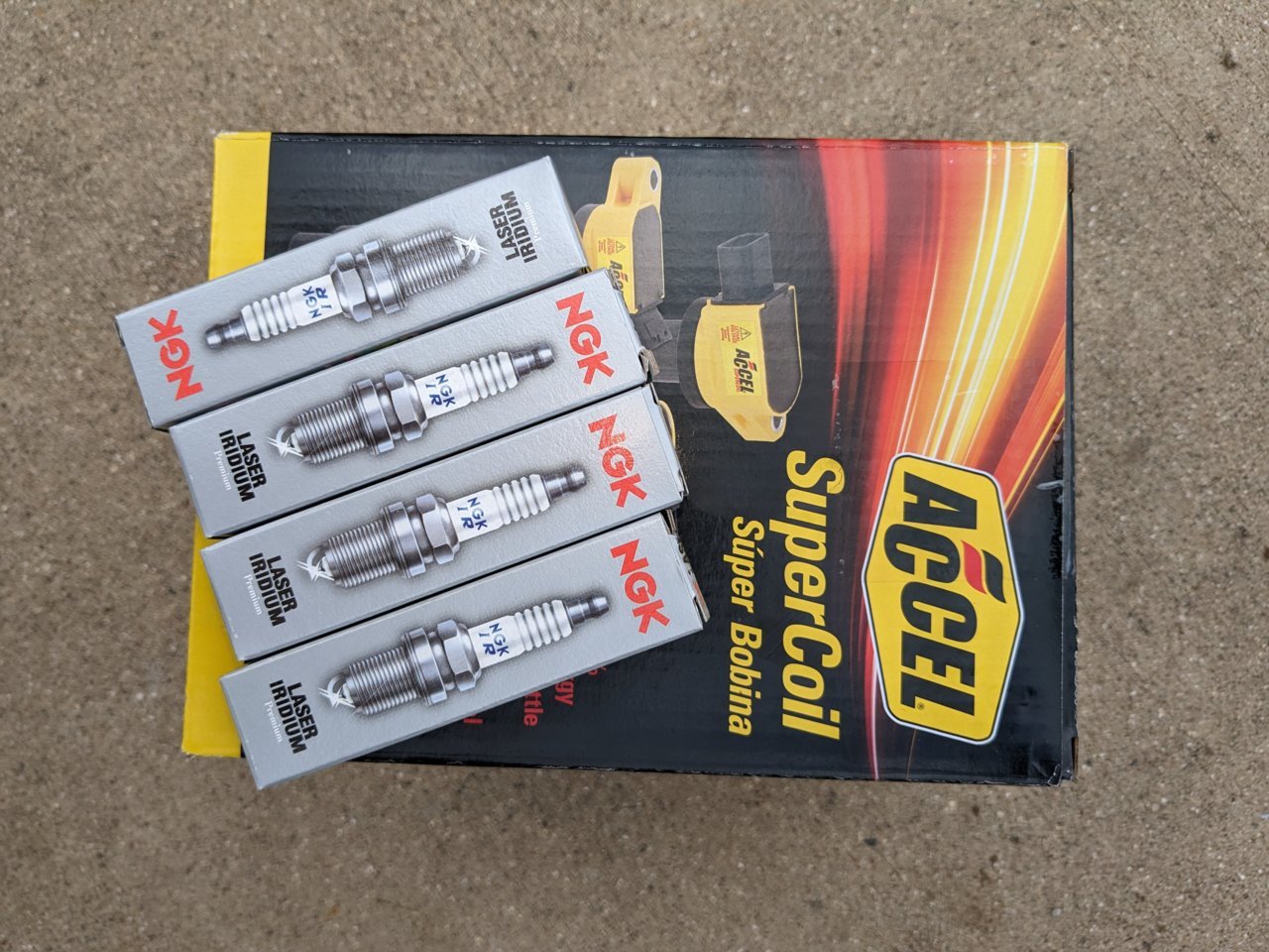

    PXL_20230121_185046509.jpgreplaced plugs and coils and greased all my joints

    tell me about these coils, was wondering about replacing my coils, just put in new plugs, could looked okay and didn't have any misfires, but getting closer to 180k, just thinking i should do coils too

    They had good reviews. I literally just put them in and drove my truck around the neighborhood a little bit but I definitely feel better throttle response
