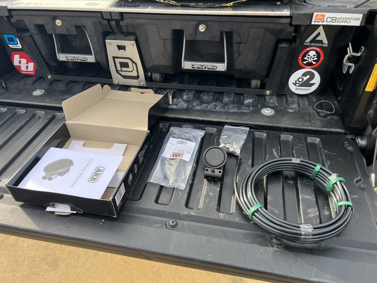

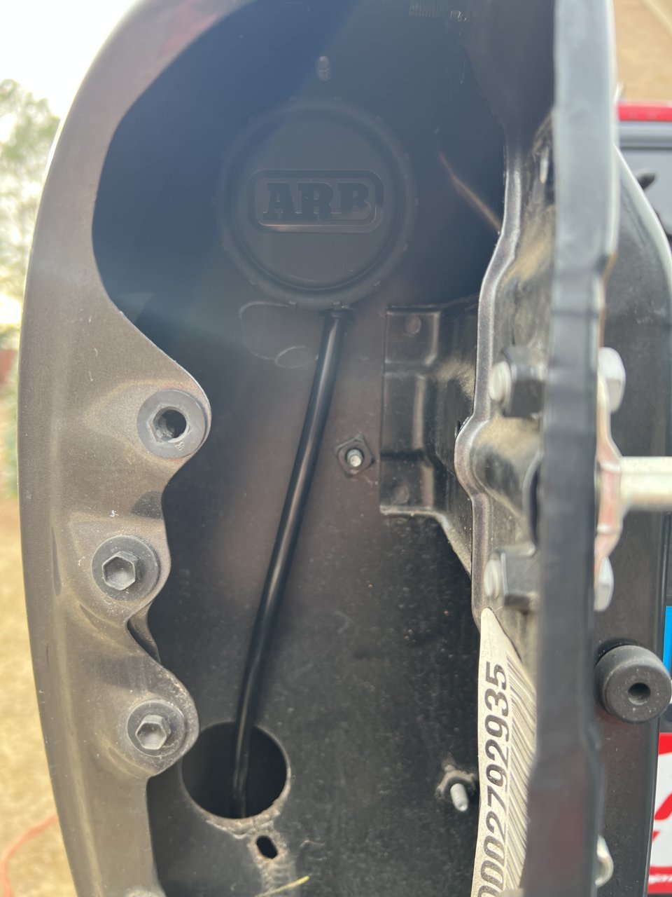

    ARB Diff Breather installed.
    B7C9EE81-BA98-4060-BE5D-A04AE320A0A6.jpg 258B00A6-24EB-4FFD-B072-363C0F8A2507.jpg

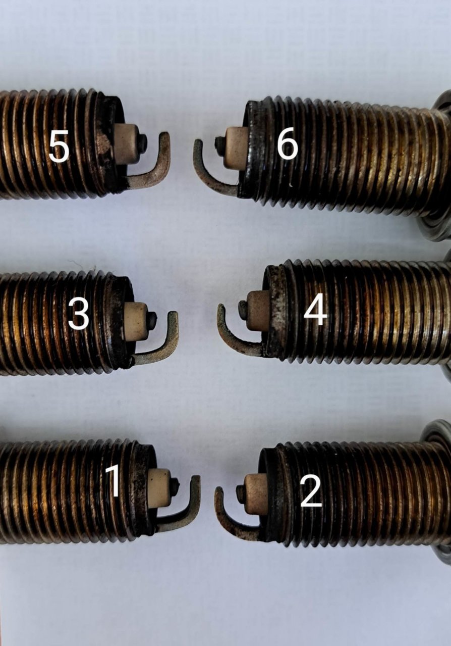

    My truck just turned 125K miles and it's developed some hesitation lately. I noticed on the 120K maintenance recommendation to change the spark plugs, so following the outstanding write-up on this forum I tackled it today. After 1.5 hours I've replaced what had to be the original plugs (Denso on the passenger side, NGK on the driver side) for some new Densos. They were terrible - the gap on all of them had grown to over .064. No wonder it wasn't running great!
    Now she's back on the road with good power and zero hesitation, and sounds like she's running more smoothly than she was. This forum is the first place I turn whenever I have Tacoma questions. Thanks to all who contribute!
